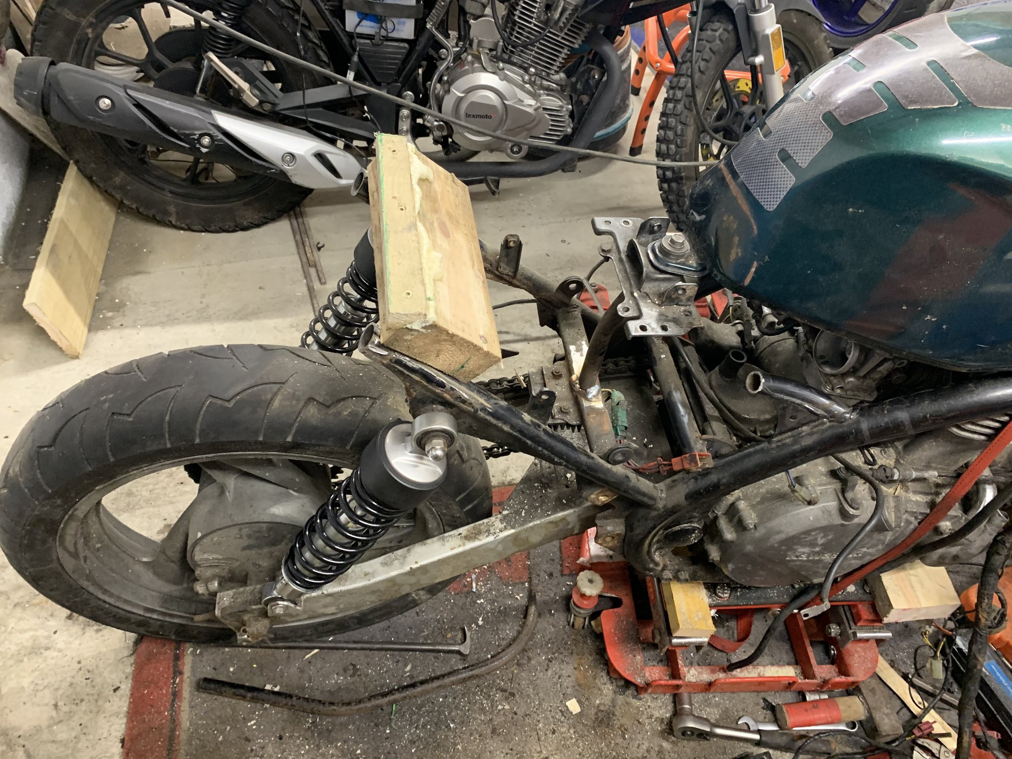

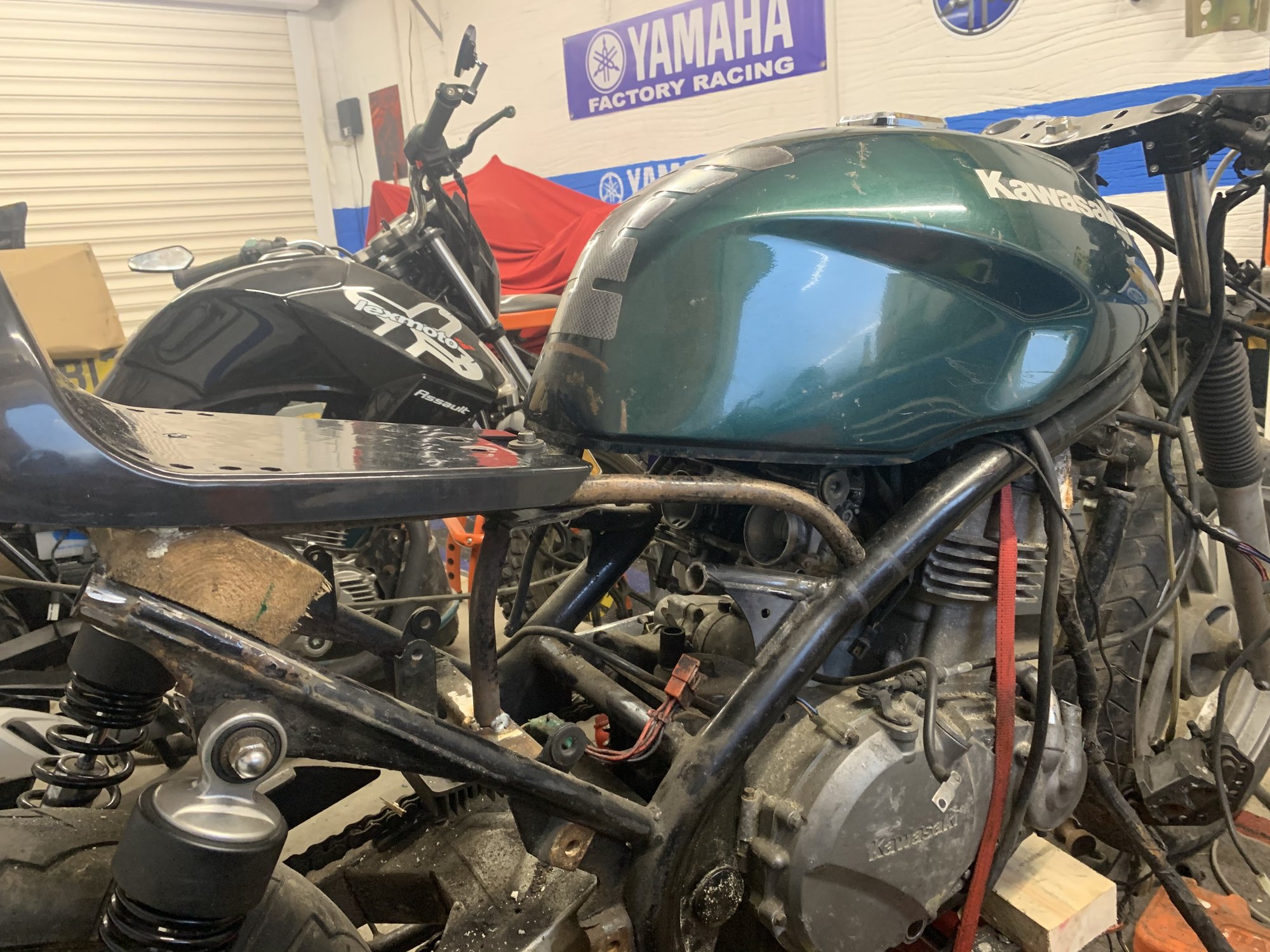

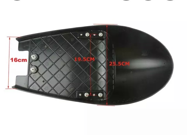

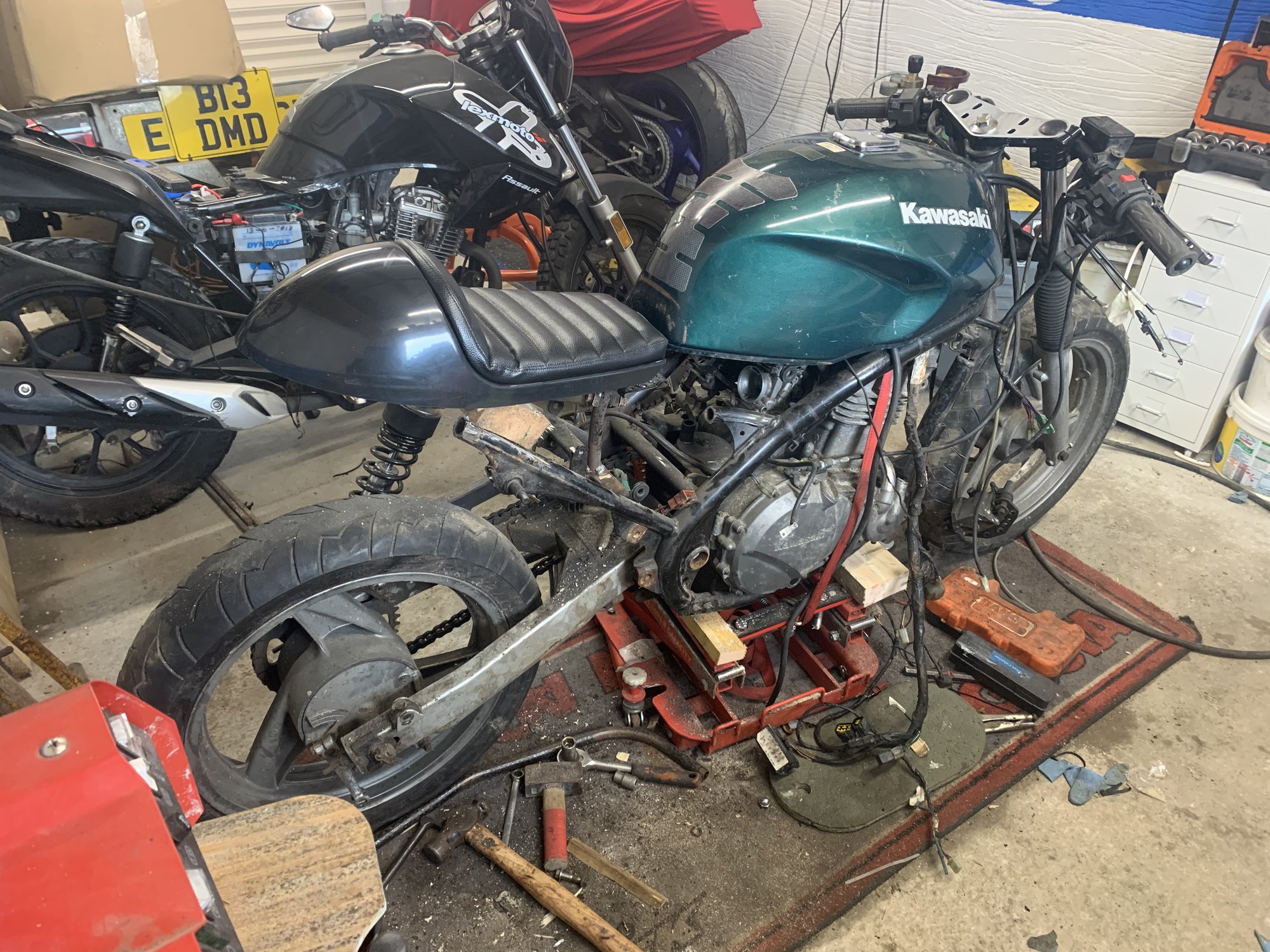

Depends on what look you want I suppose? A bit subjective that one............older CB50 tanks are quite long?...and quite expensive!! There's even a Chinese knock off of these, for the RD50 etc...Just google cafe racer tanks LOL...............the choice is endless...!!
CB50 tank might look a bit odd on a perimeter frame Chris......

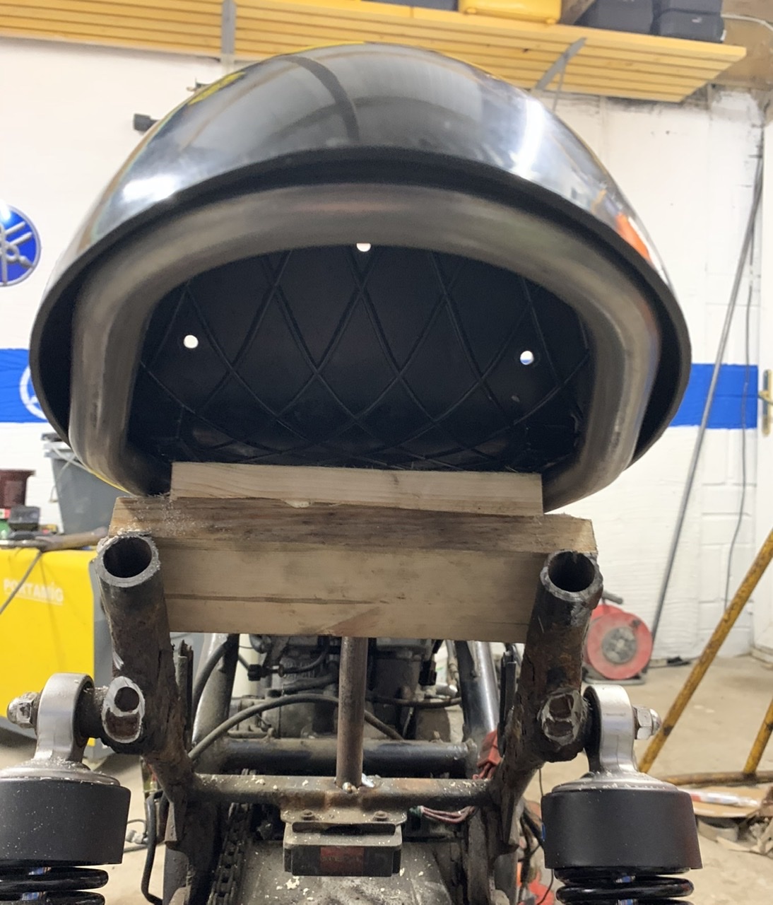

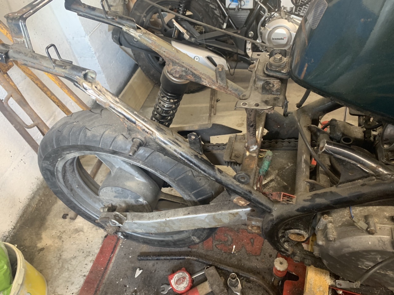

I would start by stripping all the rear bodywork off and sitting on the bike in the rough riding position, preferably with the bars you want to use fitted and something to rest your feet on to get a feel of where the rearsets will be. This should give you an idea where your **** will be and how the seat the seat unit is going to fit then look at the aesthetics, ie if the seat looks ok in respect of the rear wheel, tank height and shock mounts.
