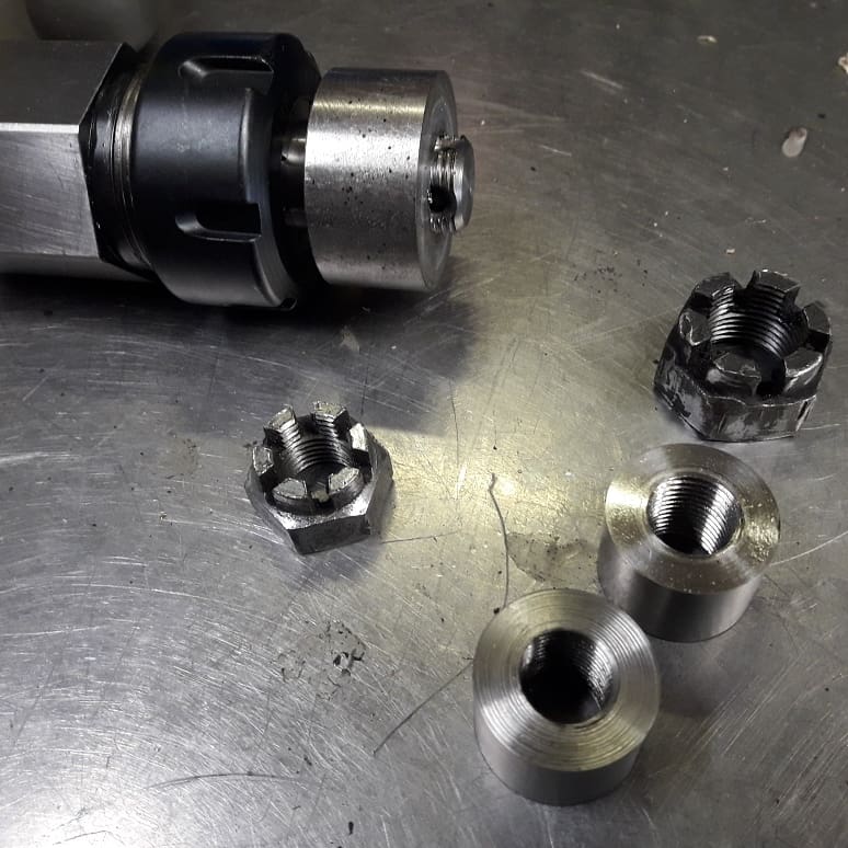

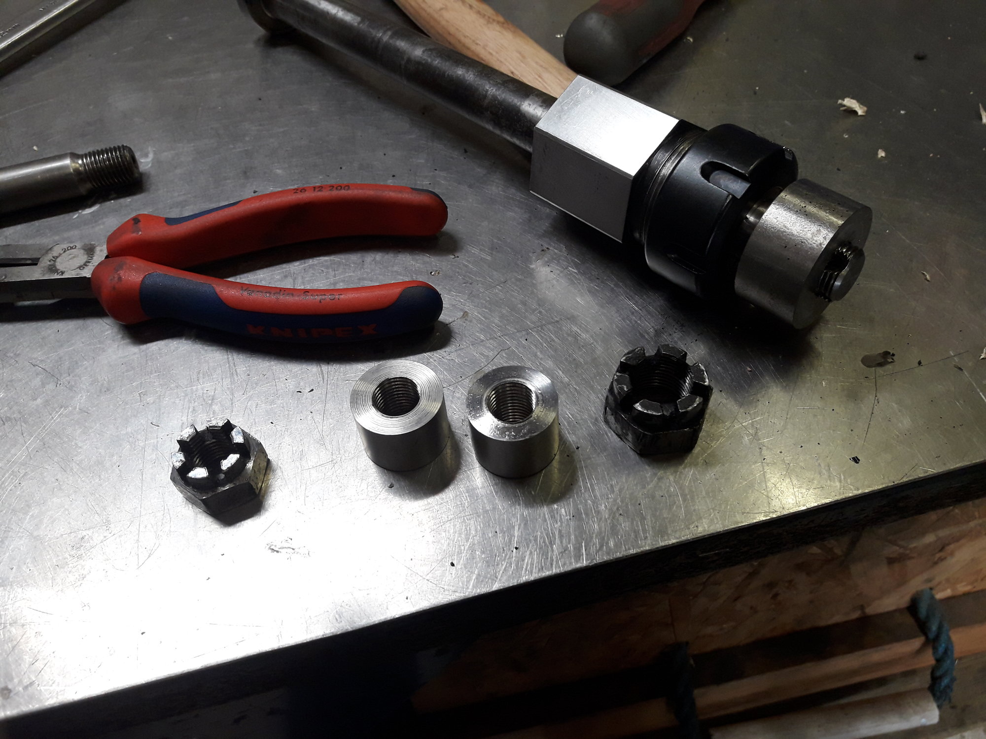

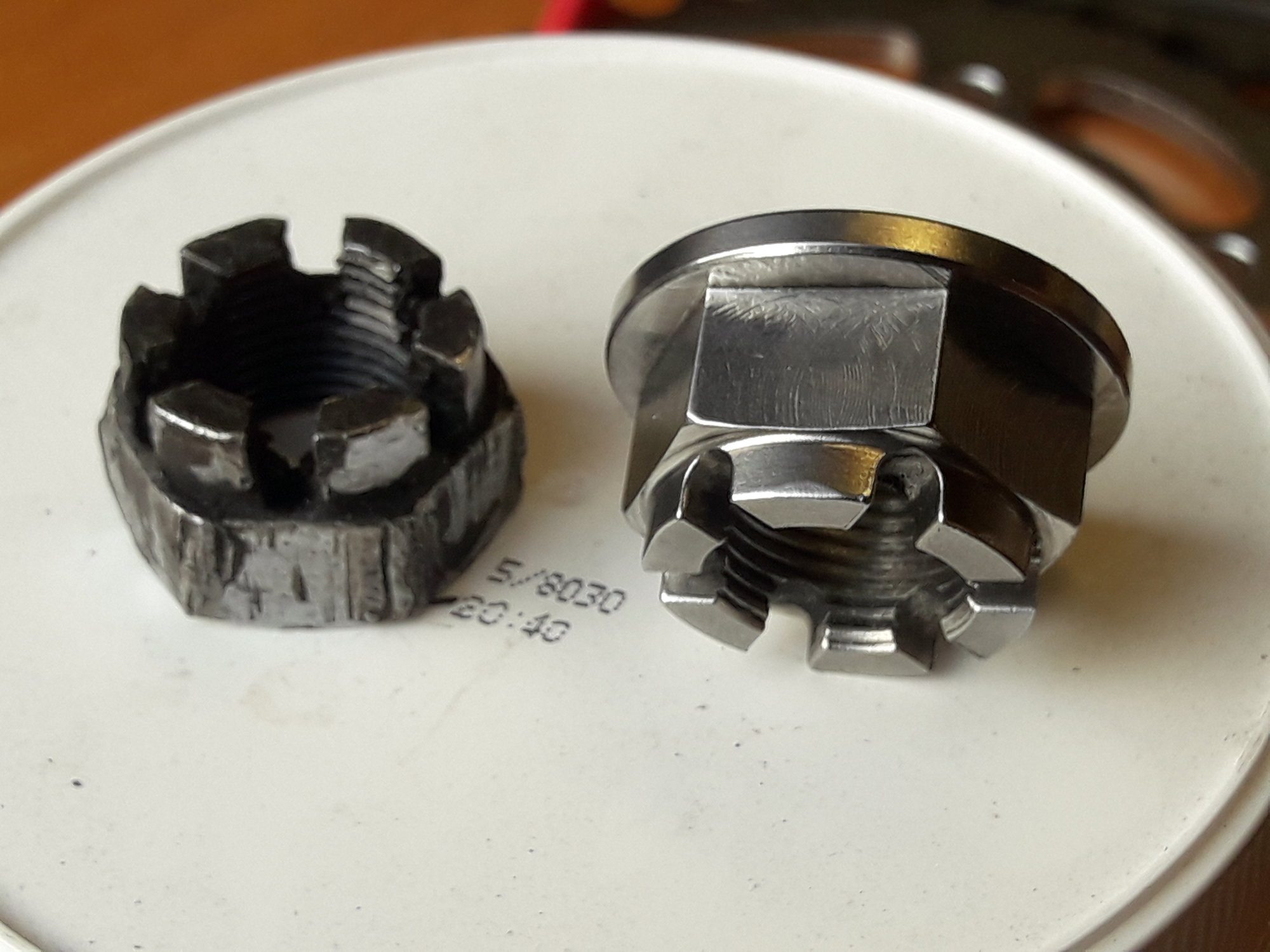

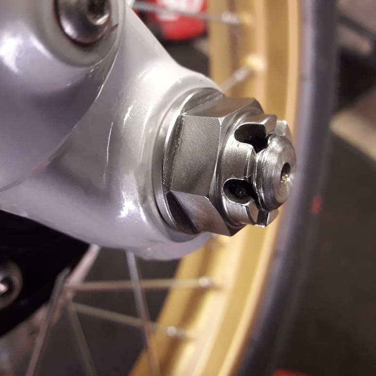

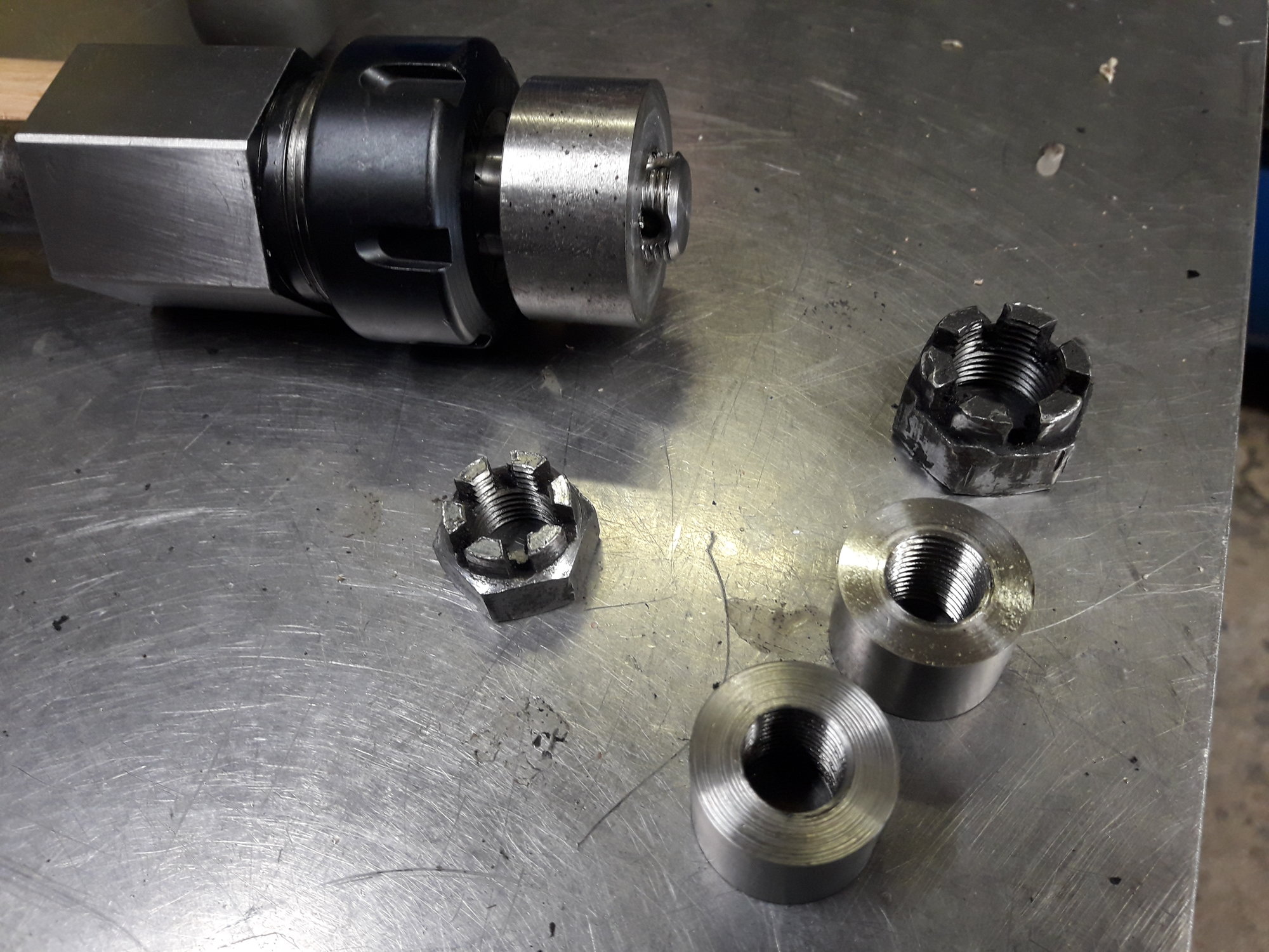

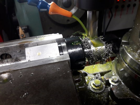

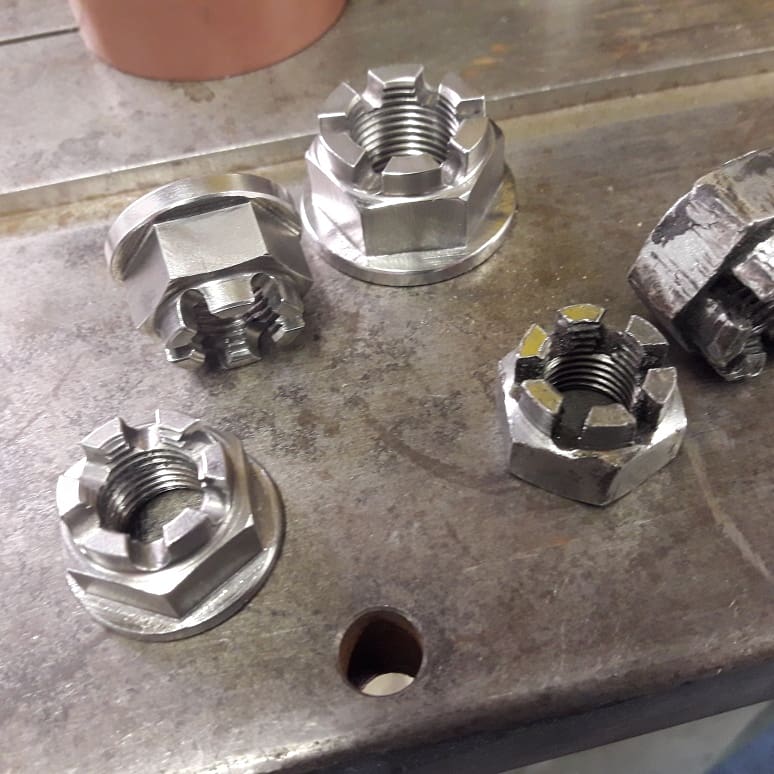

    no chocolate eggs today.....just nuts.....hand made stainless steel ones:whistle:

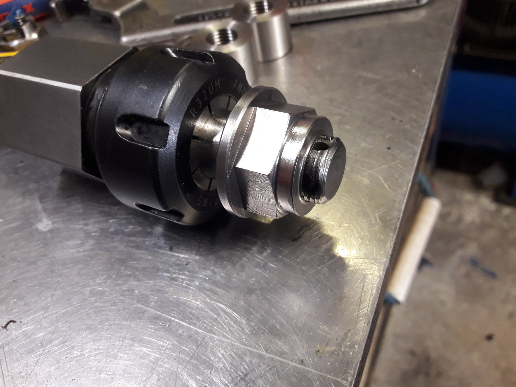

    Like the nuts, how did you index them in the chuck?

    I was thinking of making some castellated nuts out of lock nuts but this is just on another level.

    You can do I suppose. Quicker and easier to use a hexagonal er32 holder I got off aliexpress, you can see it in the picture above.

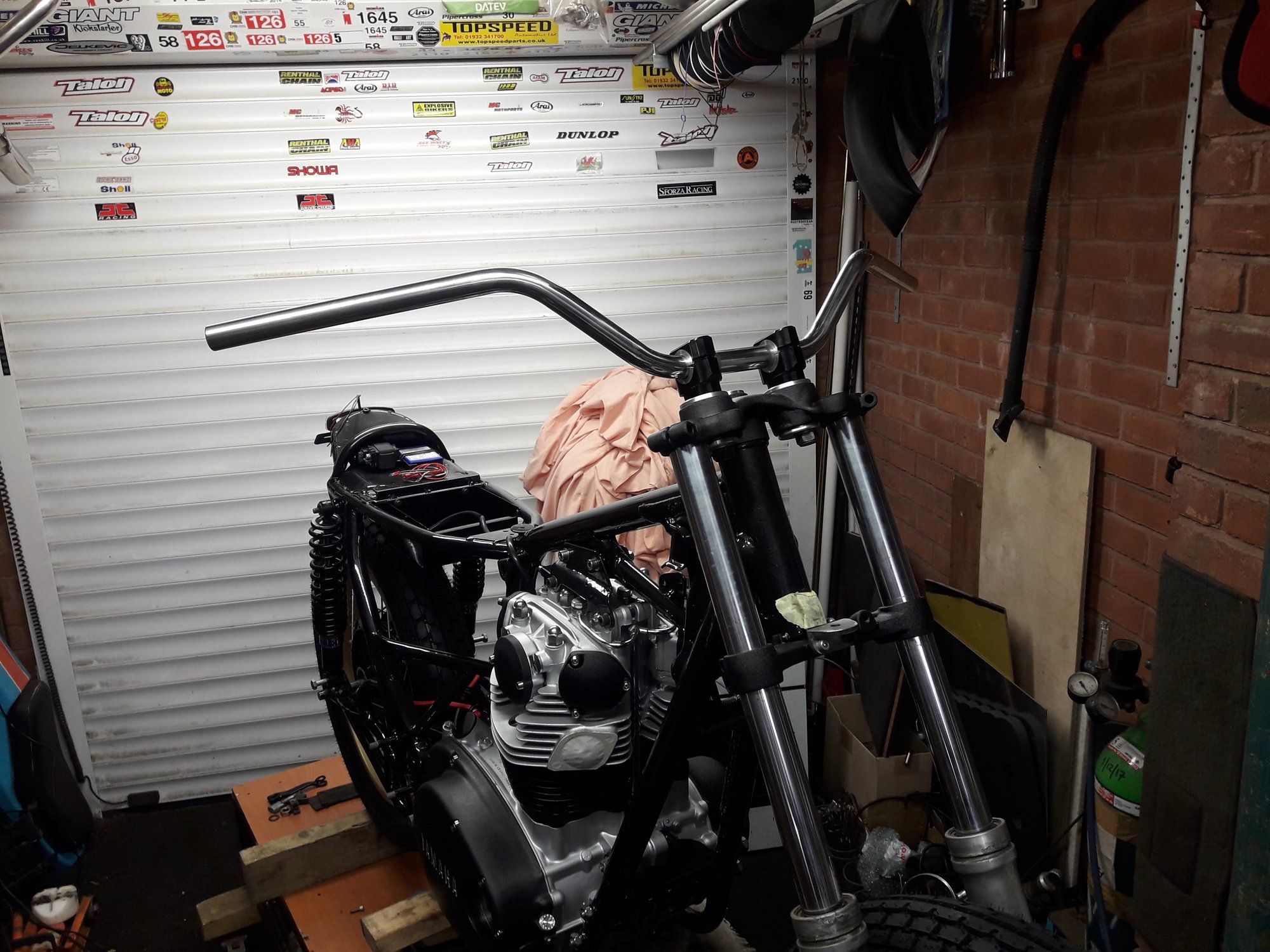

  6. lchris21
    lchris21 Member
    Messages:
    1,182
    Location:
    South Wales

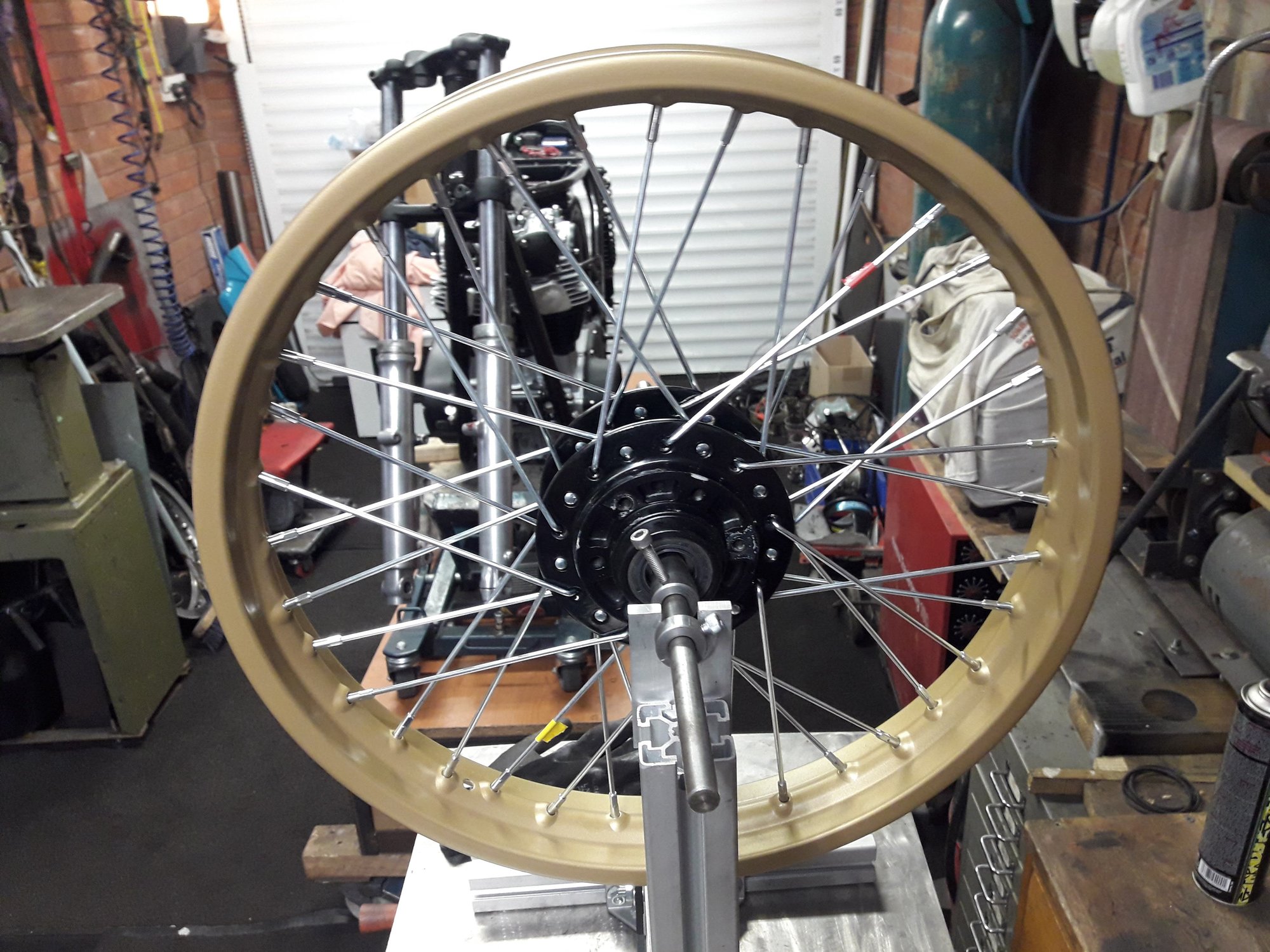

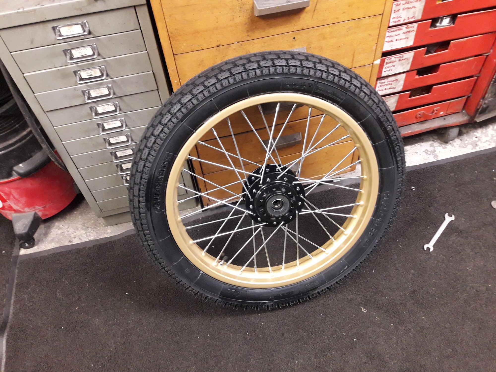

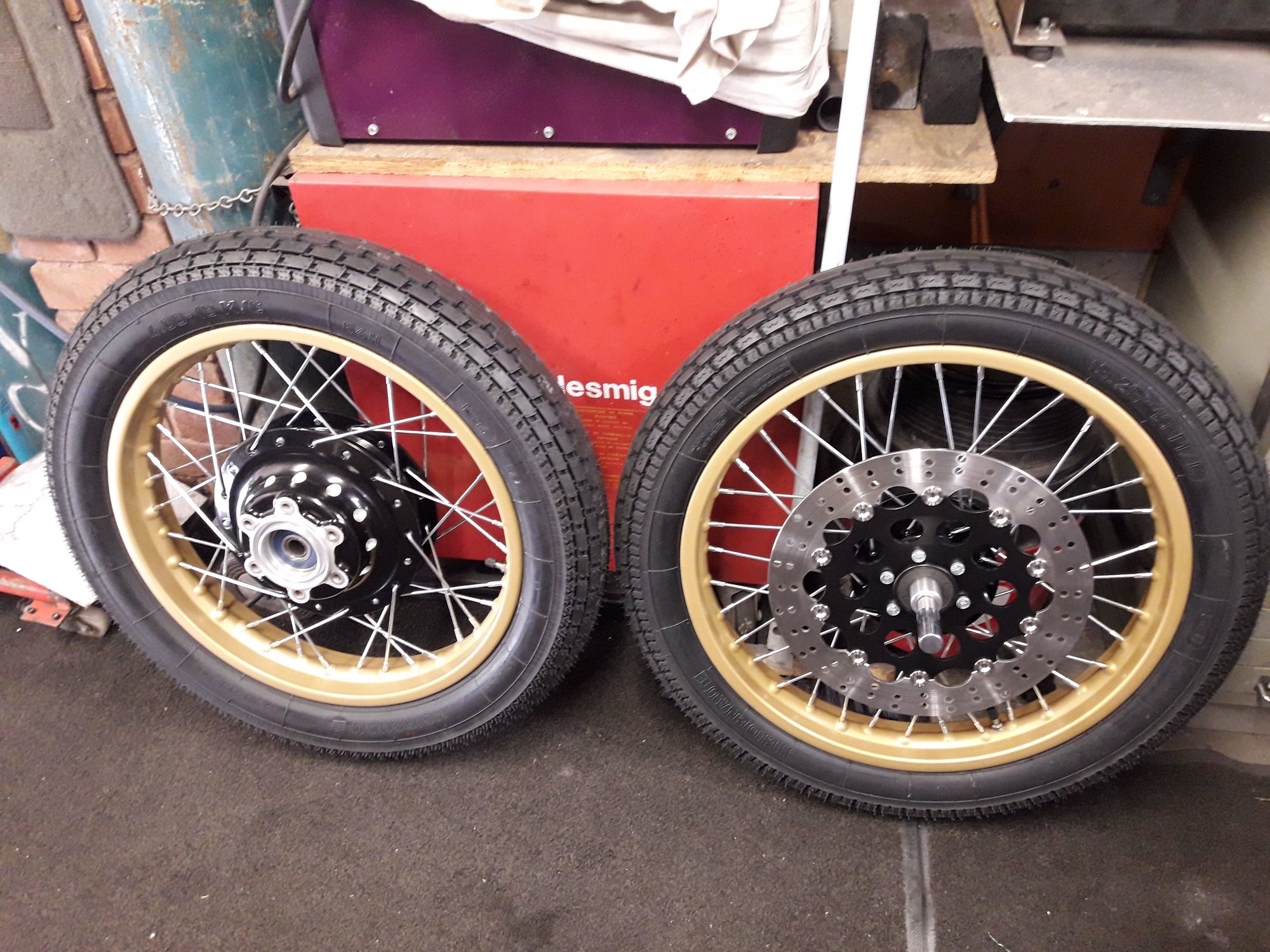

    Righto...where was I...:D

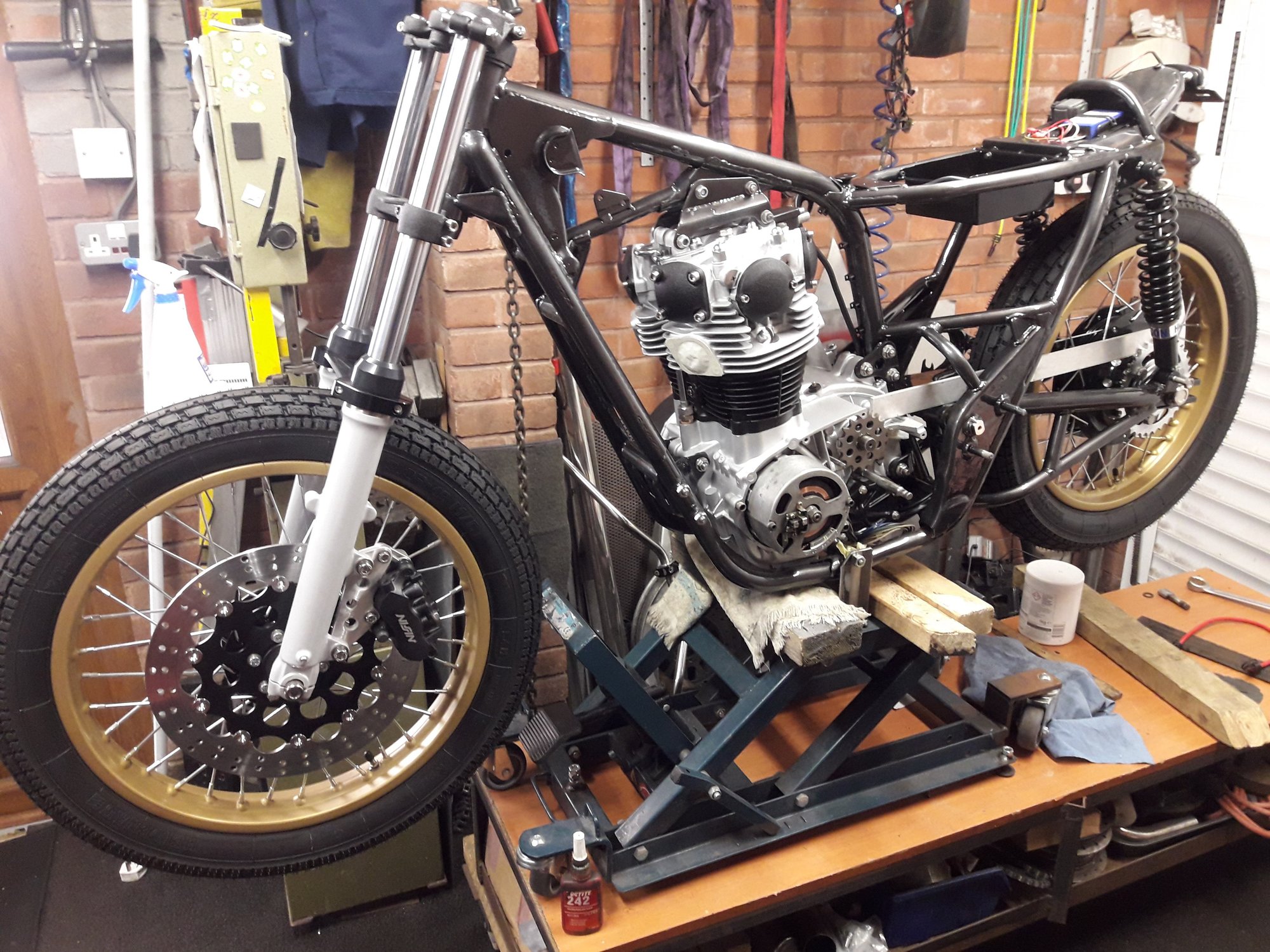

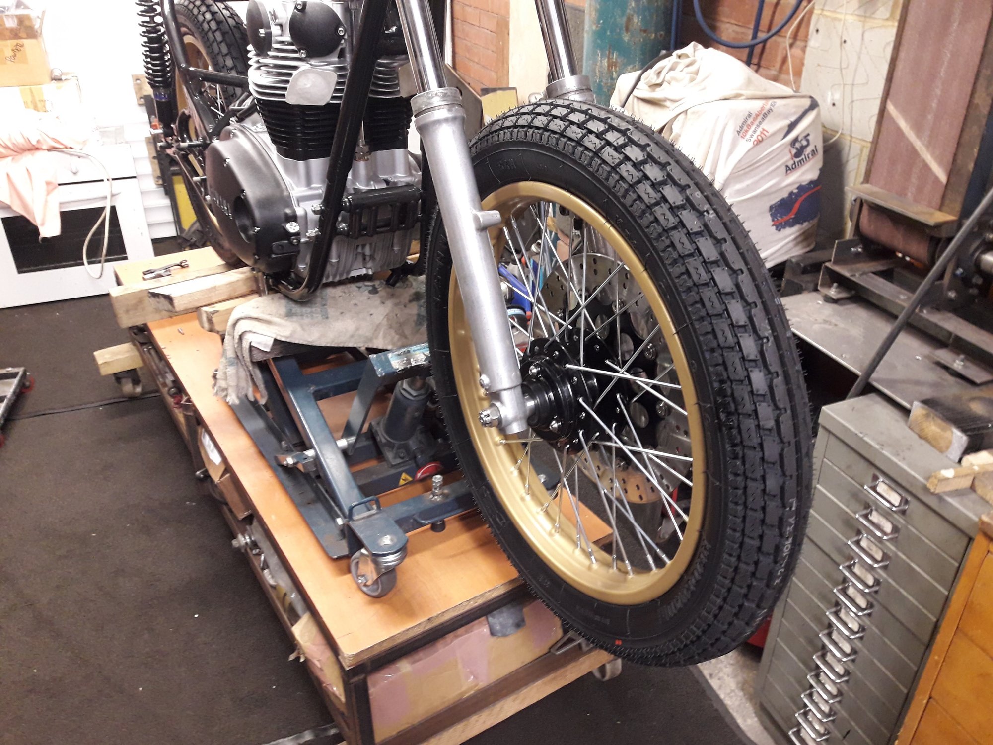

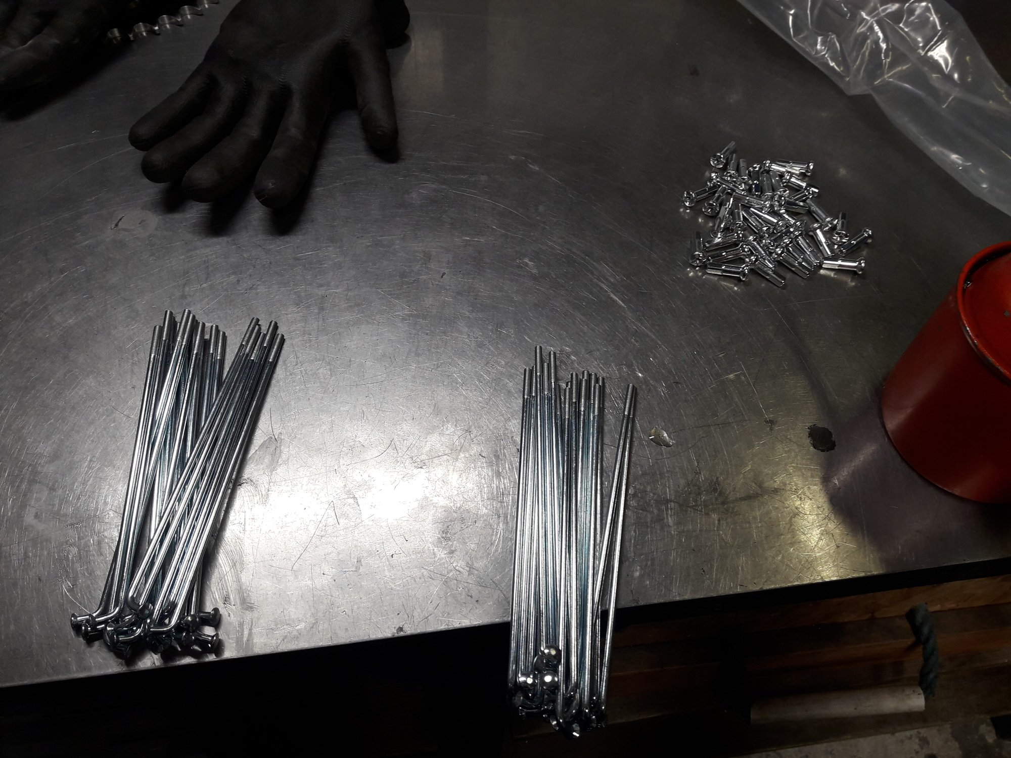

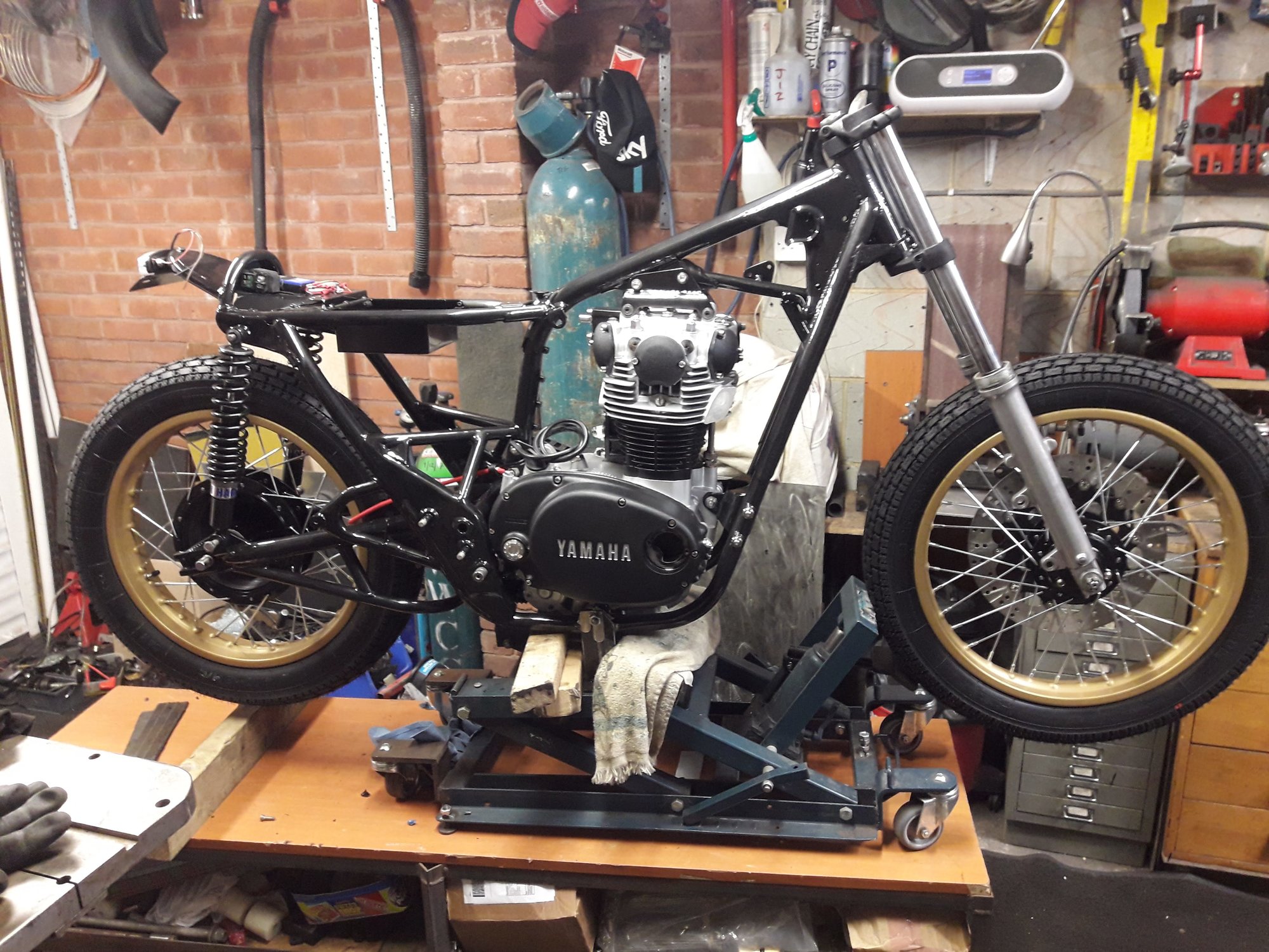

    Spring/Summer fun over....time to get back in the garage for the Autumn / Winter build season.......cant wait for them sub zero temps to come :o

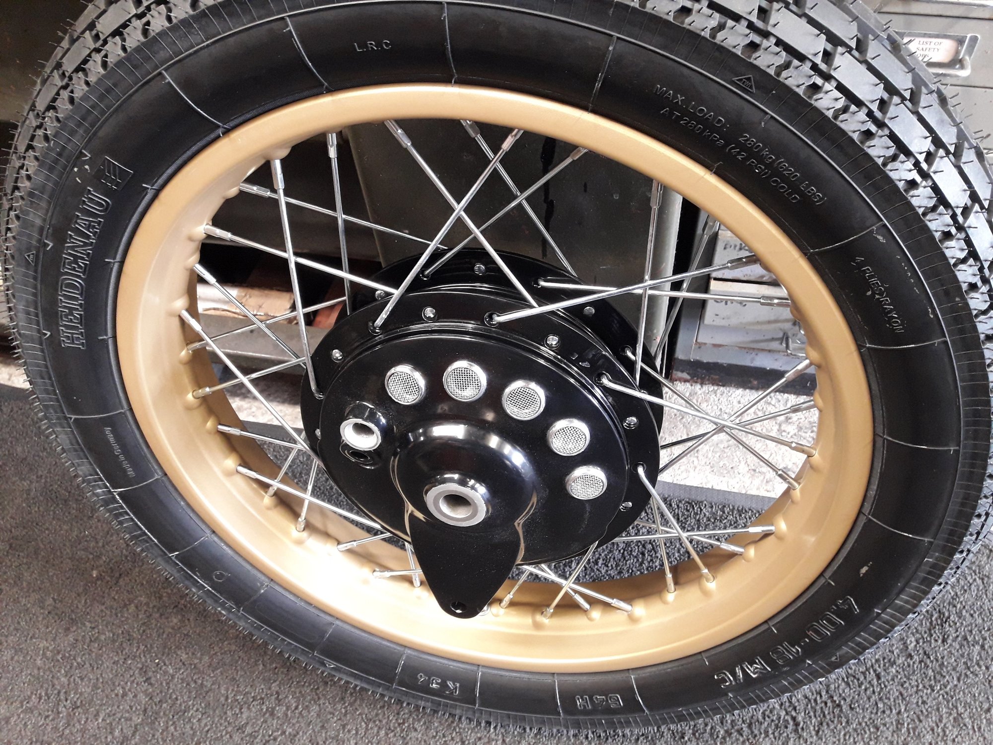

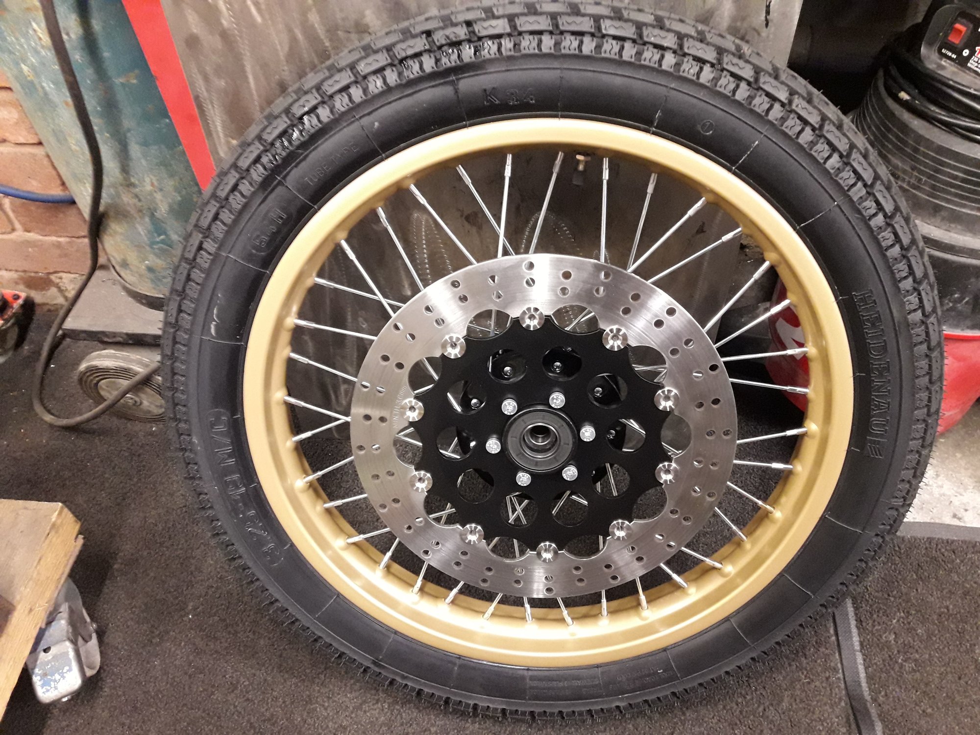

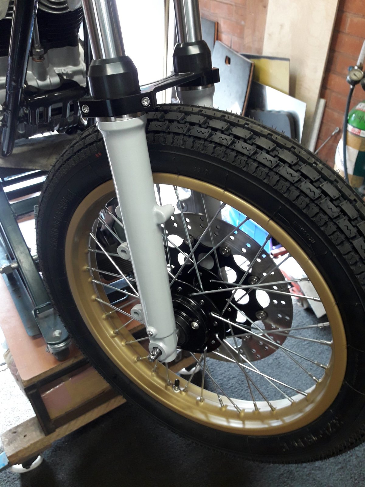

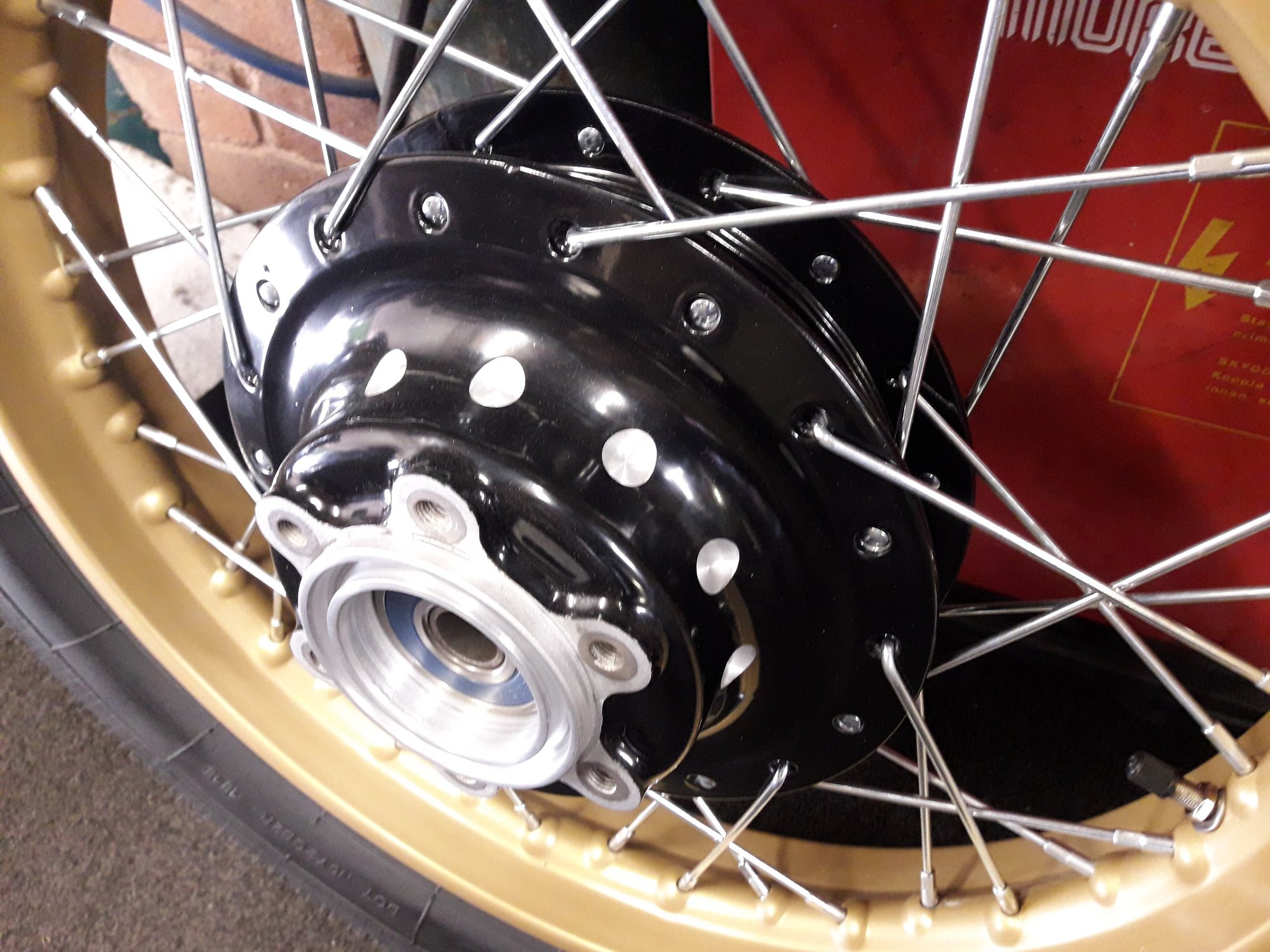

    Finished up back in May by putting the wheels back together with new spokes, bearings, tyres, tubes and seals etc.

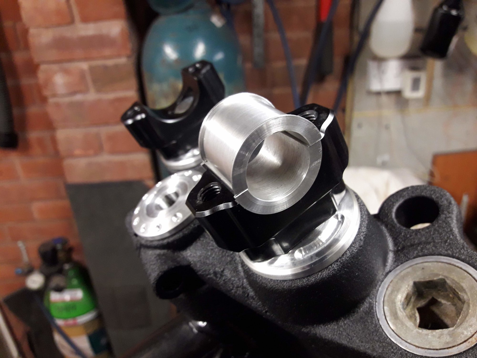

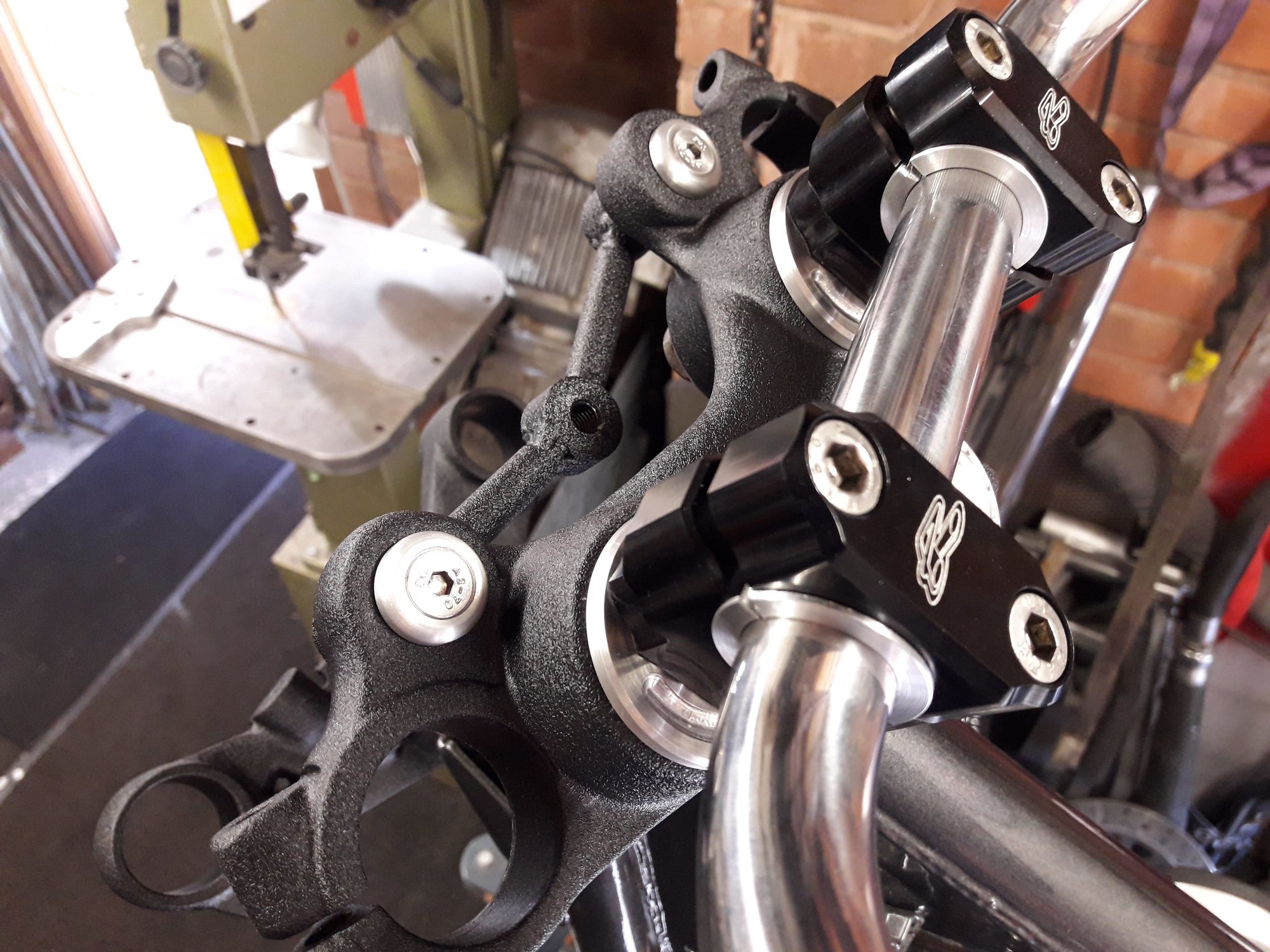

  7. lchris21
    lchris21 Member
    Messages:
    1,182
    Location:
    South Wales

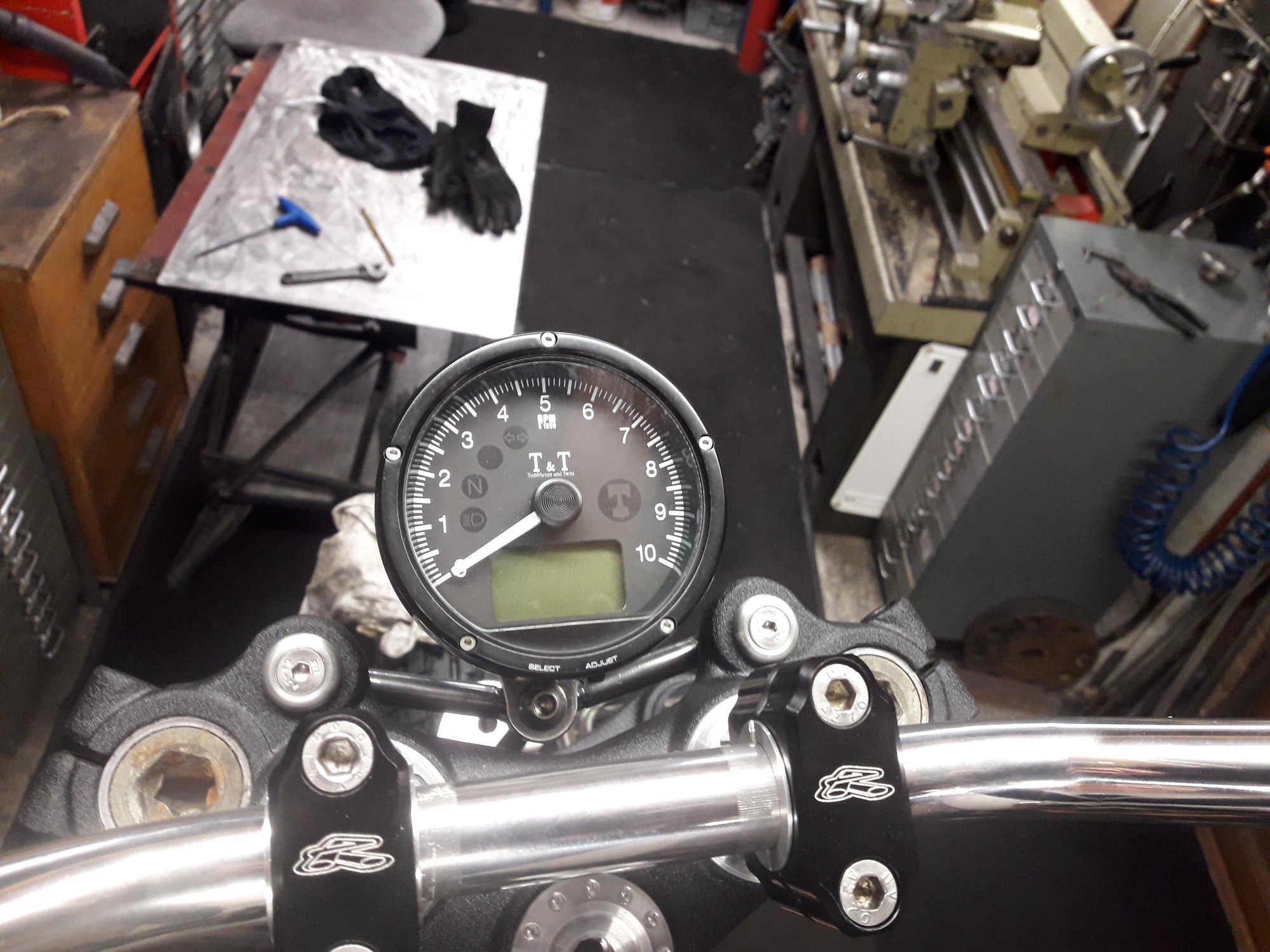

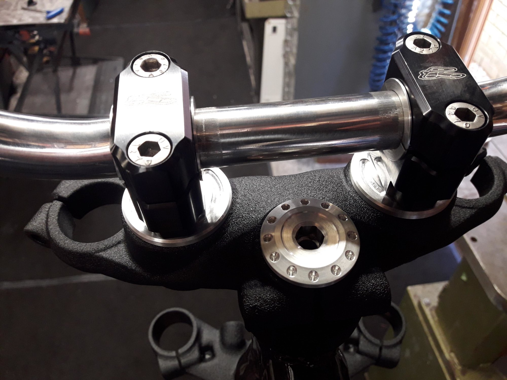

    Onto the handlebars.........:doh:

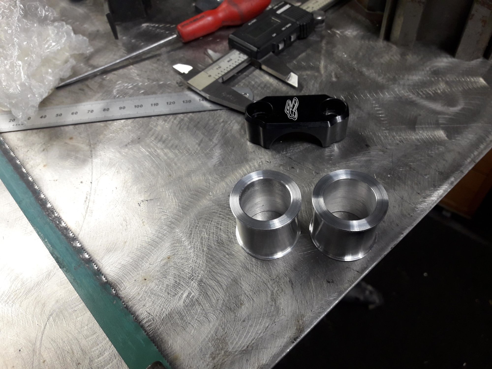

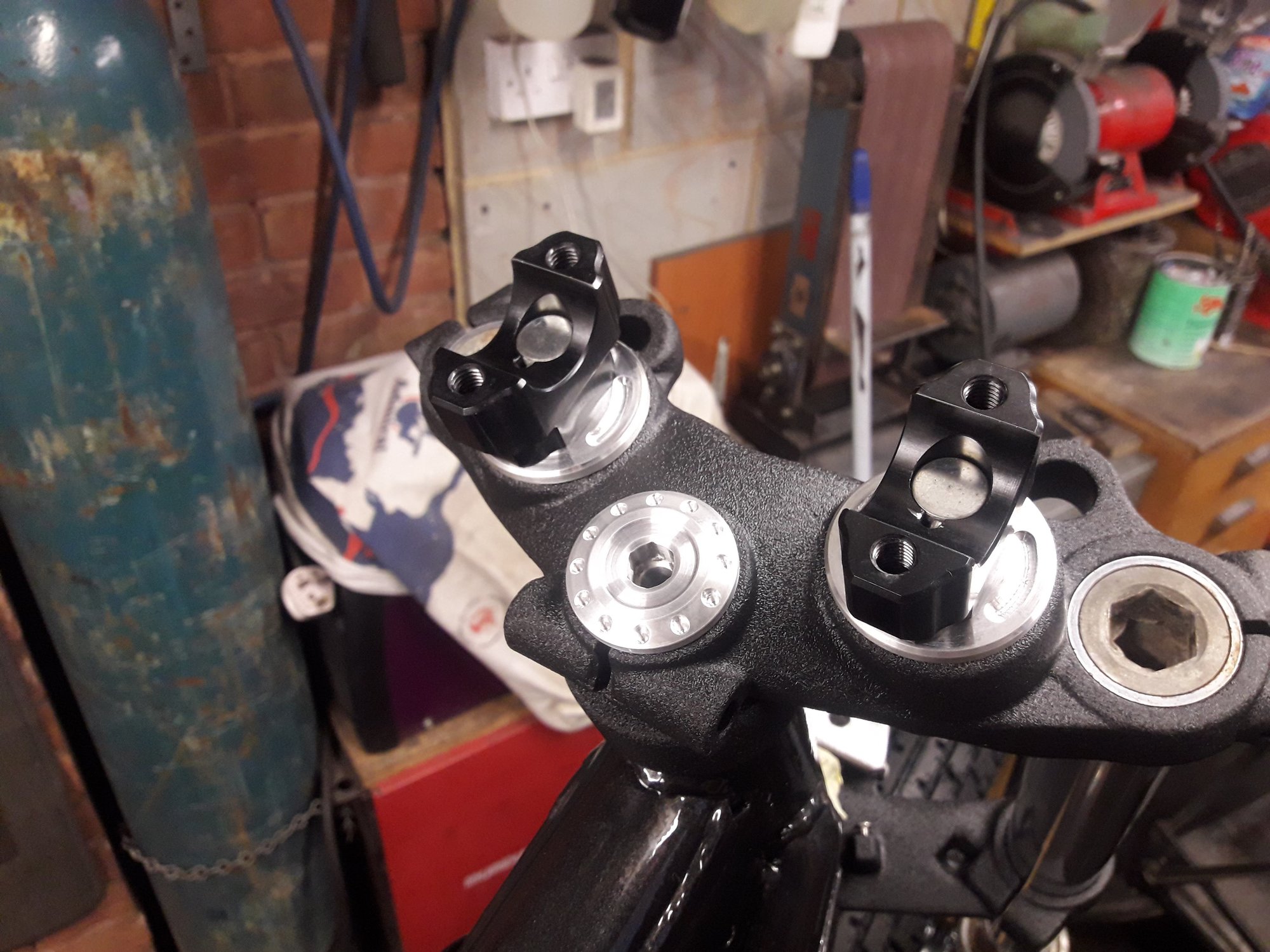

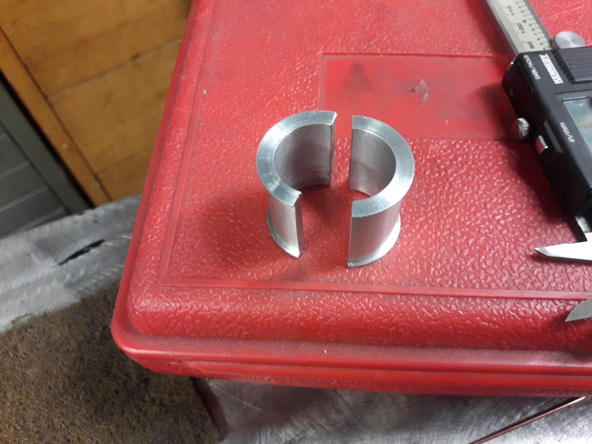

    Bars I ordered were smaller diameter than the Renthal clamps that came with the bike, so knocked up some split spacers.
    20190303_162246.jpg 20190303_162310.jpg 20190303_165803.jpg 20190303_165835.jpg 20190303_170047.jpg 20190303_171419.jpg
    zx9, slim_boy_fat, Exuptoy and 4 others like this.

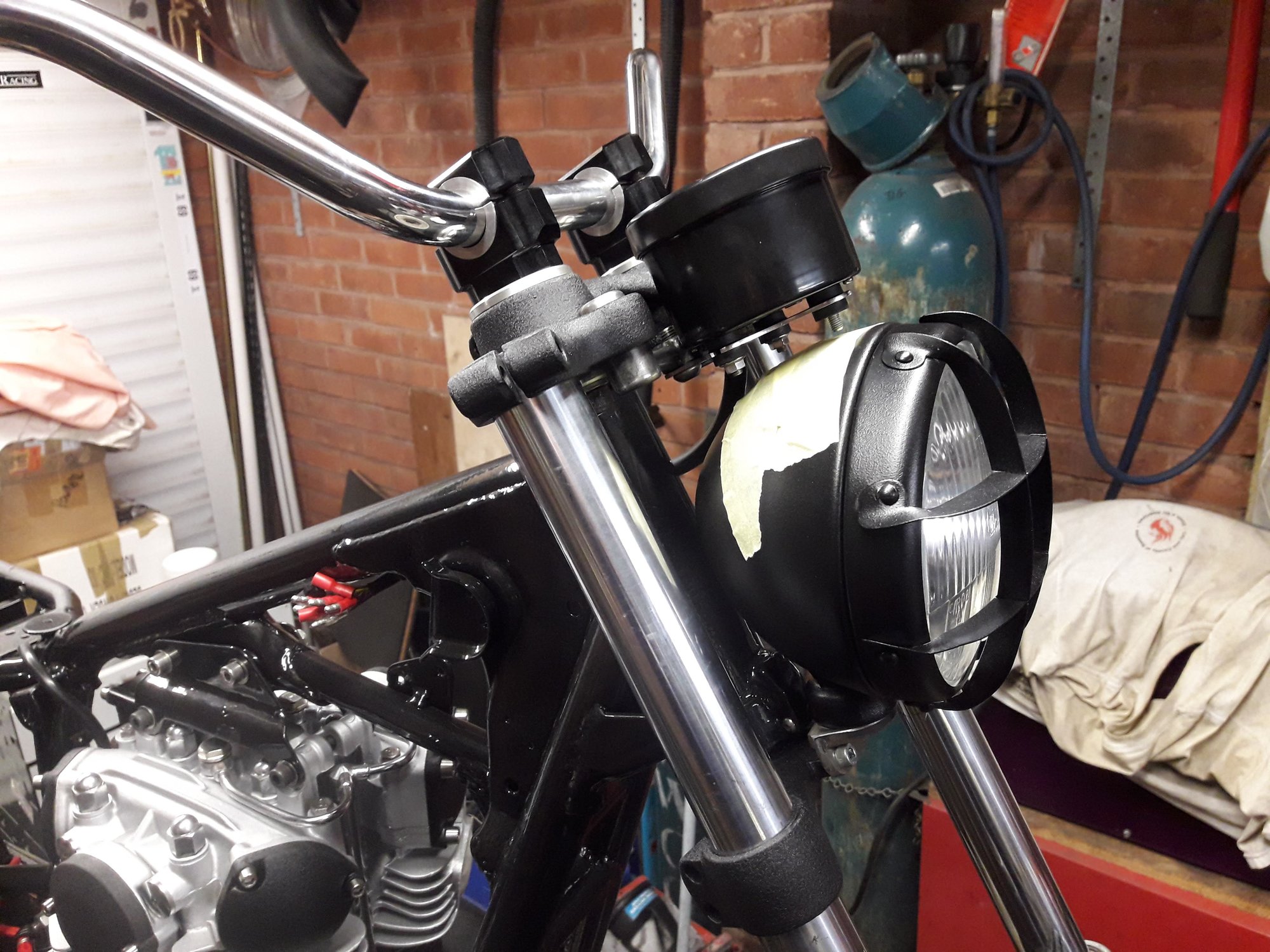

    Next up....speedo bracket.

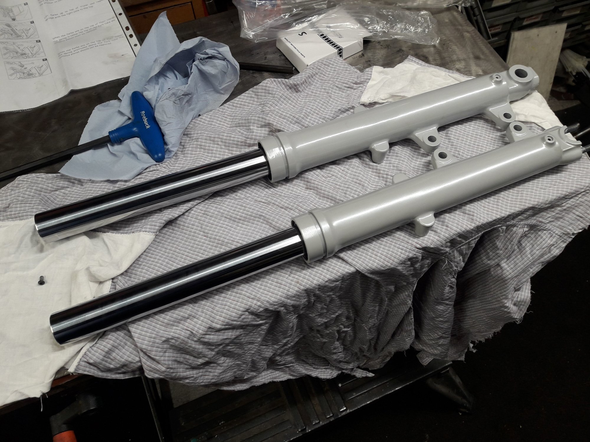

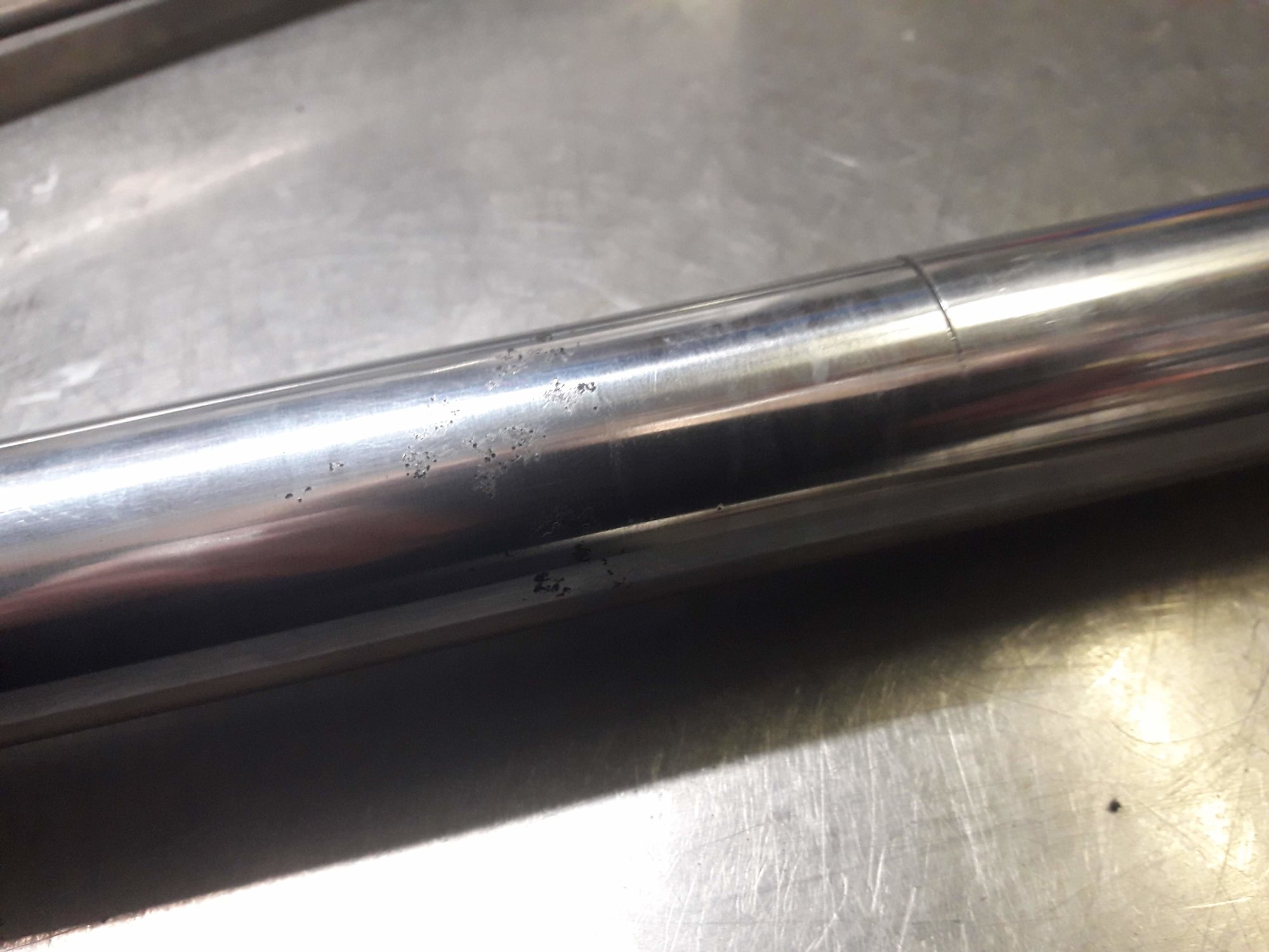

  10. lchris21
    lchris21 Member
    Messages:
    1,182
    Location:
    South Wales

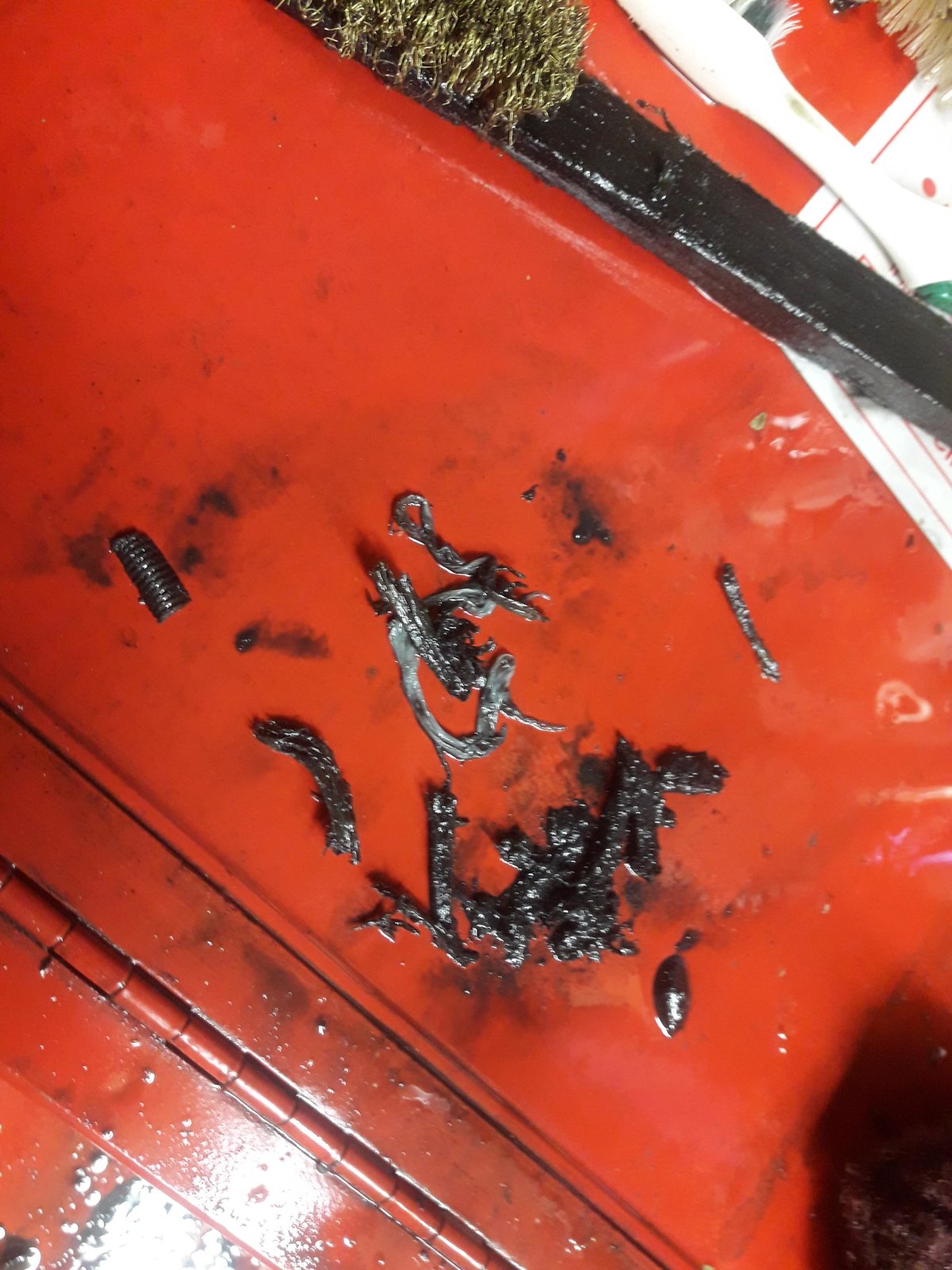

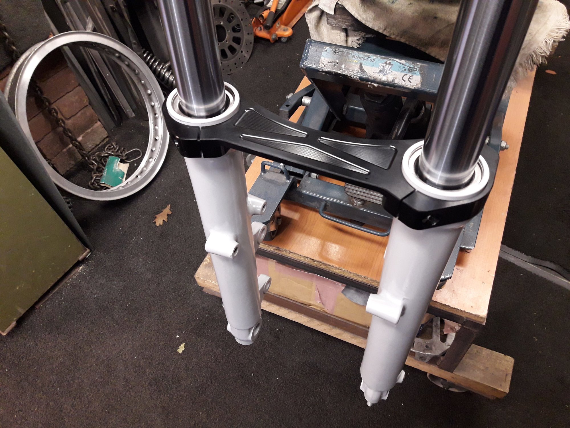

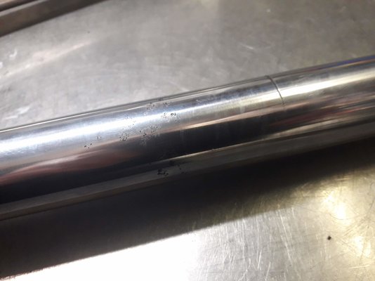

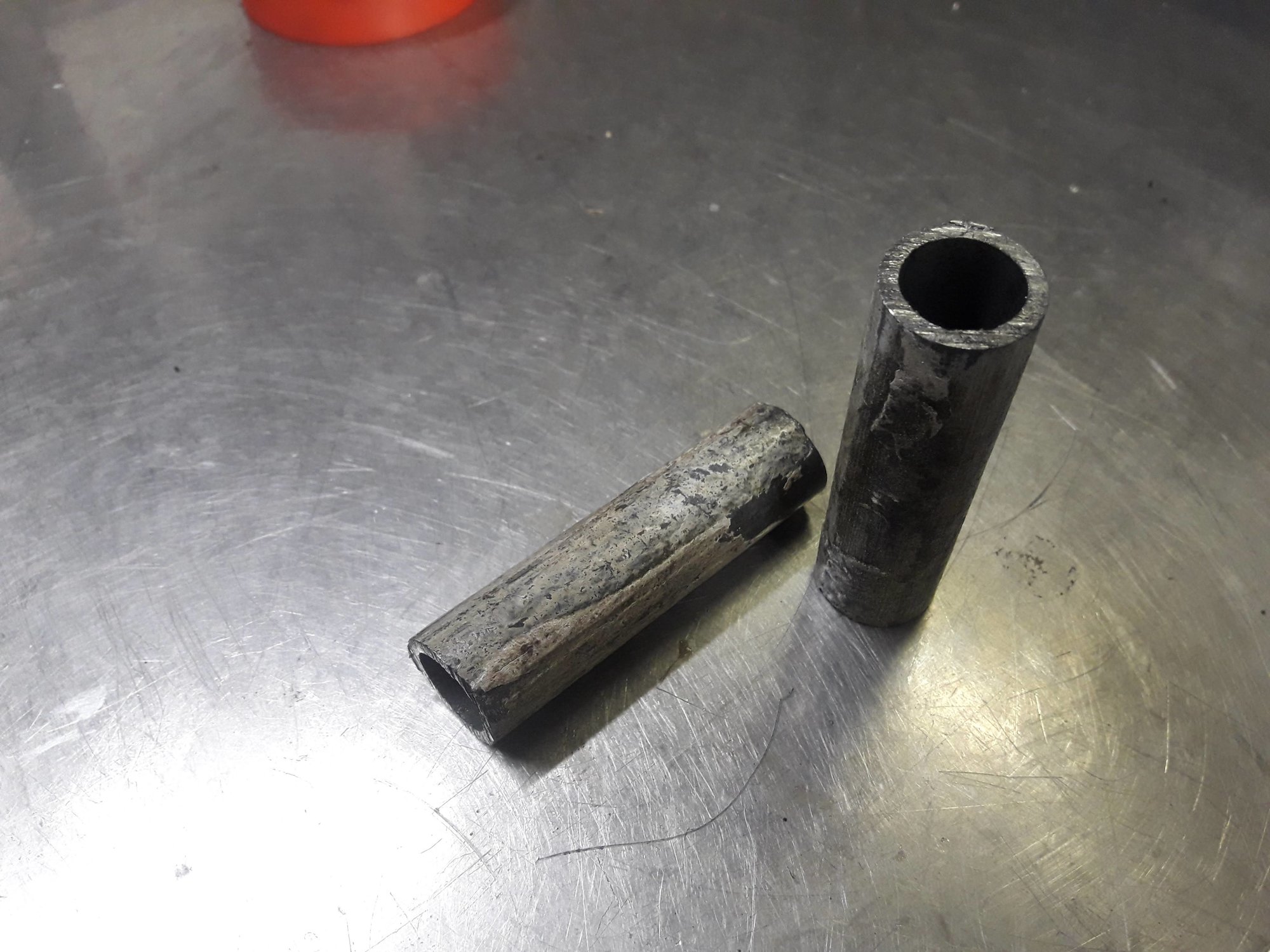

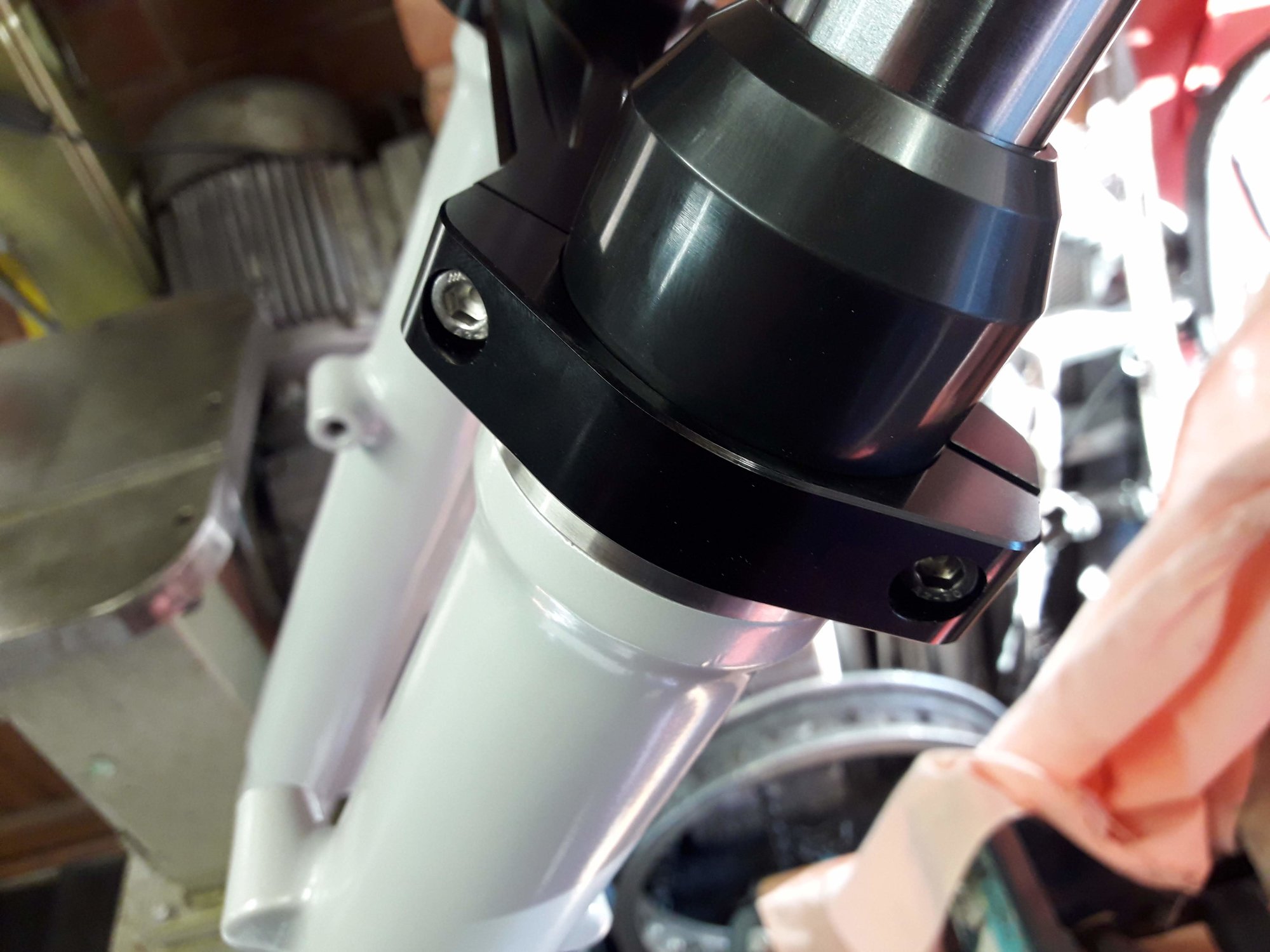

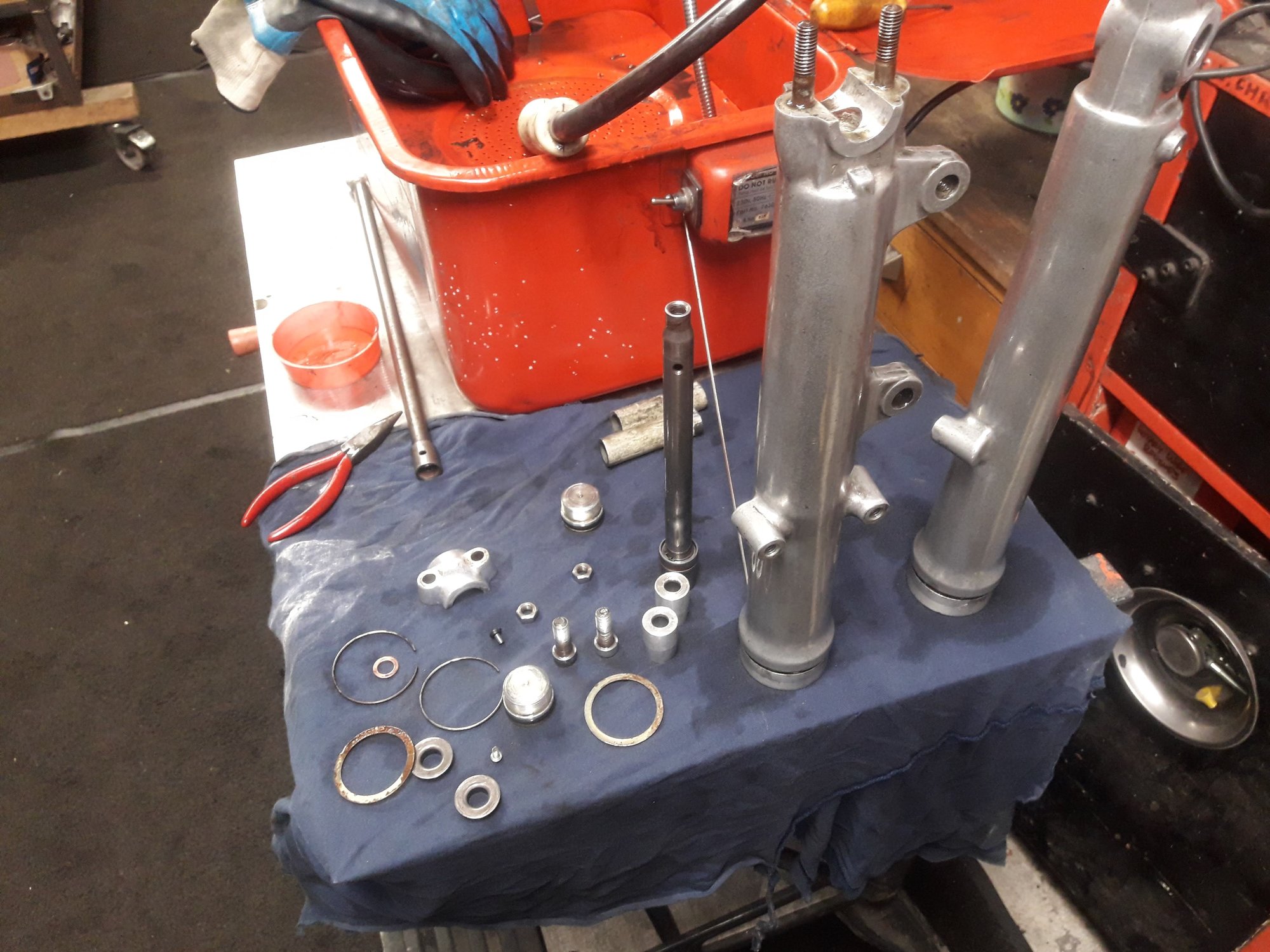

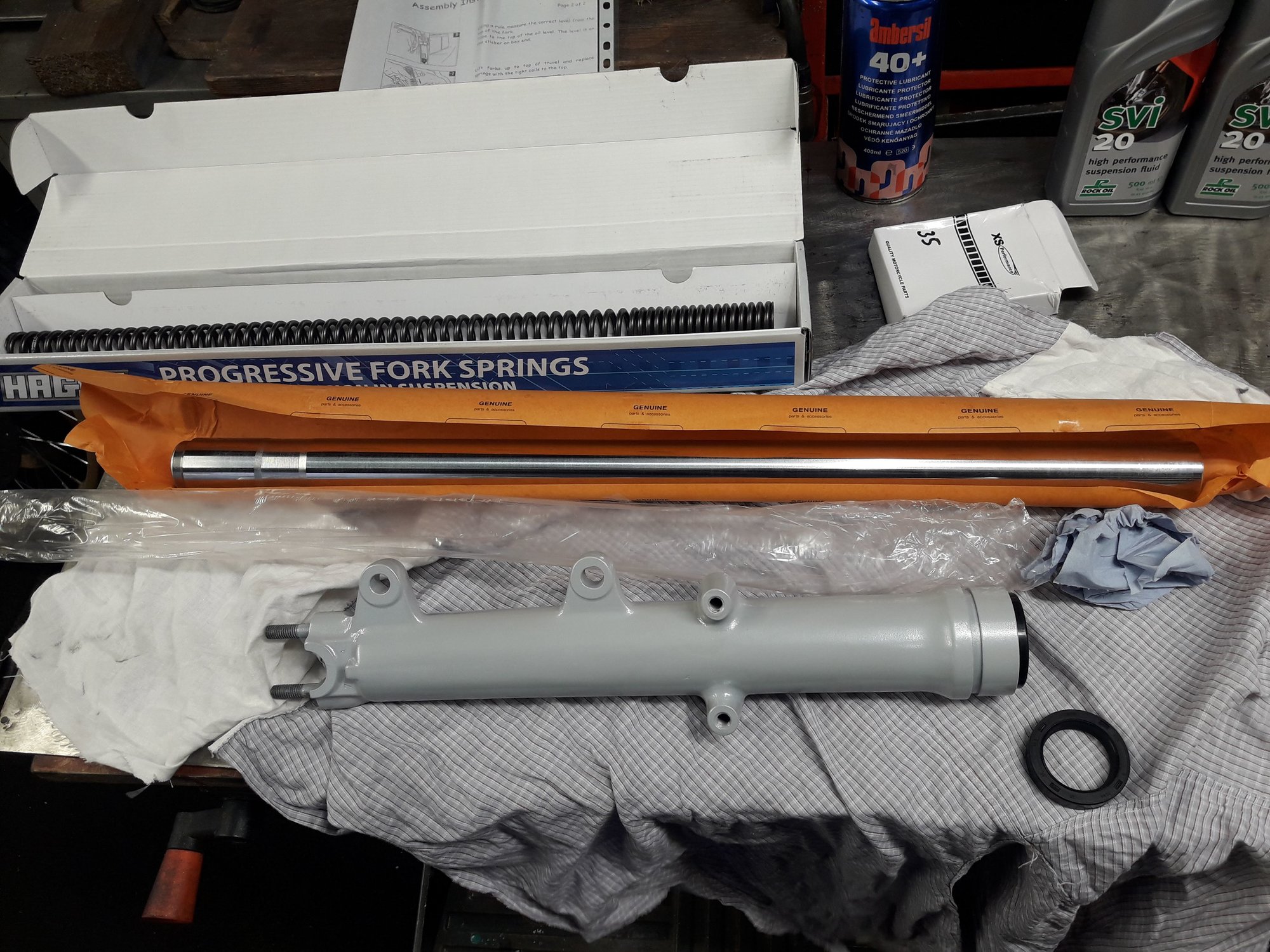

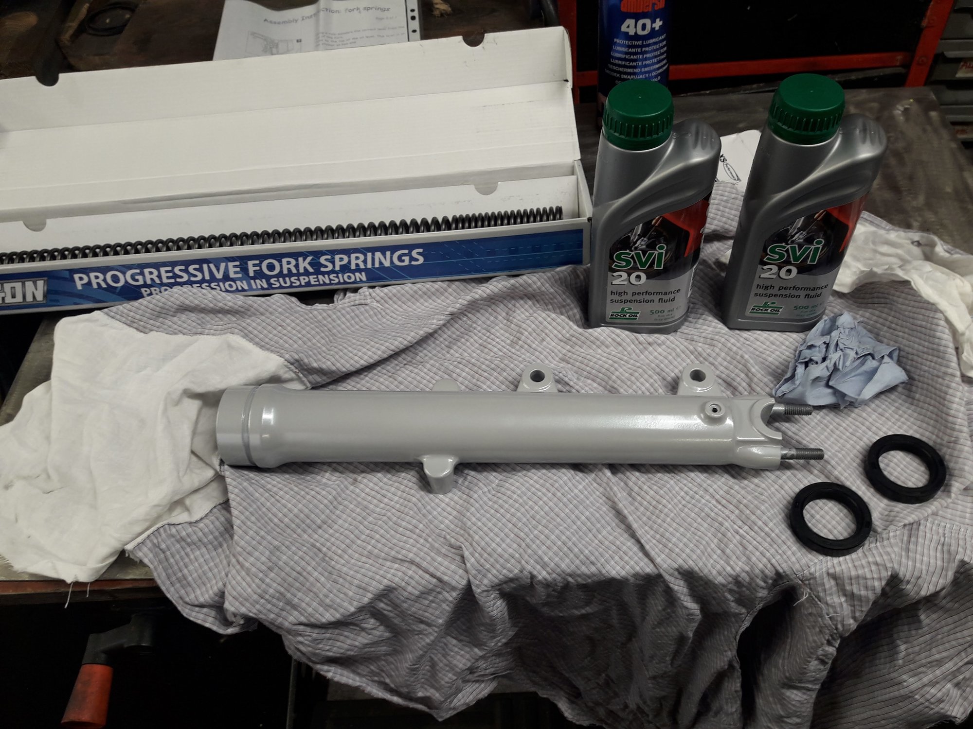

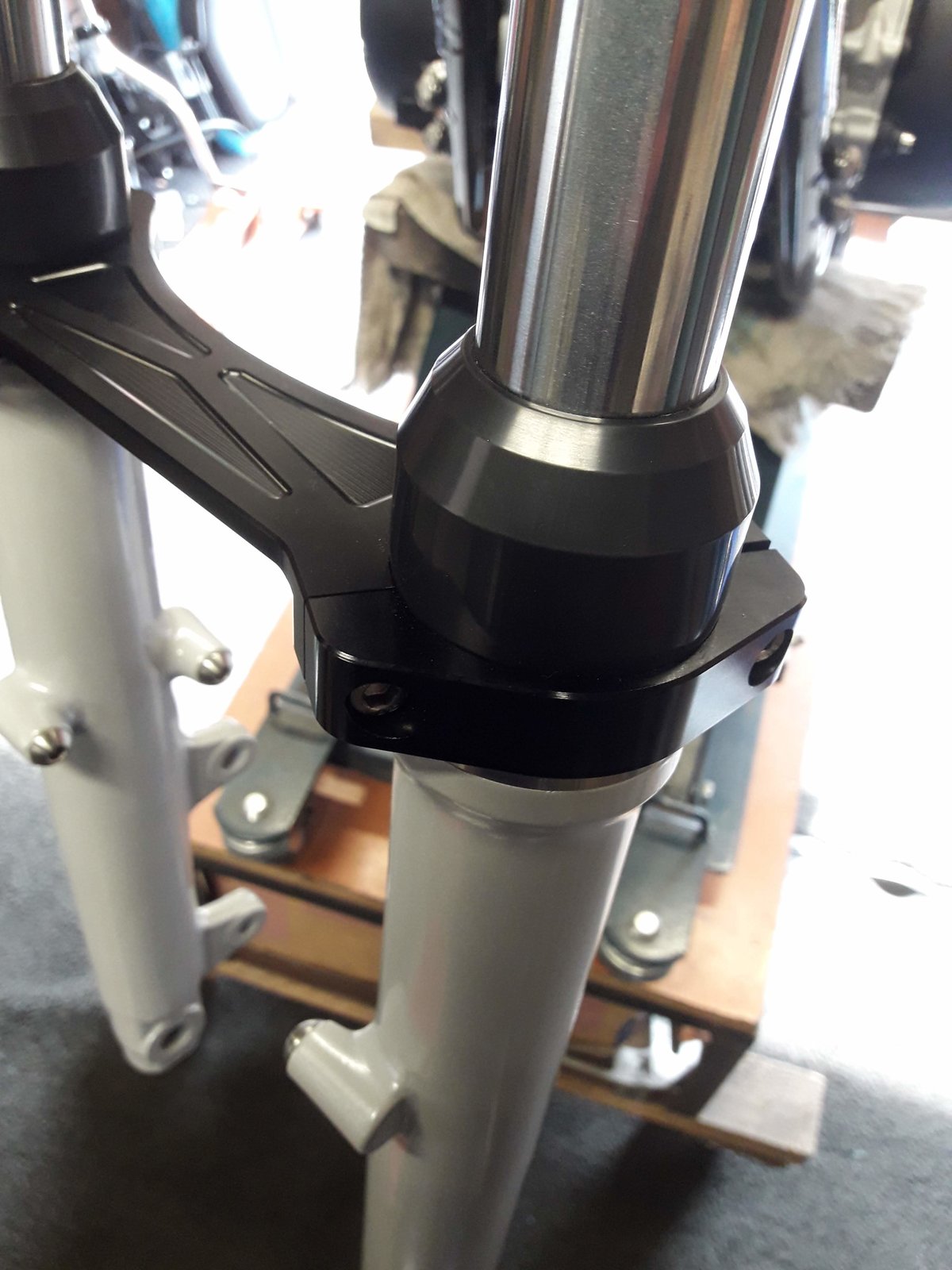

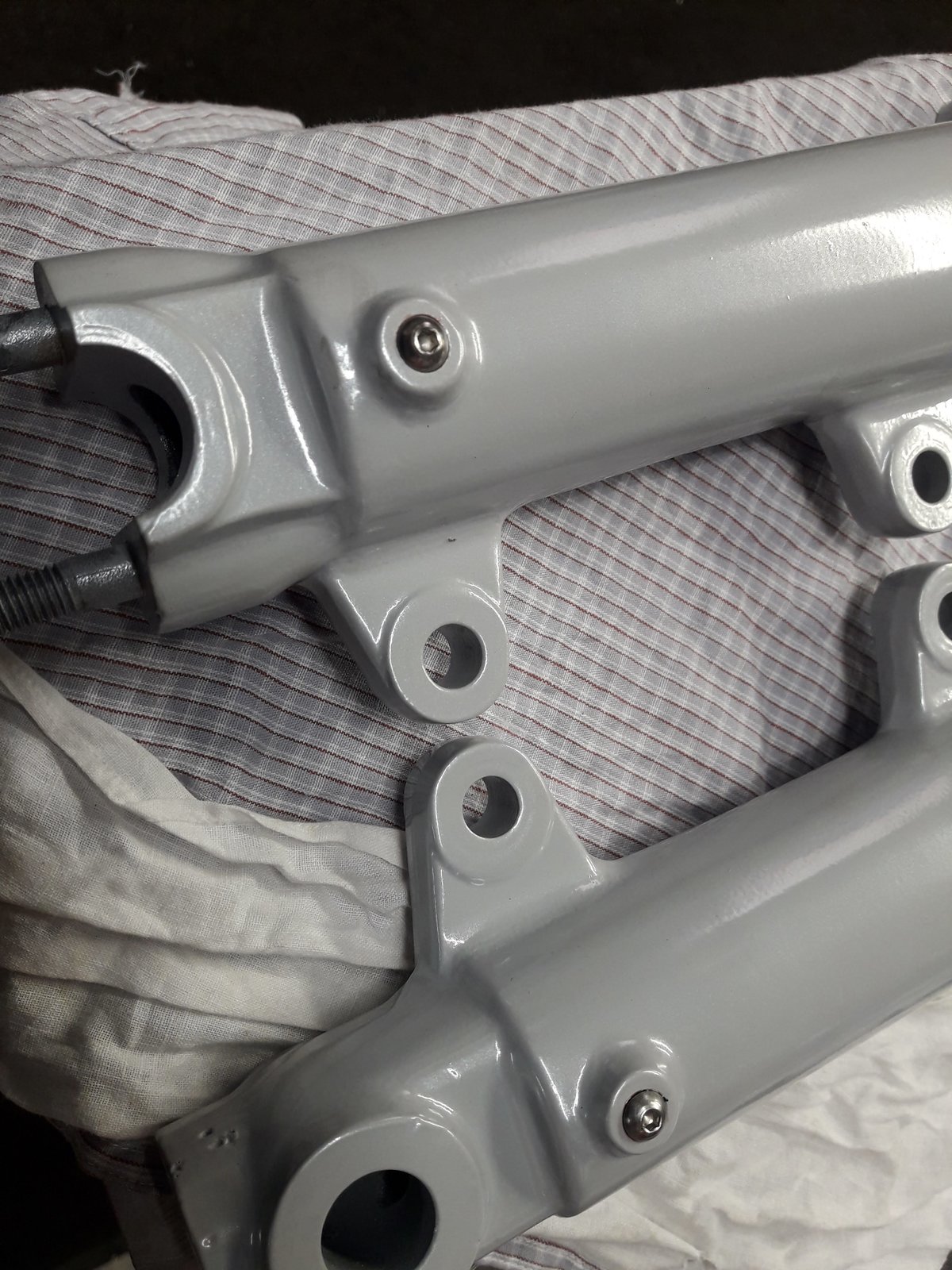

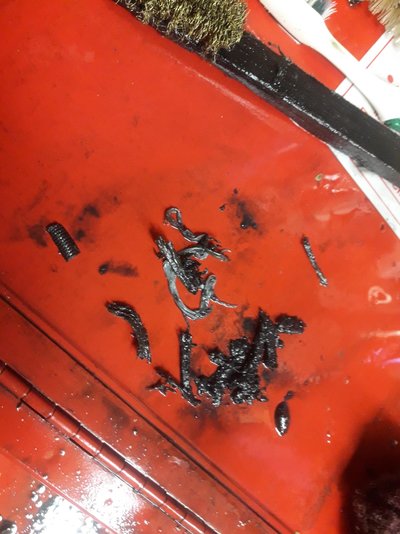

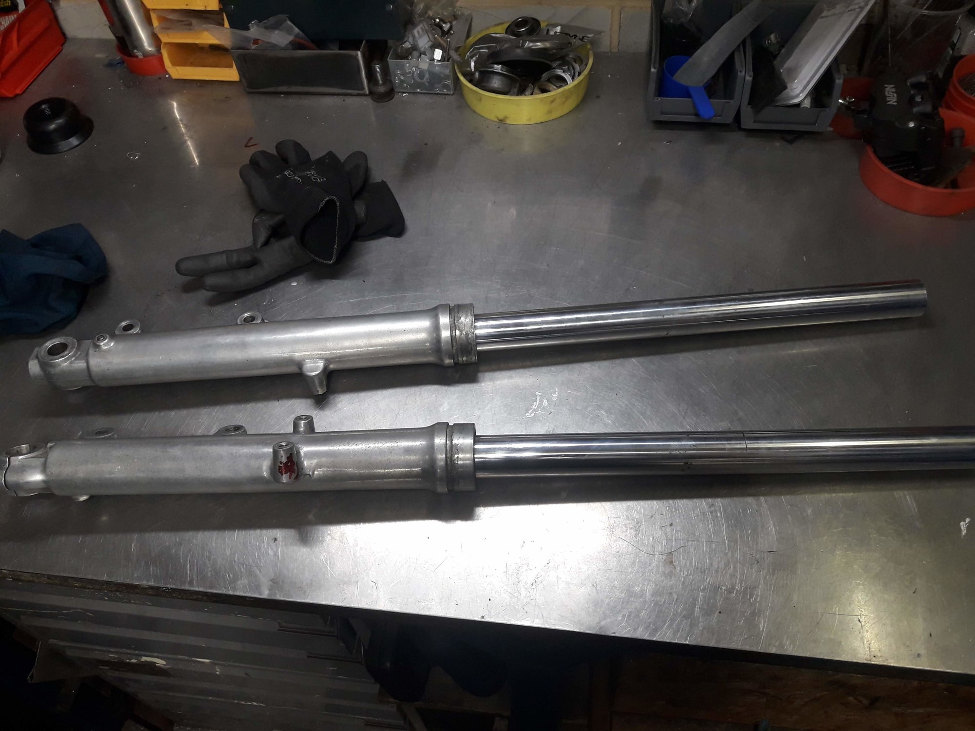

    Front end suspension for a bit of TLC next. The fork stanchions, although not leaking were fairly pitted and looking a bit tired. Complete strip don required, new parts ordered. Alloy bits powdercoated and rebuilt. When I was stripping down I found a couple of roughly sawn "preload" spacers made out of pipe inside, plus a lot of debris :whistle:
    New progressive springs sorted that problem out, and nice CNC brace all the way from Thailand finished it off. Need to sort out some dust covers and machine some adapter as way of fixing them in place.
    20190316_114722.jpg 20190316_114743.jpg 20190316_120335.jpg 20190316_144151.jpg 20190316_144212.jpg 20190324_161620.jpg 20190324_161816.jpg 20190324_165643.jpg 20190324_165916.jpg 20190324_174246.jpg
    Exuptoy, magicgrotto, Wallace and 2 others like this.

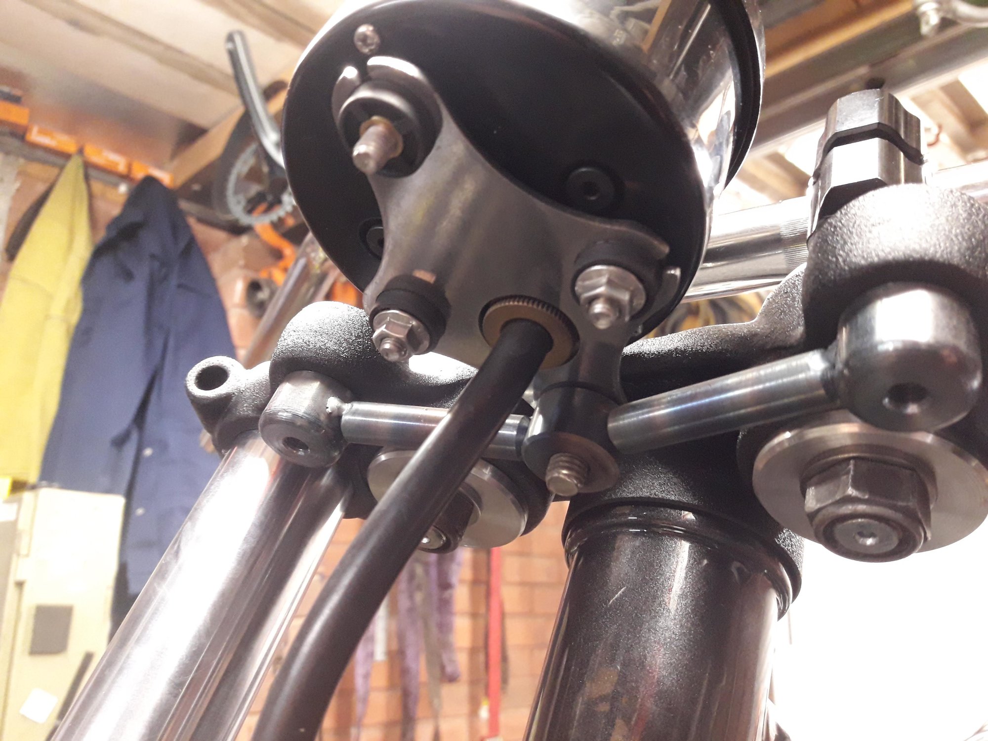

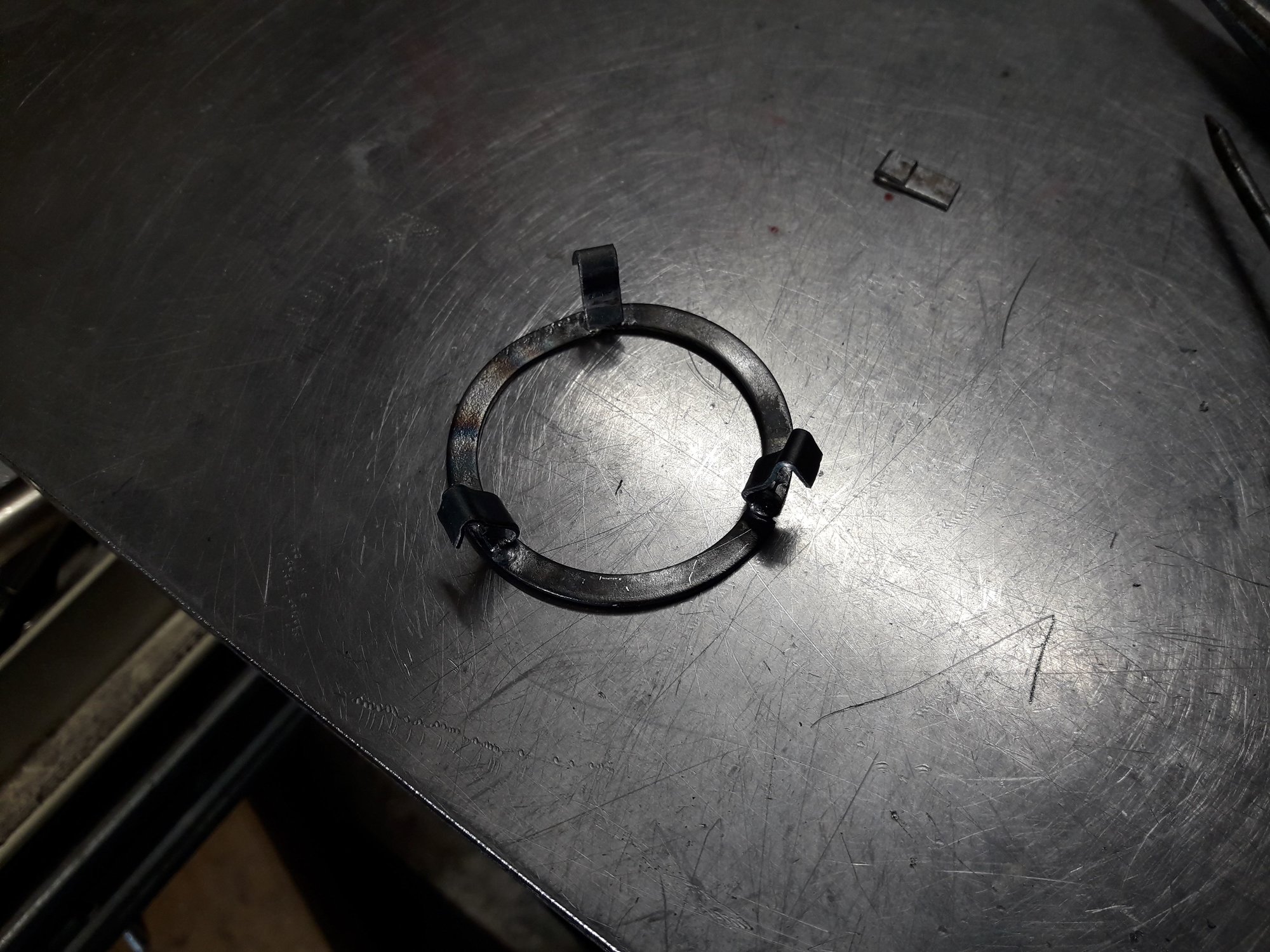

    As there's not enough meat on the fork after the brace is fitted, the recommendation is to go without dust seals.....I do not like that idea, so came up with a method fitting the dust covers, but I'm going to revisit this over the winter as its a bit carp and the tabs a bit close to the shiny new stanchions for comfort:rolleyes:

    :dontknow: Some people should not be allowed to work on their bikes.

    Too right................there was half a broken screw in there........not even related to any other size on the fork leg :o

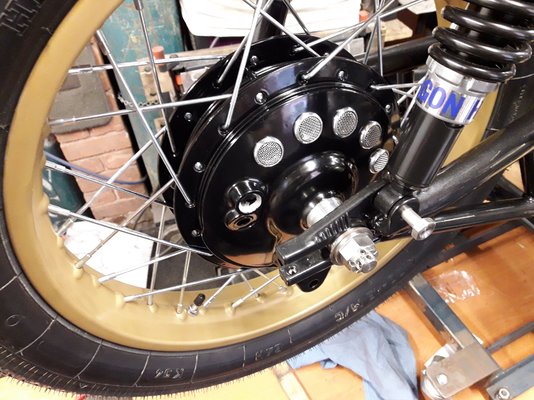

  14. lchris21
    lchris21 Member
    Messages:
    1,182
    Location:
    South Wales

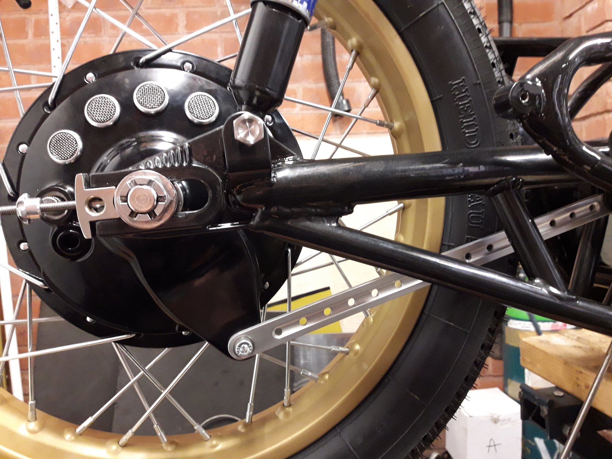

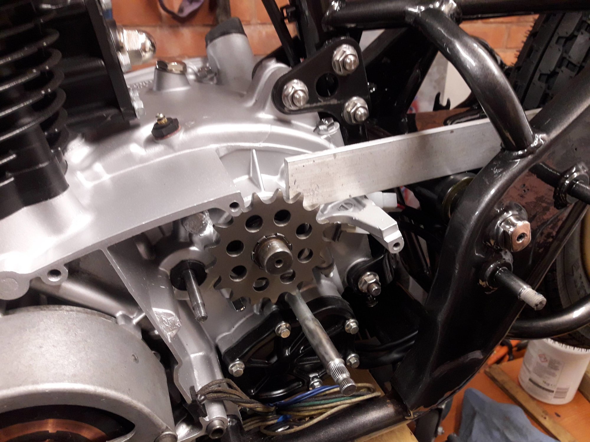

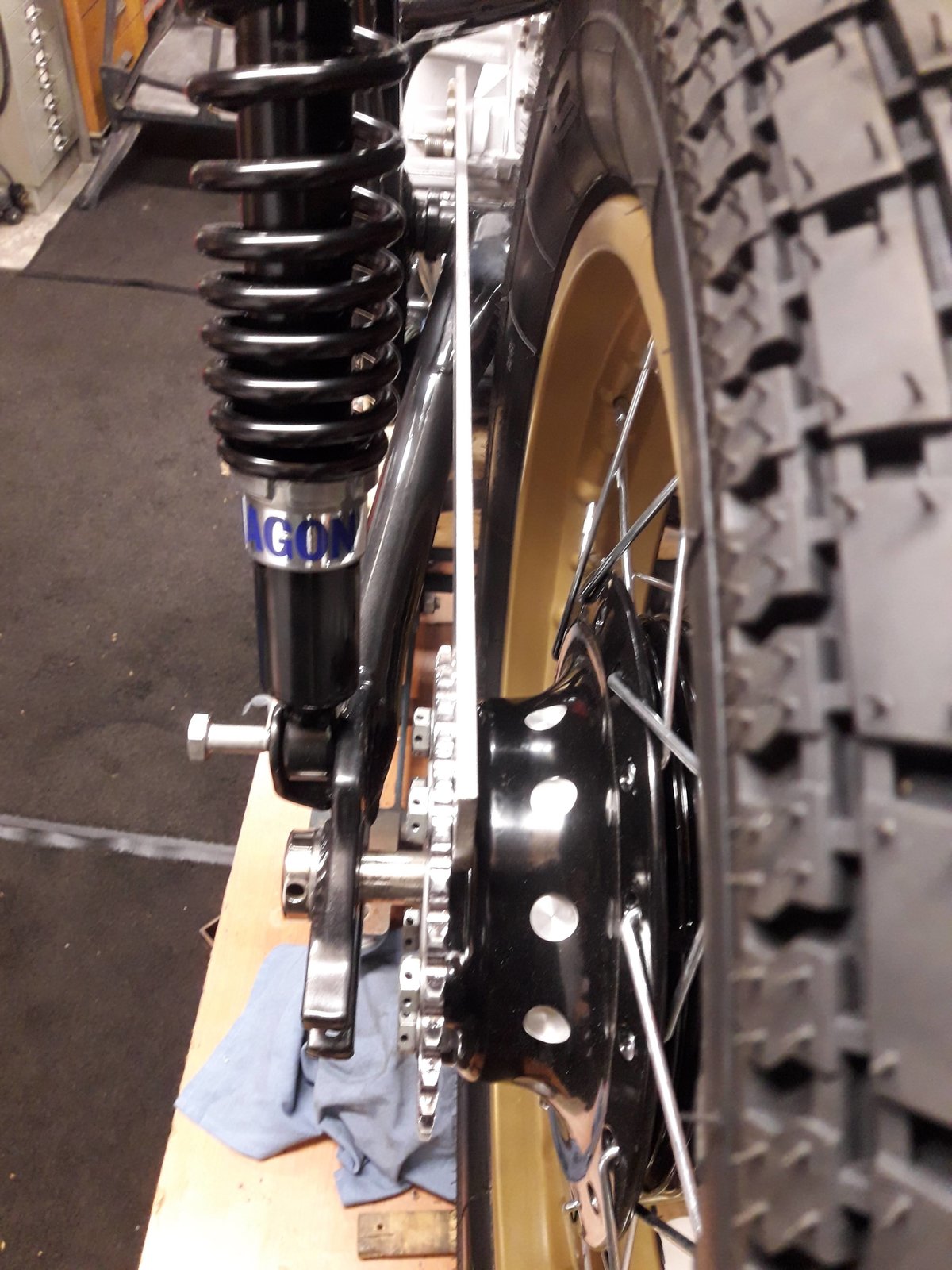

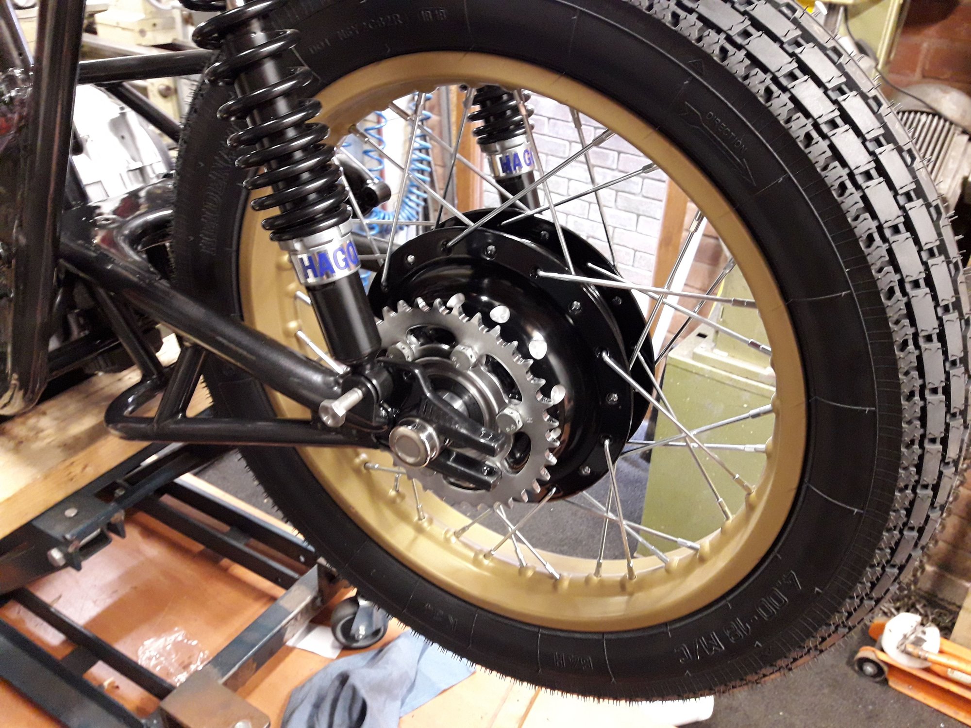

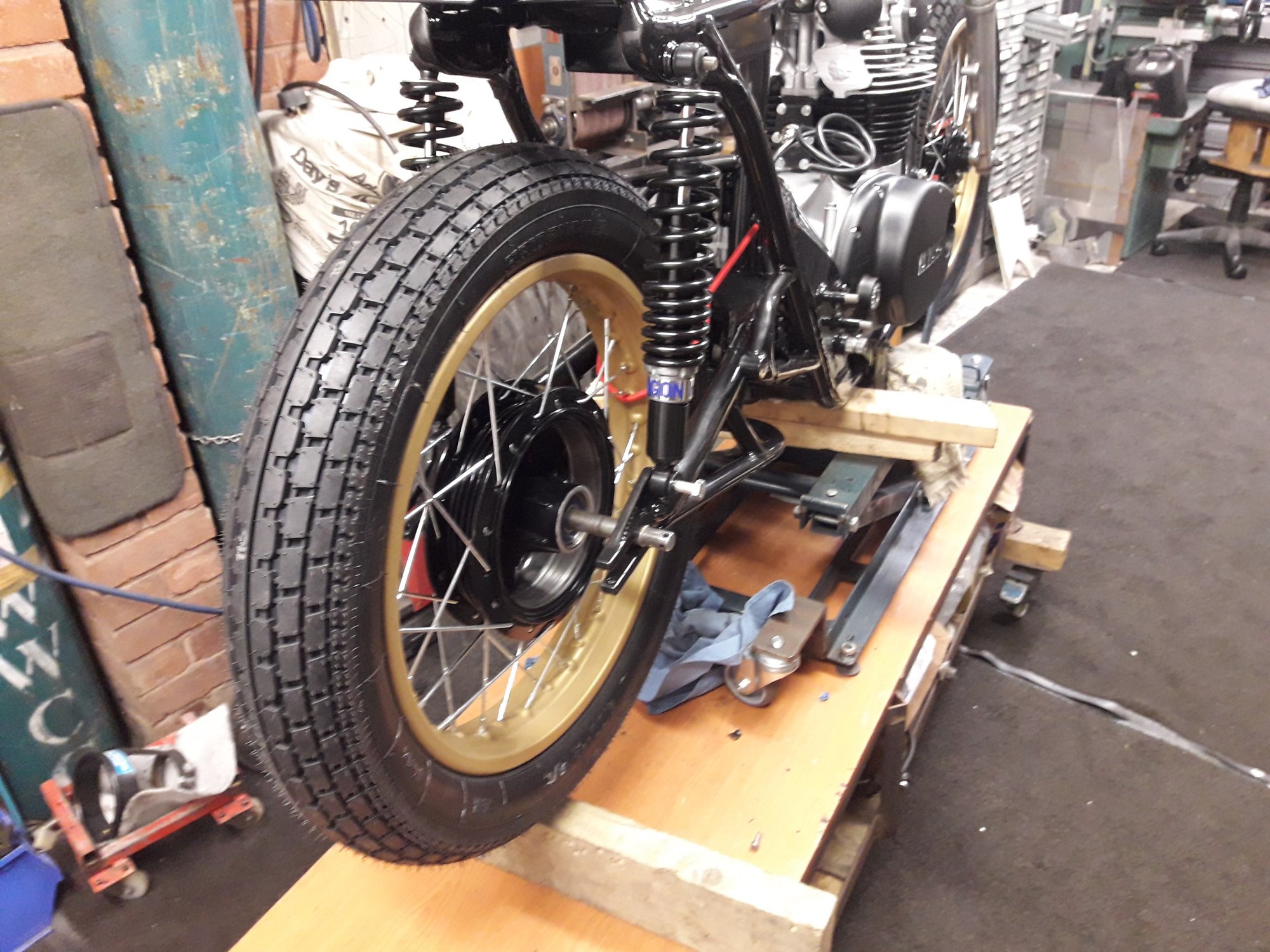

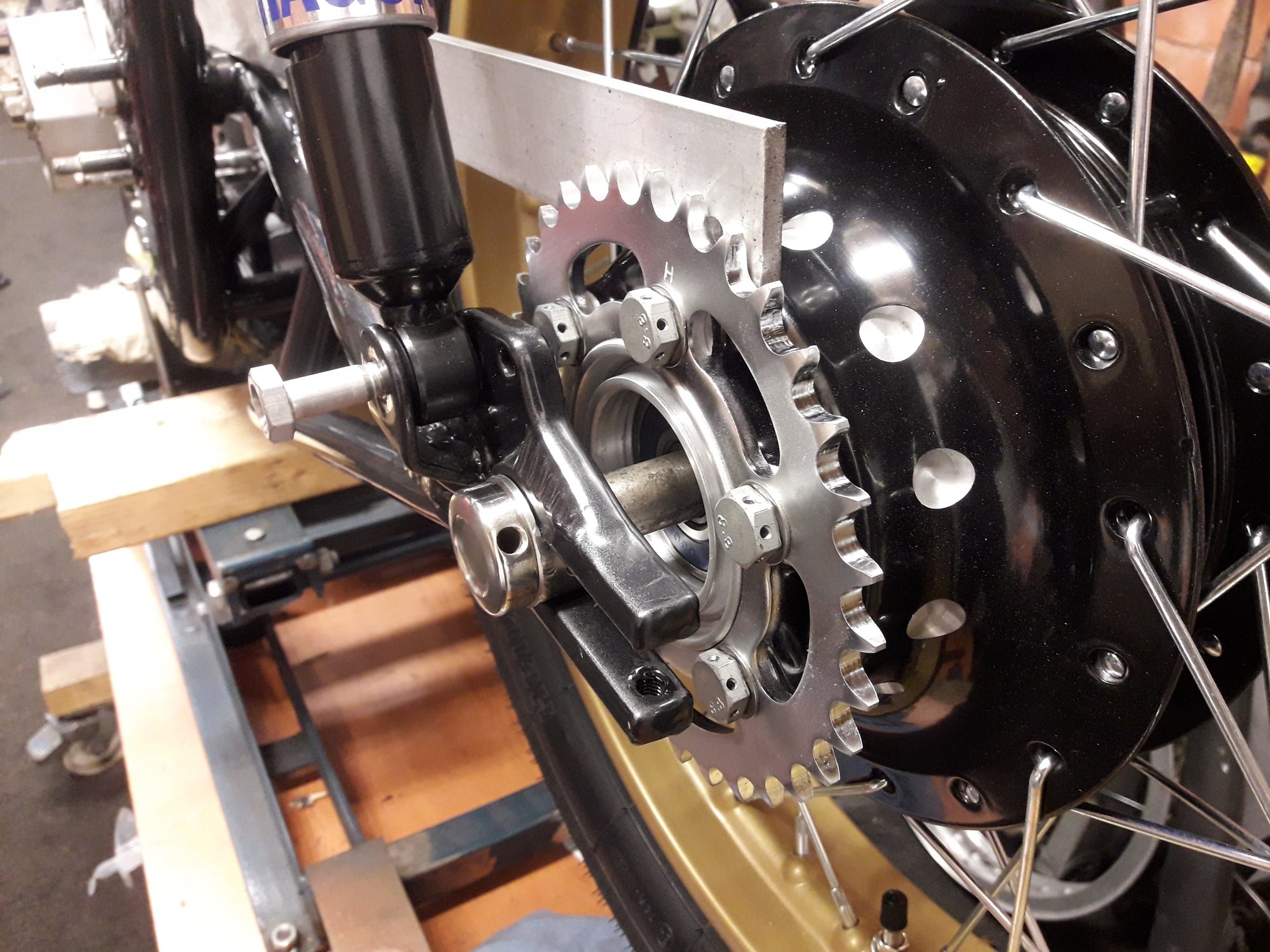

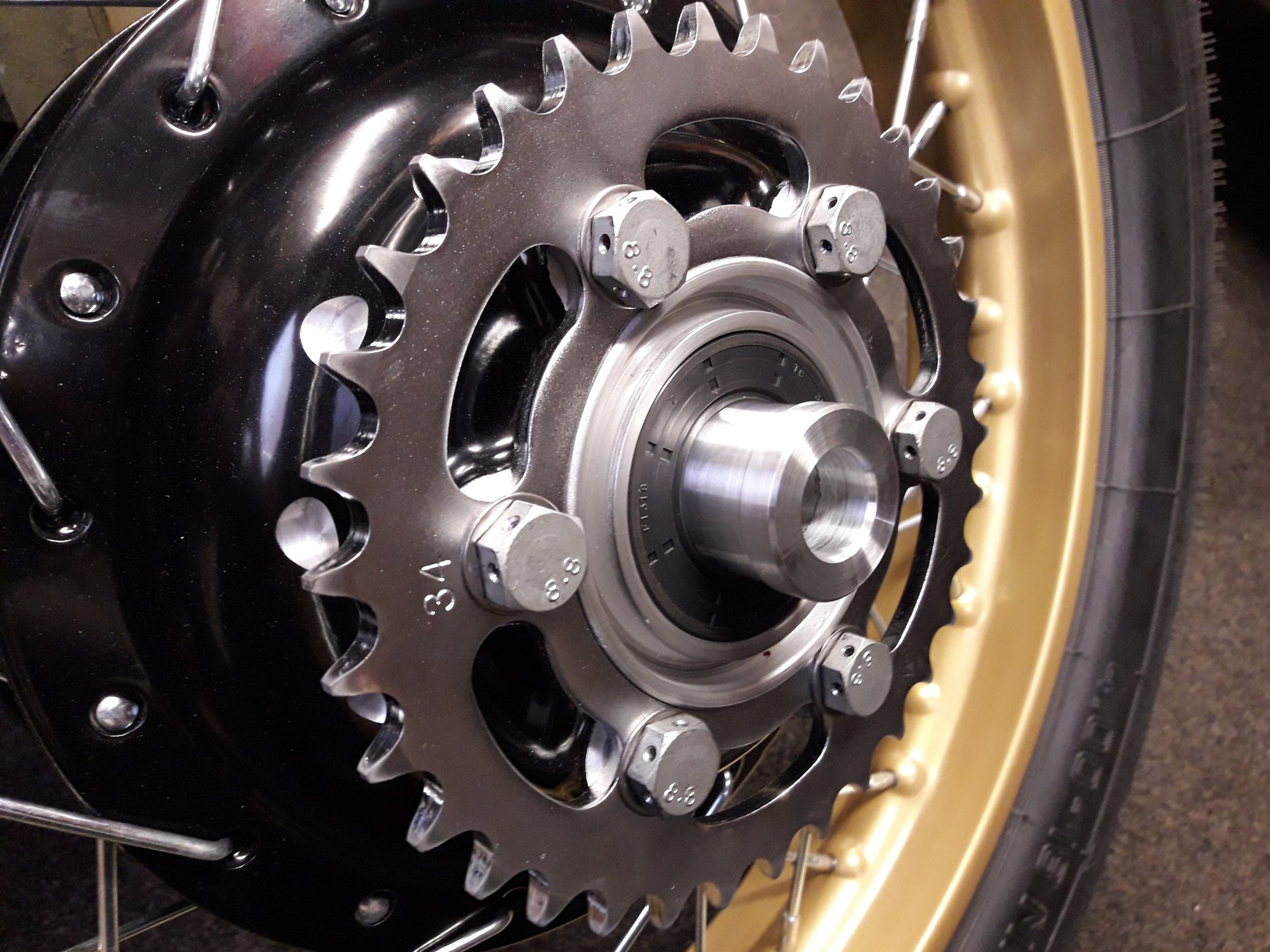

    Rear wheel alignment time along with some spacers to suit.
    20190427_180307.jpg 20190427_180321.jpg 20190427_180334.jpg 20190427_182351.jpg 20190428_171104.jpg 20190428_174123.jpg 20190428_174316.jpg 20190428_174846.jpg
  15. lchris21
    lchris21 Member
    Messages:
    1,182
    Location:
    South Wales

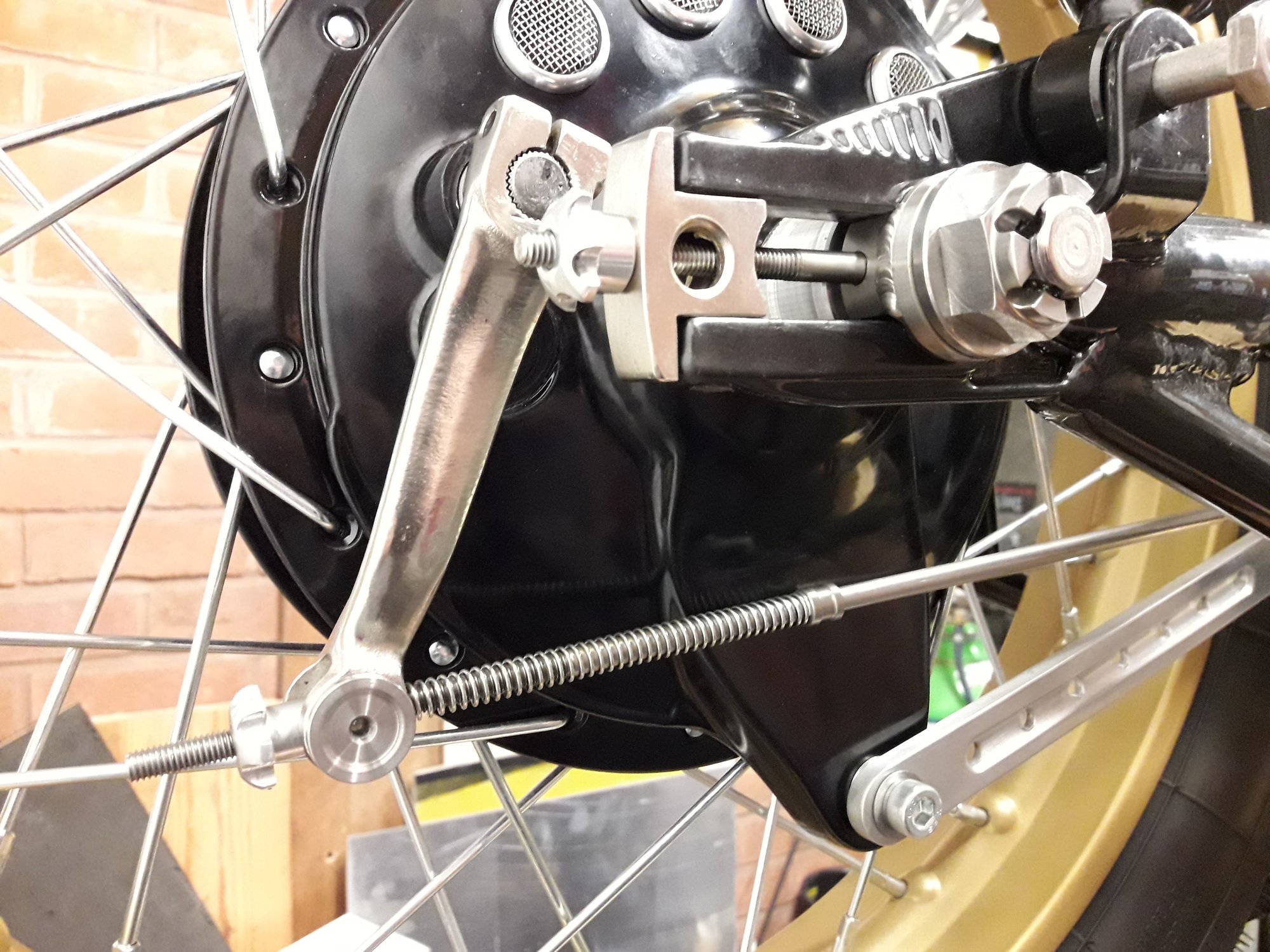

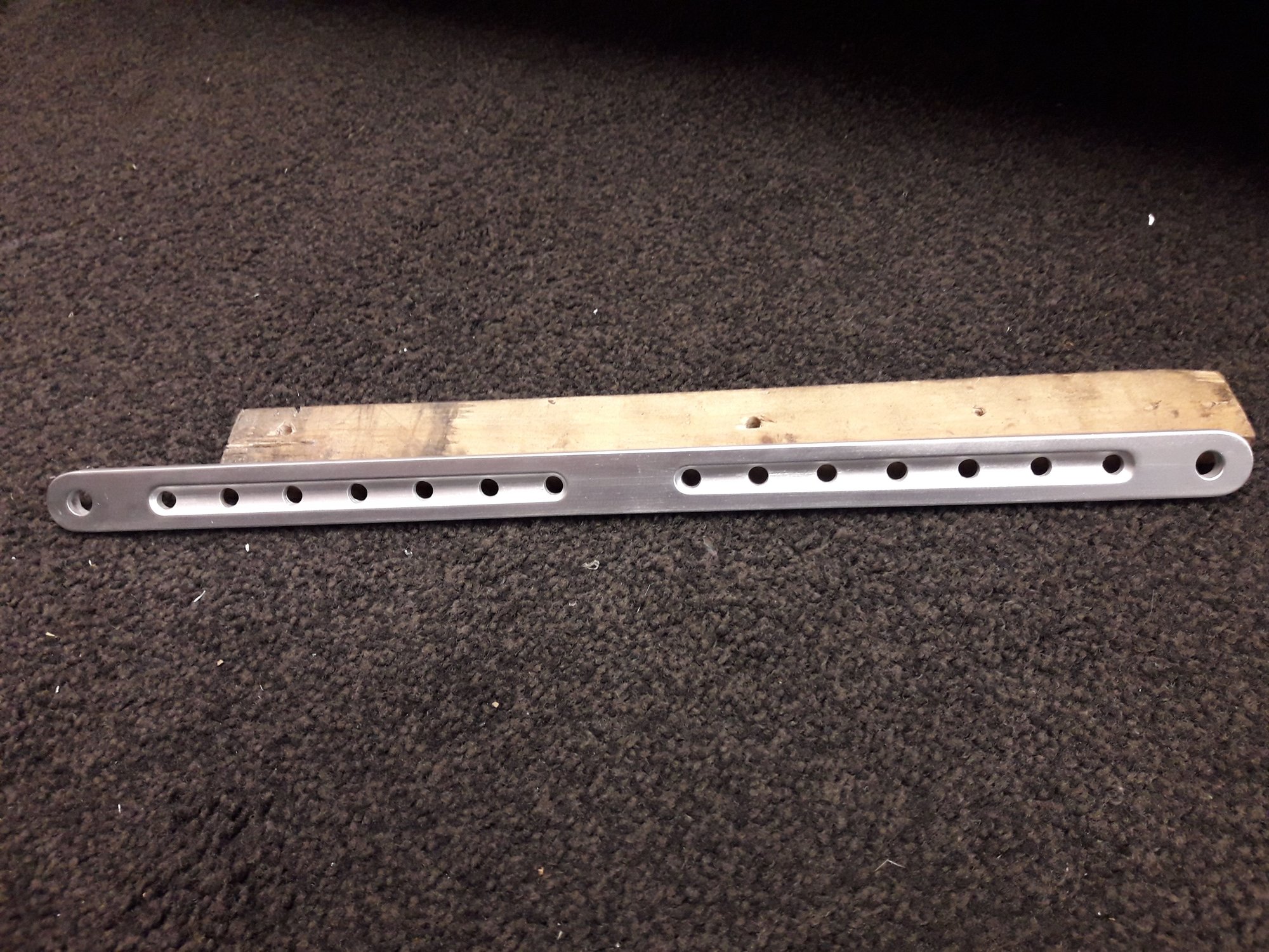

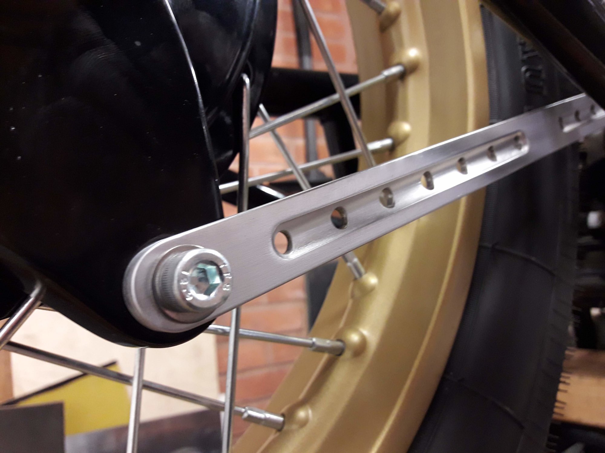

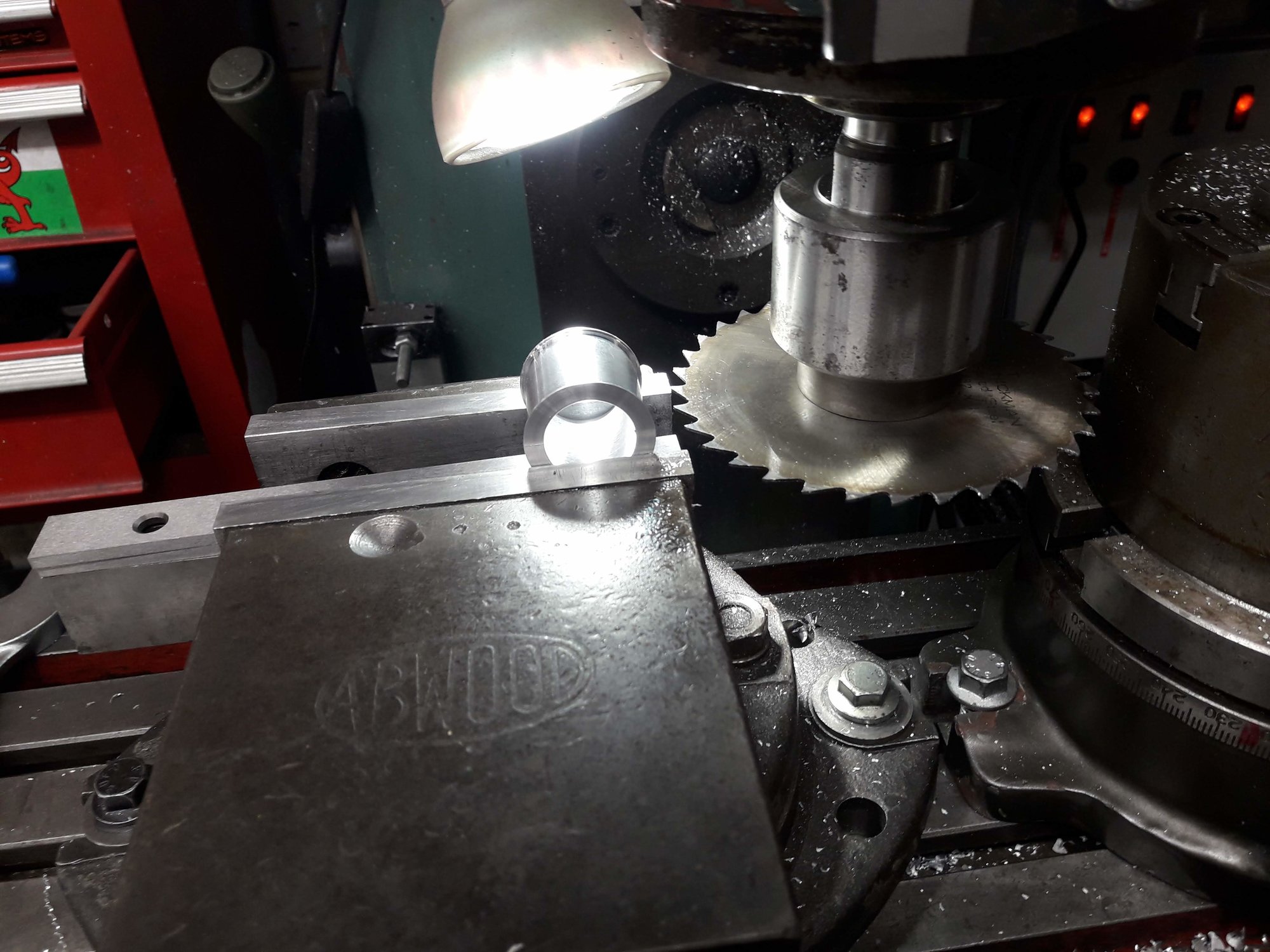

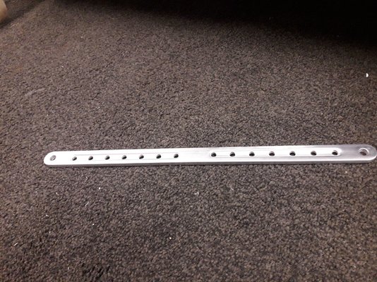

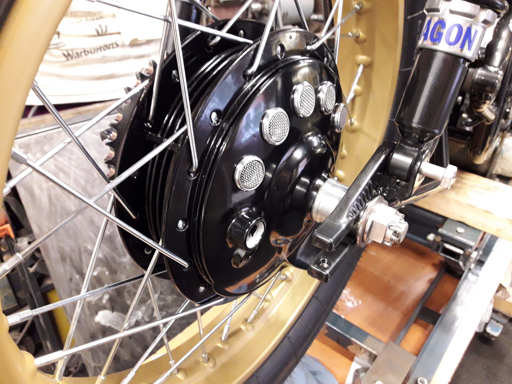

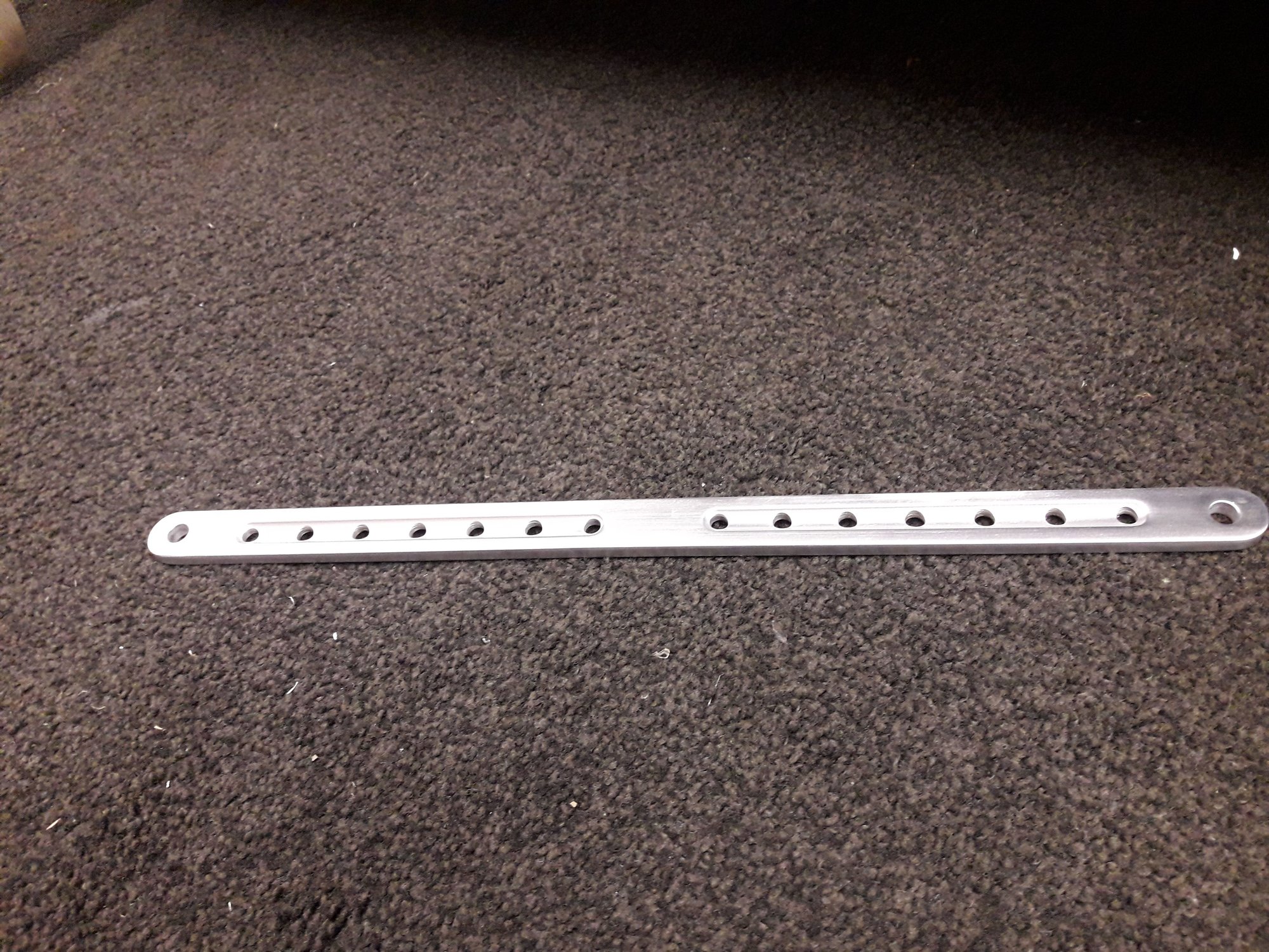

    Last job before the Spring this year was a torque arm for the rear drum................I'm up to date now :thumbup:
    20190505_172906.jpg 20190505_172918.jpg 20190505_173228.jpg 20190505_173346.jpg
    Rannsachair, Exuptoy, Wallace and 2 others like this.

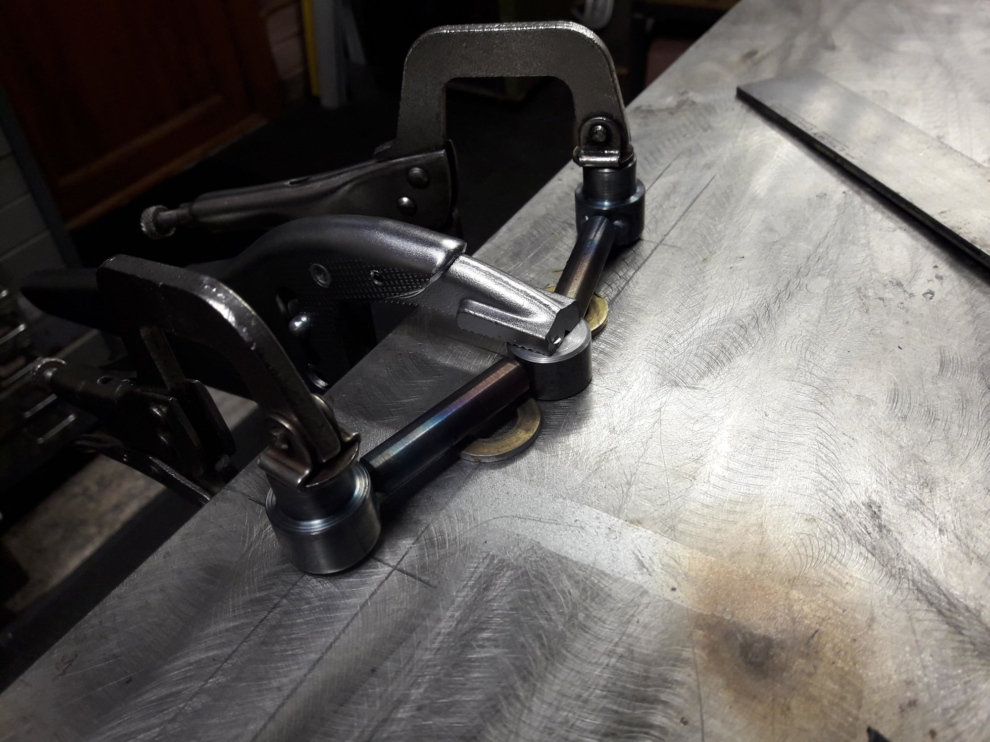

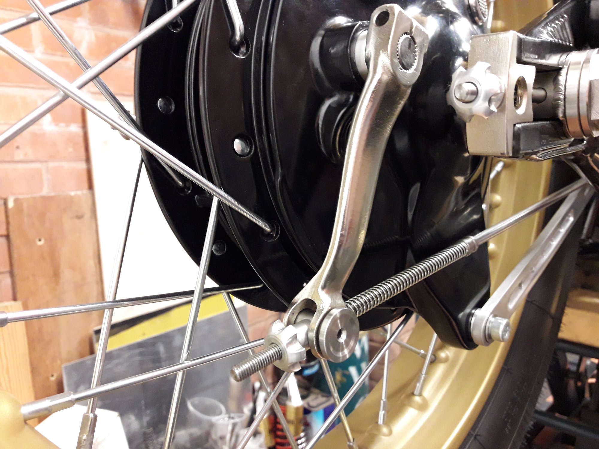

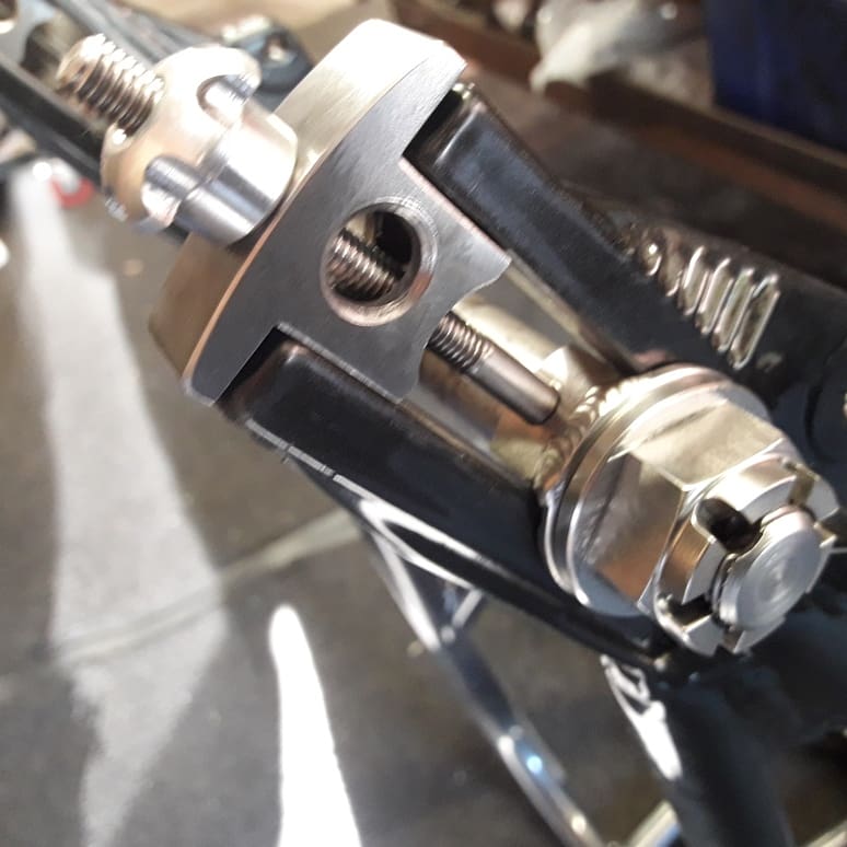

  16. lchris21
    lchris21 Member
    Messages:
    1,182
    Location:
    South Wales

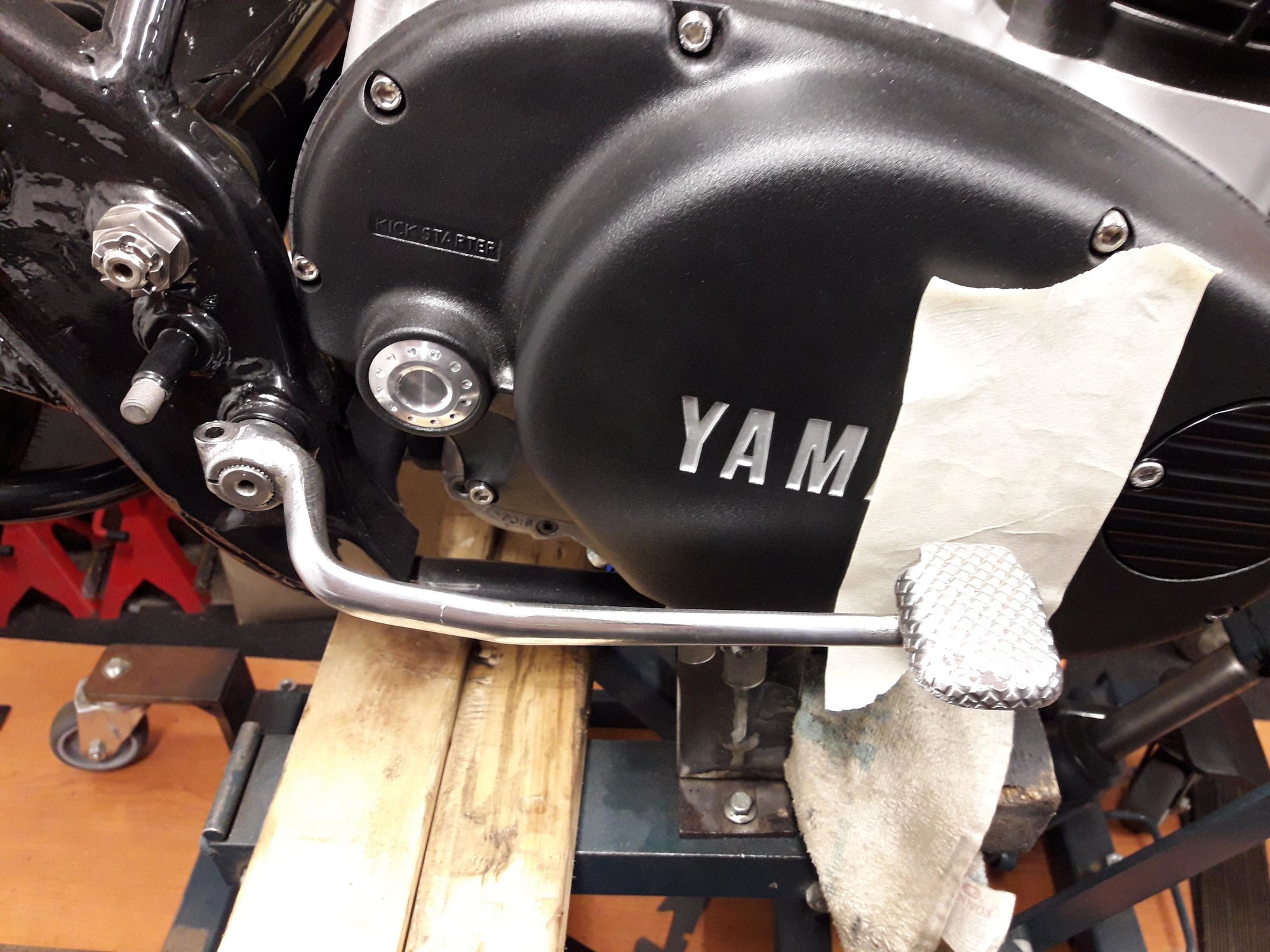

    Over the last few weeks Ive been working on getting the back end sorted along with the foot controls. Knocked up a stainless brake rod and linkage pivot for the brake arm, along with a matching adjusting thumb nut.
    zx9, Rannsachair, Exuptoy and 4 others like this.

    I can never make my mind up about those fork braces with fixed centres in respect of any discrepancy between their centres and the yokes.
