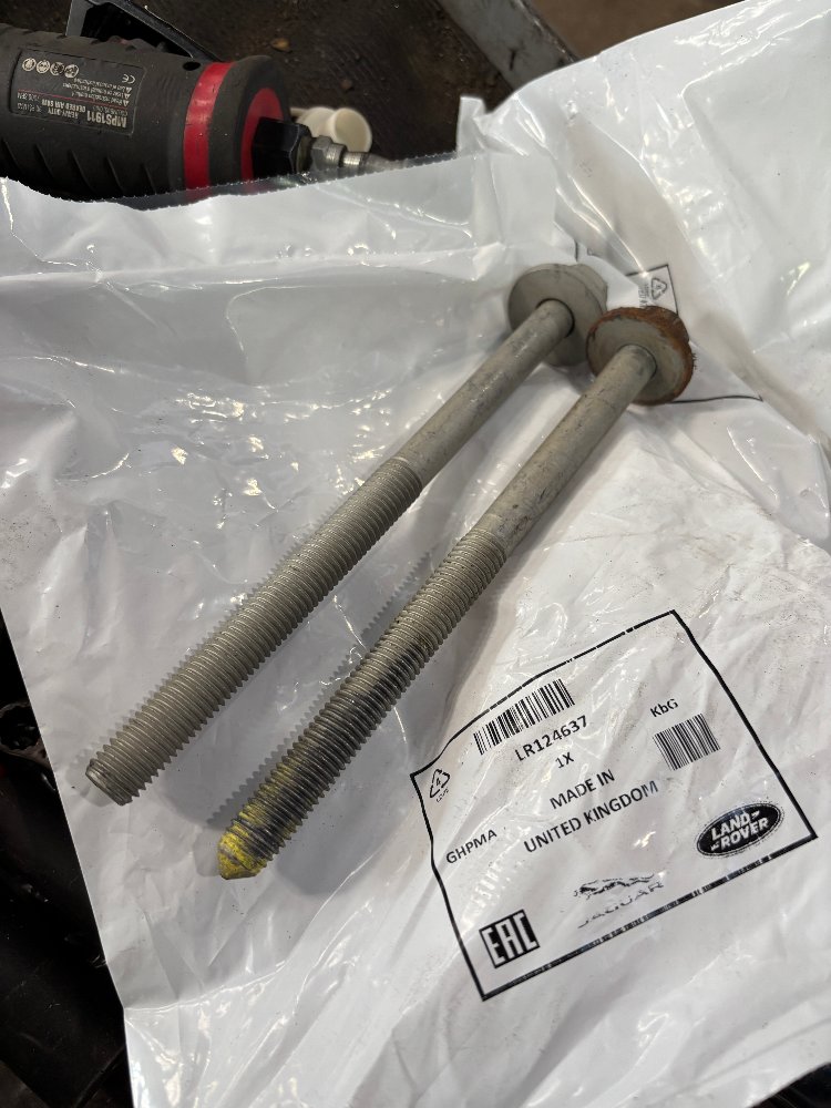

Parts turned up this morning - two AC pipe sections and four subframe bolts, if you ever have to release or remove the subframe bolts, do not, reuse them - it's nothing to do with being angular tightened after torquing (although that does apply), the original bolts are trilobal 'self cutting', reusing them can/will cause the existing thread to be damaged so use the 'refit' bolts which are standard, round thread bolts.
These are the correct ones, old bolt next to it for identification

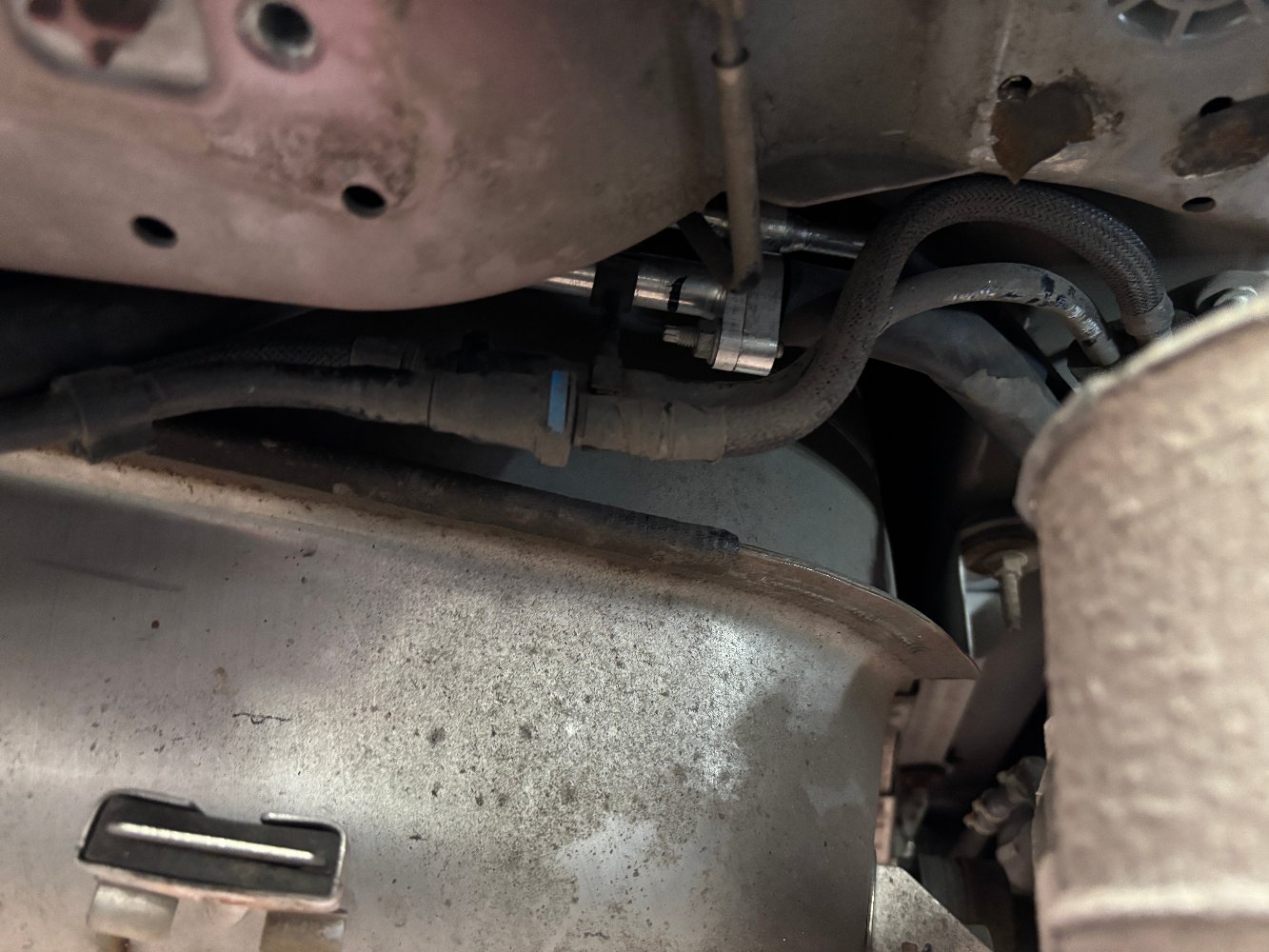

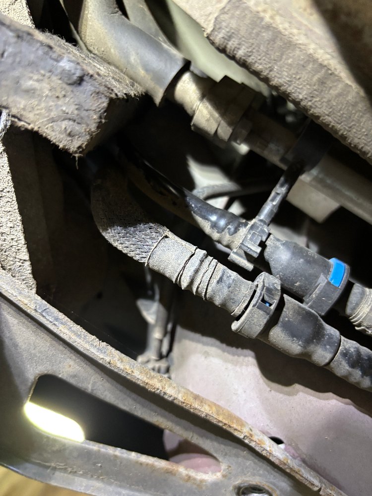

The reason for two sections of pipe - the failed one, plus the section in front of it, the joint is exposed and I've never found it to either come apart without twisting the pipe or reseal properly due to corrosion damaging the new seals as the union is pushed together. The union roughly in line with the 'B' pillar is better protected and accessible.

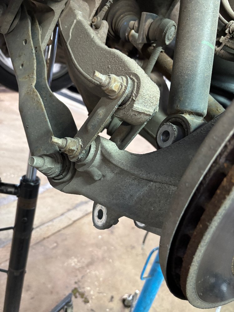

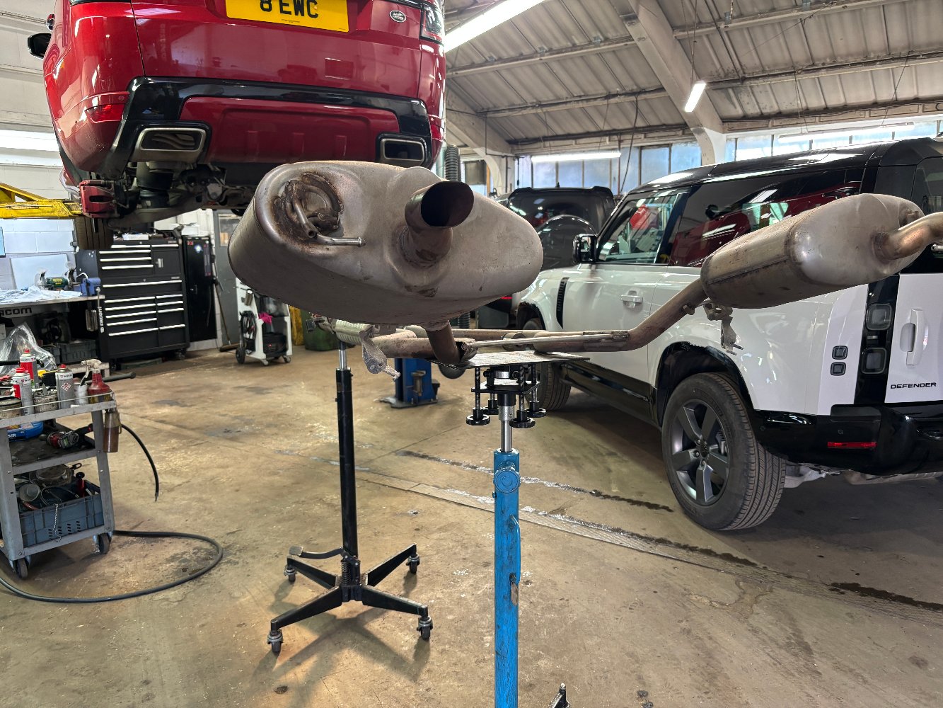

First step, remove the exhaust, reasonably easy as most hangers are bolted on, only the rearmost two need to be drawn off the pins

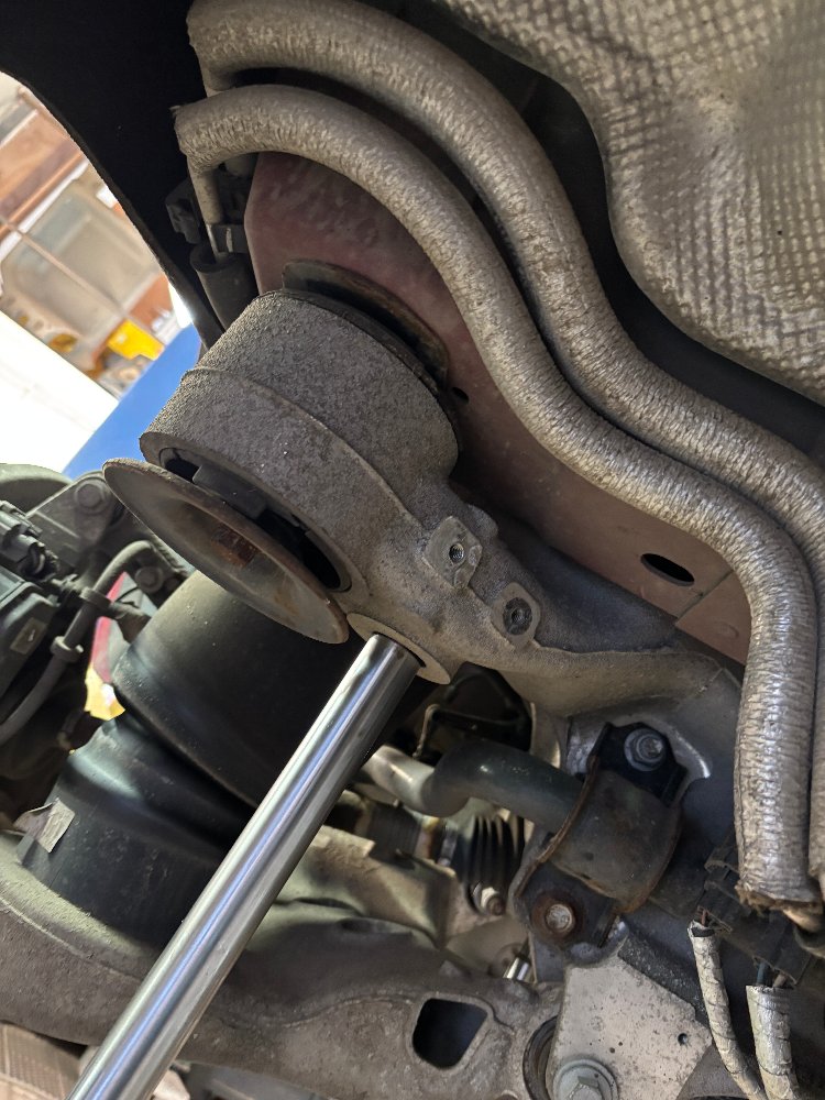

Then, slacken the four subframe bolts by hand, release the NSR damper from the lower suspension arm, deflate the NRS suspension airbag & remove the pneumatic coupling.
Support the subframe using the factory location holes - most transmission jacks will fit the holes.

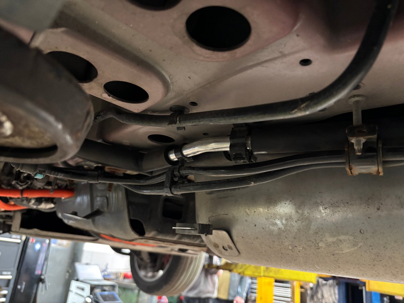

Then fully remove the NS subframe bolts & the front location bracket, withdraw the OS subframe bolts by 30mm and lower the transmission jacks, giving access to the AC pipes, note the fastening clamp and body stud (circled).
Release the electrical harness retainers as they become exposes as the subframe is lowered

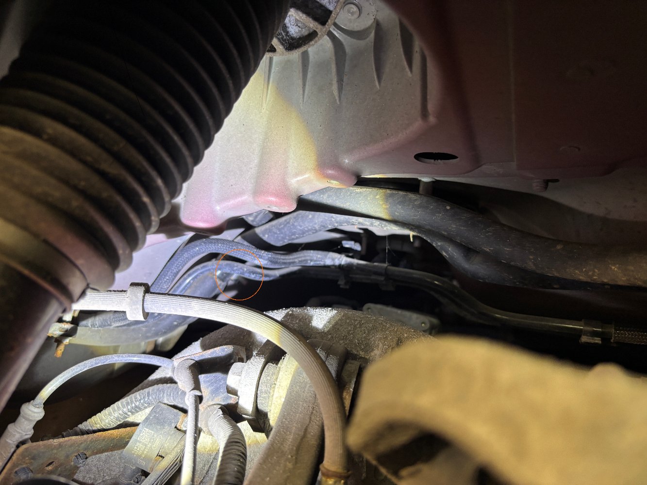

Here's the pipe union that suffers corrosion
An air saw takes care of that!
Fit the pipes bur ensure the union above and the one onto the existing pipes are fully fitted and tight before fitting any pipe clips or securing the clamps to the body
