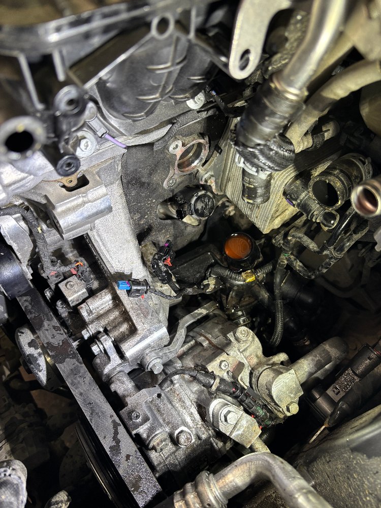

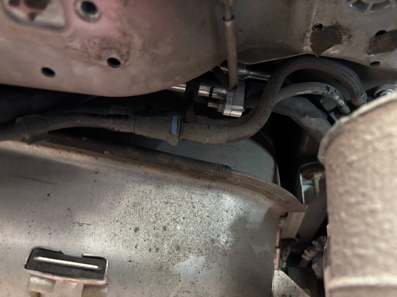

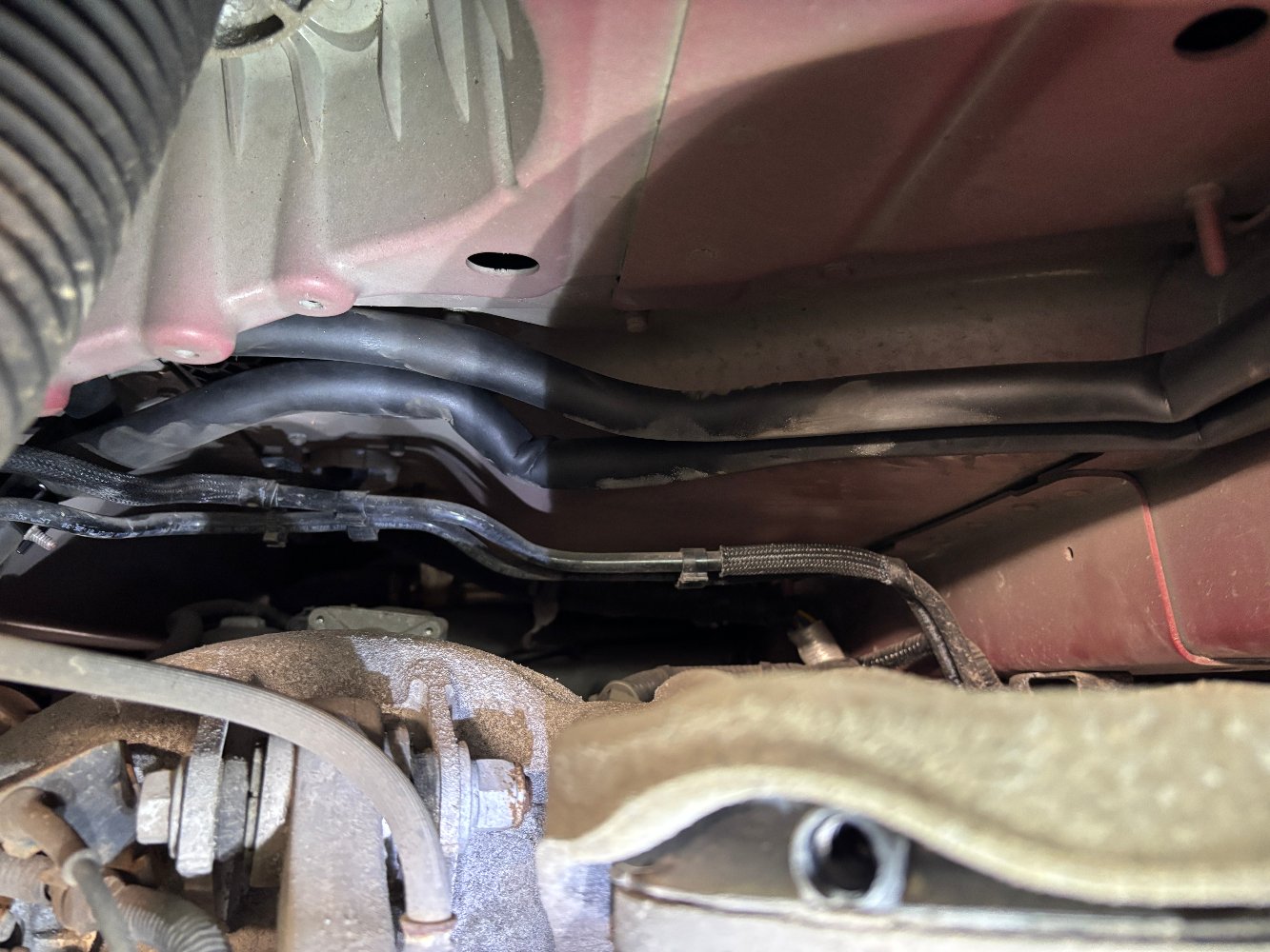

Replaced the fuse and turned on the ignition - it took ~5 seconds for the fuse to rupture, but there was a slight whiff of 'expensive' coming from the NSF of the engine, the only component on that circuit near there is the oil control solenoid (Piston cooling control solenoid), so time to take a look..

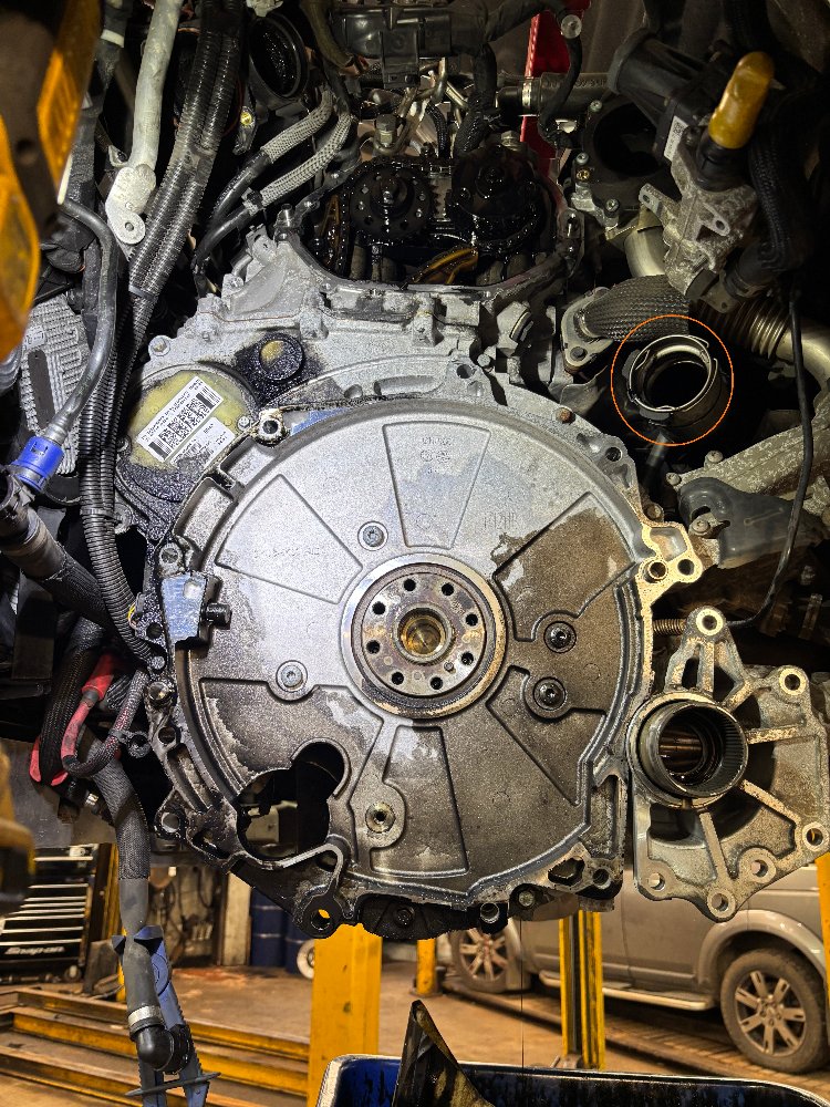

It's a MHEV so a forced shutdown is required, as the starter-alternator needs to be removed, after removing the belt tensioner, lots of coolant pipes (and draining the system) to get to this....

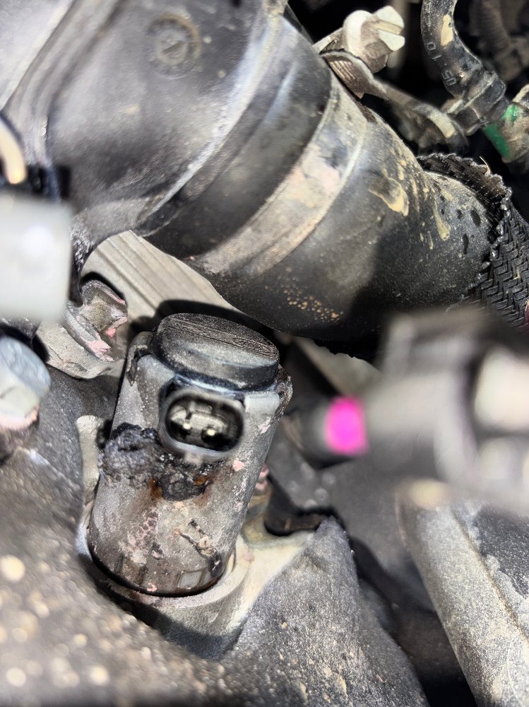

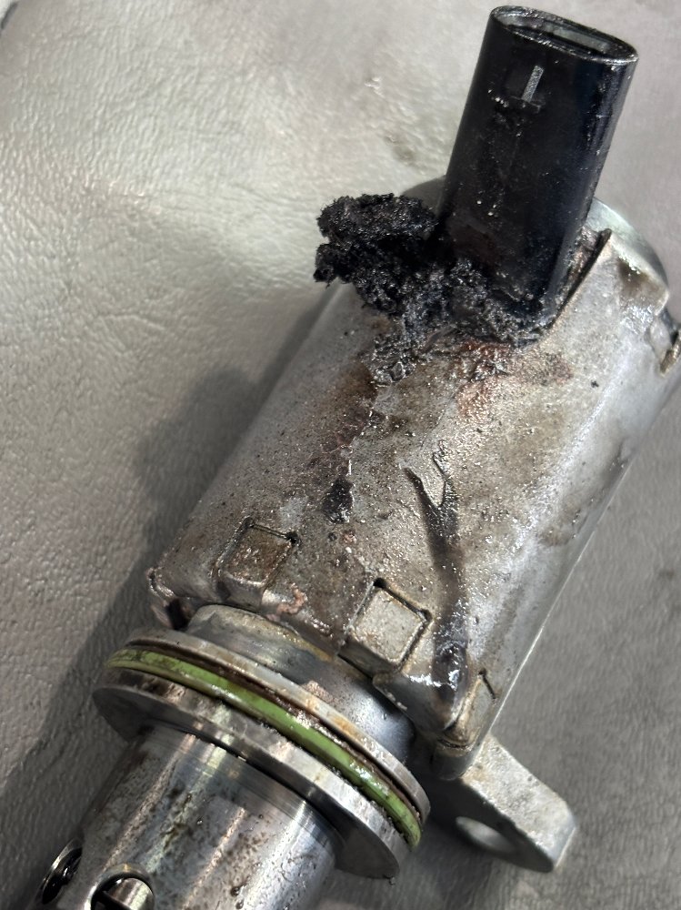

The oil control solenoid is behind a coolant hose & manifold...
Looks like it's had a bit of an 'eruption'!
Yep, all that molten plastic is where the 'expensive smoke' came from, resistance measurement of 8 Ohms to ground (should be >1MOhm) confirms internal defect, unfortunately not the same as the 4 cylinder ones we keep in stock and on backorder with no ETA....
So put it back together enough to move around the yard and wait on parts. So far, just under two hours including making mobile again - there's worse jobs!
