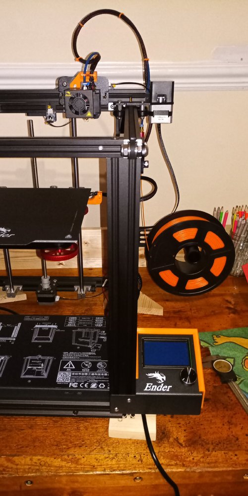

The 32 bit upgraded version. £280 on Amazon but I paid £170 delivered from the manufacturer's website. I got a Kilo of black PLA and a kilo of blue PETG to make the brake flush funnels which I need urgently.Which printer you gone for?
