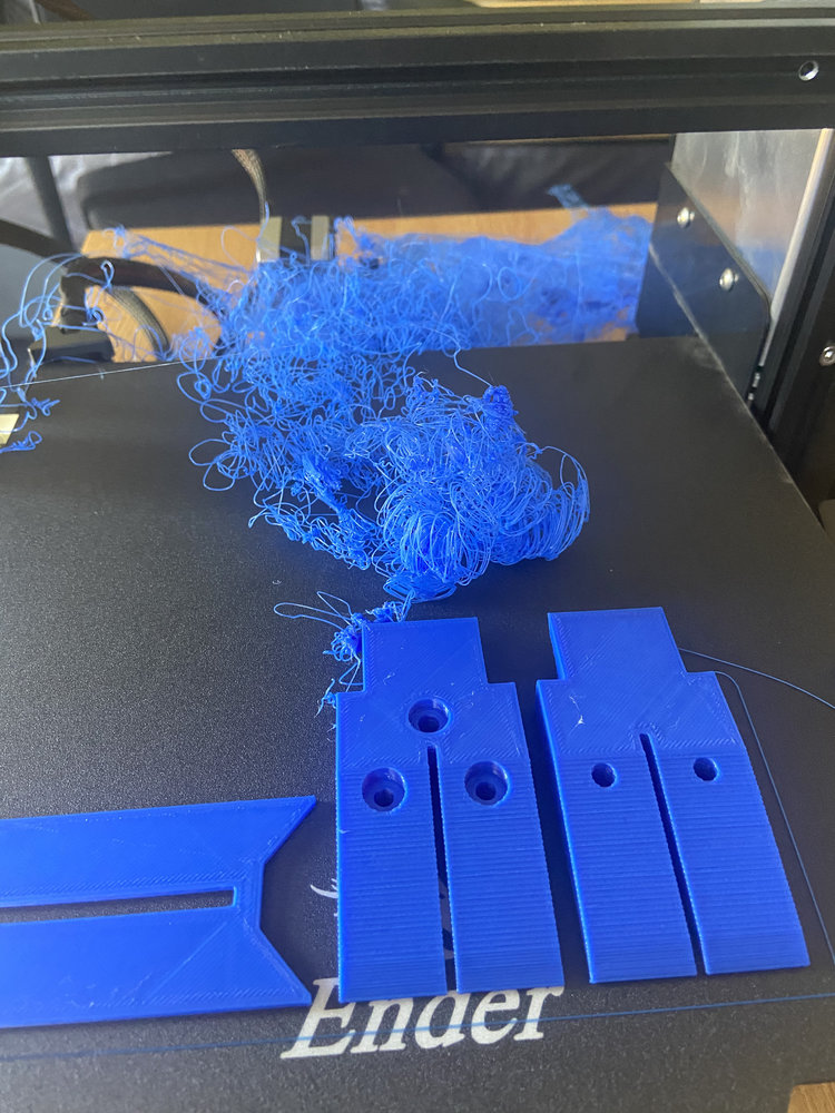

Was a combination of flat and shaped parts.Were they all flat parts? I had it try stringing last week because of a shaped piece which had no bed contact in places.
What's a brim?
One of your parts came unstuck from the print bed, so the filament had nothing to stick to. Usually caused by the print bed not being clean or not being level as the first layer generally needs to squish into the bed to stick properly. I used to just wash the magnetic bit in the sink with a nail brush and then a bit of ipa.This happened, first time I put more than one part on the bed, think the bed temp wasn’t high enough.
was set at 60 for Sunlu PLA +, extruded temp at 210
A raft is like a small pallet for your print. A brim is like printing a top hat when you wanted a fez. A skirt is just a ring of plastic around the print that doesn't actually touch the print, but if it doesn't stick, you can easily see that the print won't stick either, so you can cancel the print and level or clean the bed before you have another go. The raft and the brim will just peel off the print afterwards.In Cura, go to build plate adhesion, it explains there if you hover over it, there's raft, brim and skirt. Skirt puts a single layer thick border around your print.

What’s the homing switch?You have to move the homing switch up or down to suit.The z-axis doesn't home off the bed, it homes off the switch.
Ok. Didn’t say anything about in the instructions.To the left of the bed on the vertical pillar should be a bracket holding a microswitch. When the machine homes it travels down until it closes that switch then goes up to it's 'home' position. Adjusting the switch vertically will adjust the home position distance above the bed.
Ok , that’s useful.No it doesn't the switch sits on a cnc bracket that is supposed to hold it at the correct height. Creality released a vid on how to adjust it:
