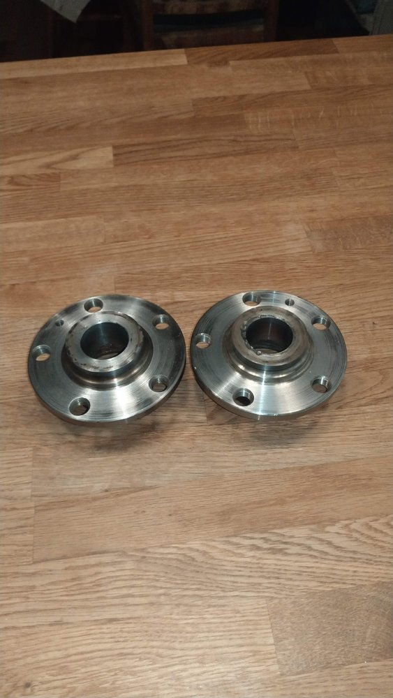

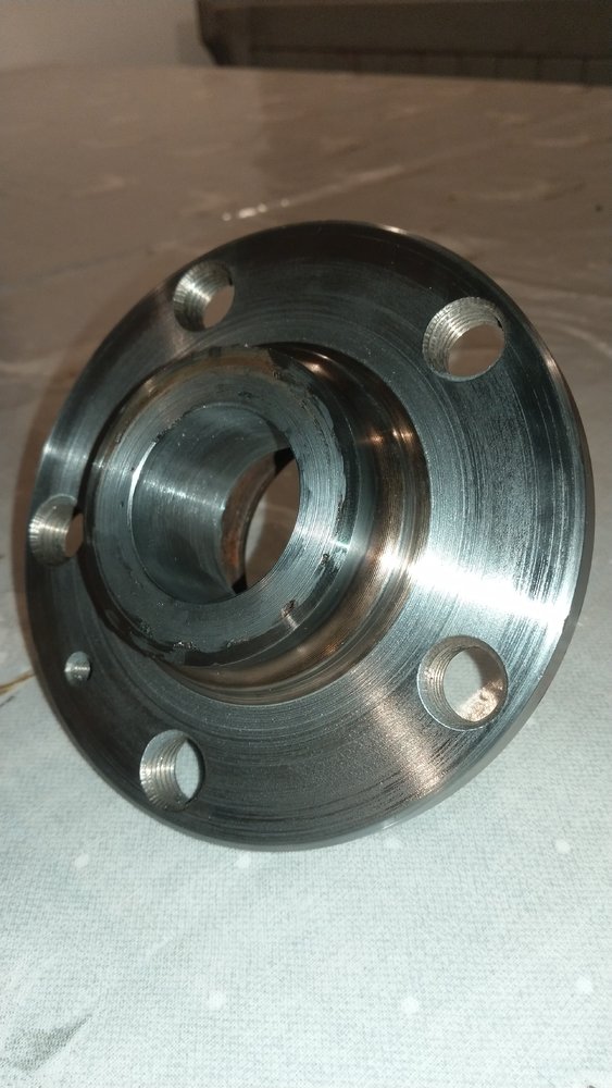

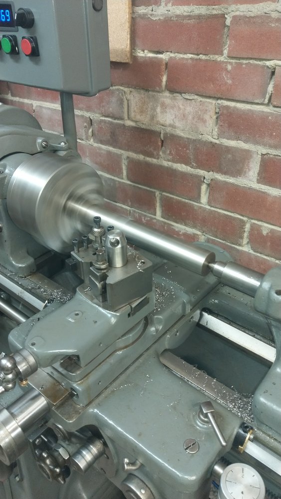

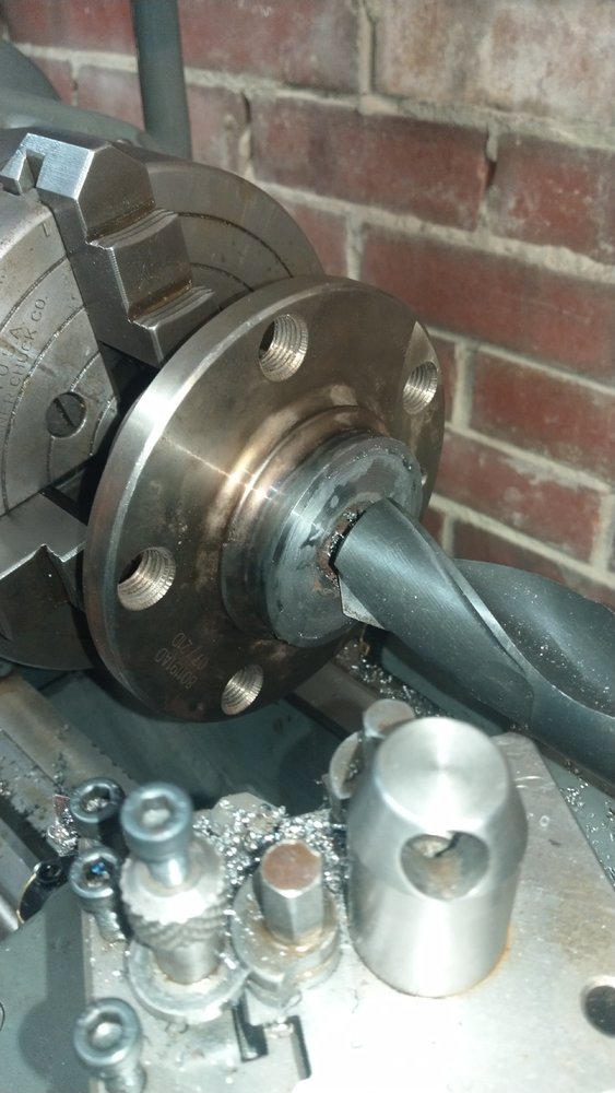

Right! I've had a go here and it's not great!

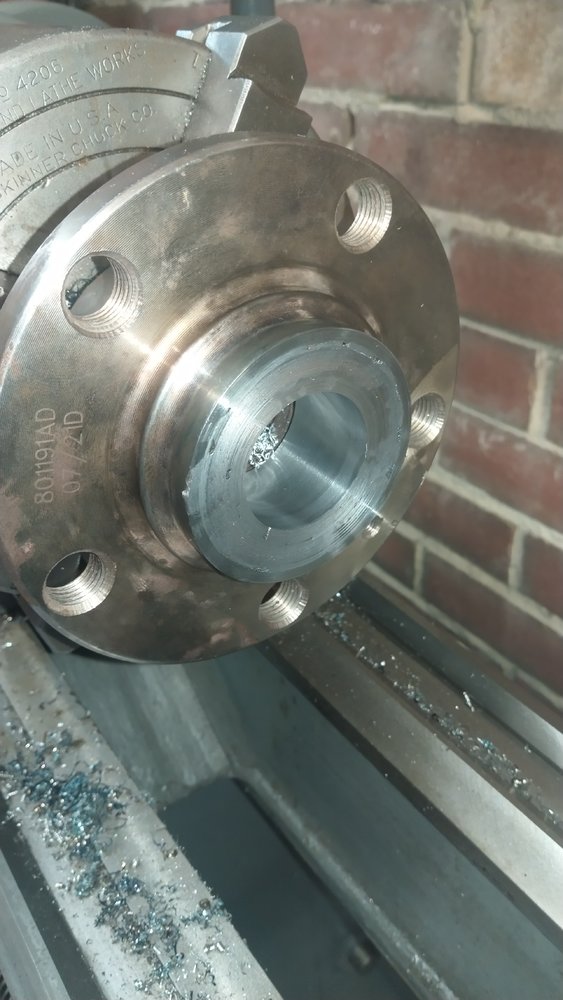

Took ages to get it clocked in the 4 jaw, the best I can get I within 0.05 mm, maybe warped from welding?
I tidied up the welding first then
tried the large drill but that just jammed with very little pressure.
I got a boring bar out and it's cutting reasonably well once I got passed the square hole!
I'm getting a taper though
Very little stick out on the tool and seems to be the same on light and heavier cuts. Any ideas?
