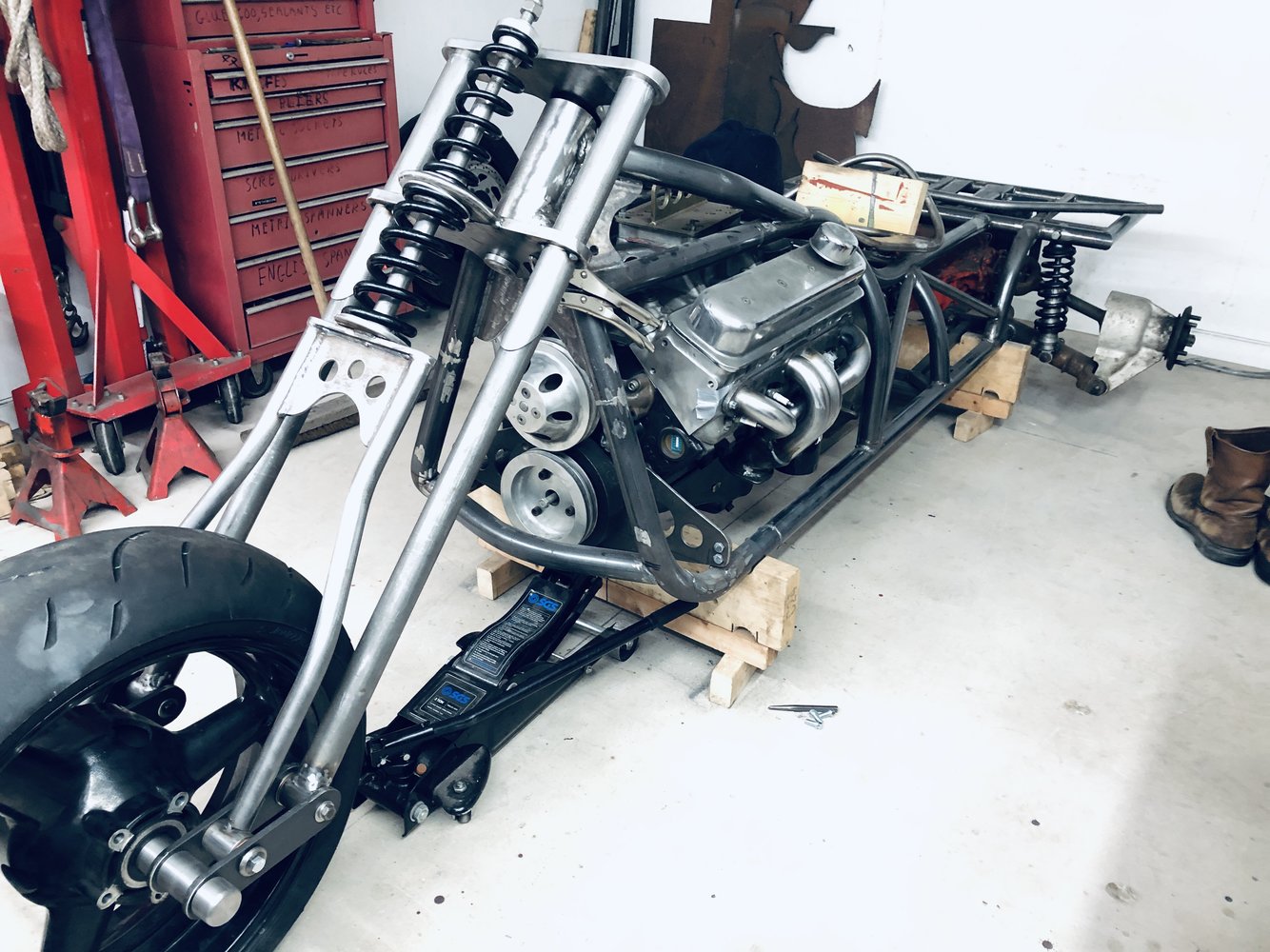

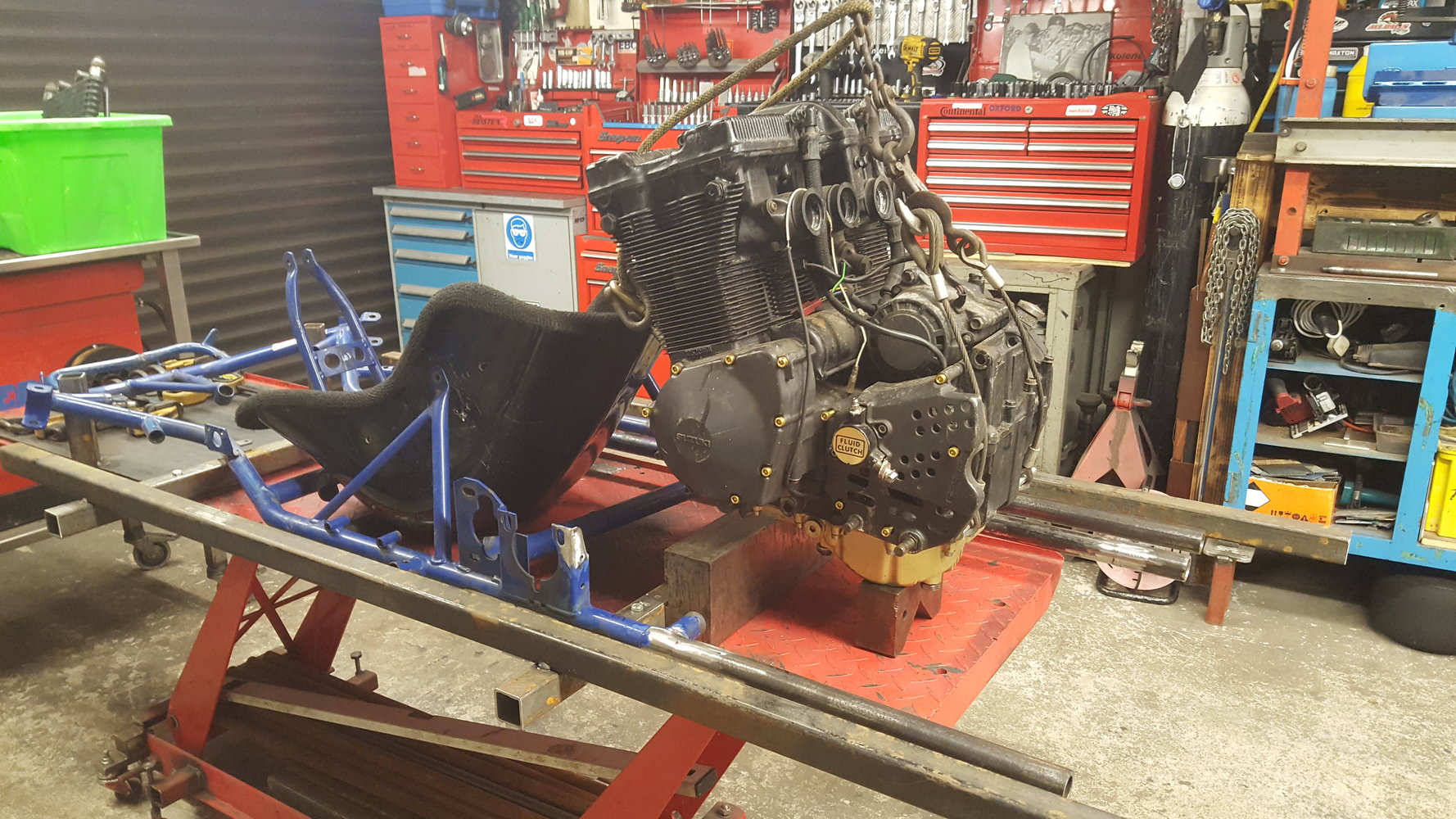

Starting to take shape.
Was thinking about hanging it off some kind of roll bar above the motor/my headStarting to take shape.Are you going to fit the oil cooler high up at the back or low down at the front?

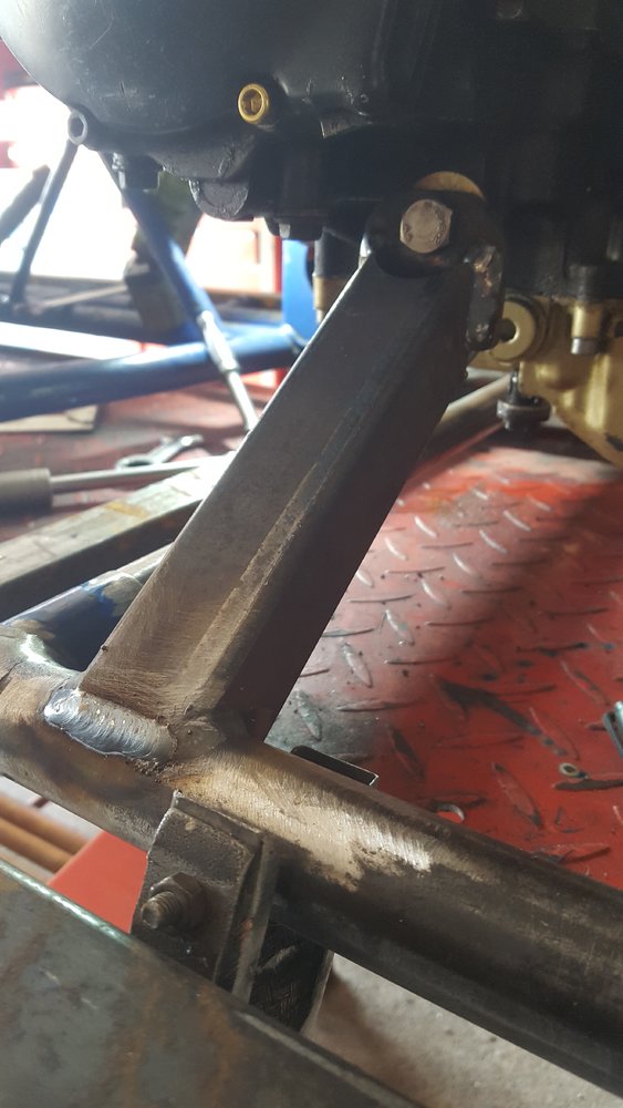

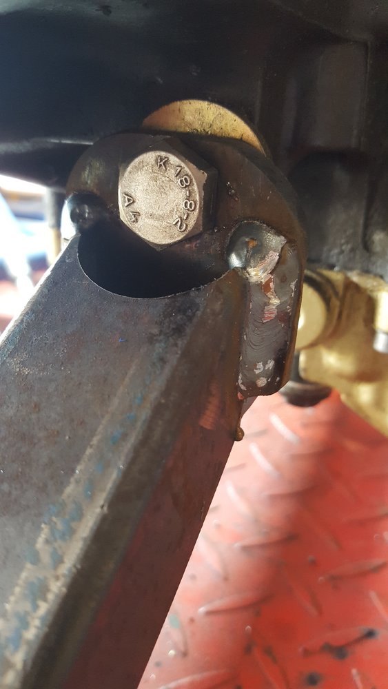

Cant fully weld the mounts till the motor is back out and i can turn the cart upside down but that's a long road yet as i want to fab every single last bracket so i don't ruin the paint once its done with a forgotten bracket or tab.
I have put enough weld into the tops to hold it from moving when i do the bottoms...i will keep doing diagonal pieces to keep the heat out..Nice. Best hope it doesn't all move when you remove the motor to invert it for the awkward welds.

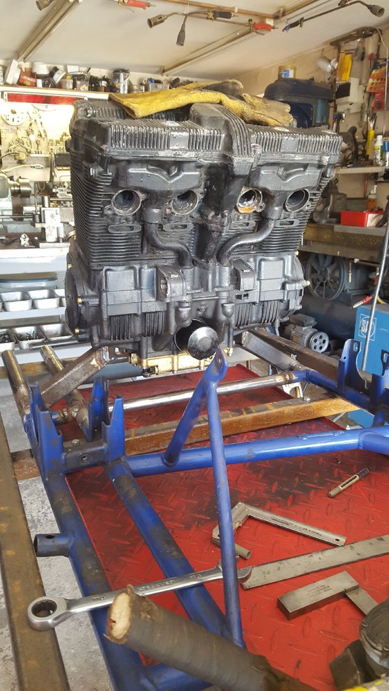

is it an optical illusion or is the motor sitting quite high?

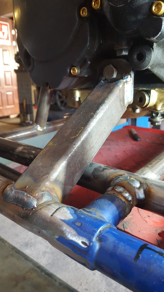

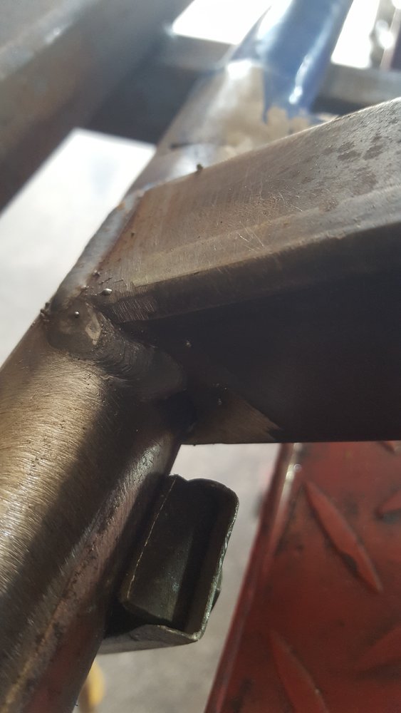

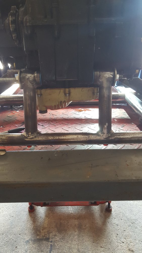

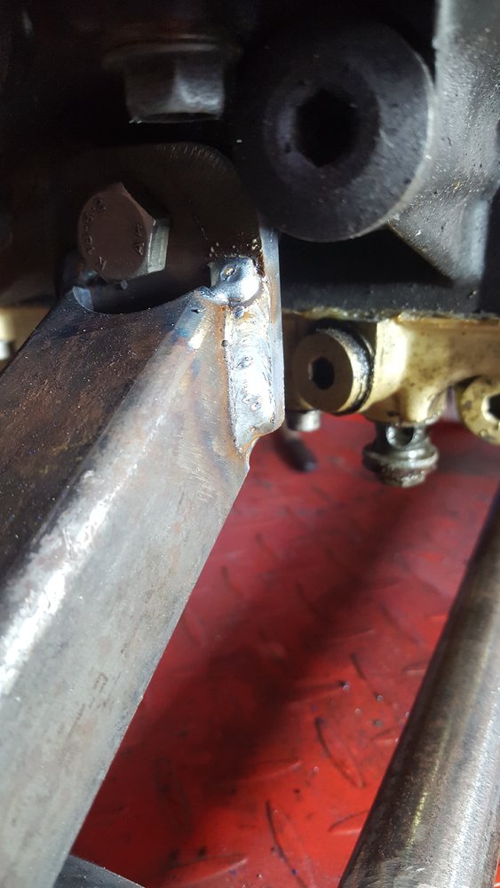

but its at the limit to allow exhaust down pipes and collector to clear frame and if you look close it has the gold colour sump which is the limiting factor..once its built and on the ground it will all fall into perspectiveHow dare you post anything welding related.Ok had a few hours this afternoon and the motor sits on its own mountings (top mount to do yet). The bolts,washers and spacers are just a temp fix to hold it, and as a bonus some welding pics..Cant fully weld the mounts till the motor is back out and i can turn the cart upside down but that's a long road yet as i want to fab every single last bracket so i don't ruin the paint once its done with a forgotten bracket or tab.
View attachment 351466 View attachment 351467 View attachment 351468 View attachment 351469 View attachment 351470 View attachment 351471 View attachment 351472
Flip the exhaust like thisI have put enough weld into the tops to hold it from moving when i do the bottoms...i will keep doing diagonal pieces to keep the heat out..
Yea it does seem high from the angle of attack for pics,even i thought thatbut its at the limit to allow exhaust down pipes and collector to clear frame and if you look close it has the gold colour sump which is the limiting factor..once its built and on the ground it will all fall into perspective
Motor is low enough, sump is not much higher than lowest chassis rails
