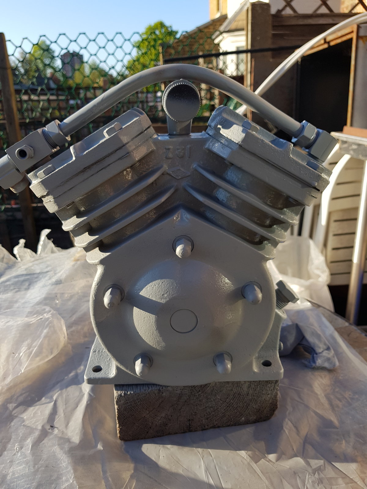

Cheers Mat. Slowing heading towards final assembly time. Maybe a couple of weeks, weather allowing. Then I suppose I'll have to crack on with my rotary converter build, or the Bambi, or finish my stick welder mod, or fir the DRO, or or or...![]()

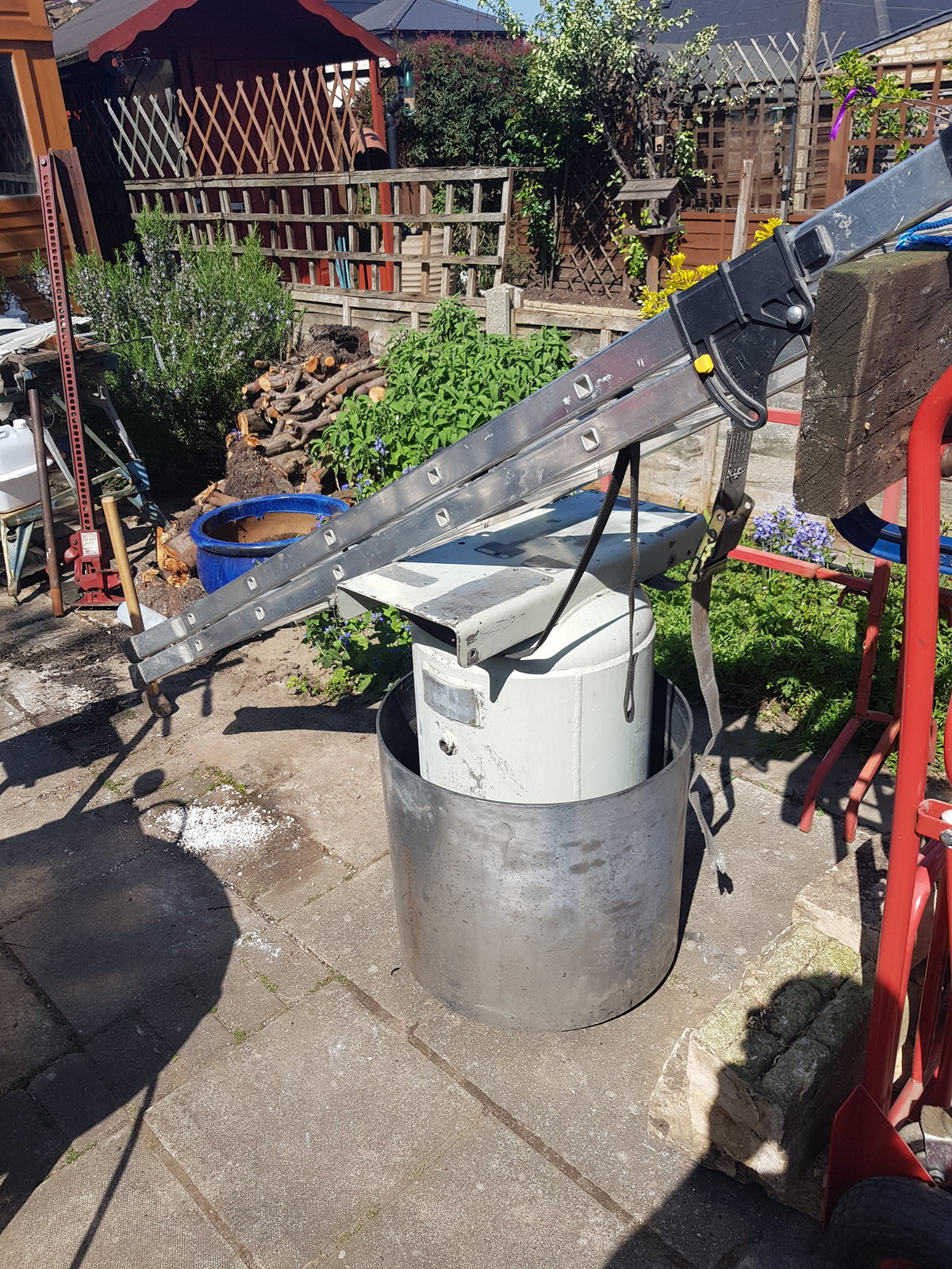

Being an old motor it used a 3/4" conduit thread fitting for the cable entry point.

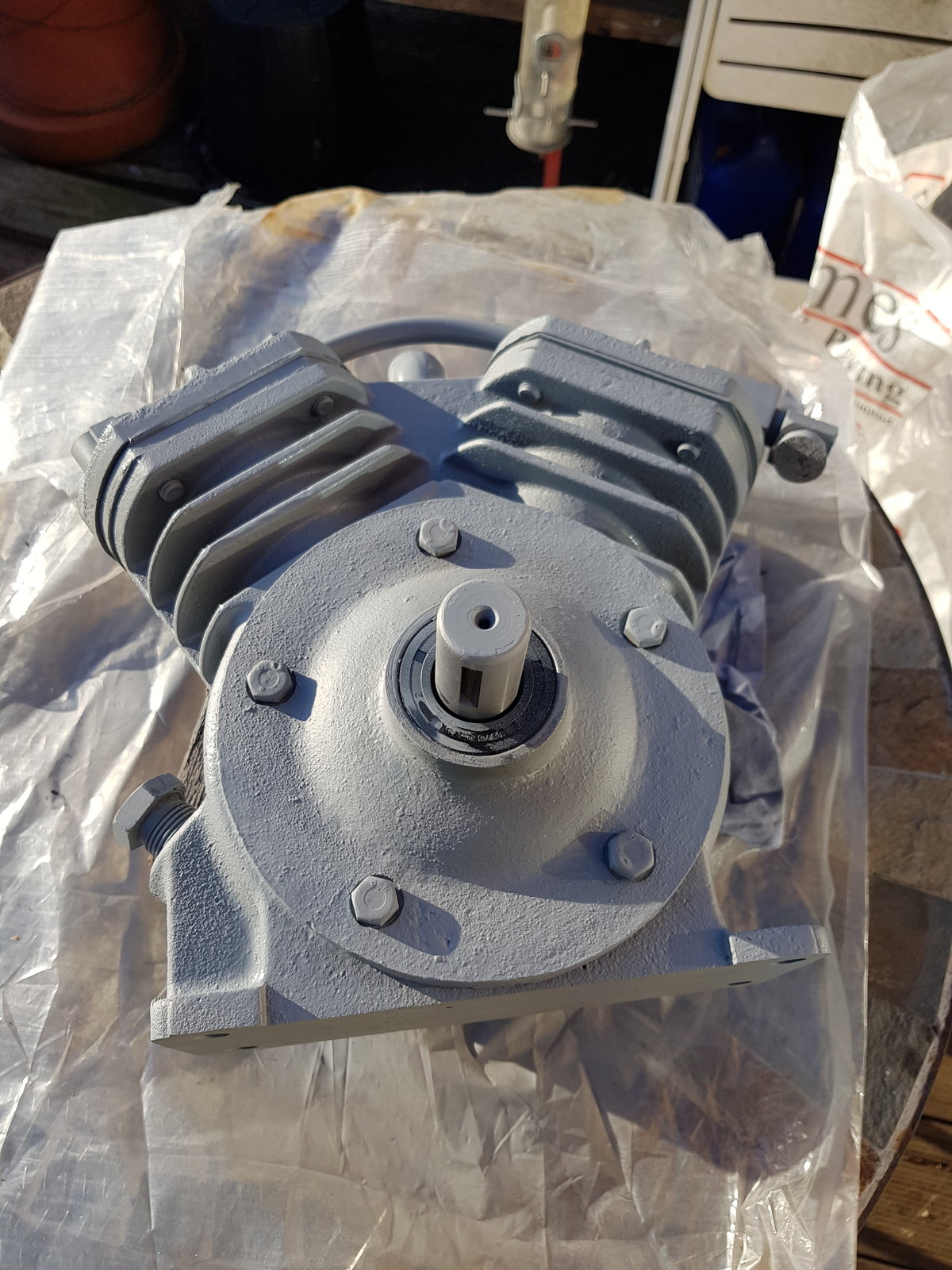

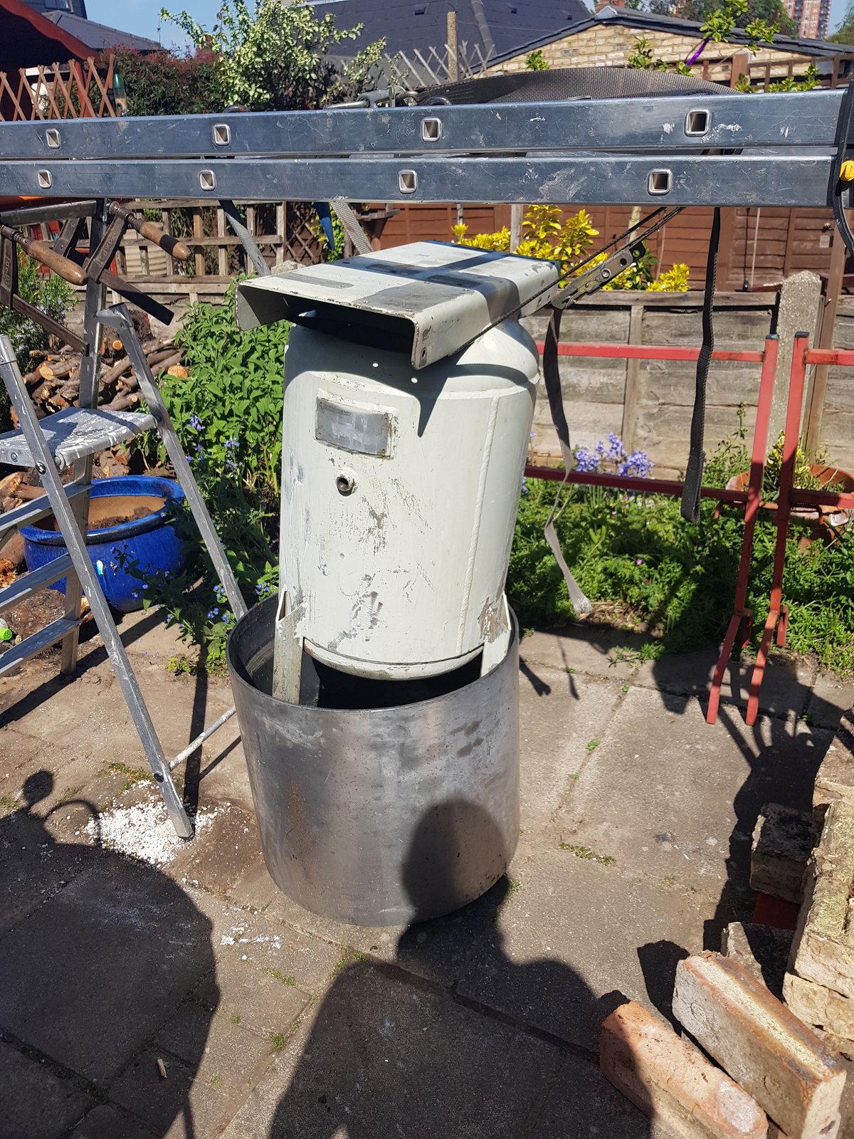

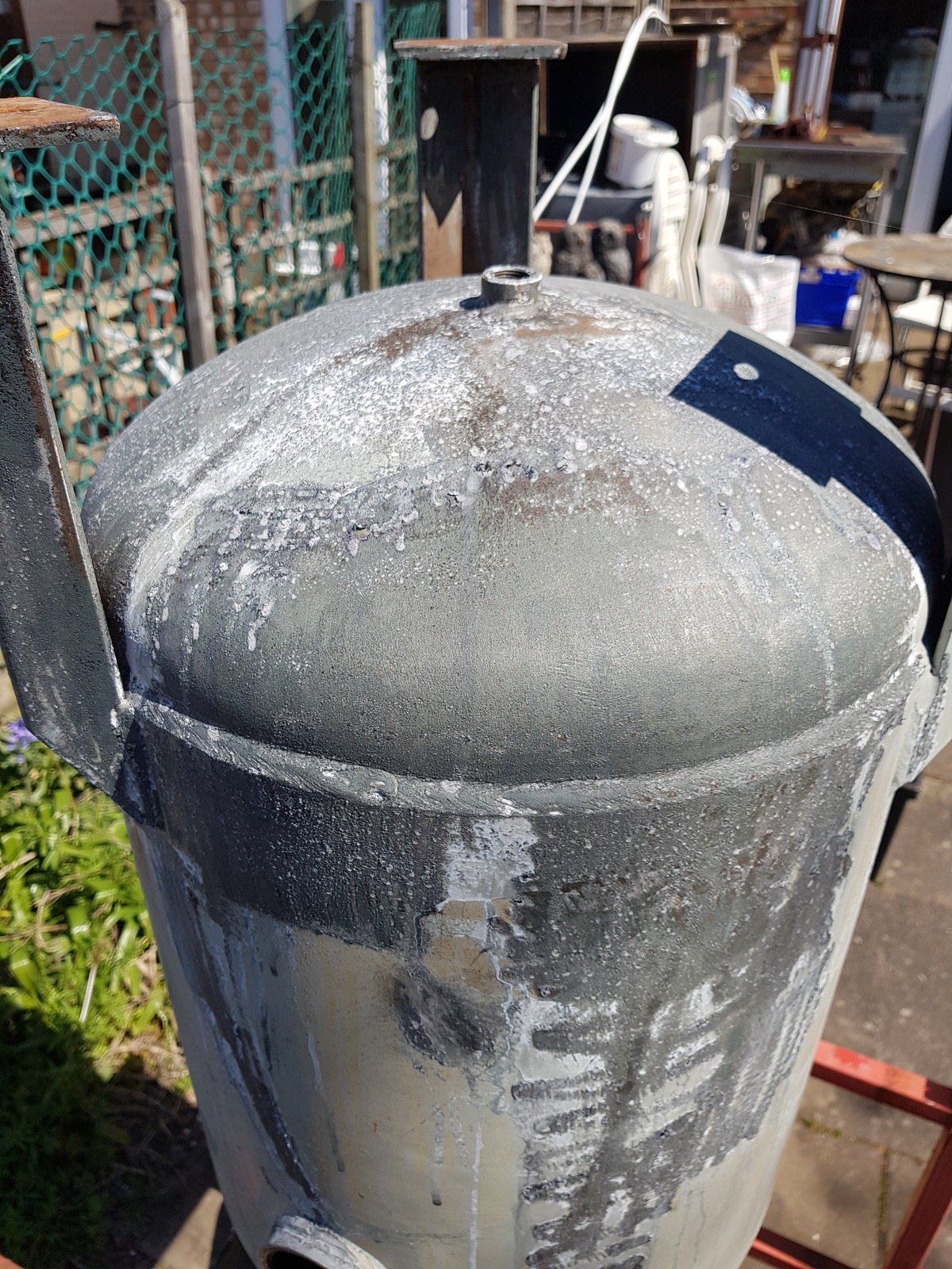

It's an enjoyable project, apart from the painting. I never get a finish that meets my hopes. I wish I had a spray booth.

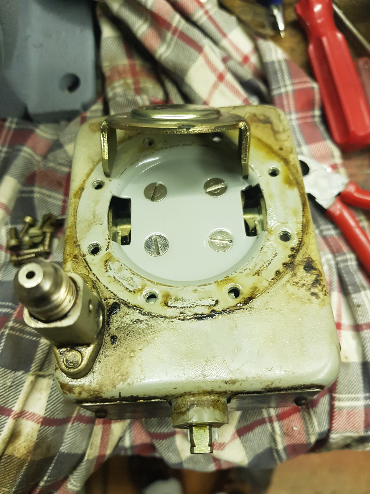

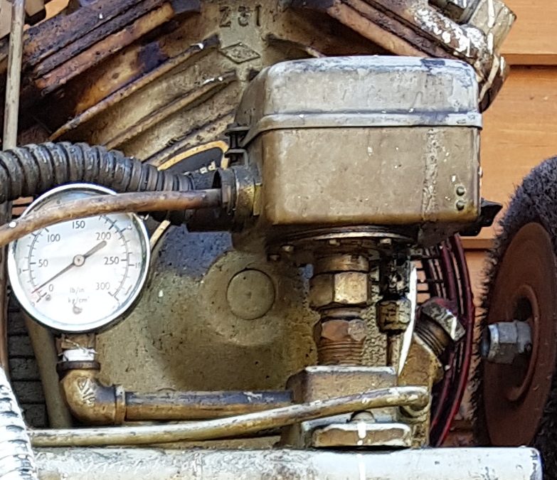

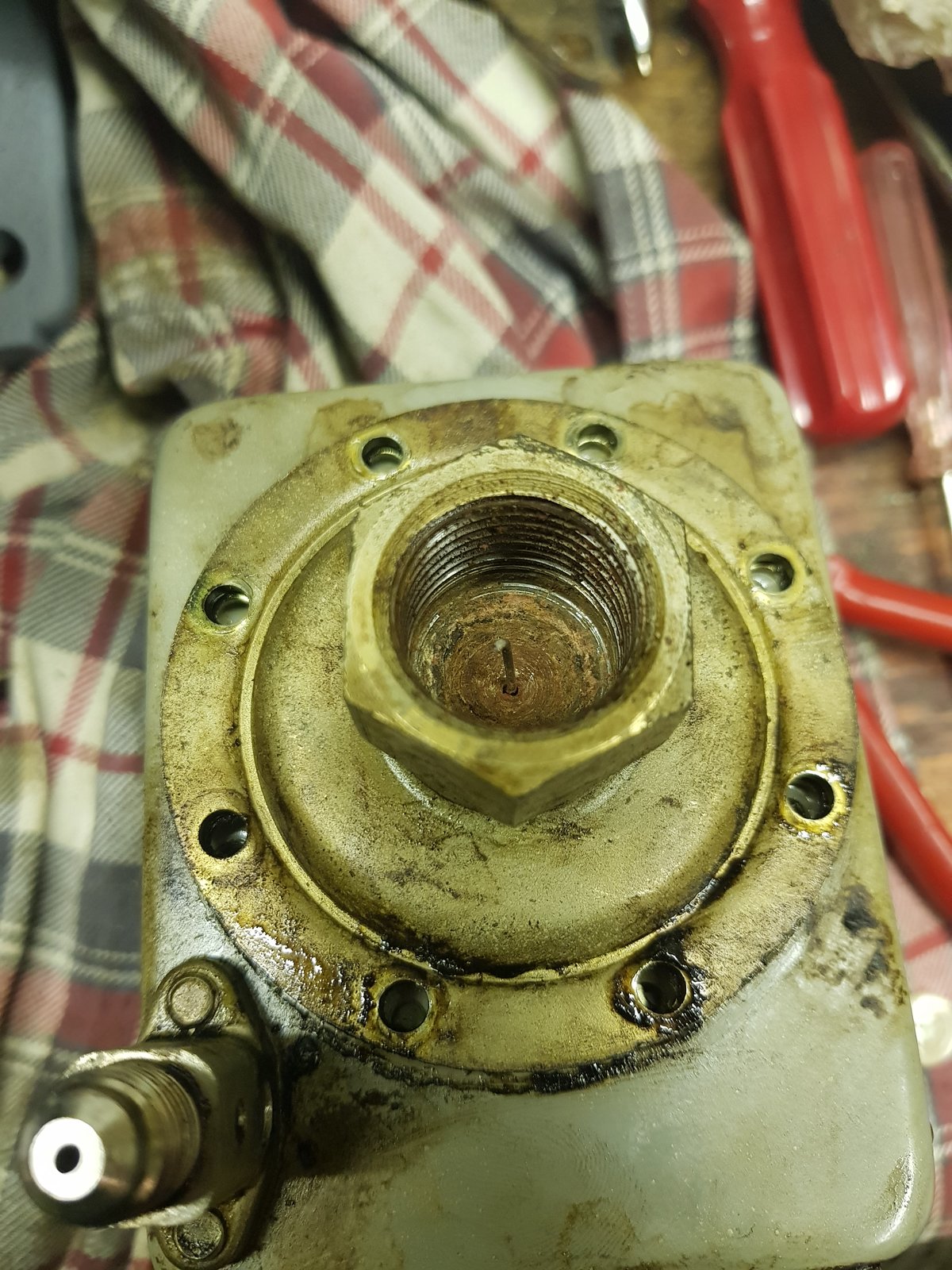

Have literally just taken one of these off a compressor, switch is broken but you are welcome to it for spares.A little more progress. I decided to attack the pressure switch. It's a lovely Danfoss unit.

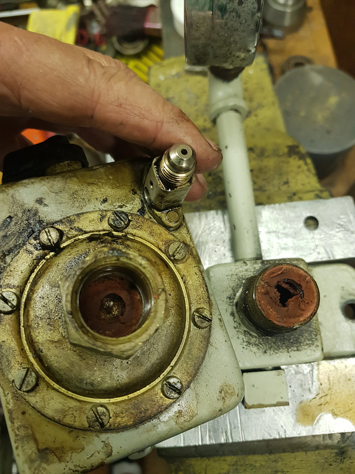

After unscrewing it from the base there was a lot of, what seemed to be to me, rust.
As I started to scrape it off it was obvious that it was the remains of several fibre washers or one very thick one.

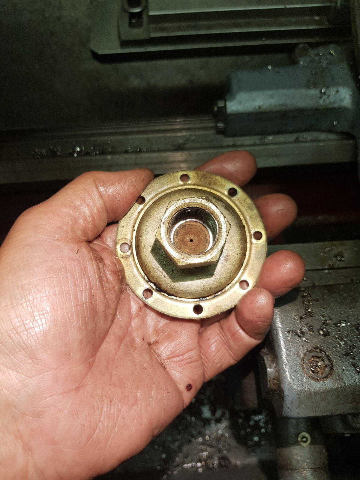

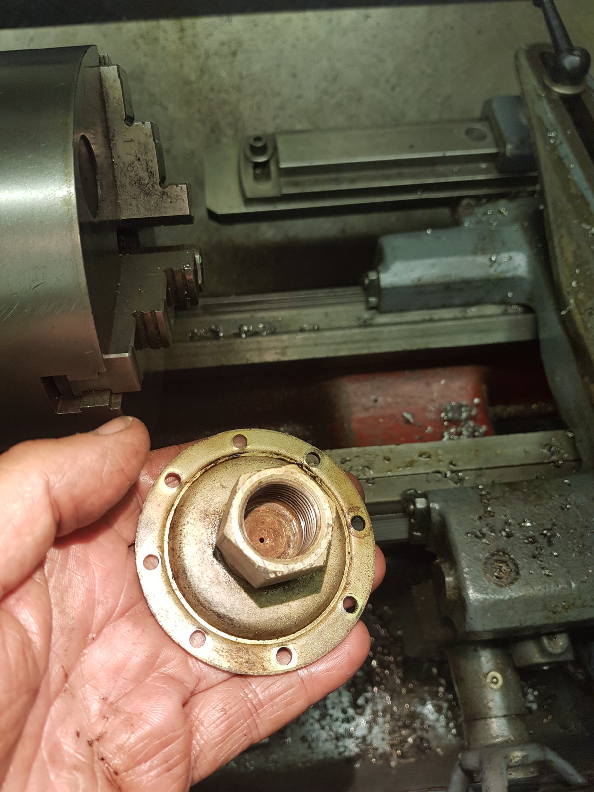

The seat for the washer has a small step, which doesn't run all the way round and then becomes a conical face. Not an easy thing to find a washer for I decided. So a bit of machining was called for.
Before
And after
My odd fibre washer drawer came up with a couple that were a perfect fit and the first thick washer that I picked up was the right size too. So that's sorted.

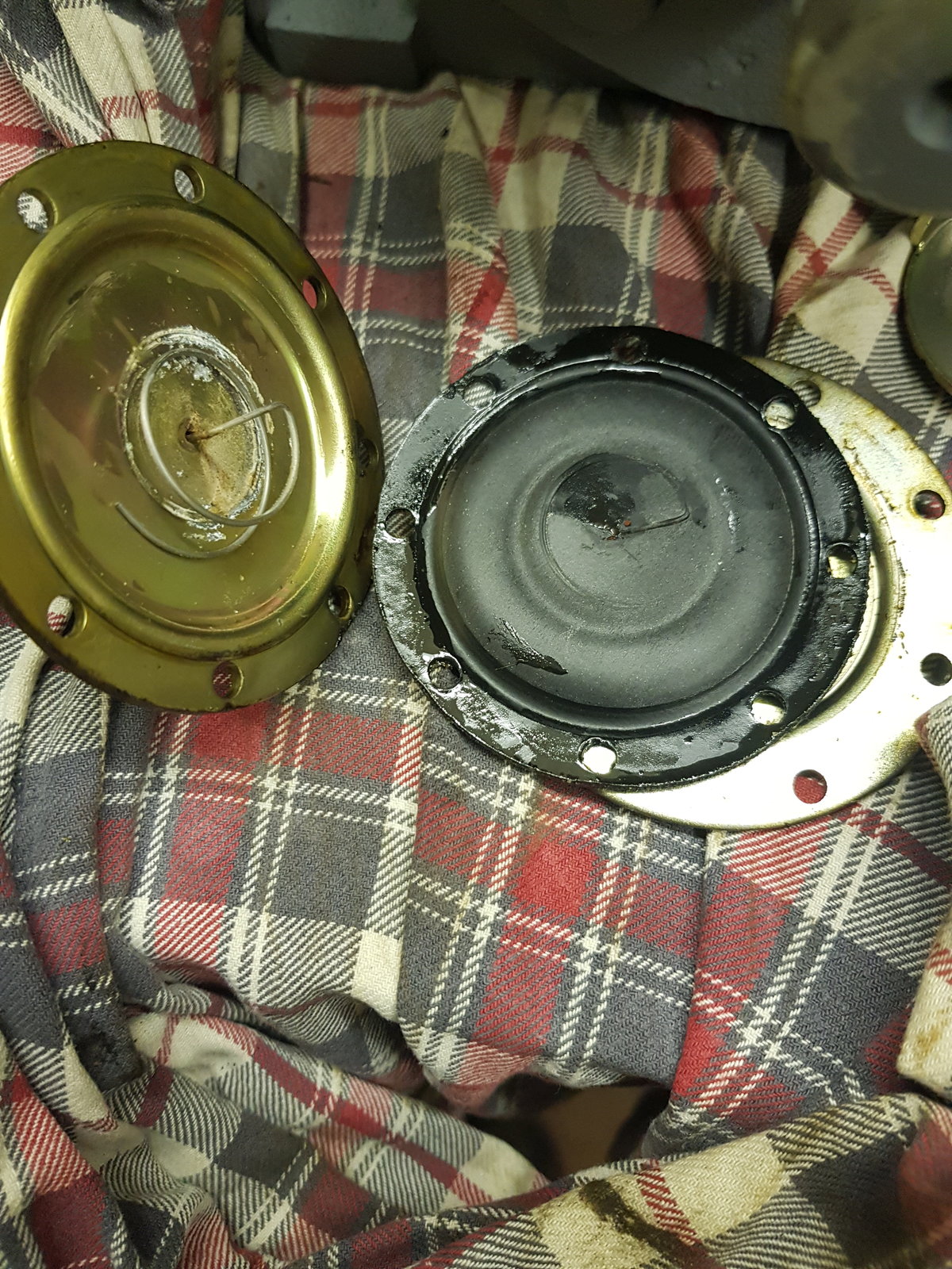

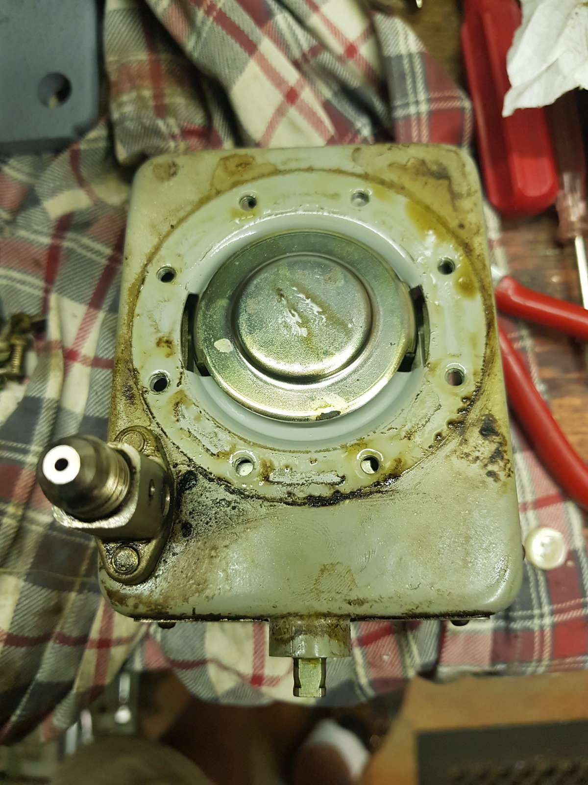

Next it was a just a strip to clean any muck out.
The diaphragm looks to be still serviceable, although there's a distinct indent where the small spring has sat. I'm not sure whether or not to leave this, repositioning the spring on assembly or, perhaps gluing a piece of thin rubber to the surface for reinforcement.
The diaphragm pressure plate hides four screws that retain the mechanism

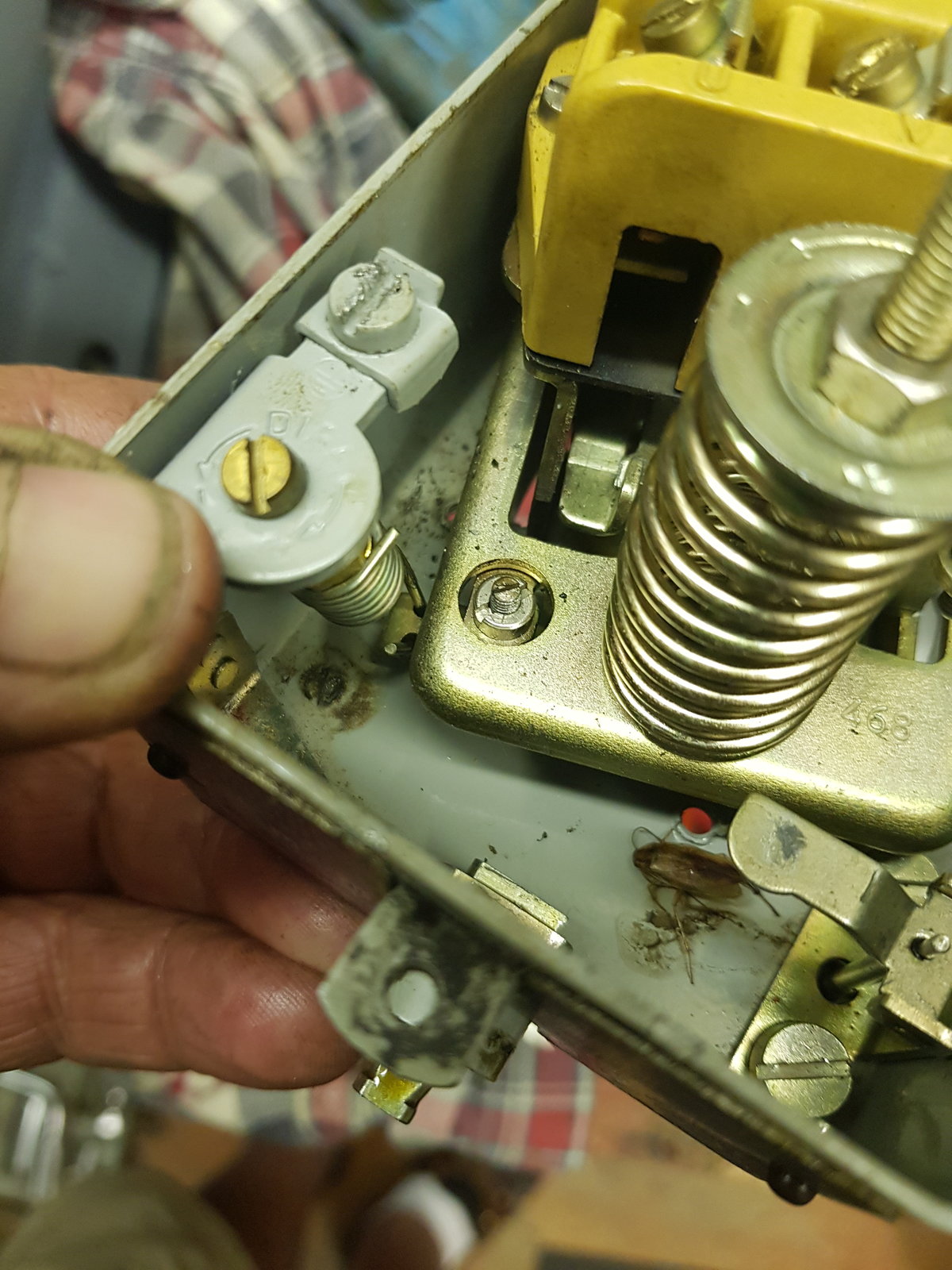

Detail of the differential adjustment spring and a house guest
