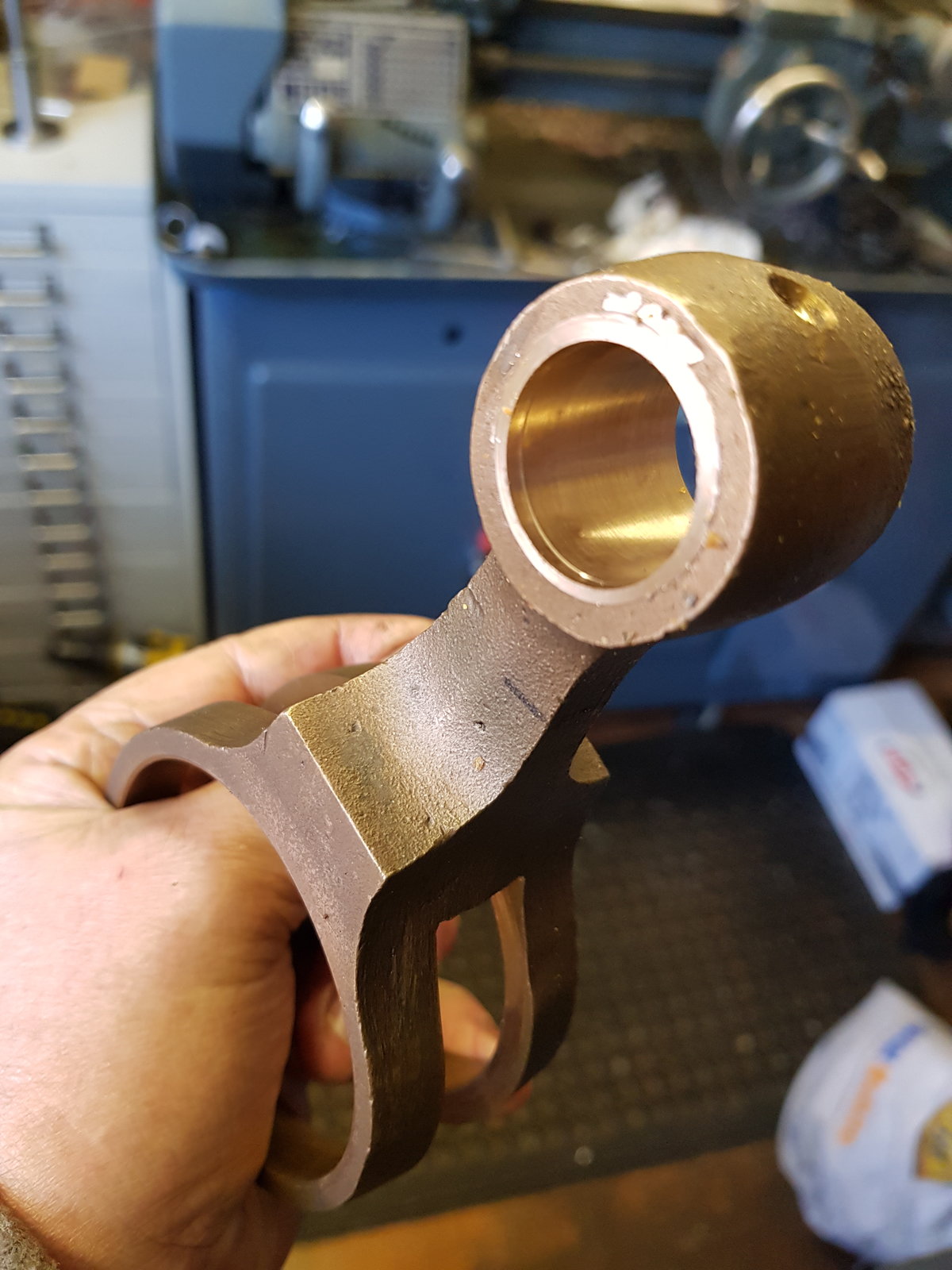

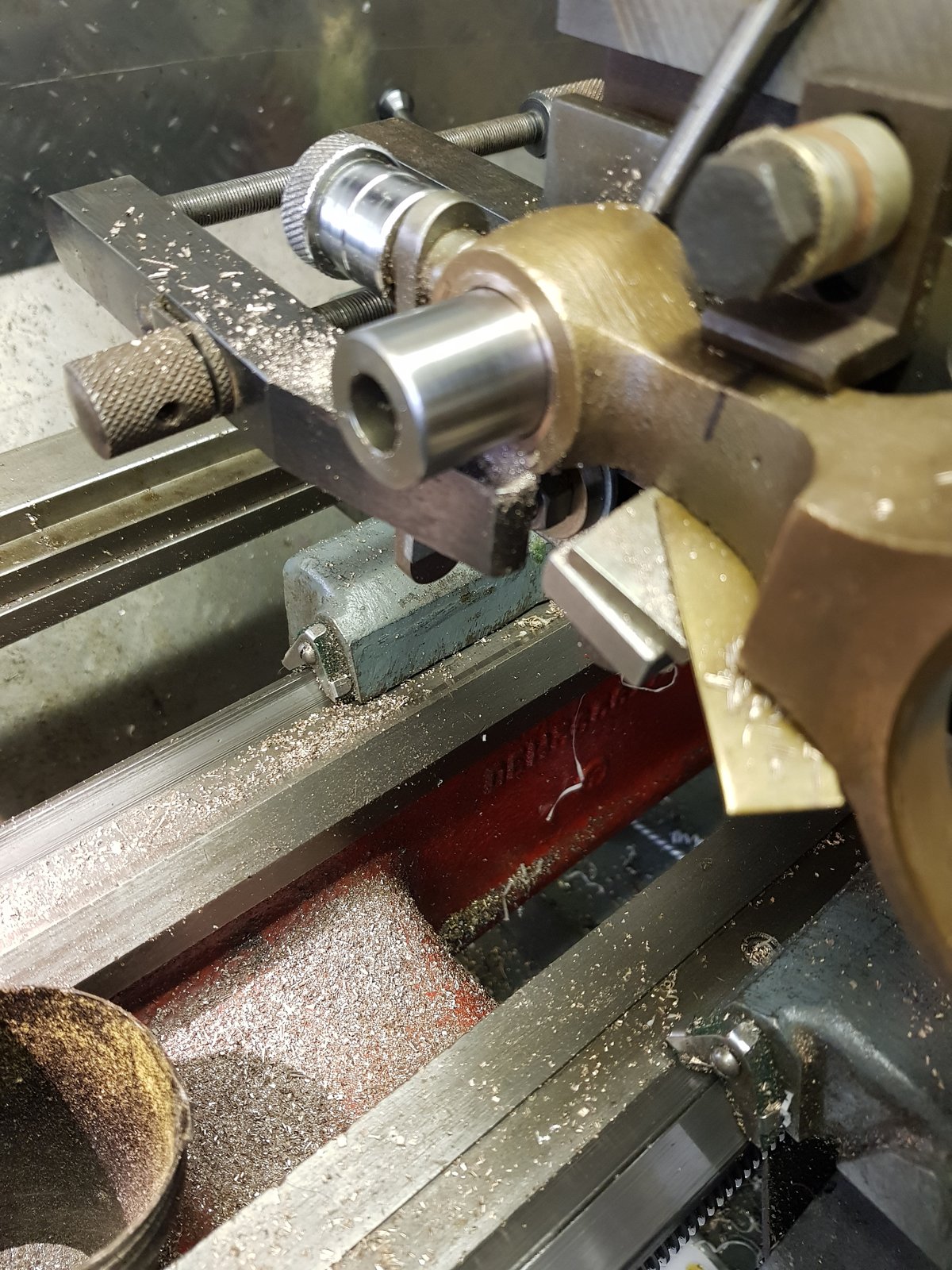

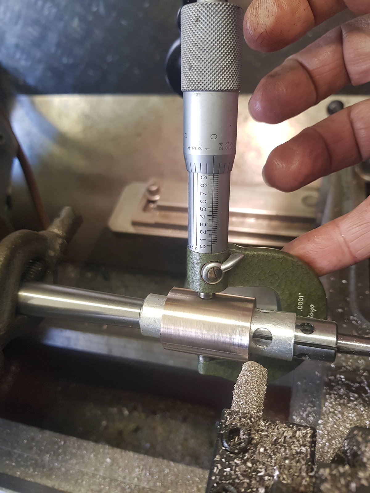

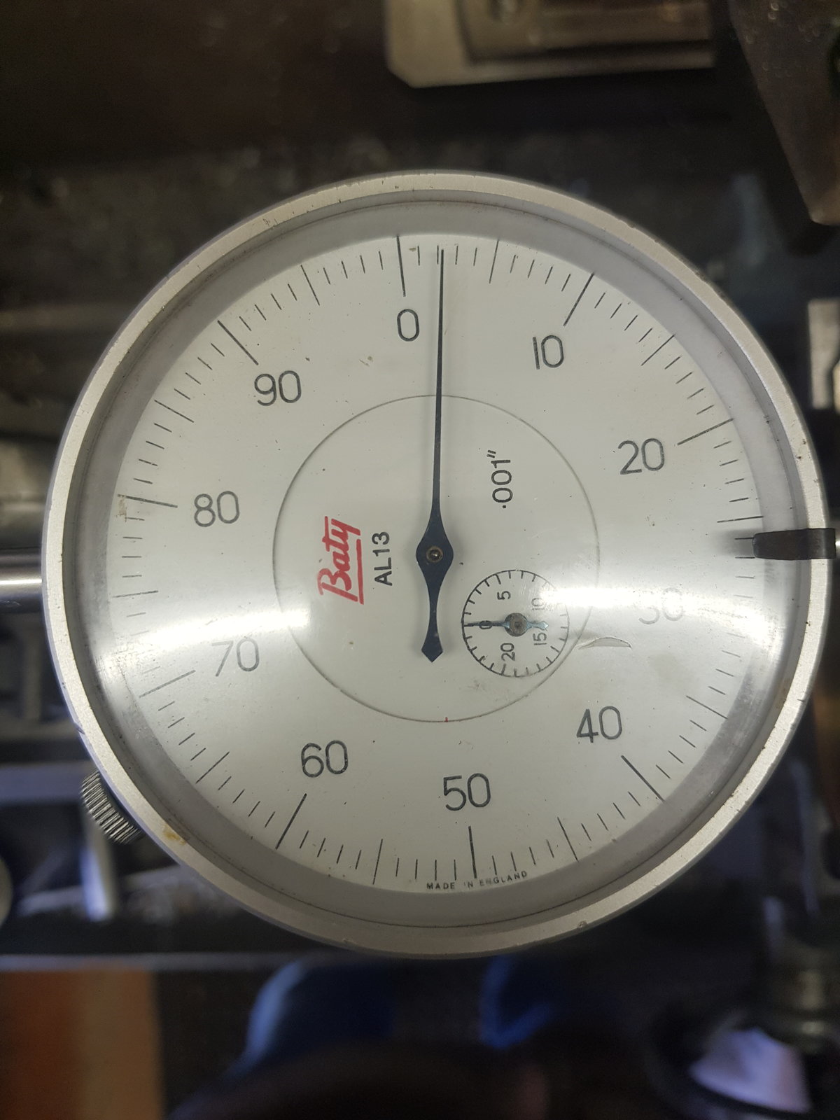

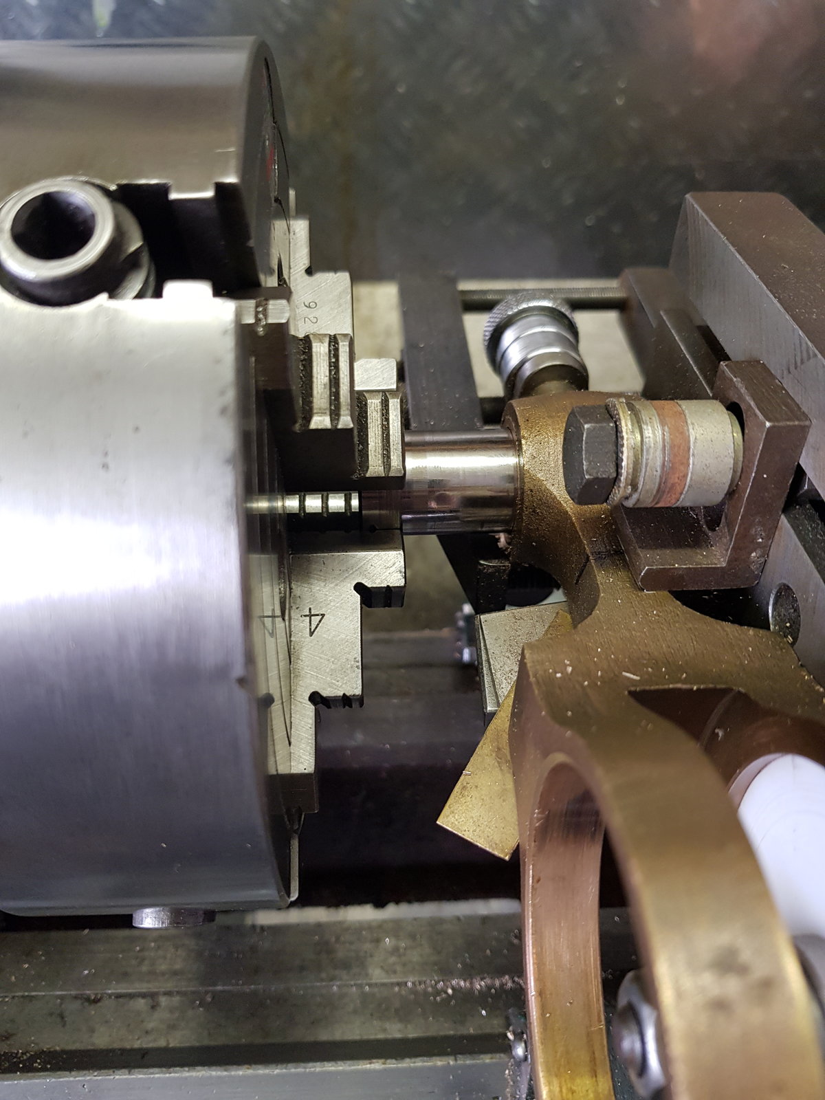

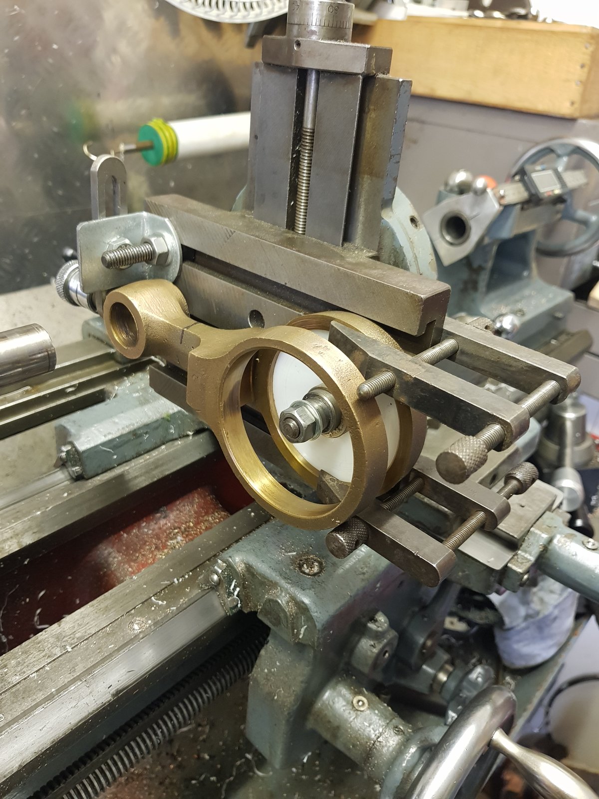

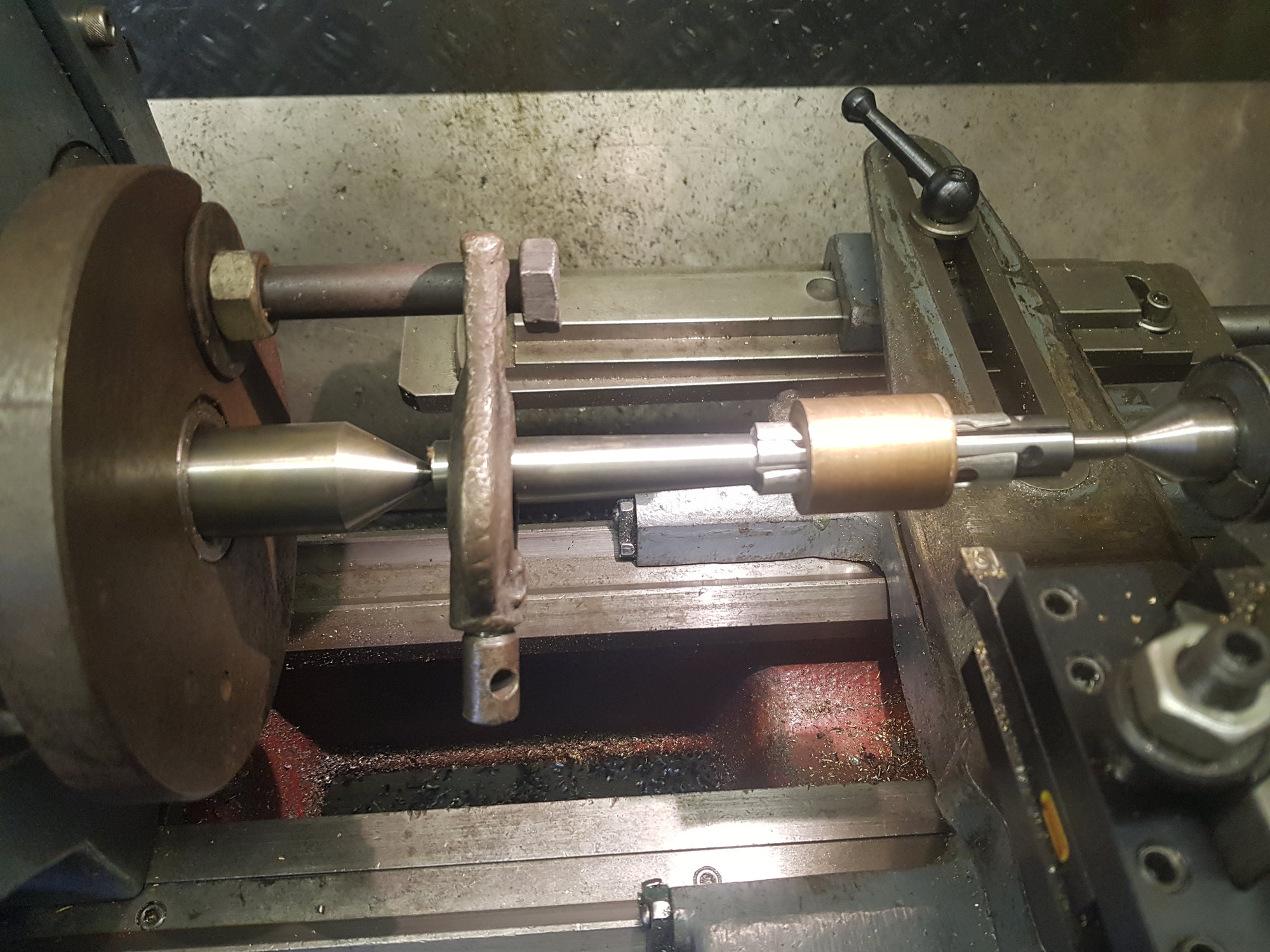

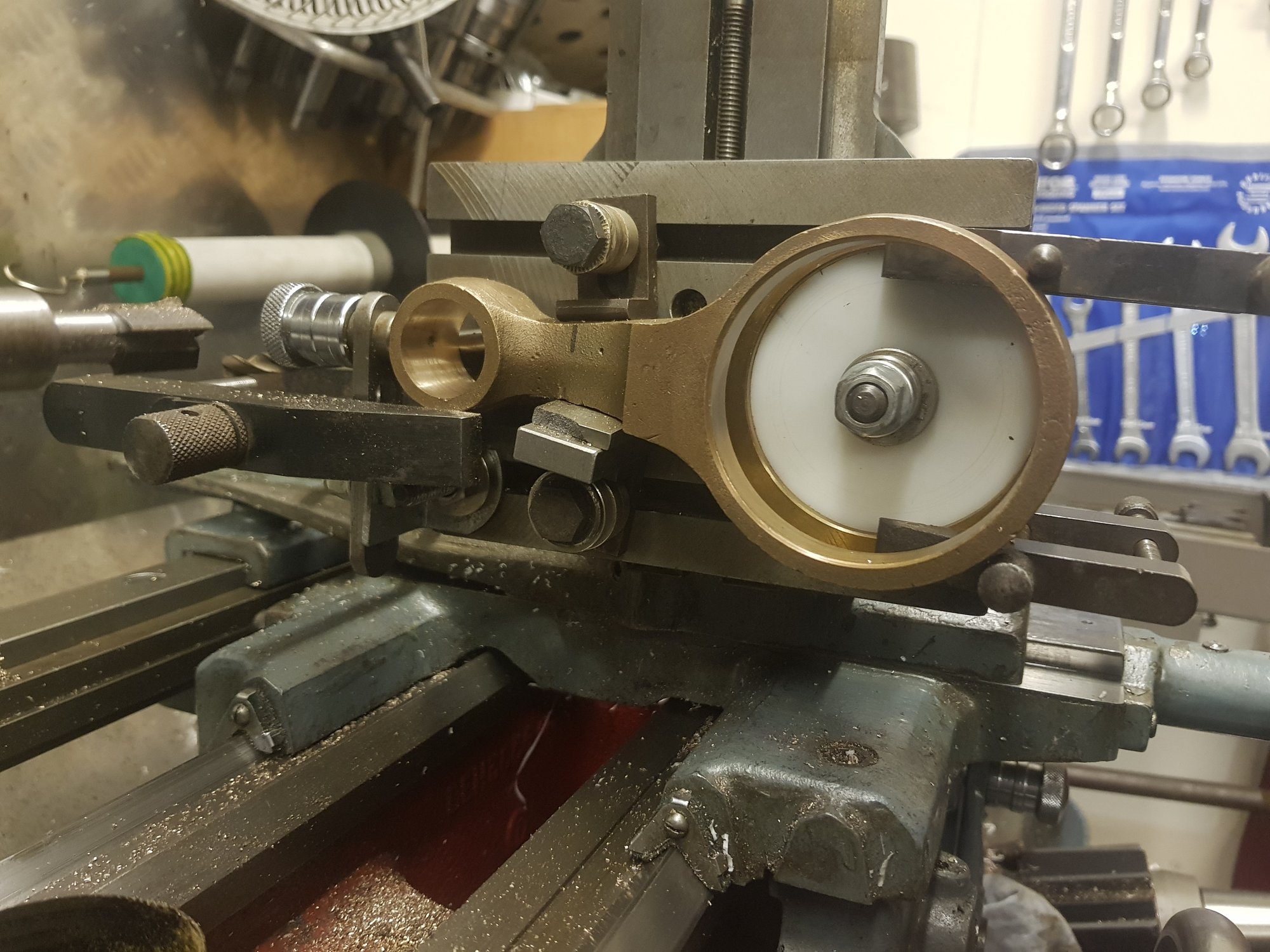

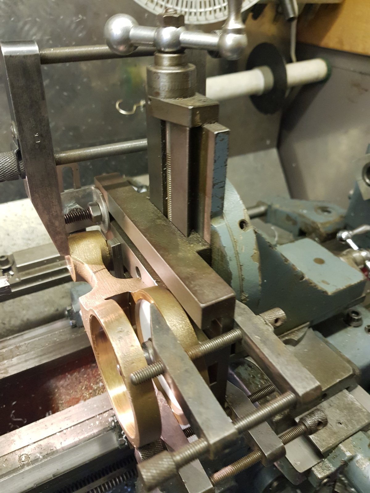

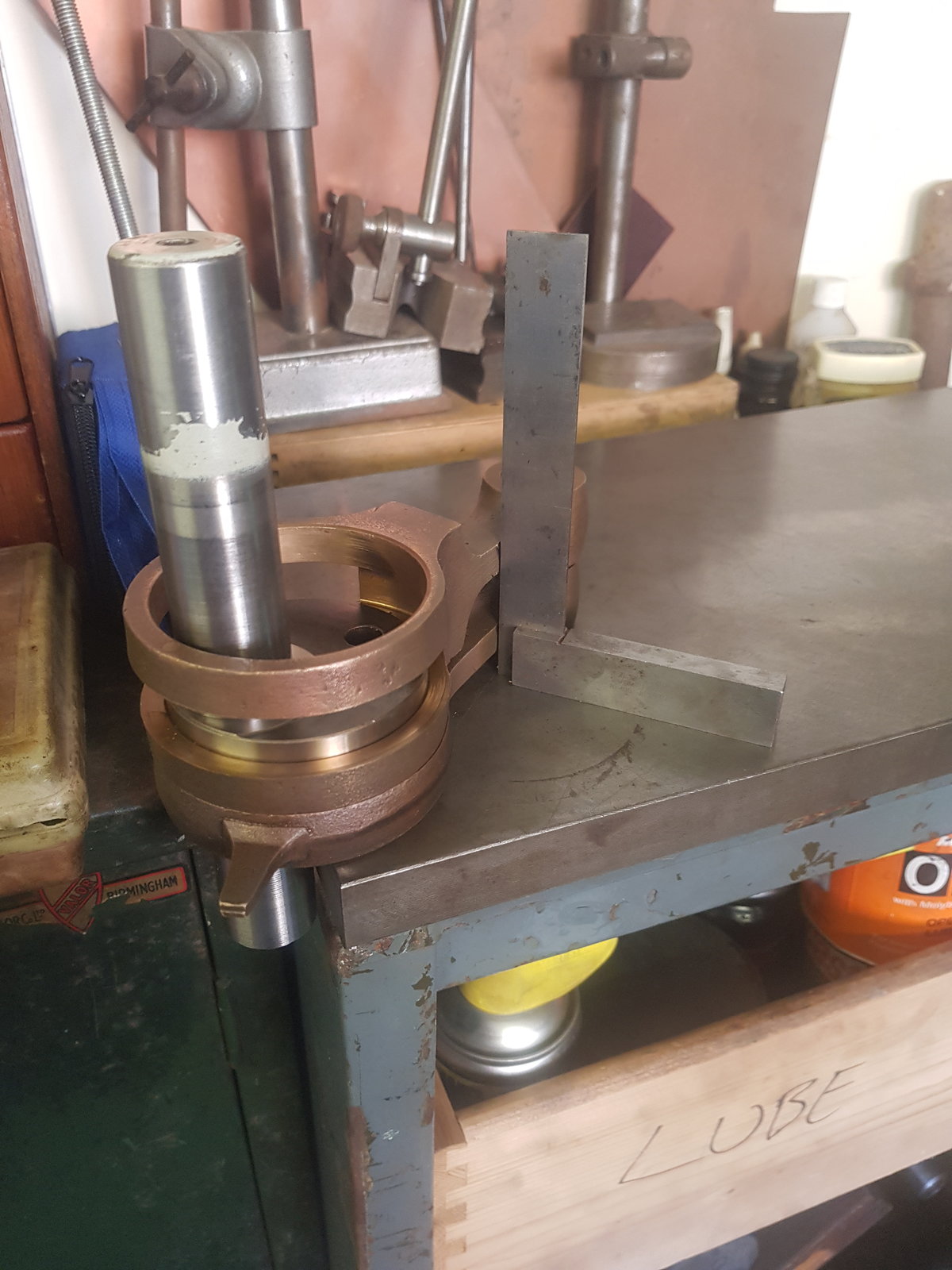

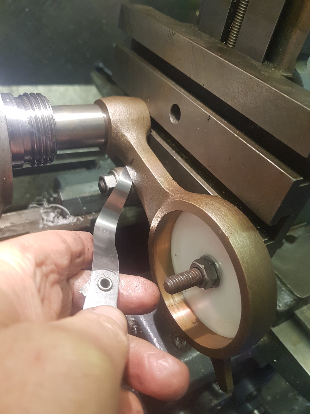

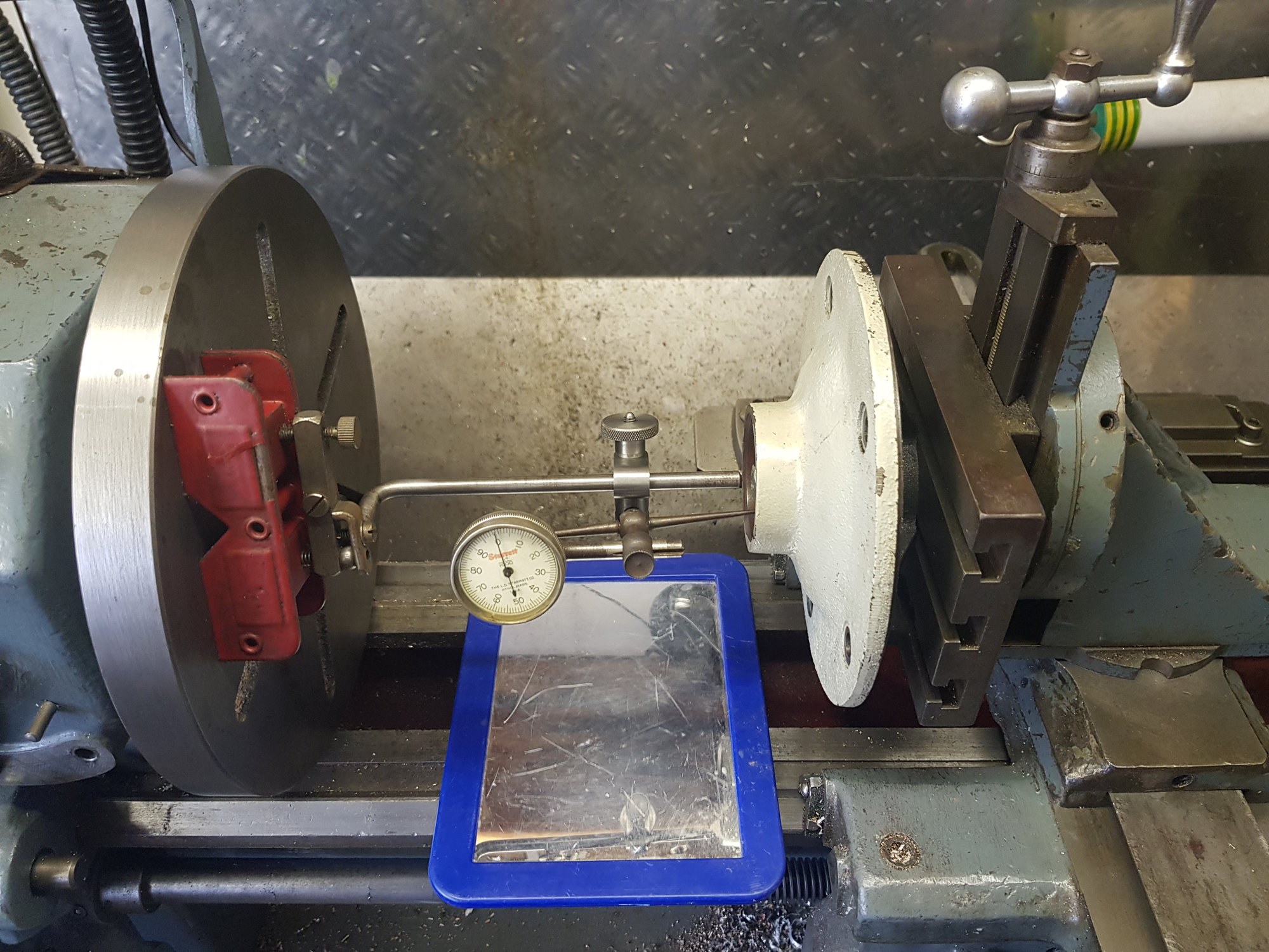

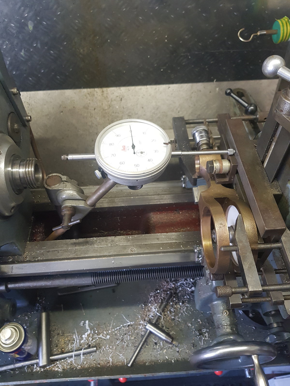

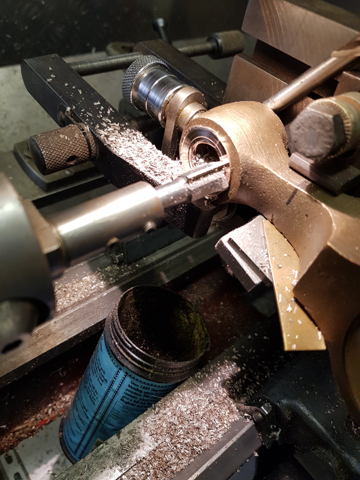

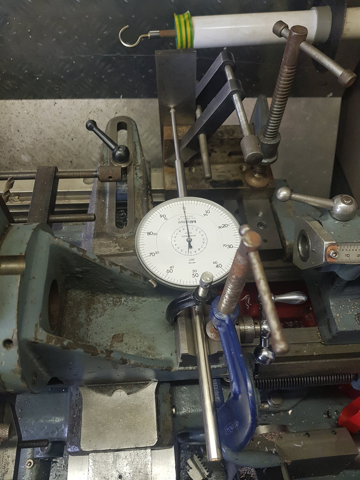

My brain is currently in meltdown because I've spent the last four hours trying to work out how to accurately position the damaged rod for boring. I only have a lathe and a pillar drill and a recently acquired boring head. Plus odd milling slides and some long travel DTIs.
I might have to pop into "The Bar" for a couple to relax![]()
Thanks @Migmac
It's all about having at least a basic understanding and obviously the kit. I struggle to do things with the odds and sods I've collected over the years. A lot of time is spent just trying to work out how to do the job. the job invariably takes a fraction of the time that I spend setting it up. I'm now at the annoying stage of having to wait for stuff in the post, something that I hate, especially with the additional delays.
Still, fingers crossed it'll be running the tail end of next week.
i had some small ends finished on a delapena hone but what i found that grit from the lap embeds itself into the metal and wears the hardened pins
