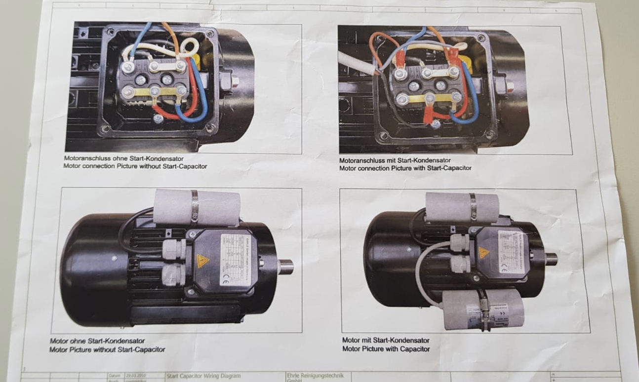

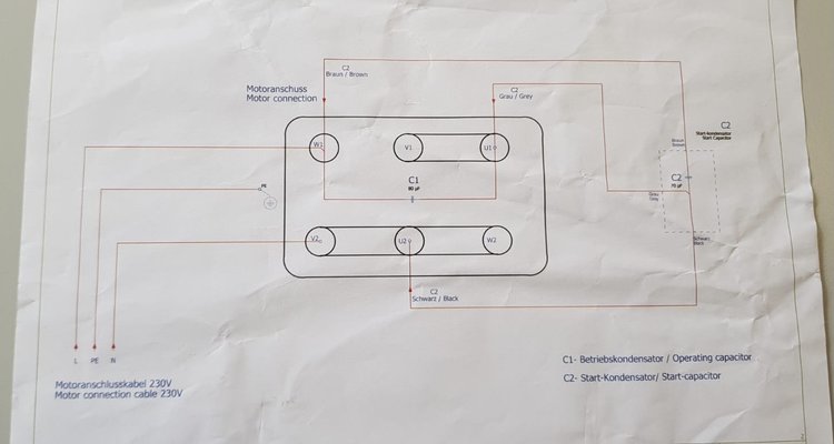

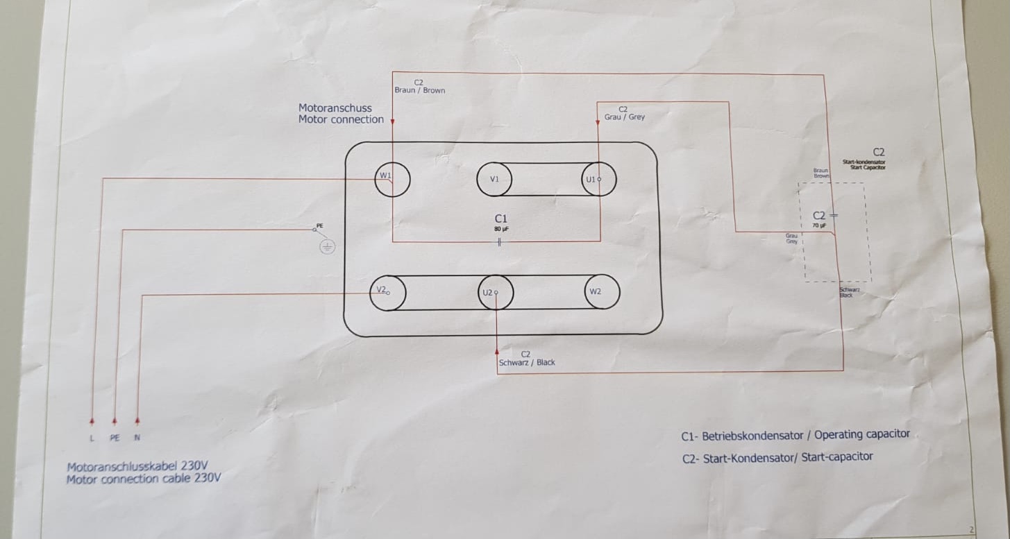

It does look like the one on the outside is marked 0-40uf and trying to find a rough translation of the text towards the bottom gives me the impression that it is 40uf for the first 1.5 seconds then reduces to possibly 0 when the motor is running. The time that this can be repeated is every 6 seconds possible with the lower line. So the 60uf in one @mm289 would be the correct one and the 0-40uf on the outside is just used when the motor starts. Like having a centrifugal switch inside a motor but without the additional cost of fitting the switch. So at start his would be 100uf then once the motor has started it would then reduce to 60uf. The one I have here does measure 40uf but I’m not sure how it could be tested when operating
Thanks @carbon that's great info. I think I will start by replacing the 60uf as that looks a bit battered anyway and see if that fixes it. I saw on the pic of my external cap that it was noted as 0-40uf so your thought of it being a start cap makes sense although I am no expert on this
Thanks for posting the wiring diagram, I am sure that will help when I inevitably find a thermostat or something is kaput as well
I've had a quick google search and I'm struggling to find a similar capacitor, I could be using the incorrect search term. All the ones I've found are just plain 40uf caps. If that 0-40uf is no longer available it could be replaced with a electronic motor start capacitor relay and a standard 40uf capacitor as it seems some of these relays have an adjustable timer
Got the new 60uF capacitor this week from RS and fitted it today. Bingo, started up straight away

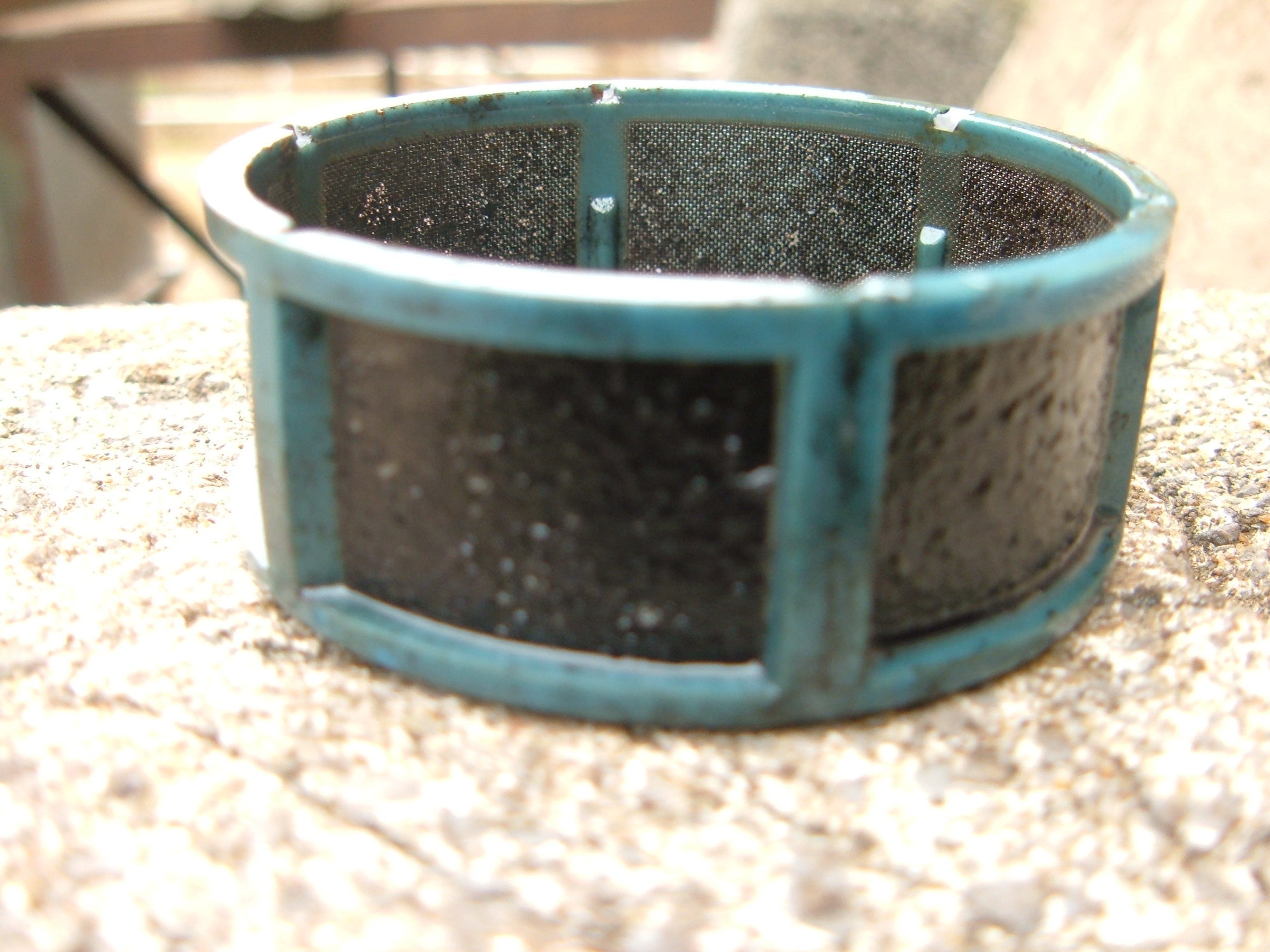

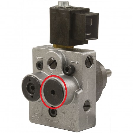

There is a small filter in the fuel pump that may need cleaning

Thanks for the tip on the filter, didn't know that - it has an inline fuel filter as well but thats pretty cruddy
I think it needs to be correctly orientated to fit back together, rotate the filter when refitting it then fit the cap afterwards
A lot of fuel pumps have internal filters, some larger than others some more difficult to find. Some can look worse than this one

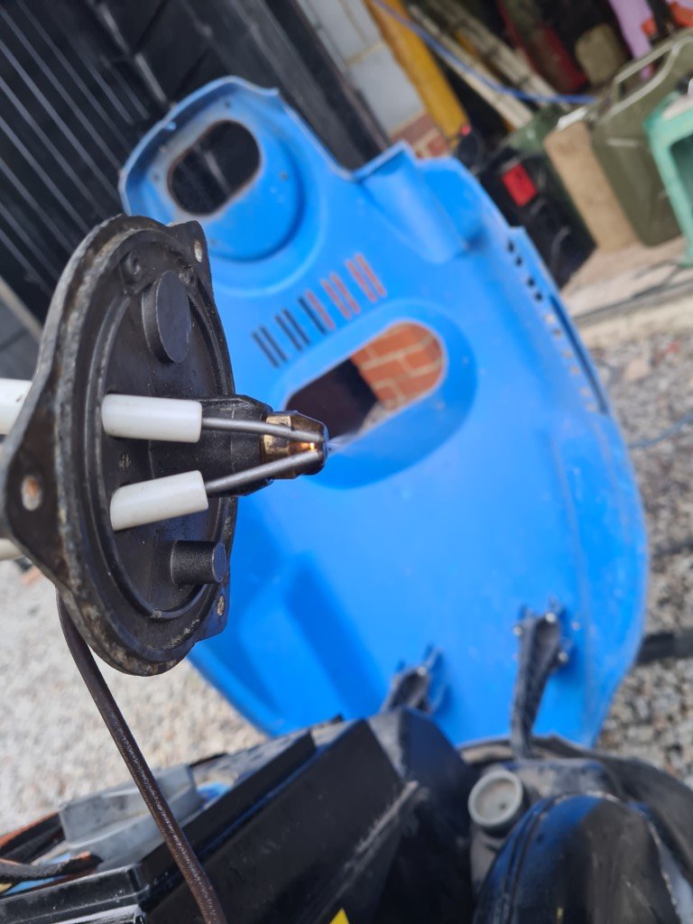

All reassembled and runs fine, but struggling to get it to ignite.

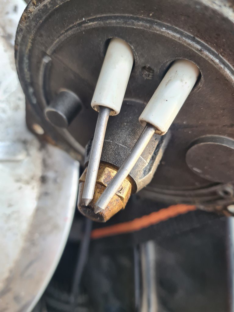

First up the electrodes sit at the side of the nozzle and don't seem to be near enough the mist to ignite it.
Also the electrodes will only arc if really close together, like 2mm and they are arcing only between the end of the shafts not the tip, which I think is because the arc isn't strong enough to bridge the larger gap between the tips.......
You can see the arc if you look closely at the pic below and also the diesel mist
So whadya think? Wrong electrodes, new electrodes, new coil.......... so close but so far
Only on my phone so can’t see the picture to well but nozzle needs replacing to start as doesn’t look to be spraying very well. When the top of the burner is back in place the air flow over the electrodes will move the spark off the end of them.
pull the leads of to the electrodes hold them apart and fire up see how far the spark jumps if its a good distance its the electrode insulation has broken down and shorting
