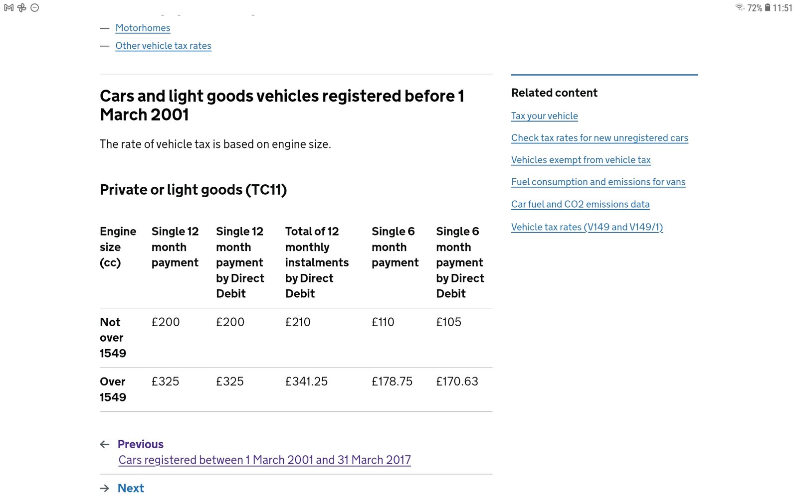

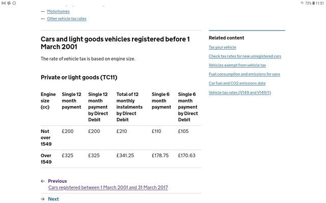

Just screenshot this off the .Gov website
I'd think a post 1 March 2001 4.2 litre Landcruiser would be in one of the top two brackets 226 g/km + so nearly £700 tax a year!
If it's pre 1 March 2001 it's (only) £325!
