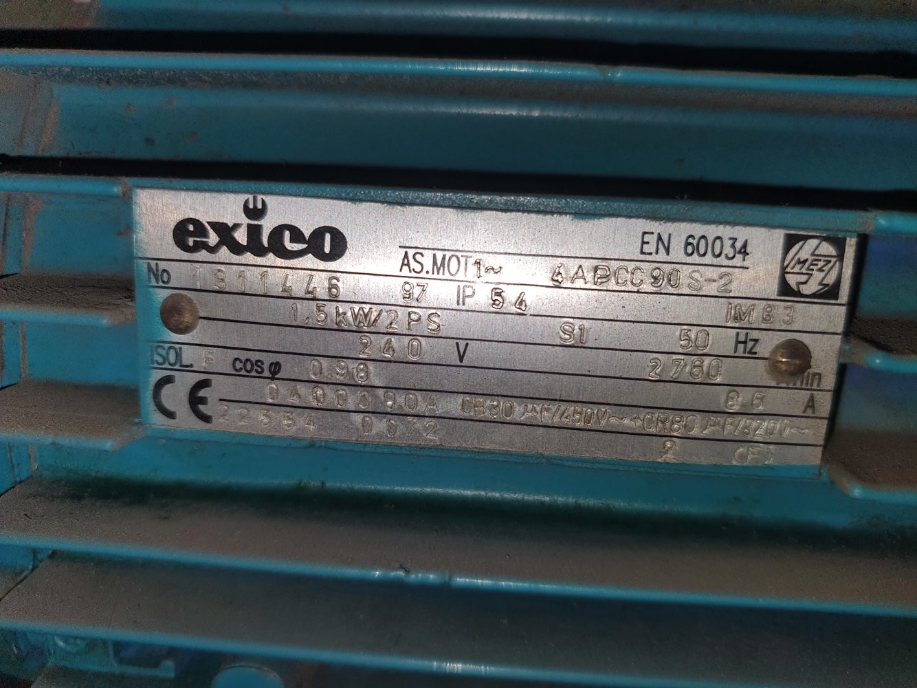

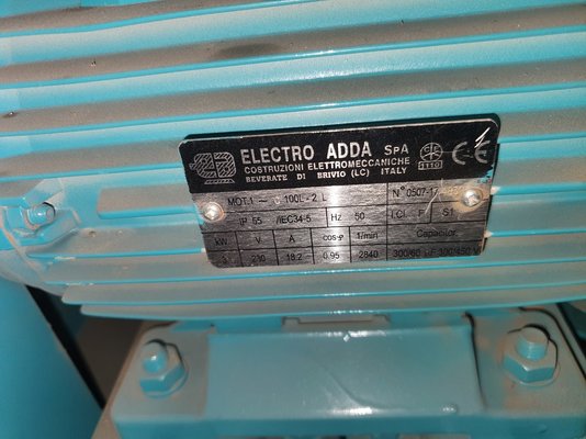

Are you saying i have a large tank ????
in actual fact, I have two VERY large tanks !!!!!!

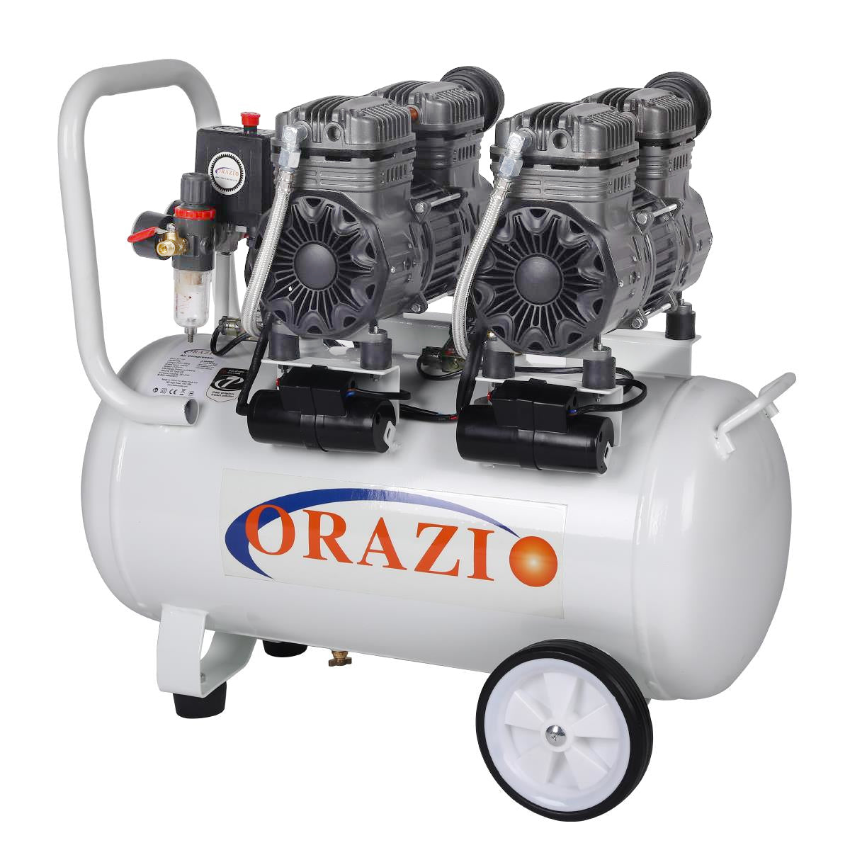

Would one of these be suitable for the odd small spray job like a kitchen table set of legs etc?![]()
Low Noise Silent Air Compressor 50L
Specifications: Power supply : 220V 50Hz 1100W (1.5 hp), Oil Free Tank Capacity : 50L Working Pressure : 8BAR Air Flow: 90X2 L/Min Air outlet:1/4 Start instantaneous power: 2520W. Dimensions:670×310×710mmNet weight:37kgwww.aimtools.co.uk
See what their other models specs are. I think they're all going to be similar, whatever brand.
