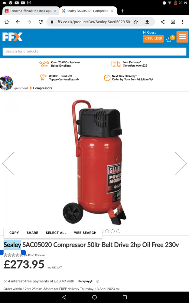

Now, I am not saying the post I will copy in, is correct, but I found this on an other forum, The chap replying to a similar question did test his own air compressor, his reply I will copy and paste below
Pasted "
Just ran up my 3hp CompAir for you.
Motor plated at 15A for full load (it's 20years old) General Electric old skool moving coil clamp meter.
Inrush on the needle peeks at 25A, running current is 10A from Zero psi.
A brand new motor would be made today with a much higher efficiency, but the pump being new would be stiffer to turn.
