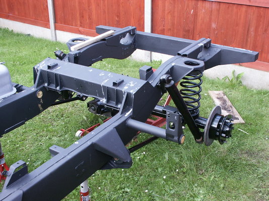

I bought a damaged new chassis. The damage was to the rear tank supports I wasn’t using.
I capped and welded up every hole in the chassis surplus the requirements, bar the loom holes, these were used to fill each rail with about a gallon of oil. The holes were then covered with access plates.
You can see a loom hole, bottom of picture with the 4 rivets
Note the expanding foam, in the jack points. I took that out
