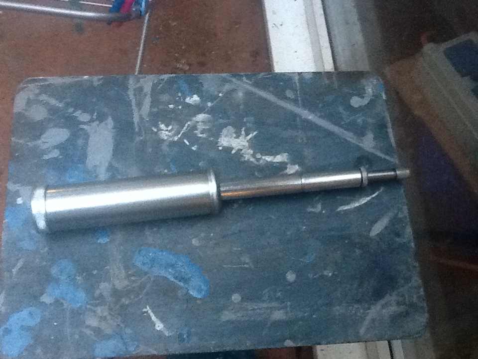

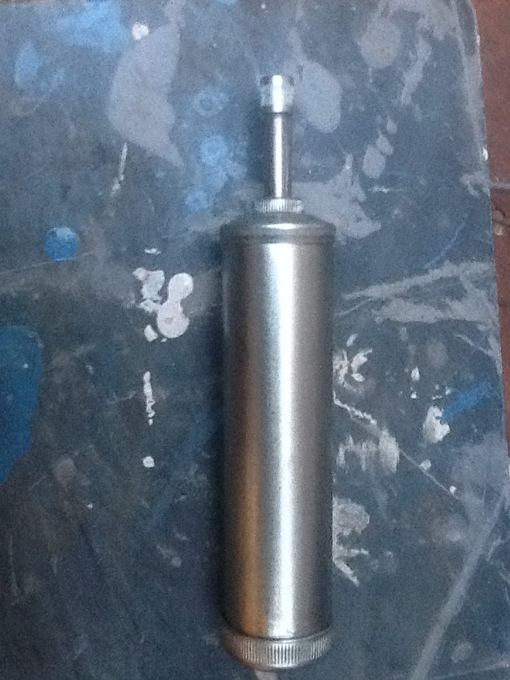

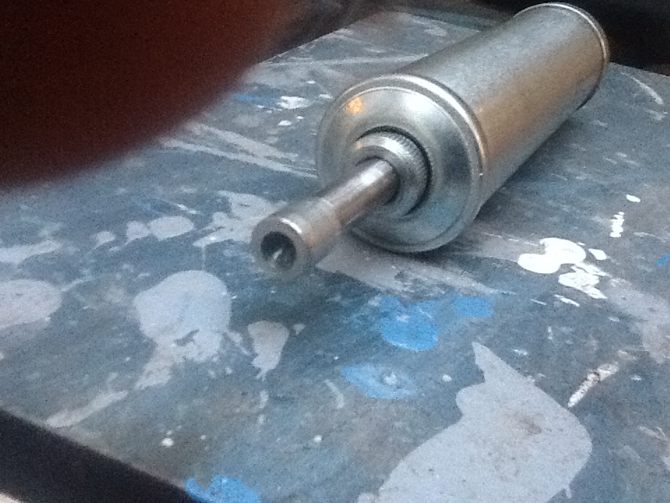

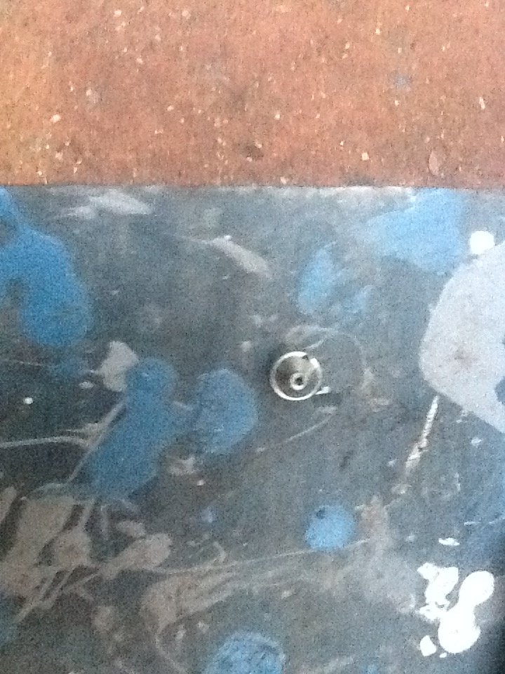

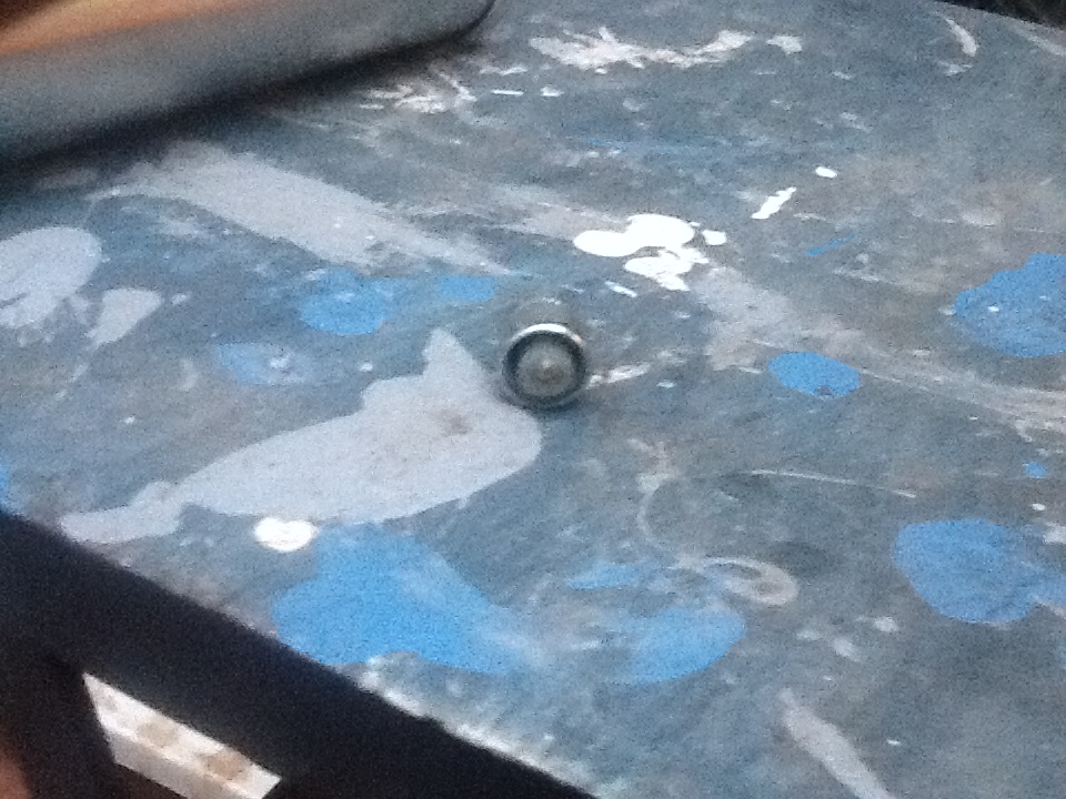

Just been out for a test.thanks not sure about that
Conical tip fits inside the ball oiler and compresses the ball enough to push oil in and seals well. Next to no mess.
The inside of the tips has a ball oiler which opens with the guns pressure.
Can't see any reason why it wouldn't do the job for you and it's cheap.
It's also telescopic. Big one extends to 300mm for awkward access.
