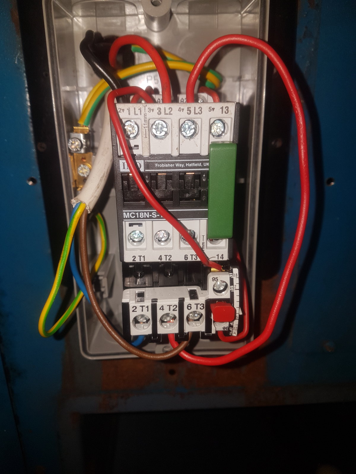

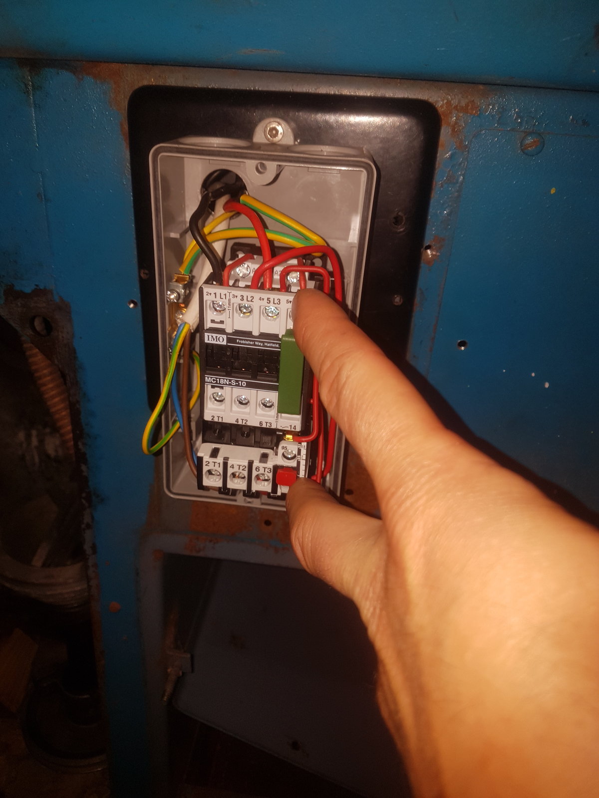

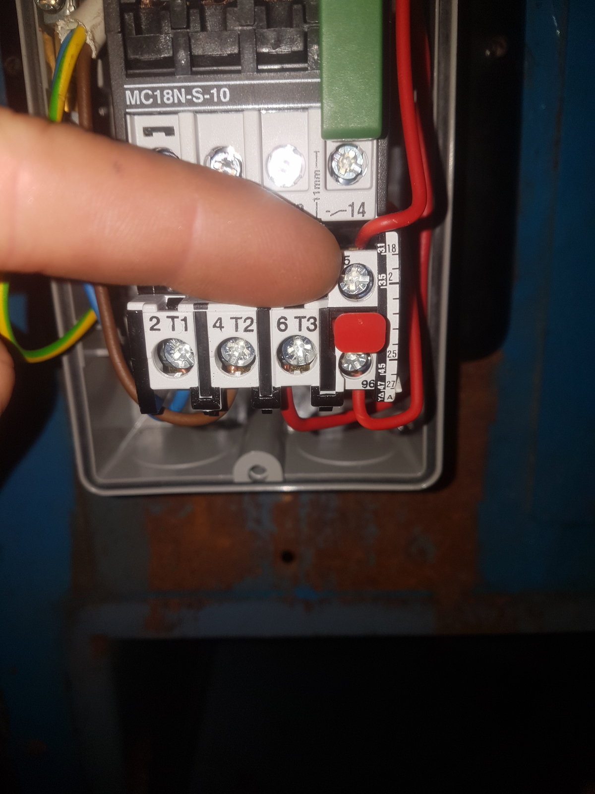

I'll have a lookThe contactor and overload are separate usually. Disconnect the overload and the motor can be switched.
If your in there anyway I’d change the cap as well even if it’s not causing your problem they are cheap enough and makes sense to do it while your on. You want the uf value and spec the voltage above what your motor runs. Most are rated to 450v.
Looking at it, that may have been specced for a 3-phase motor,
Hard to find anything else rated for inductive loads, so most will use them for single-phase too!It is a 3-phase contactor, so precisely that reason.

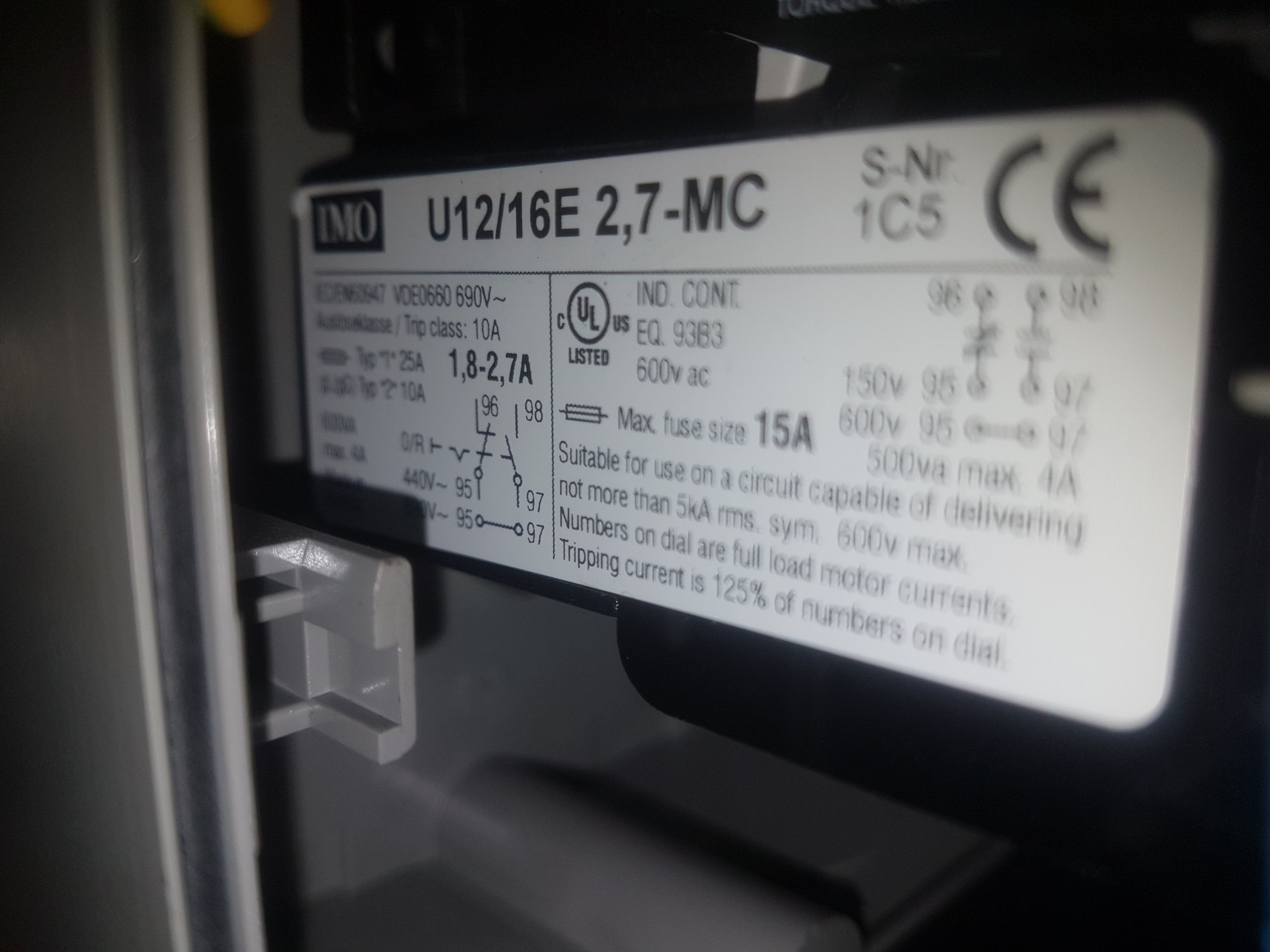

You could see if you can isolate the neutral from the overload and put the feed through all three in parallel. That would effectively make it a 8a overload instead of 2.7a

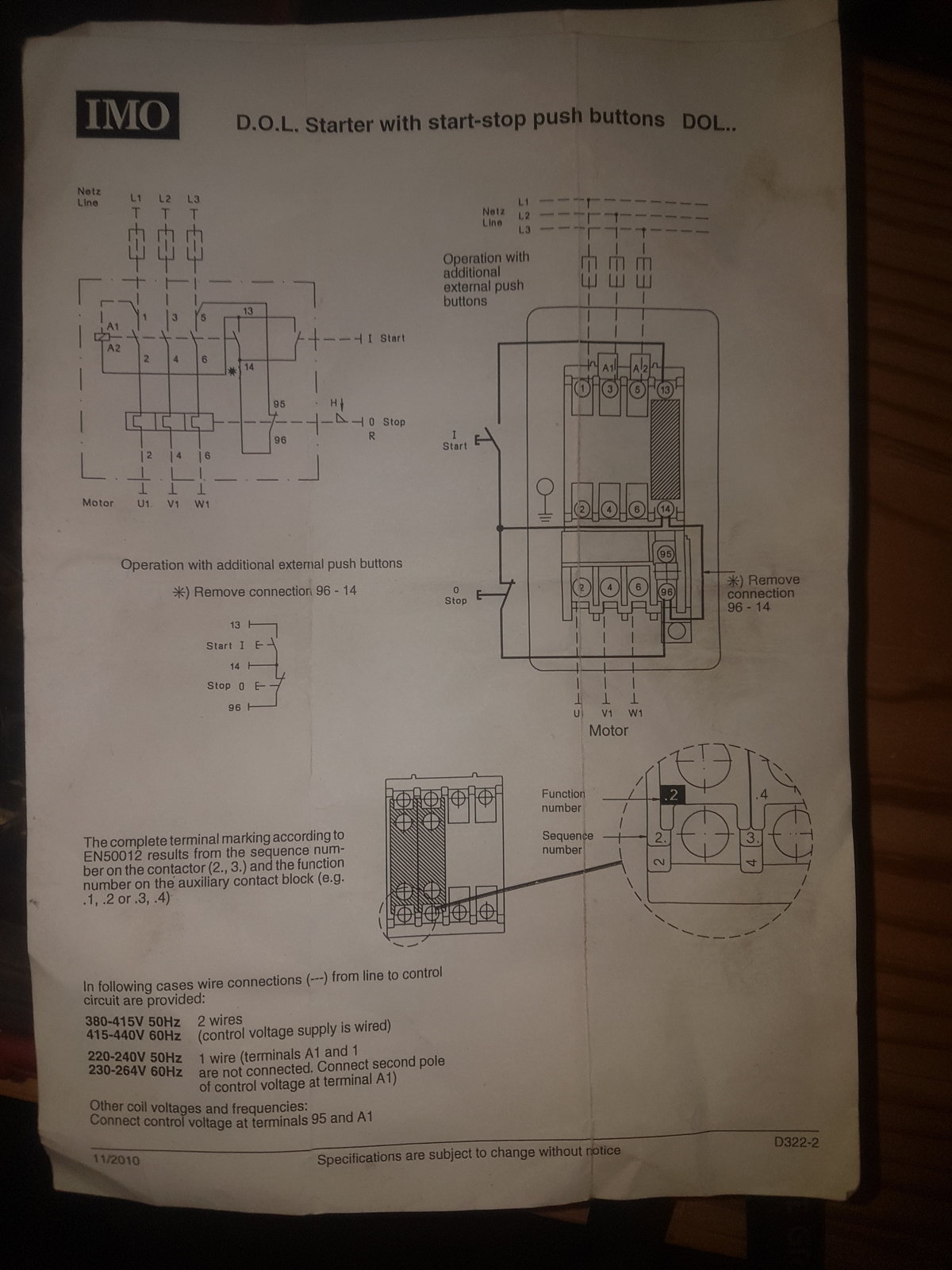

The destructions say it can be 1 phase or 3 phase the wire layout needs changing for each. It was also wired wrong according to the instructions but it still didn't change anything when I swapped them.aboutI dunno if it'll work or what hindrances there might be to it, It's just a suggestion. It looks like at the moment they have T2/L2 and T3/L3 wires in series. Dunno why that might be.
