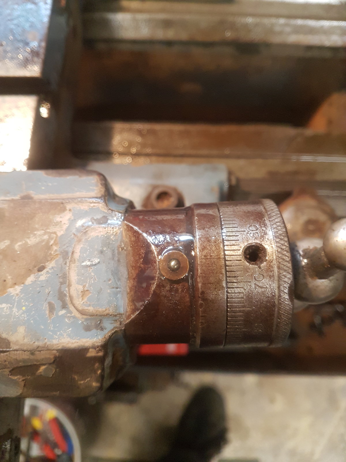

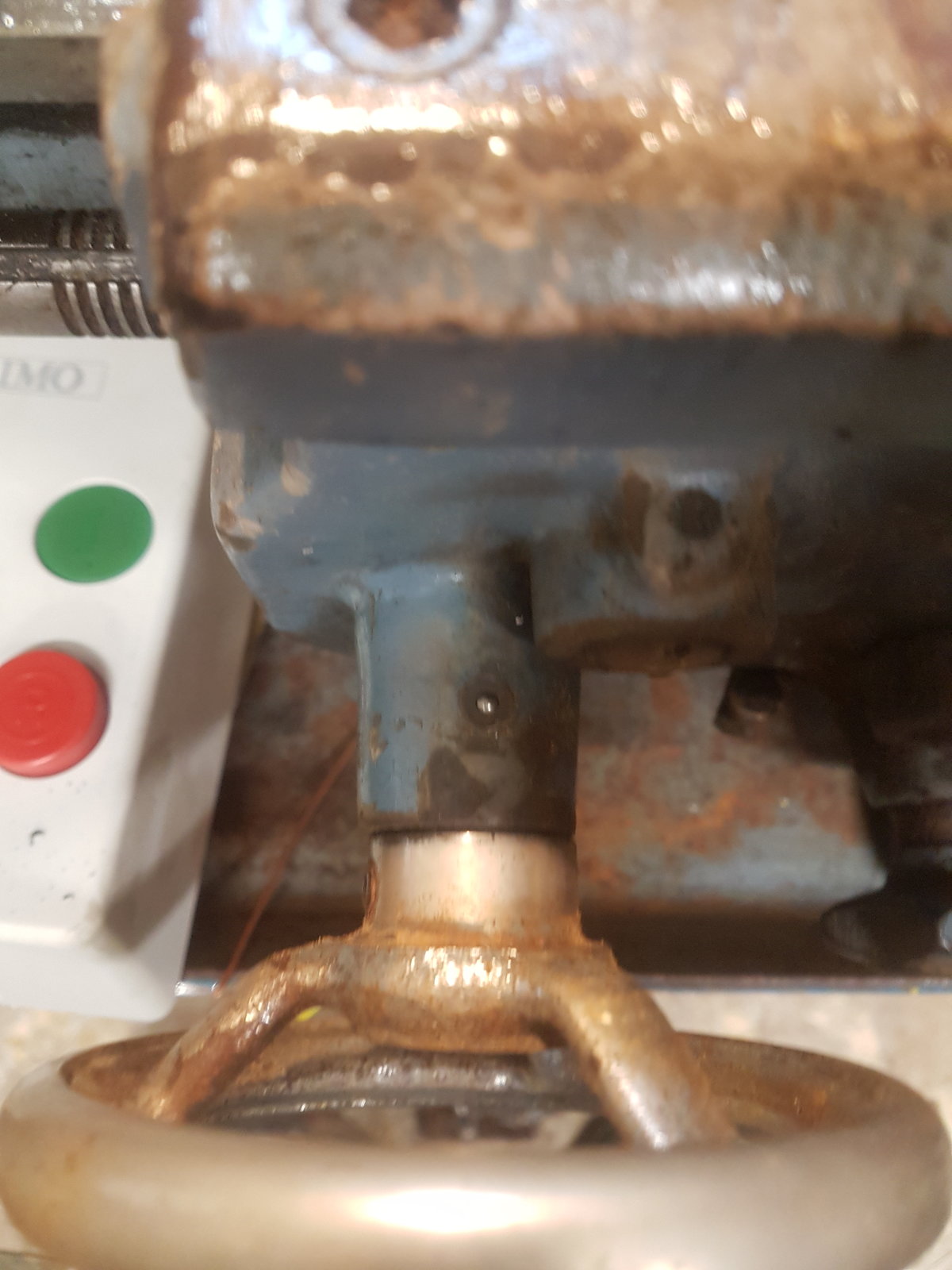

Should have checked first really. Knew one was used before the other to get motors up to speed.
Yup, plus all the others. Don't forget the cross slide screw needs lubricating too.
https://www.ebay.co.uk/itm/LATHE-MI...784834?hash=item41ff298302:g:4owAAMXQCtlRWZ~lyikes! how does one get oil into the ball bearing filled holes? just jam a bottle into it?
thats betterThese things are great for general oiling. Had 4 on the go for over a year now.
https://www.ebay.co.uk/itm/Pump-Oil...101573?hash=item3fbedd1d05:g:YTEAAOSwN2VZXE3K
I'm not saying buy that one. Just showing what you need.what 34 quid for a oiler
Yeah but these are not gonna fire oil into the nipples. Just handy for oiling other parts.thats better
the wont oh man!Yeah but these are not gonna fire oil into the nipples. Just handy for oiling other parts.
i never knew they existed! recomend me one please someone!Cheap oil guns all state grease only.
It's a one time buy so pick a decent one.
Aye. Never leave mine full.I've got a few "decent" ones, some old, some new they all leak to some degree but stil work.
Half the price of a 'Myford' oiler.Mine came with 4 different tips for various nipples.https://www.lathespares.co.uk/oil-gun-myford-lathe-1 it says this is not suitable for the ball bearing type
thanks mateMine came with 4 different tips for various nipples.
Il flick back through my eBay history and see if there still sold
