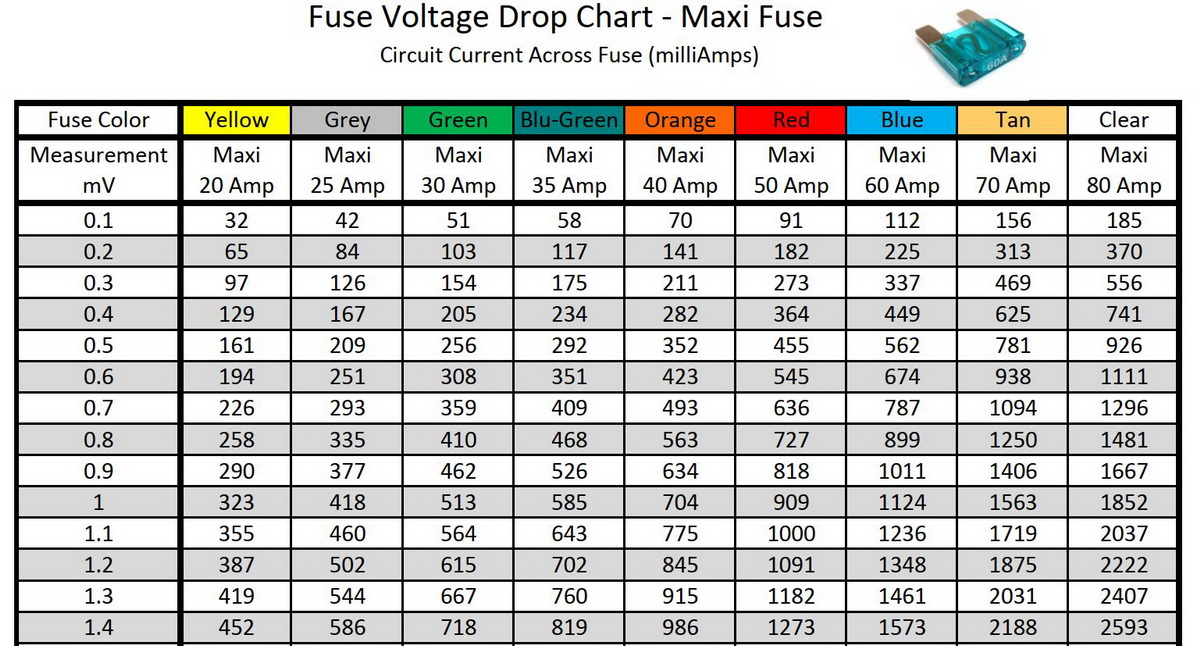

Yes I've seen them. Thanks.There's some handy charts to cross reference voltage to current across fuses, this is a big pdf so I've screenshot a section.
It's important to get the correct fuse type chart for the mV drop method - it does work well with an accurate voltmenter and has the advantage of not 'waking up' devices on other circuits due to loss of communication (even when the vehicle is 'asleep'). It's also a lot quicker.There's some handy charts to cross reference voltage to current across fuses, this is a big pdf so I've screenshot a section.
Basically anything > 0.0 mV is investigated. Done this before often...doesn't make it less of a b*ll-ache though.It's important to get the correct fuse type chart for the mV drop method - it does work well with an accurate voltmenter and has the advantage of not 'waking up' devices on other circuits due to loss of communication (even when the vehicle is 'asleep'). It's also a lot quicker.

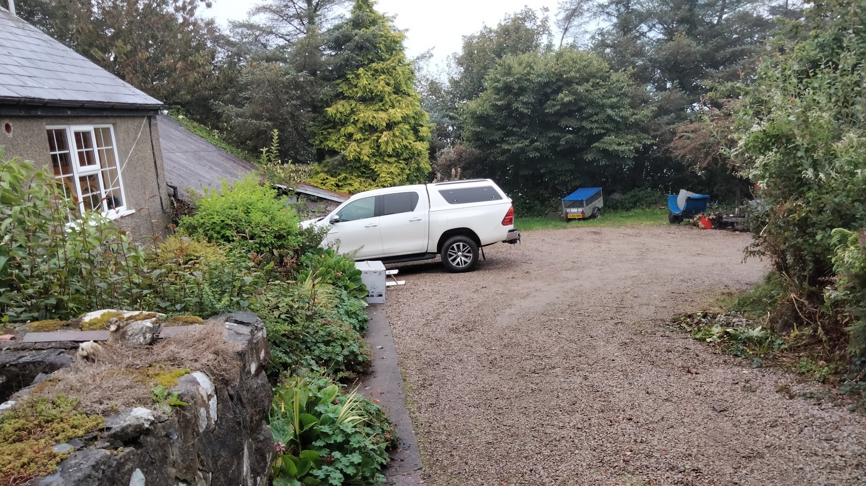

Thats the way I now fix irritating vehicles, buy a new one, under warranty so its someone else’s problem.Well I repaired the Kuga by buying a 69 reg Hilux
Garage spent 2 hrs (they say) on the Kuga with no success. Might offer it for parts on eBay. Real shame engine was excllent, paint & bodywork good. The AWD is suspect though...might be the rear drive unit that's failed...it would account for the rumbly bearing type noise.View attachment 415433
