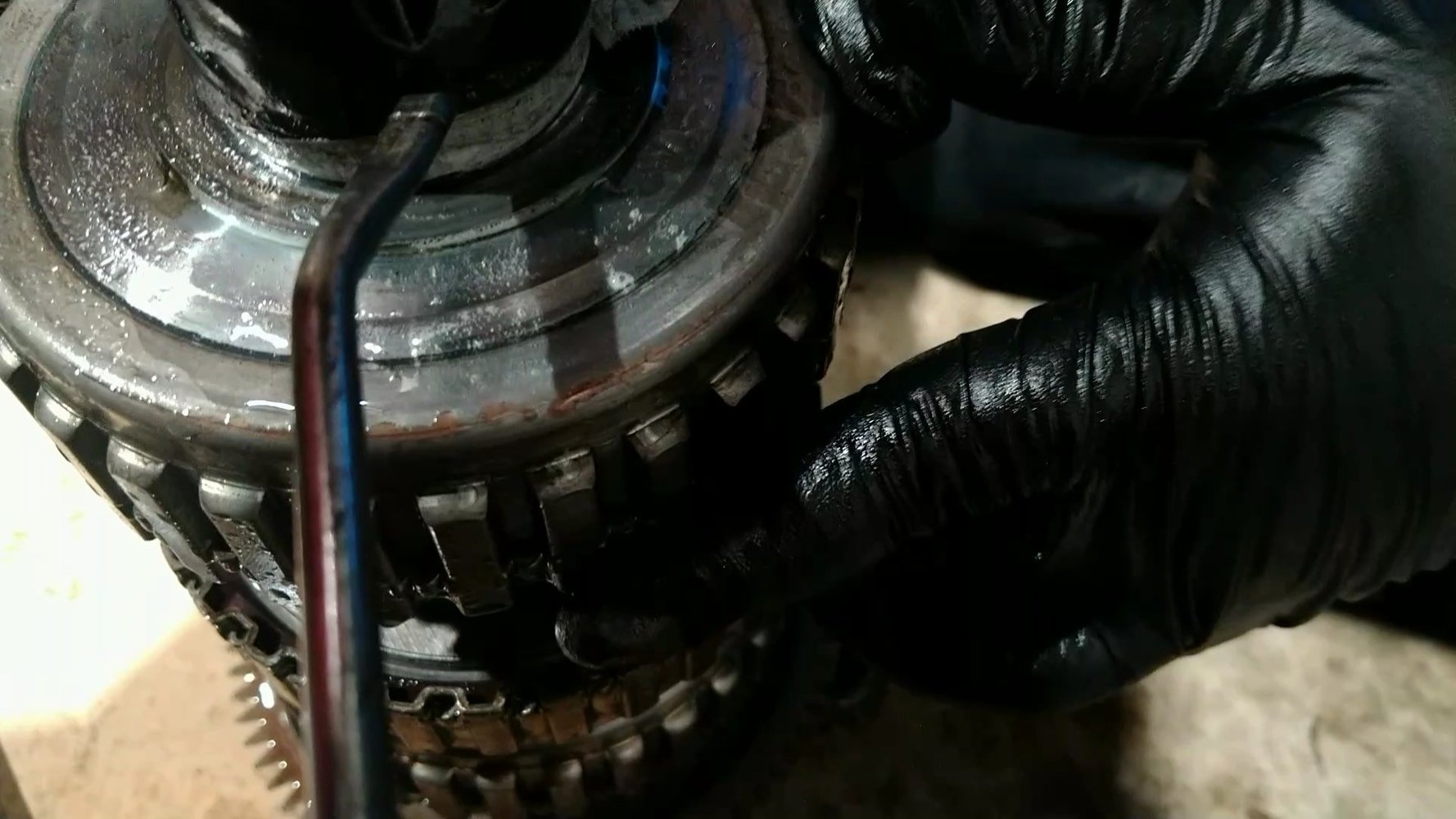

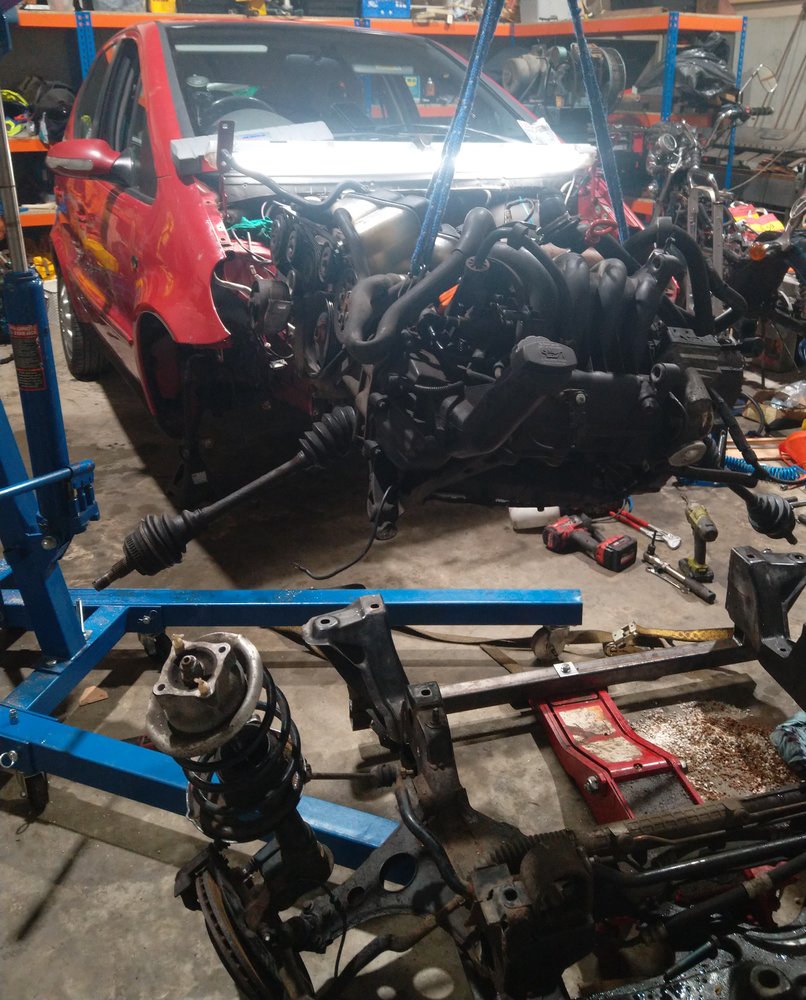

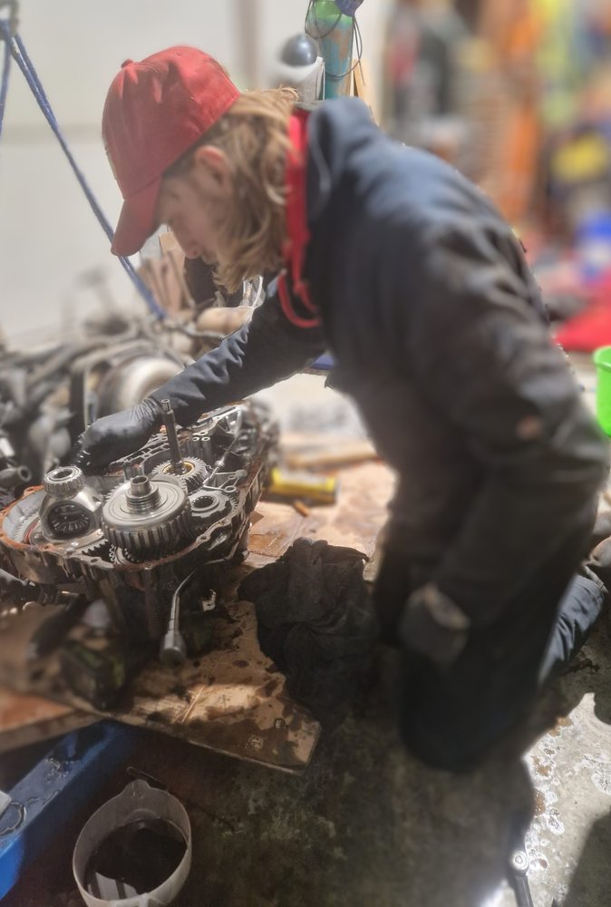

Its this sort of thing that scares the hell out of me to get anything newish!!Here's a nice modern car repair for a friend.
Merc a160 auto gearbox 722.6, pull of in first excessive clutch slip, lurches in to second followed by a big F on the dash.
Fault code, excessive or lower pressure in clutch solenoid "y3/7y1"
Quick Google using the correct terms we discover the clutch basket is known to split.
First front of, drop subframe and engine as a unit
Strip the gearbox of the engine and split the case
Remove the k1 clutch and install a replacement
Here is a what the basket looks like with a puff of air in the inlet side
See that ring of atf along the crack, the secret to a proper repair is to confirm the suspected fault, if you can't recreate it you probably haven't found it.
Car test driven all good
All in all, once you know how to get the subframe out the job is pretty simple.
