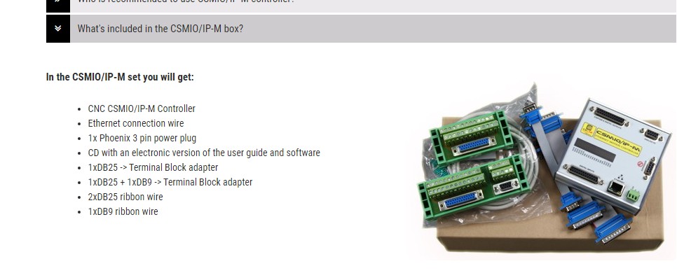

I actually have the smoothstepper as it was gifted but I have looked at the CSMIO/IP-M specs and it looks very comprehensive, very PnP.
