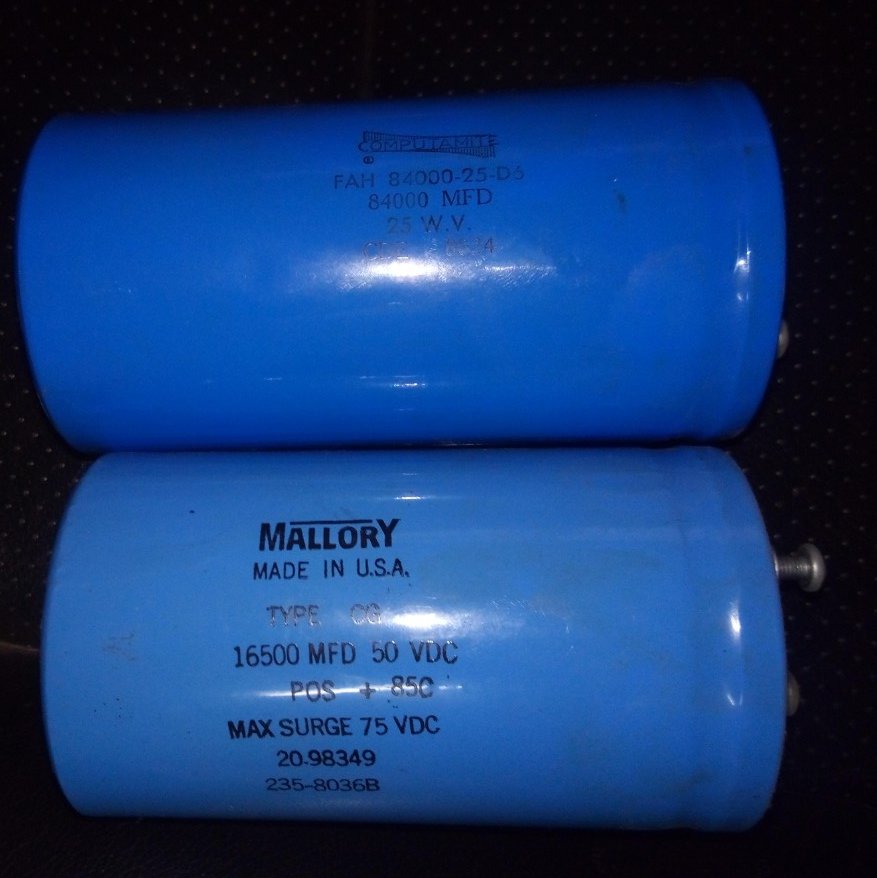

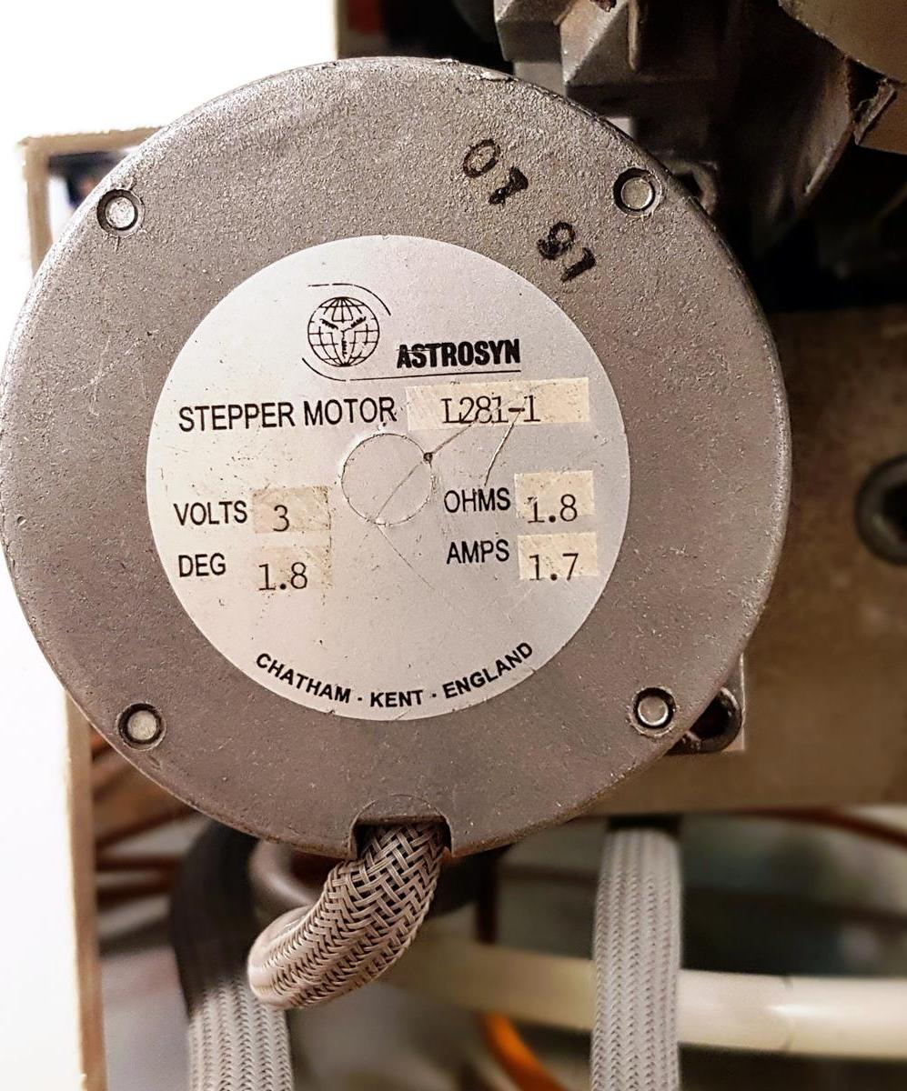

I have spent a good few hours now looking at all the options and permutations. It appears to me that the Leadshine EM542S drivers appear to be the ones for me to go for. The only snag, as always is the £65 each cost as I need four of them! So another £260. Deffo starting to add up, if anyone can find these for less than £65 I would be grateful.
From everything I have read including @m_c comments regarding digital drivers this seems to be the best option. The other option of a toroidal transformer, bridge rectifier and capacitor I am not sure about, though it would probably work out £200+ cheaper. Maybe if someone could tell me exactly what I need I could maybe try that first?
