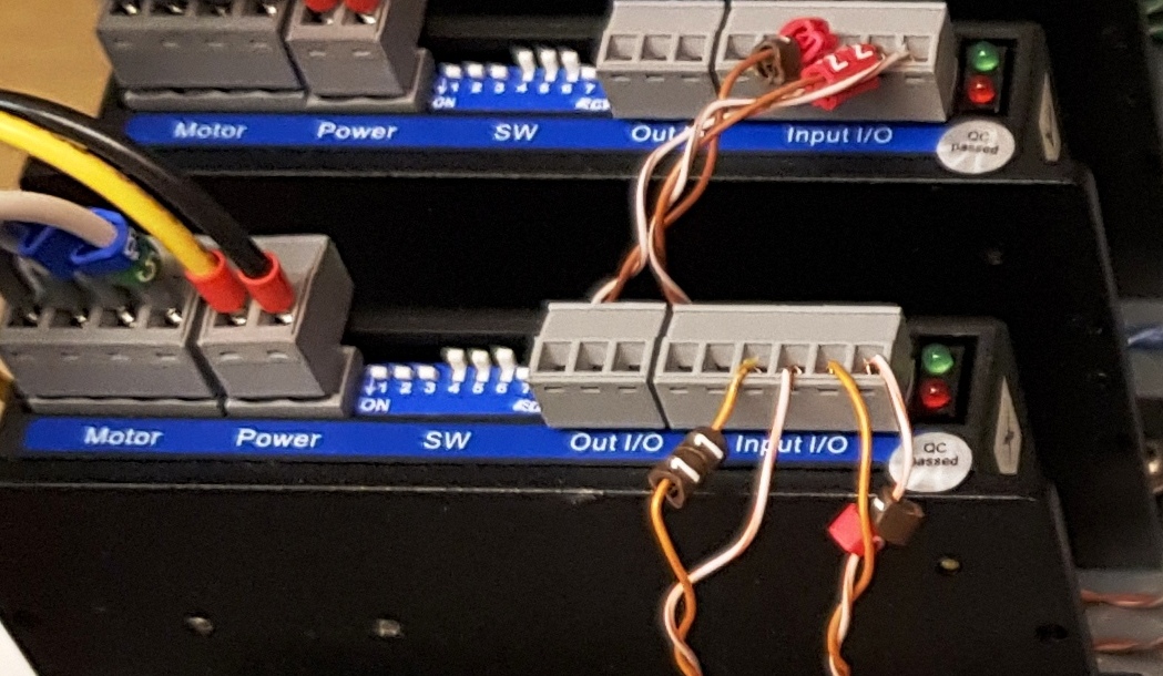

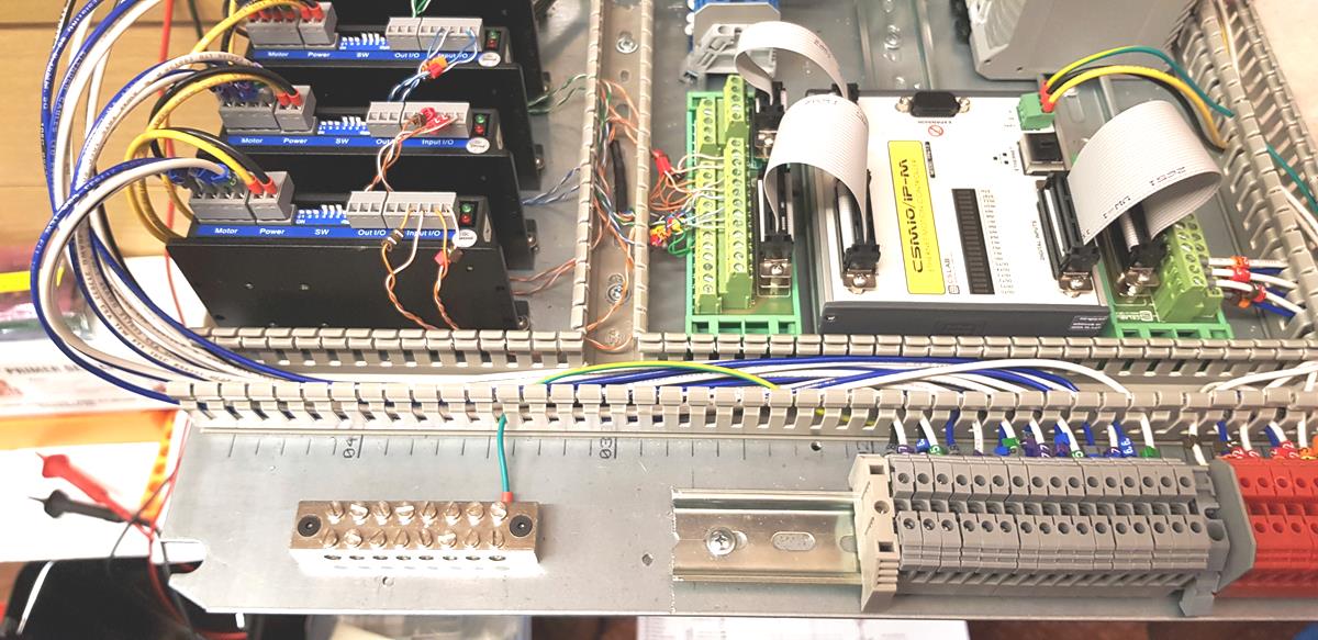

Just a question, why black and yellow for 240v on the power supply instead of the brown/blue harmonised power?
No worries, I design control panels for a living, the only reason I askedWell, the first reason is, I did not know that, Spanners n Hammers me, I am not a spark.
Secondly, I was going to use black and red, but they had no red in 1.0mm so I got yellow instead, sort of like a custard colour.
Finally, if I get it to work it will be a miracle so I am not really concentrating on colours, more functionality, sort of "function over form" the antithesis of Form over Function
Besides, I only have four colours, .75mm in two colours and two colours in 1.0mm so some of the motor wiring is going to be interesting. I am going to get a roll of green though for the erfs. I might even have to buy it![]()
I really apologise for the threadjack, but here is where the answers are!Ok, is the spindle motor an induction motor controlled via a VFD or is it something else?

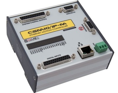

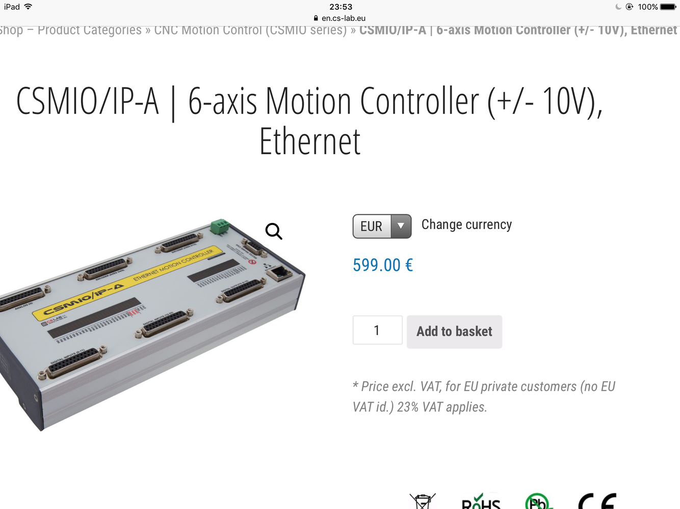

BTW personally I would be looking at a CSMIO/IP-M instead of SmothStepper/breakouts.
The IP-M is 4 axis, has analogue output for spindles, has analogue inputs for override pots etc and all I/O is 24v, also no need for a breakout board as it is all opto isolated and connects to the PC via ethernet. I think @MCKDAVID ended up going that route with his plasma.

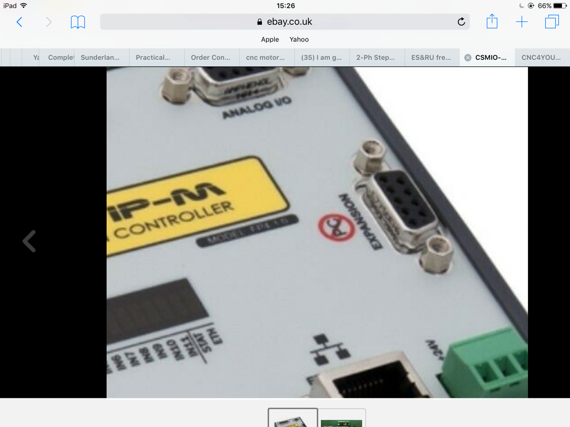

Expansion socket fitted? Enough thread jacking for one day I think.Not a bad thing at all and it is a very capable wee controller.
Sadly not capable of rigid tapping but with careful programming and a floating holder it should be possible.
I probably would have put an IP-M on the plasma if I hadn't already had the IP-S left over from the wee lathe that I was using to experiment with. Then again I use a lot of I/O and the IP-M can't be expanded sadly, it is a shame that they don't allow using the expansion modules and the Enc module (needed for rigid tapping and single point lathe threading) but I suppose they have their reasons.
You soon get tired of slow rapids even just on a smallish sized part, it would amaze you the difference in time to machine something between a machine with fast rapids/accel than one with slow.Another useful post here. I would suggest, as is indicated above, that a miller x and y doesn't need anything fast to move it, other than if changing cutters at the end of a sequence (I wouldn't even know if this happens, but I guess it does?). And then, if the steppers give adequate torque at low speed, would you direct drive them, or belt drive, which could improve packaging at least? This question applies to servos too - why would you need 3000rpm?
Yes although on the IP-M the only expansion possible is the MPG module, well worth it in my opinion to have one.Expansion socket fitted? Enough thread jacking for one day I think.

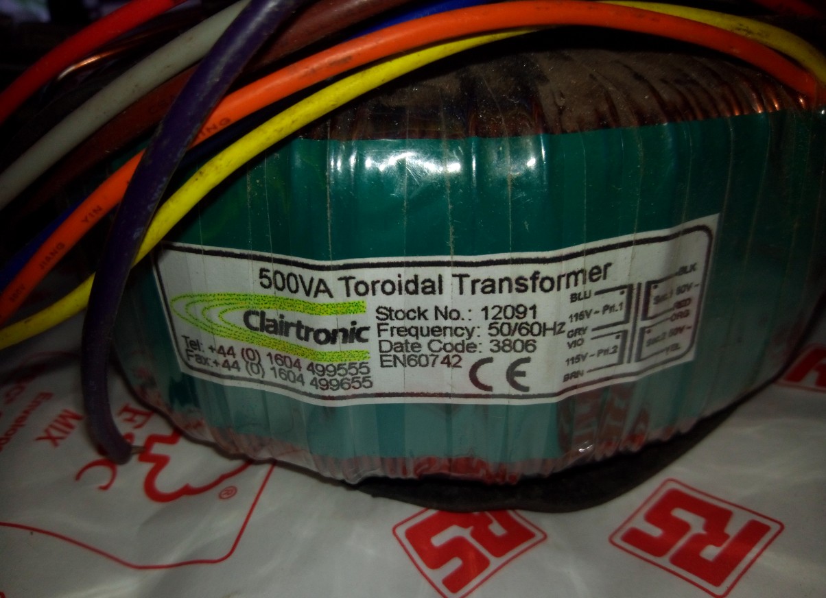

Glad you found it and I definitely would have remembered as nice as toroidal as that coming into my handsAnd look what I have just found
Looking for a USB cable of all things and there it was in the bottom of the basket that has computer cables
50V secondaries though so probably too high for @northwest anyway if my recollection is right.

So you have to buy servo drives - assuming you don't have them fitted? I'd appreciate if you could pm me a price, and your best bet on prices for servos?That is what I have on my Chiron, also have one for sale presently. It is analogue command though so only any use if you have servo drives capable of +/- 10v command rather than Step/Dir.
Most industrial machines are analogue command and it is excellent for retrofitting them with Mach3.
