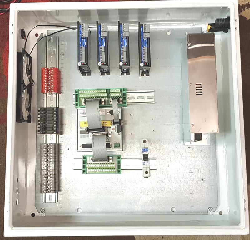

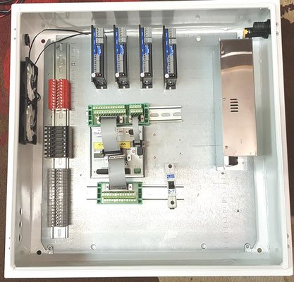

You should have welded studs to the cabinet so you could mount things on a base plate, would have made it easier when you switch to servos![]()
I will however ask somebody who's fitted a few of these if he's used the software.

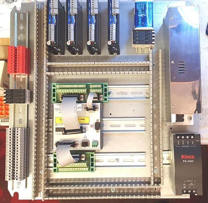

Good to see you have left plenty of space for the MPG moduleSo, now fastened down. Mains voltage down the right hand side, low voltage and signal down the left. Few more bits to stick on but I can start wiring now.
Good to see you have left plenty of space for the MPG module![]()

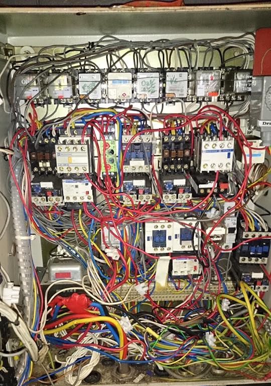

Hmmm, you looking for a job at my place?
I think you've got that red wire in the wrong place..
I have actually seen a lot worse.
