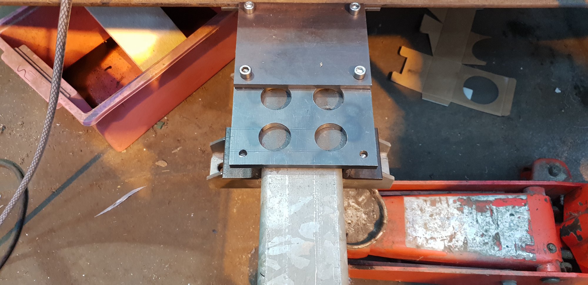

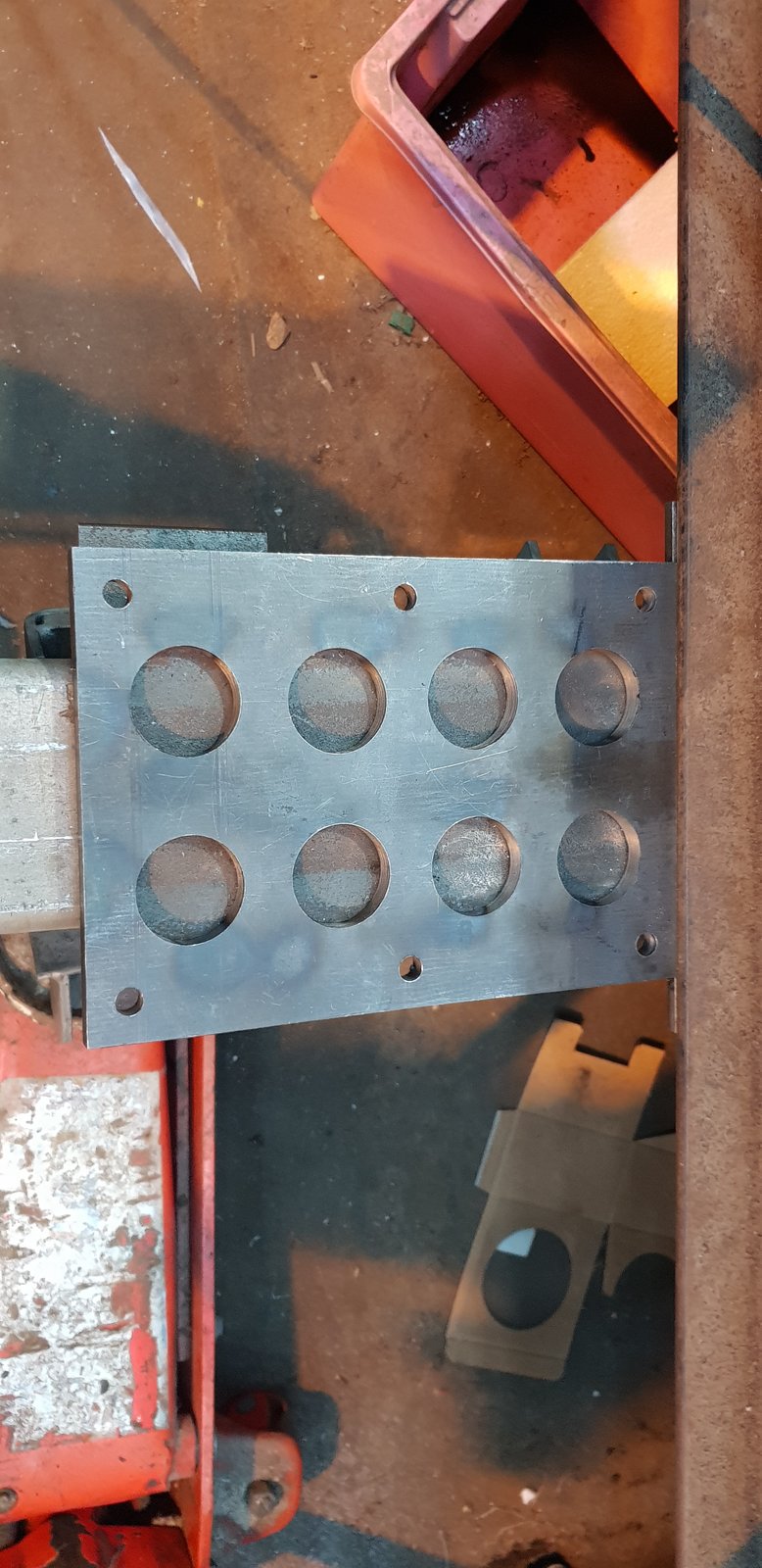

Where you’ve gone slow you’ve caused it to distort more.
Distortion is about heat input and weld bead size.
250-280A into the corner, 5-6mm leg fillet, you’d of had less distortion.
But my mig only goes up to about 220 amps. I need to practice a lot more with my 380amp arc welder!
