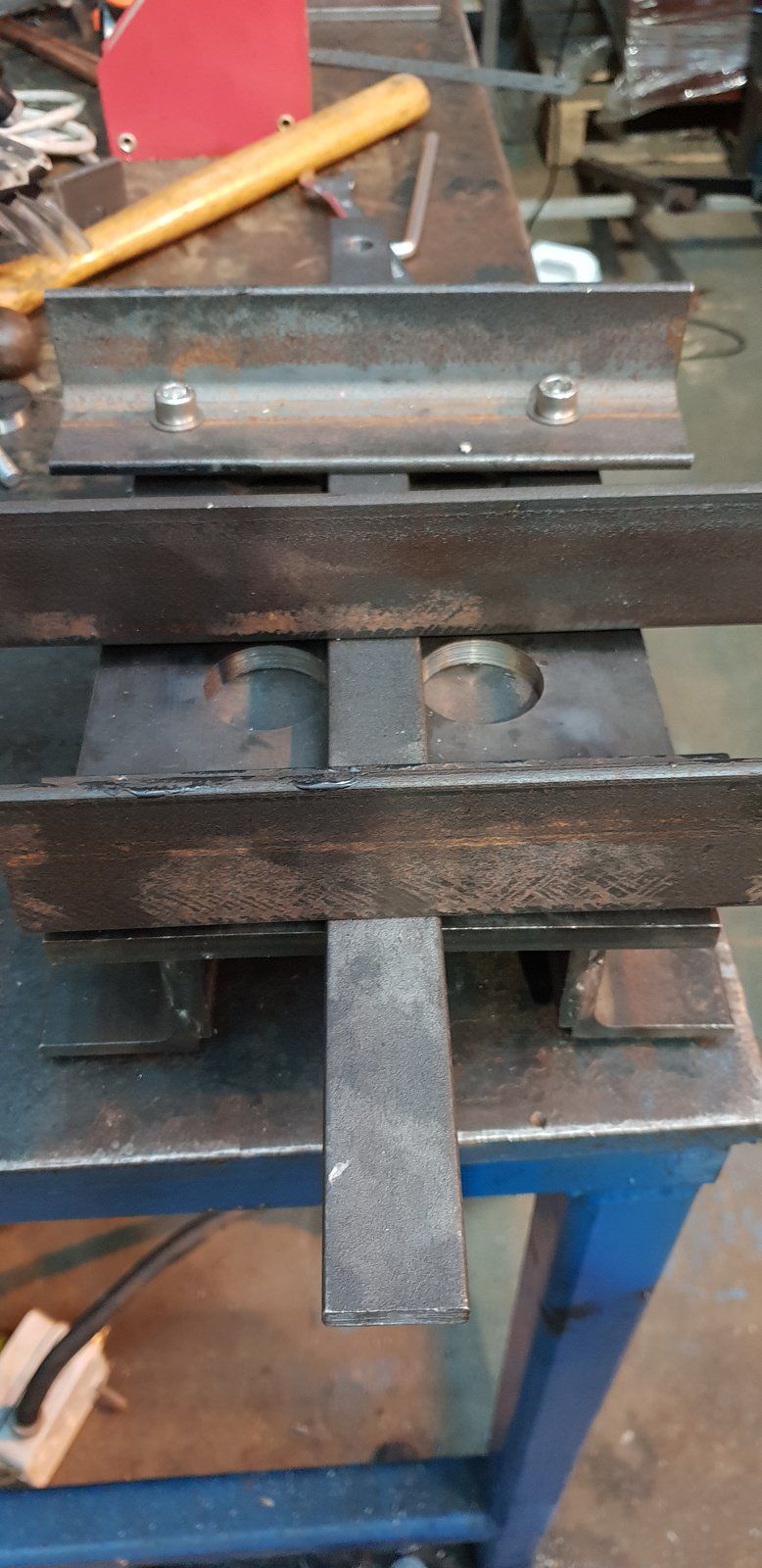

Is it that easy to warp 12 mm plate by welding?
How much heat do you have to put into it?
run a good solid bead across the middle of a bit of 12 x 200 flat bar and it will bend quite a bit if unrestrained. Usually what you're welding it to, does a bit of restraining for you e.g. channel or columns with footplates, etc, and the remaining warp is either not important or not that noticeable.
