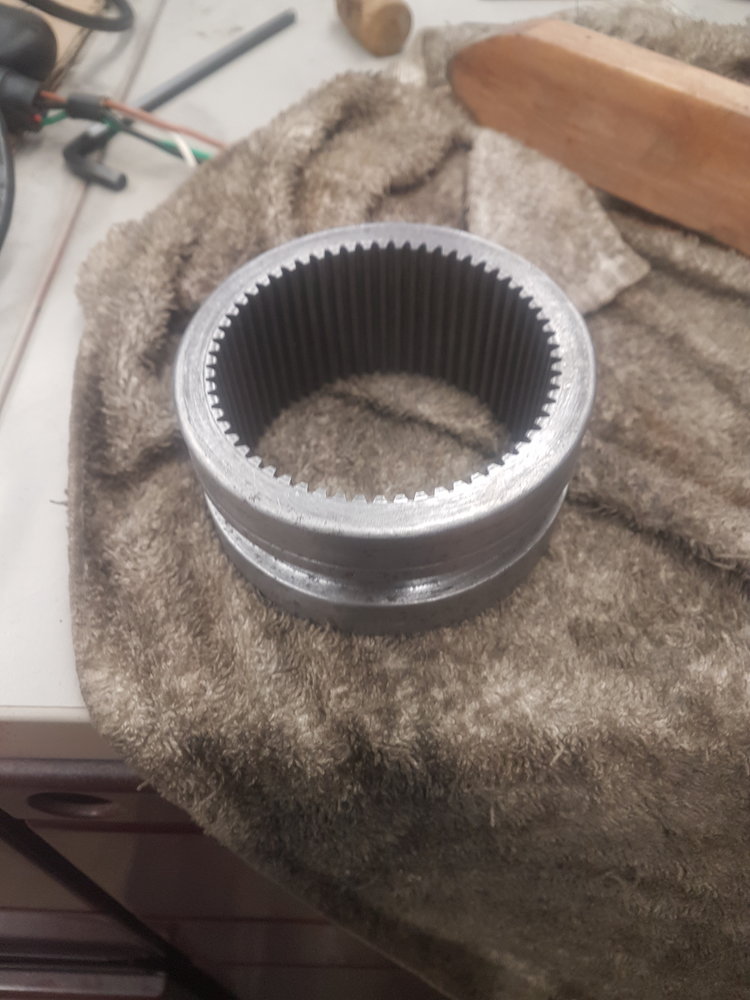

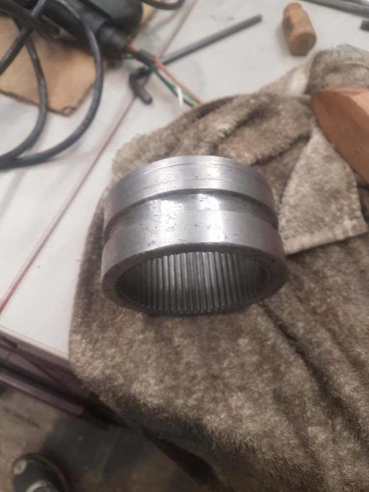

The inside yes. The smooth side is not suppose to get greased as it makes it harder to pull the rope out on free spool. If i heated it up in the oven and dropped it into oil would it absorb some.Are you going to grease it?![]()

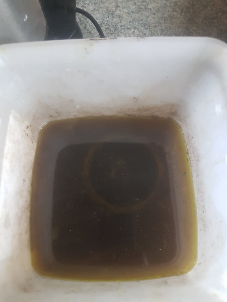

Hot enough for spit to bubble, but not form balls and dance off.If i heated it up in the oven and dropped it into oil would it absorb some.
I have old engine oil here but why use old oilHot enough for spit to bubble, but not form balls and dance off.
Old engine oil is good, but the fumes are not nice.
It contains carbon.I have old engine oil here but why use old oil
cool thanks I learn something everyday,It contains carbon.
It acts as a dry lubricant.
Do the spit test. Bubbling not dancing off.cool thanks I learn something everyday,

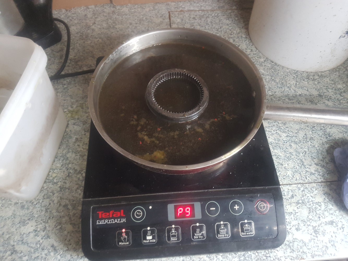

so 275 deg C in the oven will that be enough then into the oil
ok thanks ill try tomorrowDo the spit test. Bubbling not dancing off.
Does the oil need to be heated or used cold. I know for quenching it is better hot.Do the spit test. Bubbling not dancing off.
For using as a a carbon lubricant, cold is better. The metal should be hot to drive trapped moisture out, boiling spit.Does the oil need to be heated or used cold. I know for quenching it is better hot.
Great thanks mate it is in the oven right now to dryFor using as a a carbon lubricant, cold is better. The metal should be hot to drive trapped moisture out, boiling spit.
That way it draws in the oil, but does not quench the metal.
Long and slow is the best.Great thanks mate it is in the oven right now to dry
Too late it is in the oil nowLong and slow is the best.
Oh well.Too late it is in the oil now
to fish it out you meanOh well.
