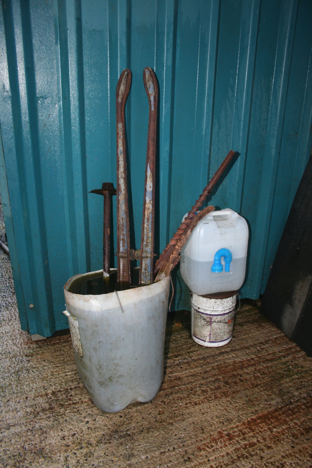

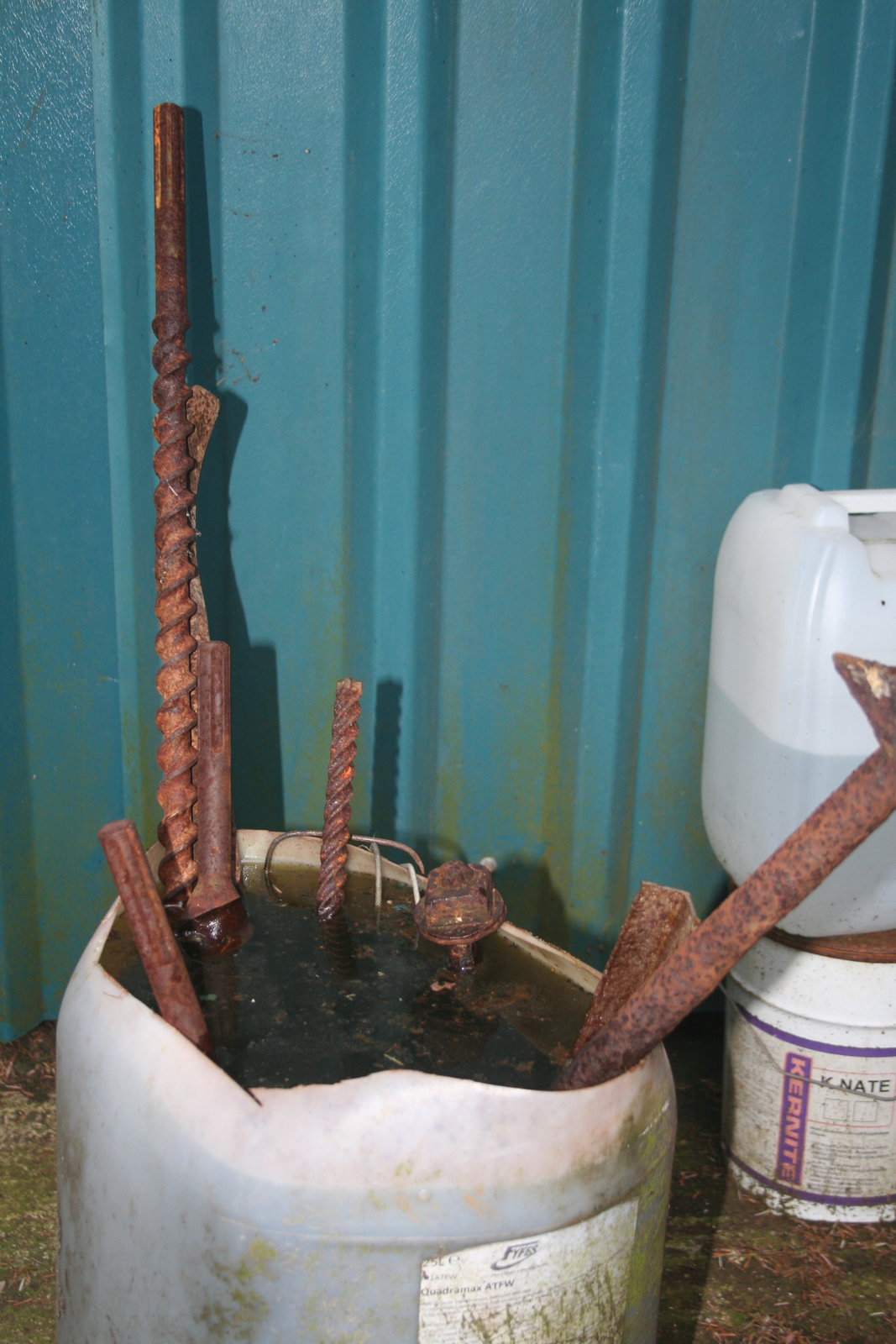

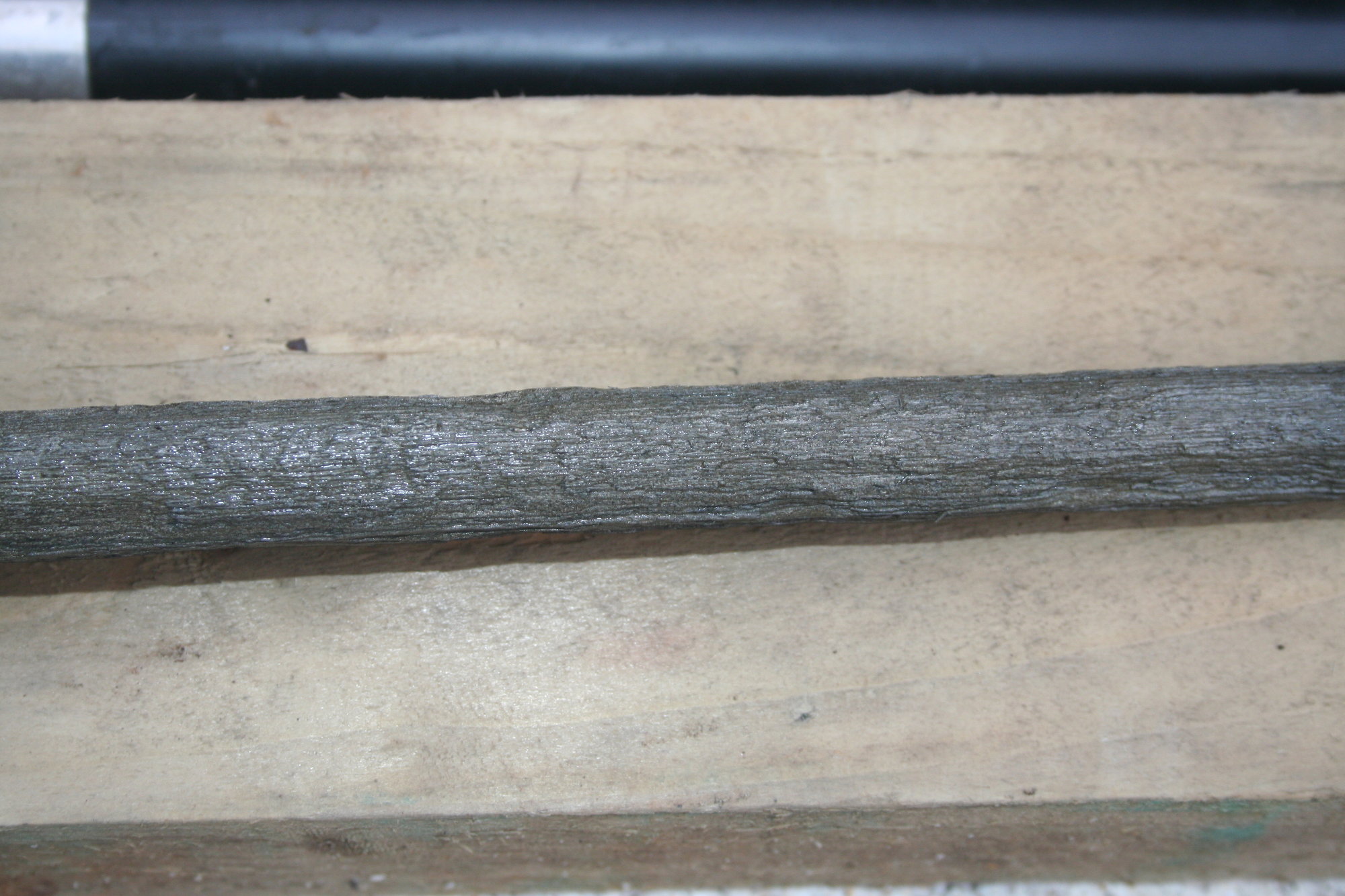

I did some horseshoes recently in citric - think I left them in too long as they ended up with a brown almost treacle like covering, it was hard as nails even the grit blaster was struggling to remove it, anyone else experienced this?
I find if you do not rotate the part every so often, or rub off the rust with an old paintbrush, the rust seems to settle back on the surface and it cakes back on.
