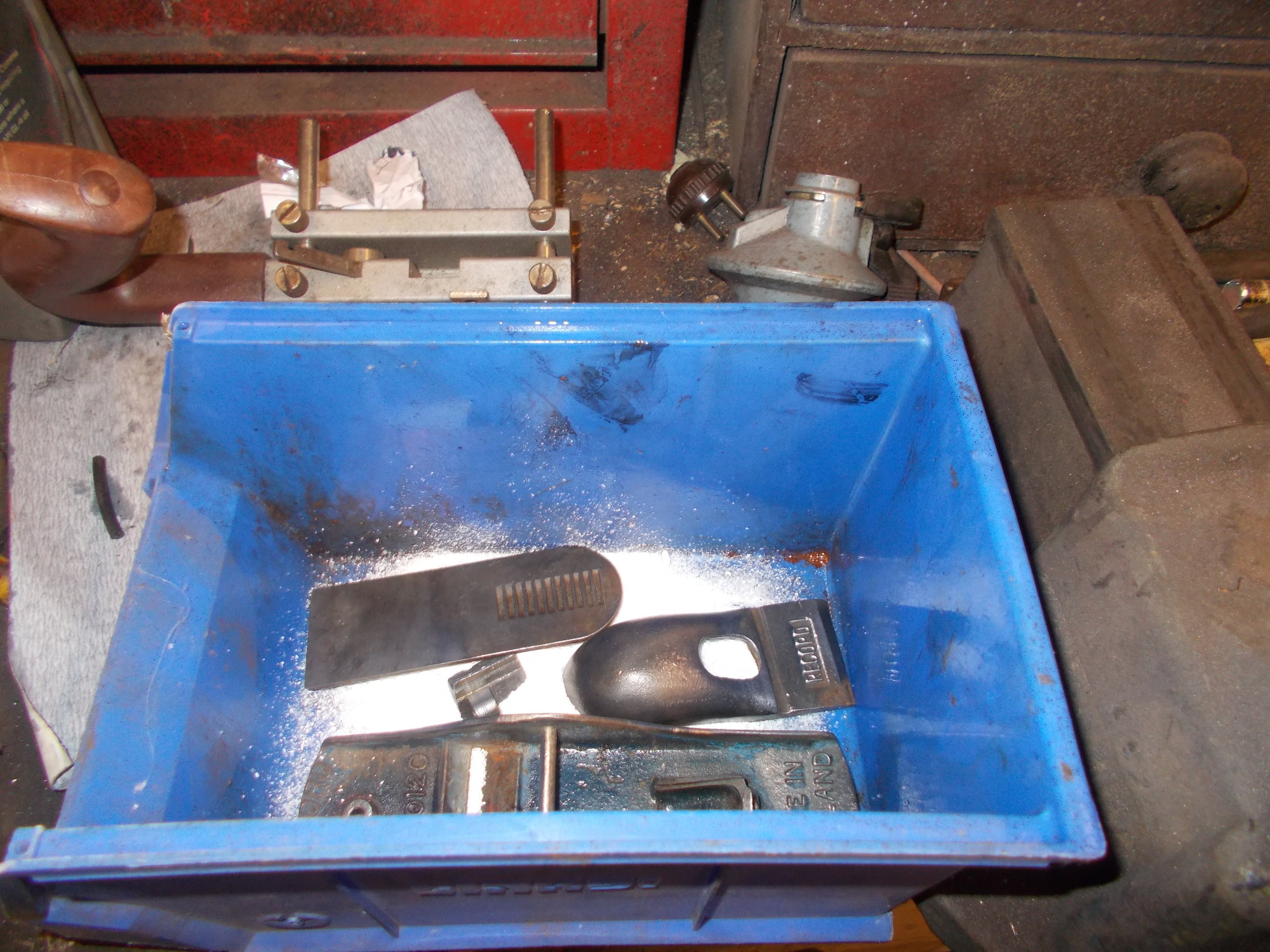

I think you are all over complicating the process. Mix the acid with the water, i used boiling water from the kettle in the kitchen sit the part in it and leave it there half and hour, then have a look at the part. I stir the mix the odd time and rotate the part. But thats as far as i would go.
Hot caustic baths.
Hot washing soda de greasing.
Hot Citric acid baths.

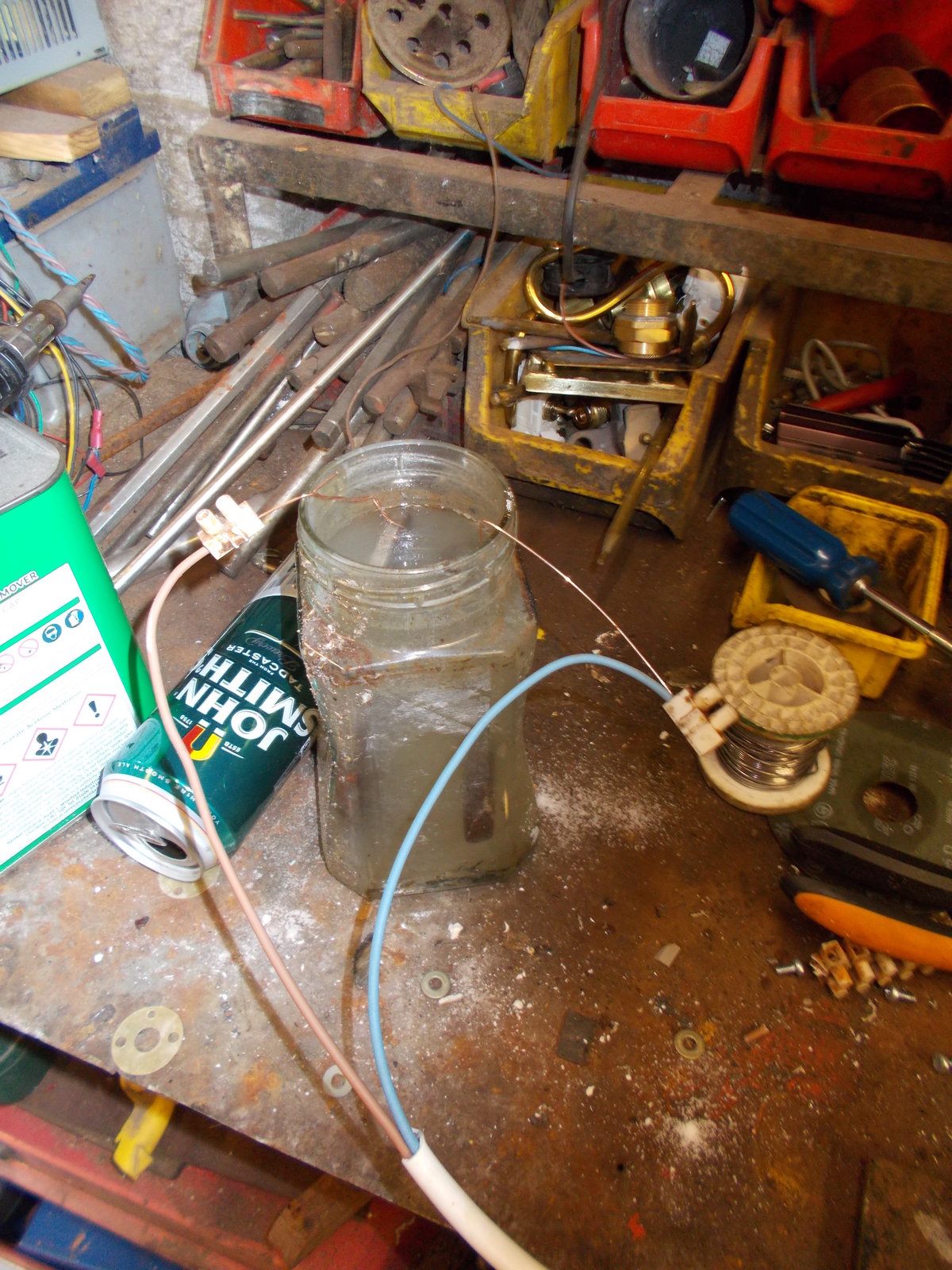

I just wanted rapid results is why I heated it plus a bit of "just for the Hell of it" as I'd only ever done Deox-C cold. I've used electrolysis too albeit only with a 24vdc 5A supply and washing soda solution. Want to try a big old arc welder!
You can only use a DC supply so an old arc welder is probably not going to work as most are ac!

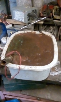

So are you doing some more?Offspring built a solid state rectifier powered by my ancient Clarke buzz box. Used it to electroclean large suspension components in a dustbin.
Put enough ergs in there to raise the temperature above the point you could put your hand in it. Above 50C?
We later put a 30 amp fuse in the circuit. 30 amps at 30 (?) volts? Damn near 1kW of DC power into c. 150 litres of water.
That was the one where it bubbled away at the end of the shed making pure hydrogen filled bubbles at one electrode and pure oxygen filled bubbles at the other.
One of their friends was delegated to dirty cutting jobs at the other end of the shed. We were in the garage. We heard a dull boom and went out to find him emerging from the shed looking very dazed. A spark had traveled the length of the shed and set off the perfect stoichiometric mix of oxygen and hydrogen.
We can still see daylight between the shed roof and the top of the shed wall and the dent where the shed door flung open a full 180 degrees.
He declined the invitation to demonstrate his technique.

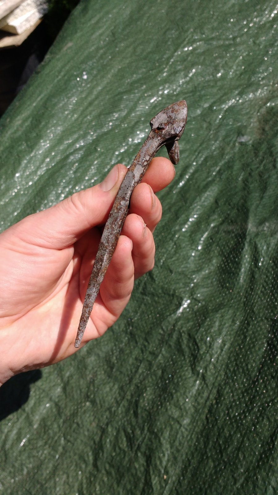

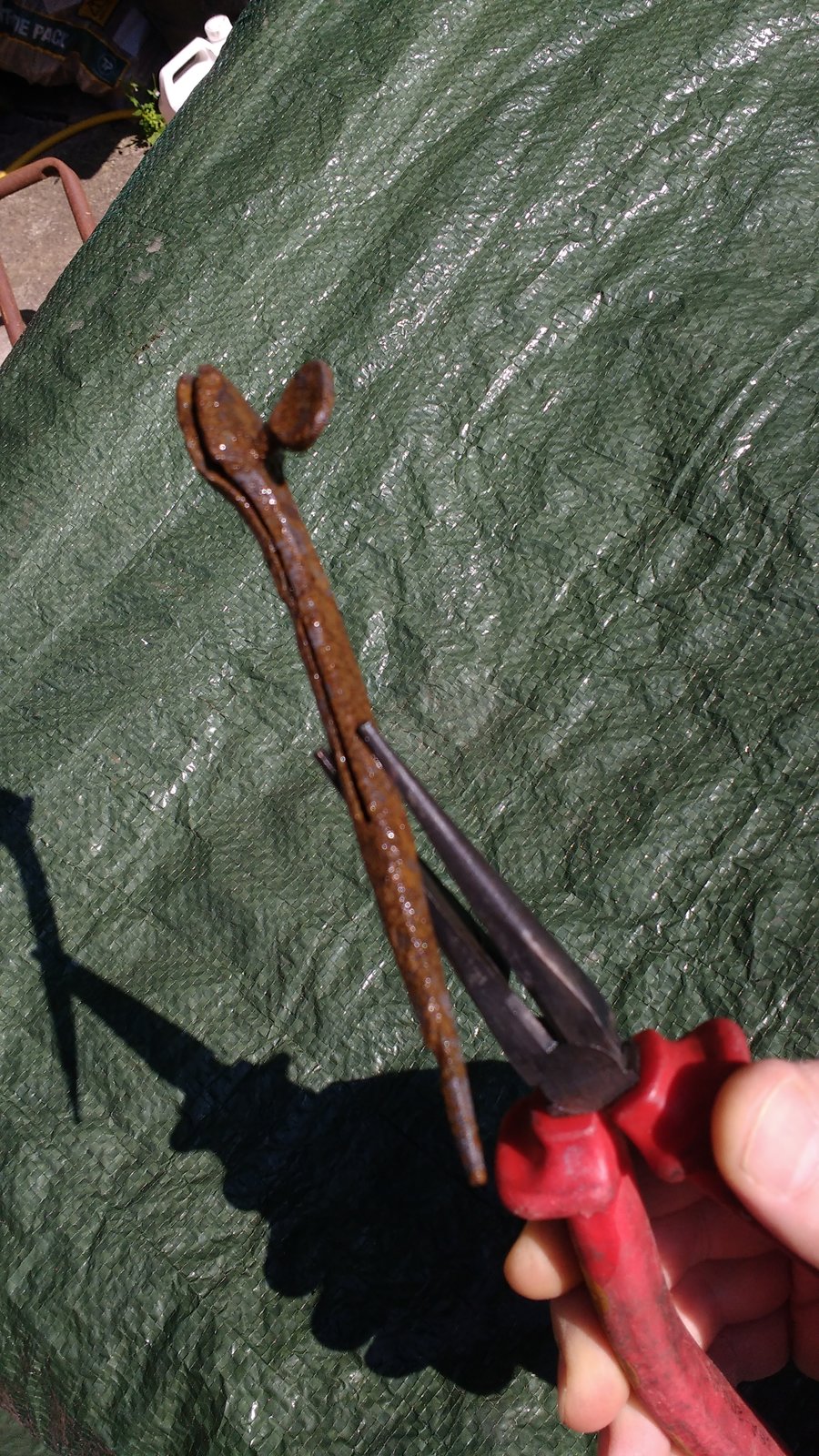

Nice definitely works your method.Vintage leather worker's stitch line marker. Hoping the thread will free up:
After half an hour:
Back in as thread still solid.
