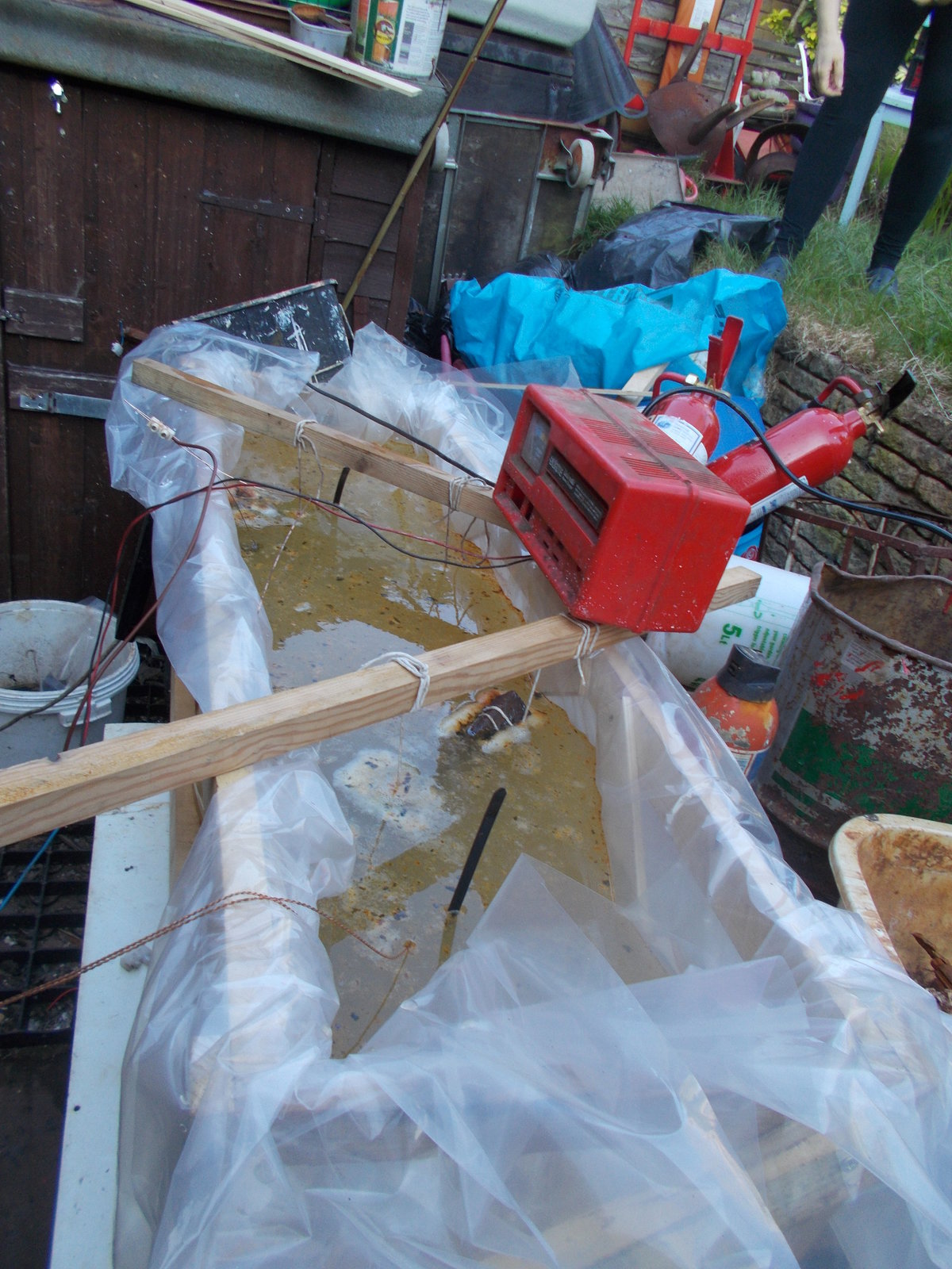

An example.
The sheet is building site sheet, wood was ripped down from pallets. Screws saved from the packing creates, psu battery charger car boot.[/QUOTE
Don't take this the wrongway, but I wonder what you would say if you saw someone at one of the many sites you frequent having a setup like that?
Or even one of the know it alls at your MIS?
I accept it's not "work" but some of the unfortunates you delight in belittling probably don't know any better, where as, you know everything.
Pot and kettle springs to mind.
Having said that it's probably exactly what I would do.
An example.
Seriously, you need to re-assess your H&S standards, that charger is so close to falling into that bath.....
Or are you winding us all up?

TYA, I am noticing a pattern emerging in your photos. Mains powered power supplies precariously balanced just above tanks of liquid, how often does one fall in?
