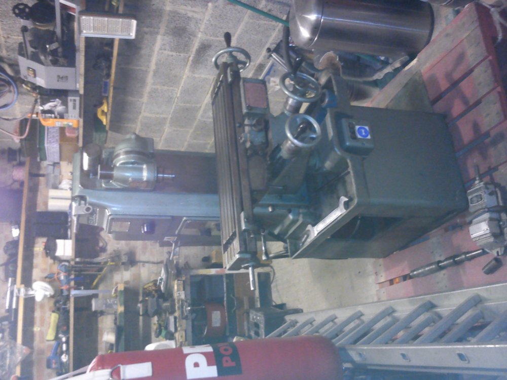

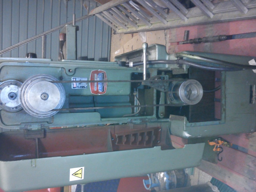

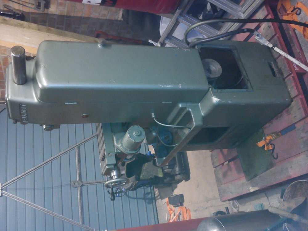

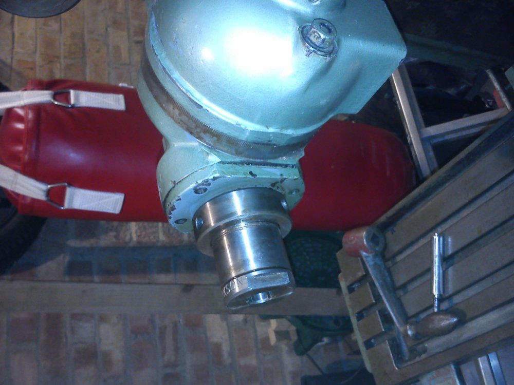

.More to the point, how was your Nan's funeral?It came, it came, it finally came.
The delivery man was very nice and got it in the garage despite it being very difficult and although it was strapped down well it was very wobbly and he said he thought it was gonna fall of the tail lift which was tipping under the weight.
I'll take some pictures in a minute.

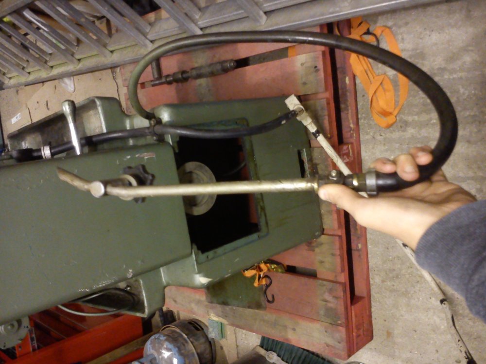

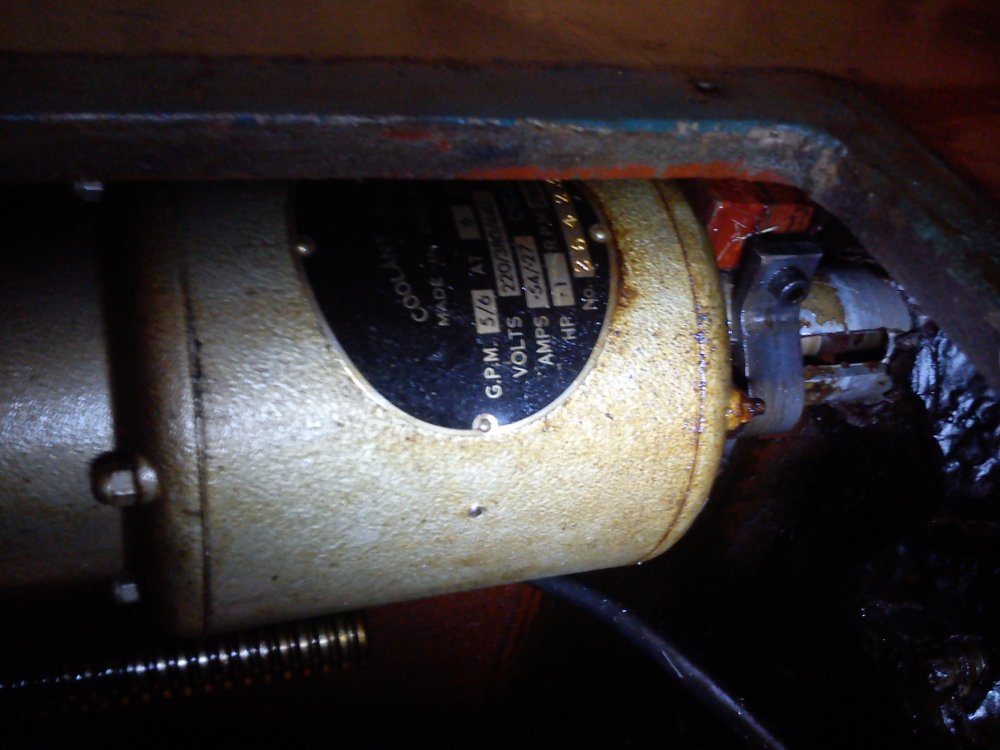

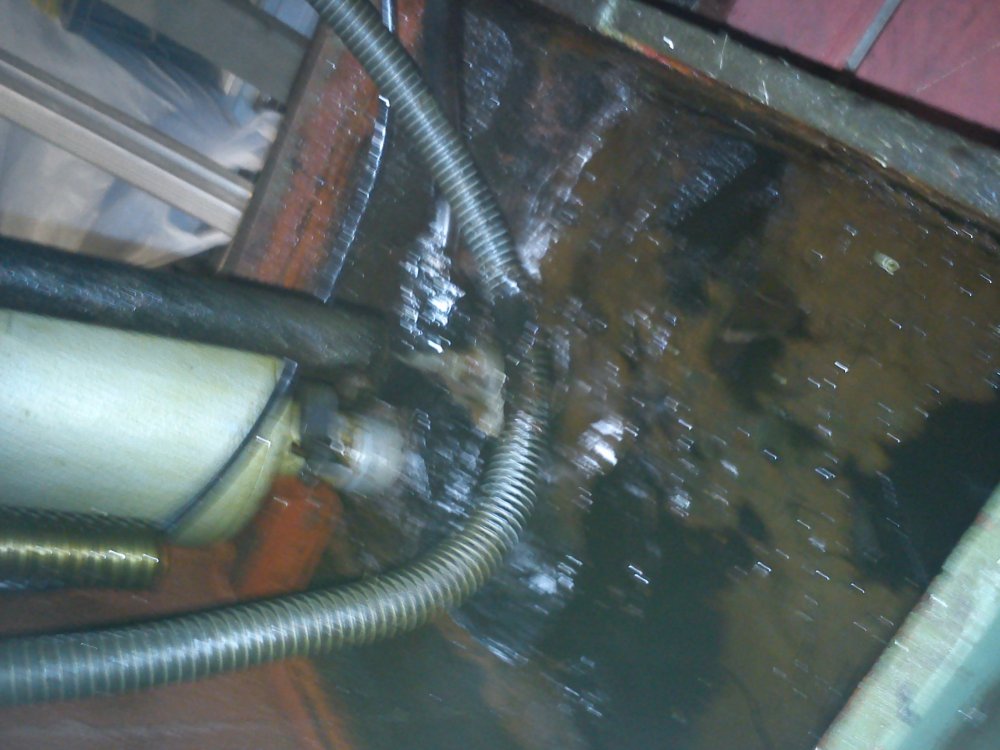

. I think the coolant needs changing, it's got a skin on it and it's just horrible.

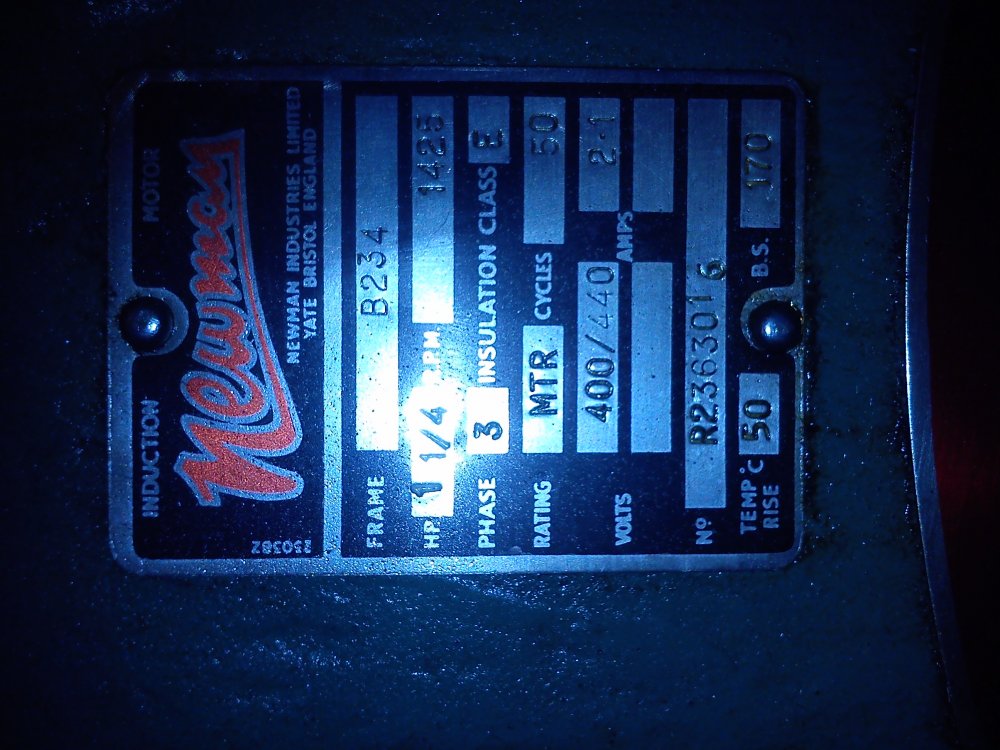

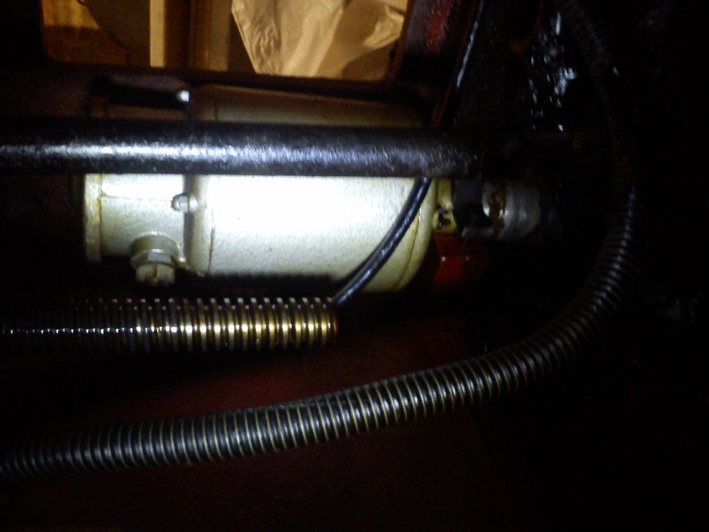

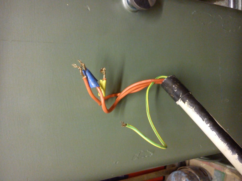

.I'll have a look inside then. I'd rather not replace the motor because the bearings seem really good and I'd imagine it runs quietly.You need to take the terminal covers off the motors to check how many wires from the motor are brought to the connection point. Just because it says 440v doesn't mean it won't run on 240v 3 phase. Both my lathe and mill motors stated 440v but had 6 terminals under the covers so I could reconfigure them to run on 230v.
I've heard of people breaking the pallet away from underneath it, maybe that's the way forward.You need to work out how to get it off the pallet first!
