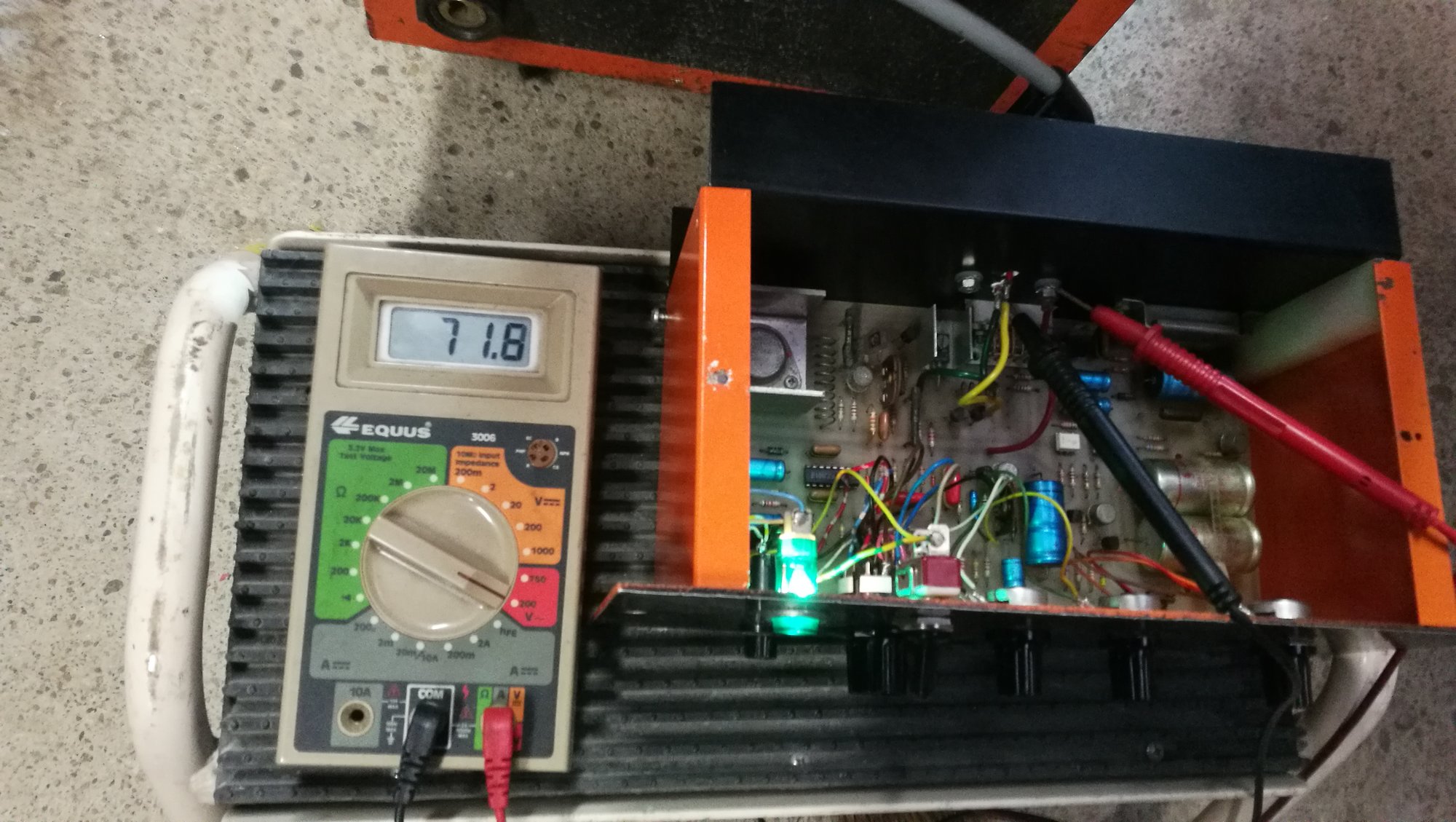

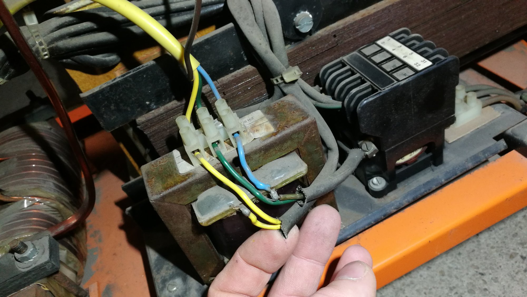

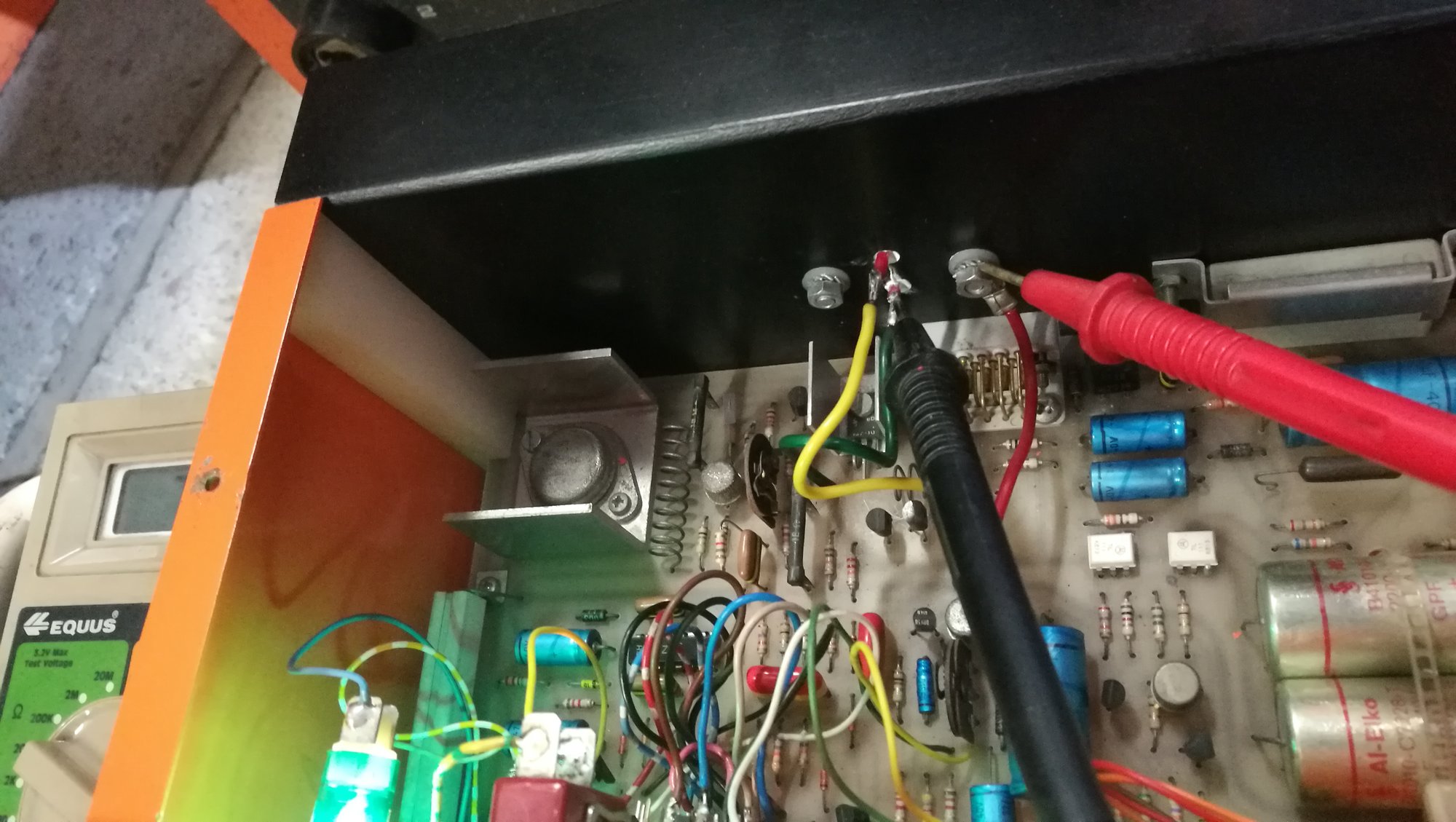

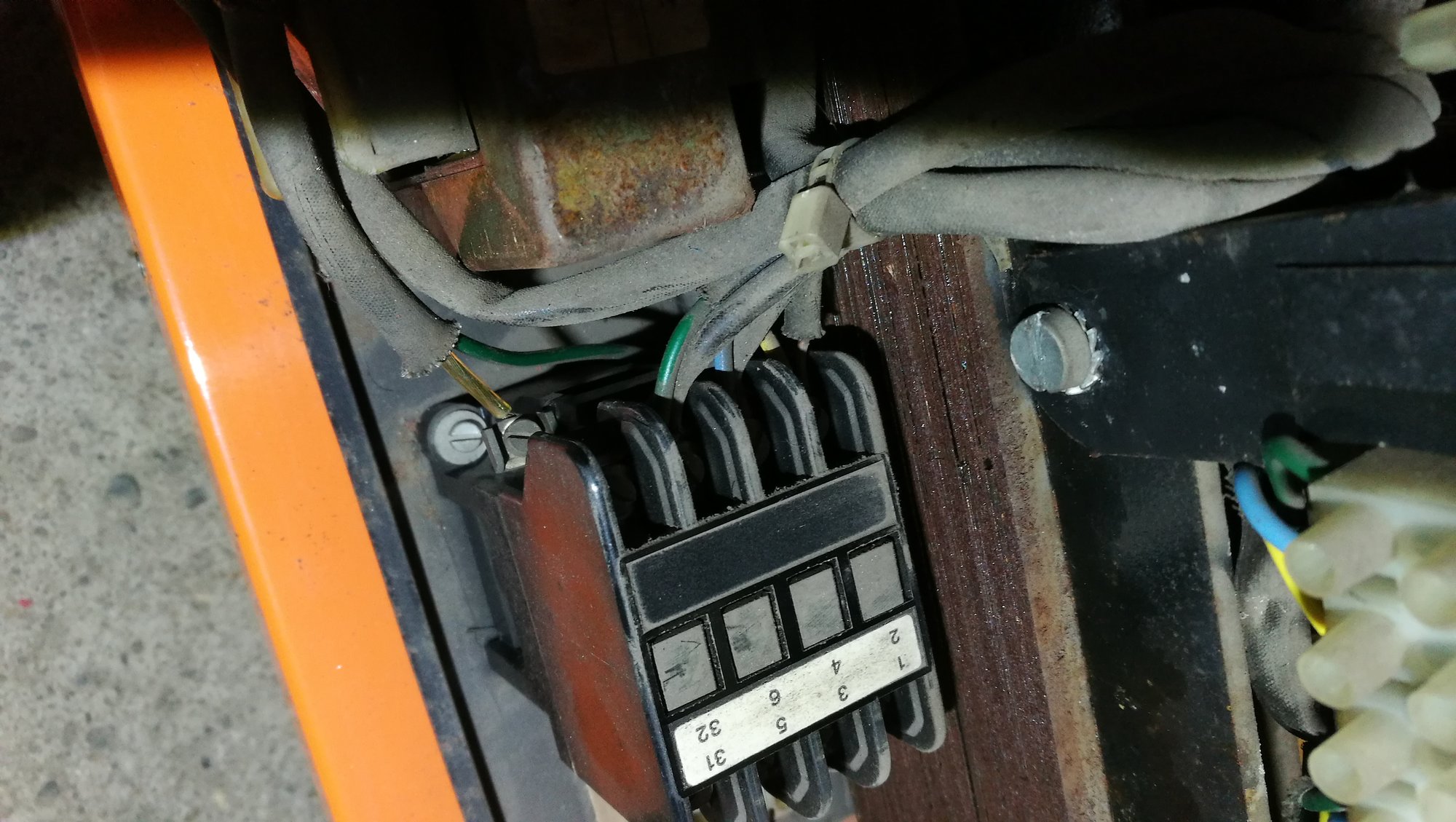

I think that can be a relay which is always on ,try to check relay and contactor
May be some contacts glued up
Oh sorry I just read about the shorted out transistor

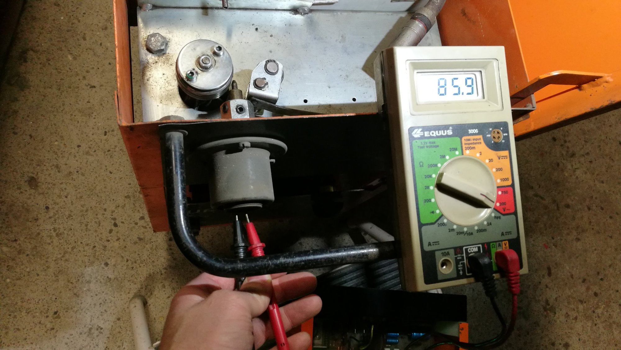

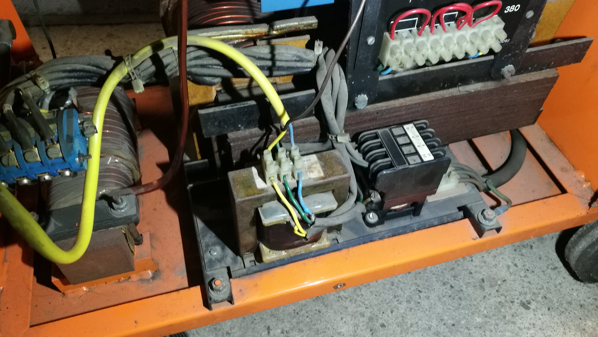

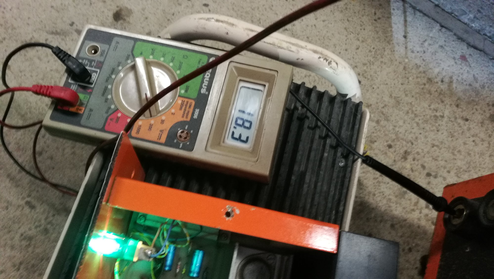

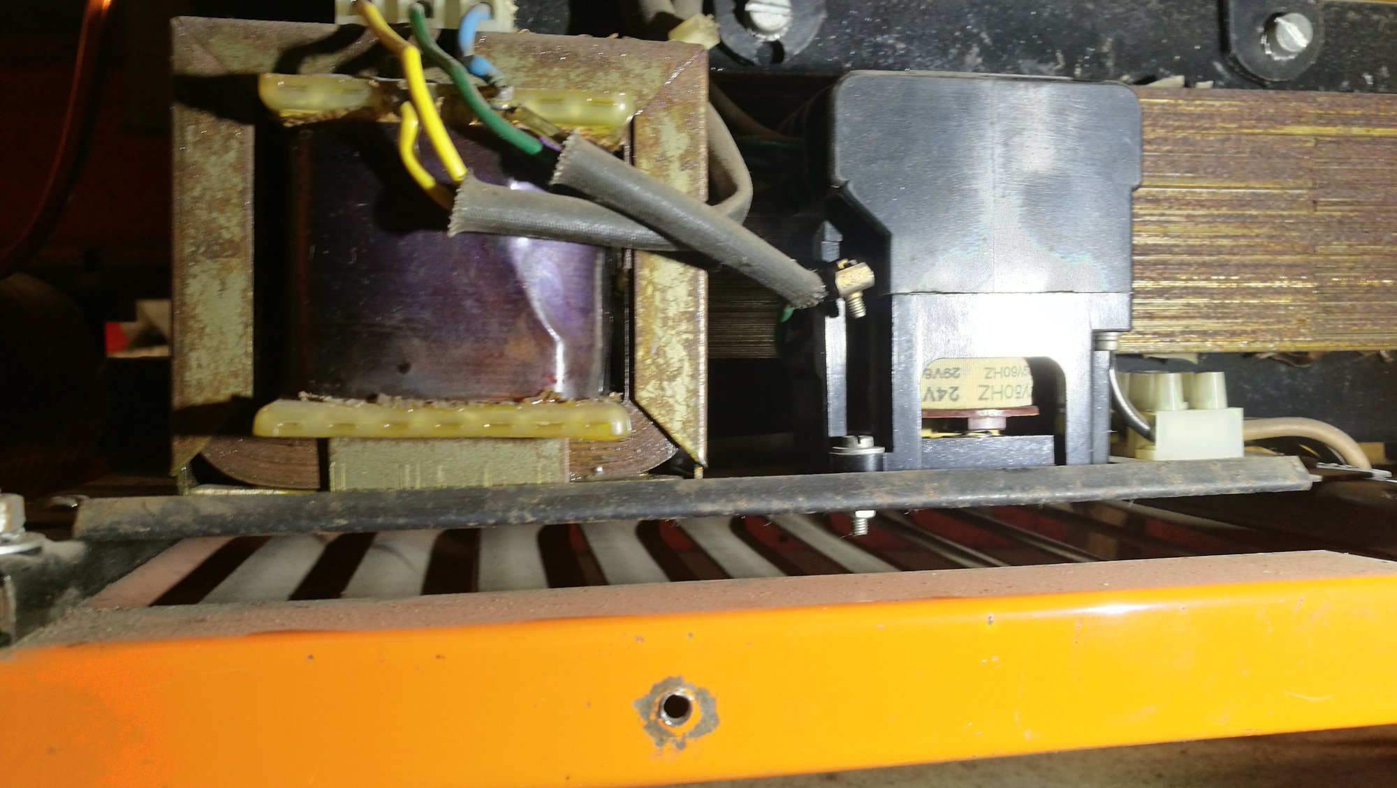

In your video when you turn the machine on there is an audible click. Does that sound just come from the on/off switch, or is this the main contactor closing, and/or the gas solenoid ?
You may be able to feel the gas valve moving, or measure 24v across it.

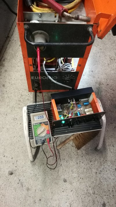

If the main welding power is on, you should get about 20vDC between the Eurotorch socket and the earth clamp on the lowest setting ( 1 ), rising to perhaps 35v at the highest power ( 10 ).
[ Even if this fully-powered-up situation does not actually happen in the fault scenario ( i.e. when the wirefeed is running without reason ), it would still be worth connecting the torch back and pressing the trigger and making these measurements, to confirm that the welder is going to work properly - after we fix it ! ]
From your posting here just before the video, it sounds like this full power-up does not happen - but have you tried in all positions of the 4-way "Mode" selector switch?
( You see, in position one - the continuous line - if this position means "just feed the wire from a new reel", there would not be welding power nor gas, only wire feed motor - which is what we are seeing.)

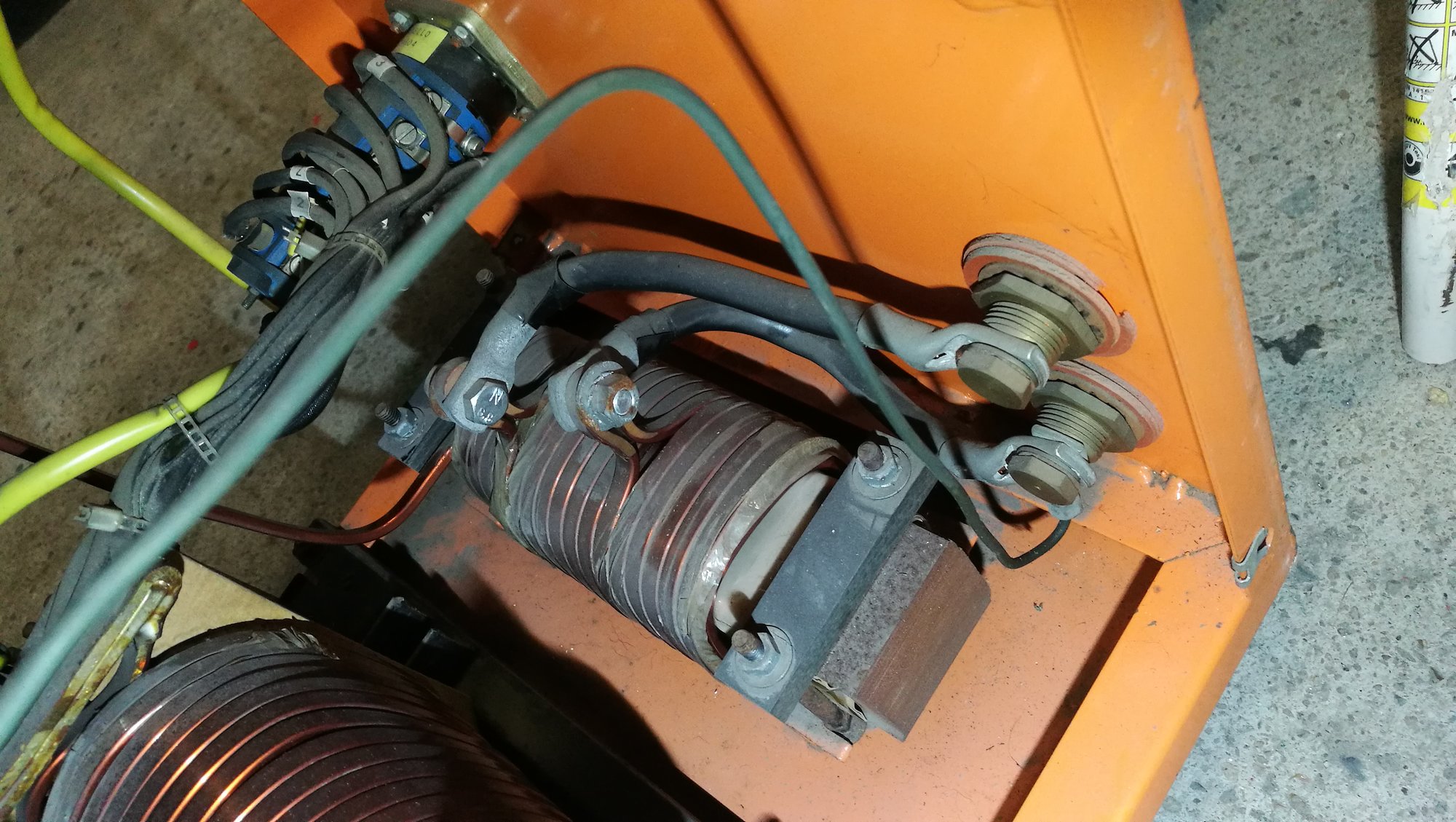

What does that do? My other mig does not have it.That's a choke.
It smooths the current. Helps to maintain a steady current.

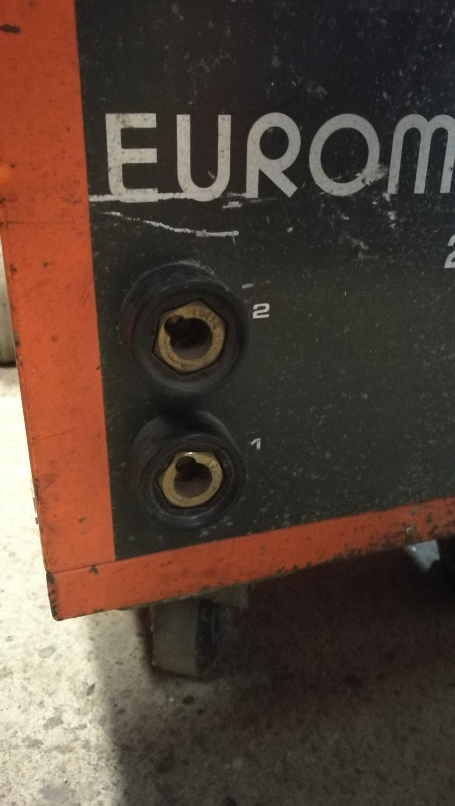

They have different inductance and different voltages fall factor ,so one is more like spray arc than other which is more smooth and quietPicture of the 2 connectors on the front for ground? Going both to the same transformer.
