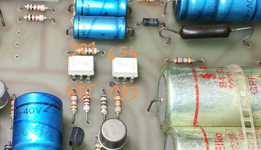

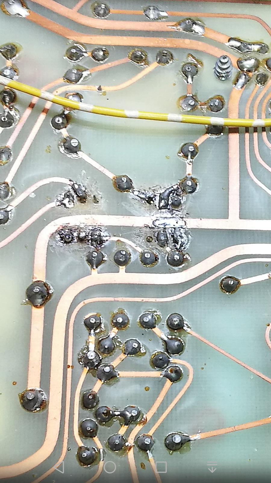

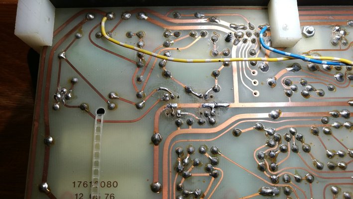

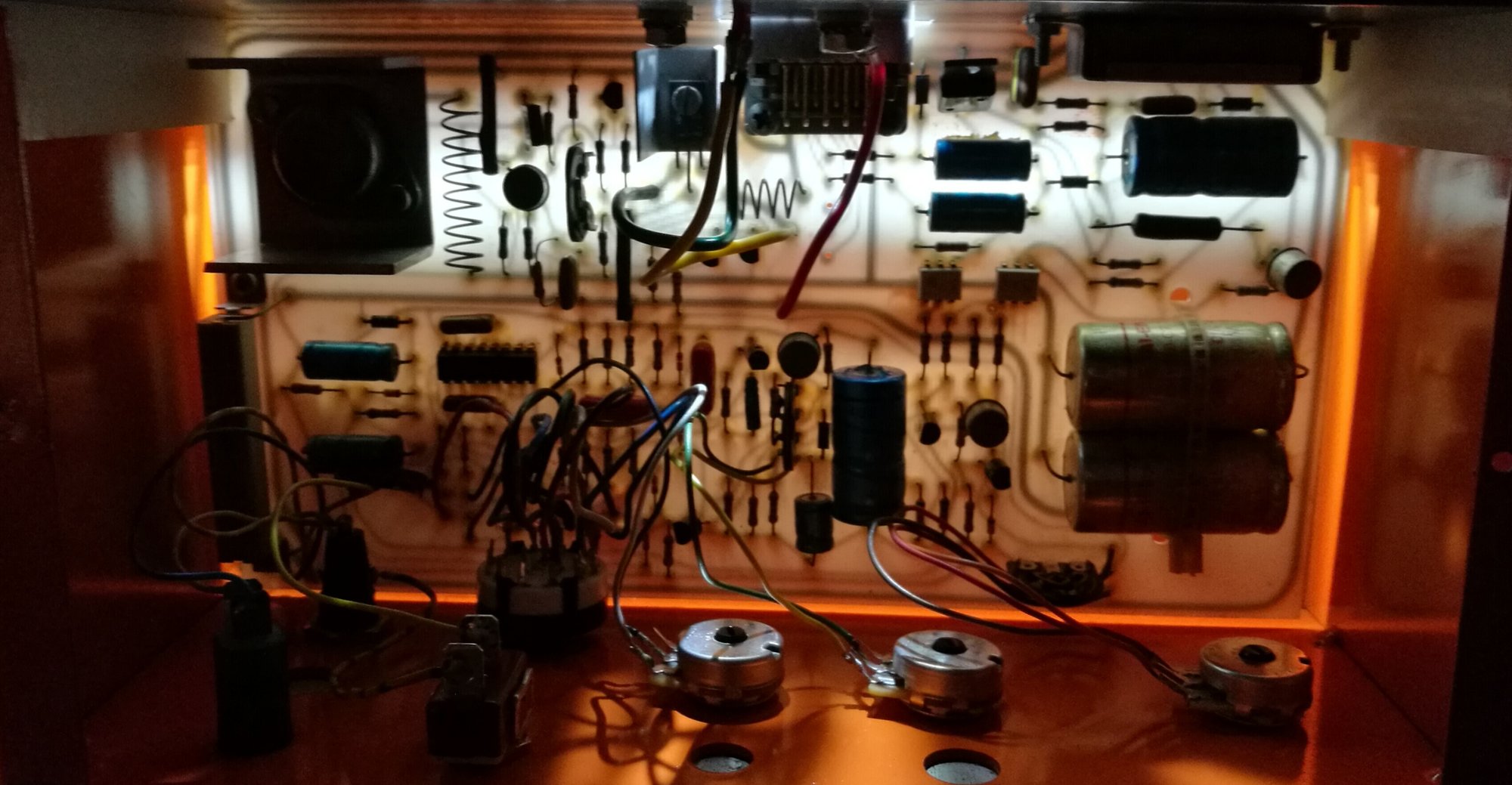

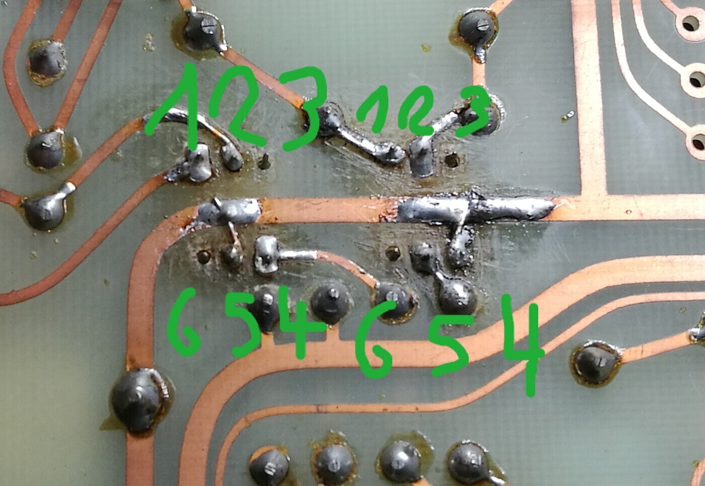

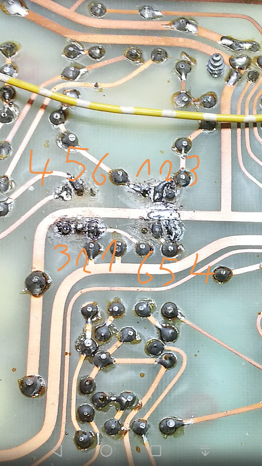

did i see someone had a go at repairing this before ? could they have had the cables off the 4 way switch before and thats why its running all the time ?
No. the problem is that the wire feed is running al the time. Thats why it was in for repair but the coud not figure it out and said it was the fzj101 but they coud not get it anywher...
it did weld before it was in for repair but now it doesnt.
