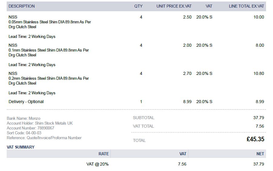

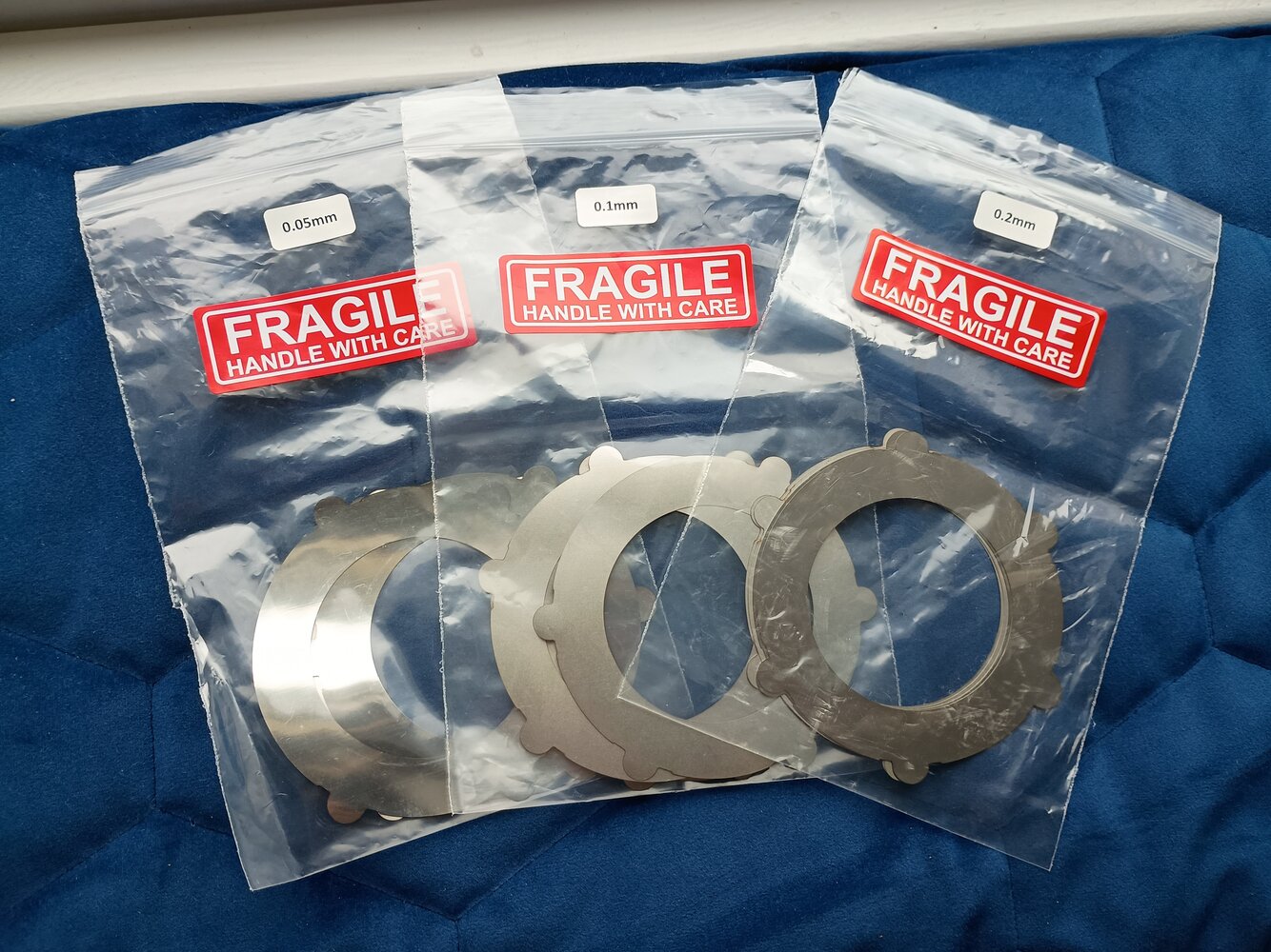

R RaceDiagnostics Member Messages 3,563 Location Broughty Ferry Today at 3:13 PM #22 I got a good quote from https://www.shimstock.co.uk/
