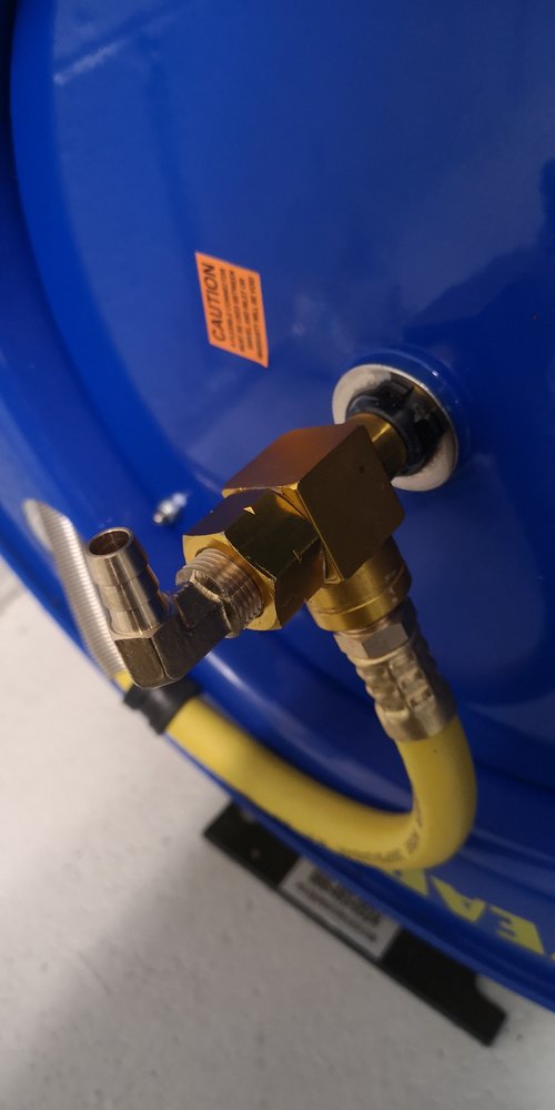

Obviously not the case here but I always thought the notches on the outside signified a left hand thread, like on gas regulators?
i thought they had some significance too. in the car world, these are on aftermarket brake pipe fittings which signify metricObviously not the case here but I always thought the notches on the outside signified a left hand thread, like on gas regulators?![]()

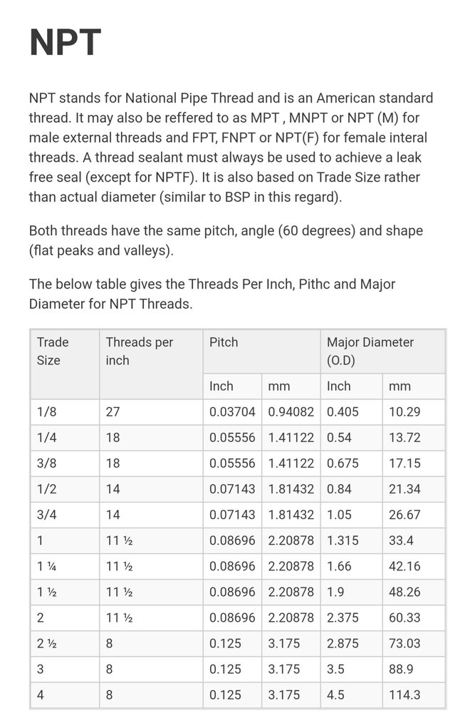

If it was made in the US, but sold in the UK, its likely to be BSP considering your NPT fitting doesn't want to run in
yeah i dont think it would have been changed, even the american warranty phone number sticker is still on it.I would like some more of the goodyear hoses but I have never found anywhere in the UK that sells them.
The ones I have both came from America
yep the hose tail fits, but its not a swivel joint so obviously i cant keep twisting the hose
