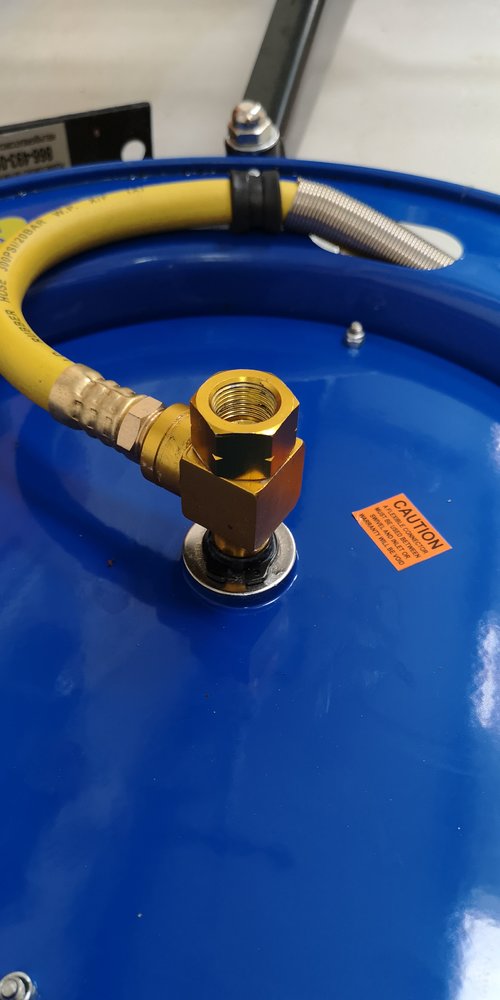

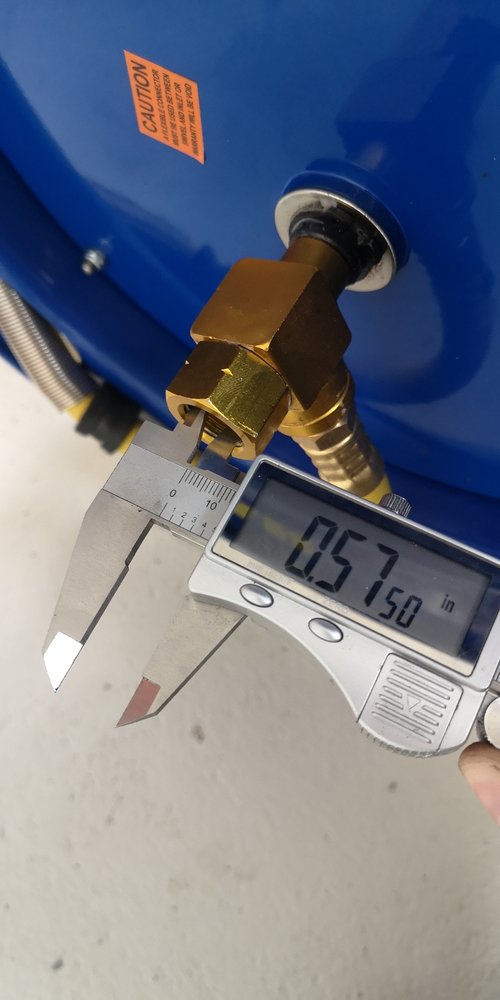

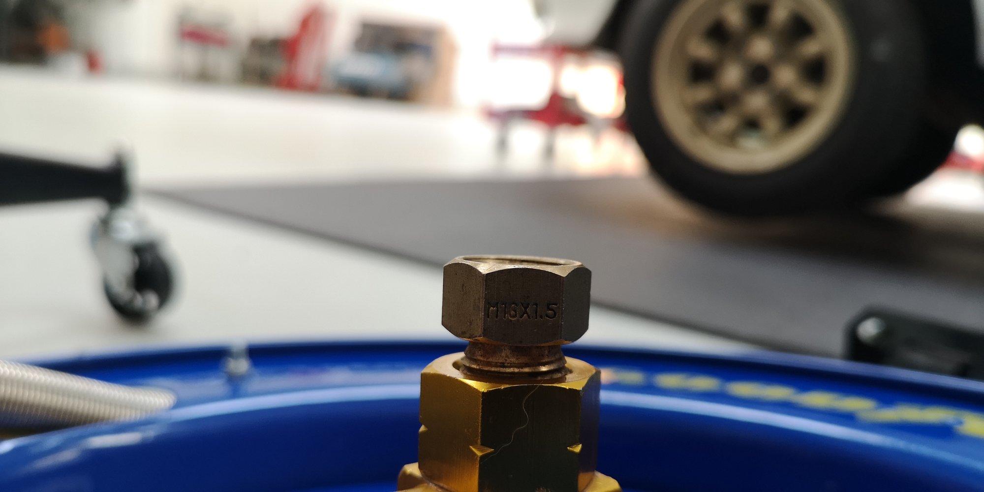

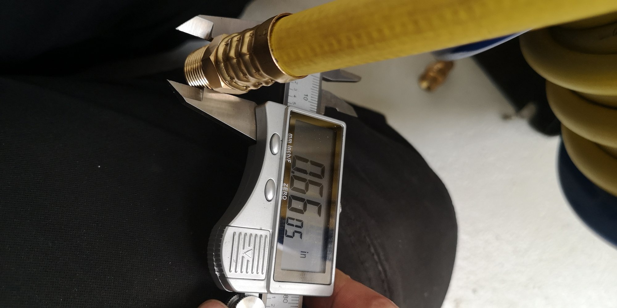

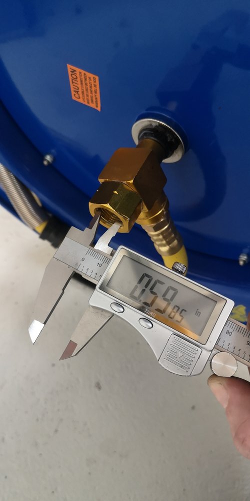

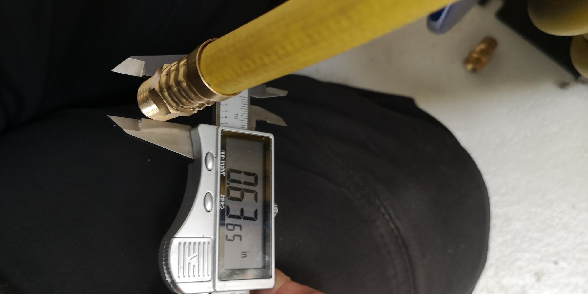

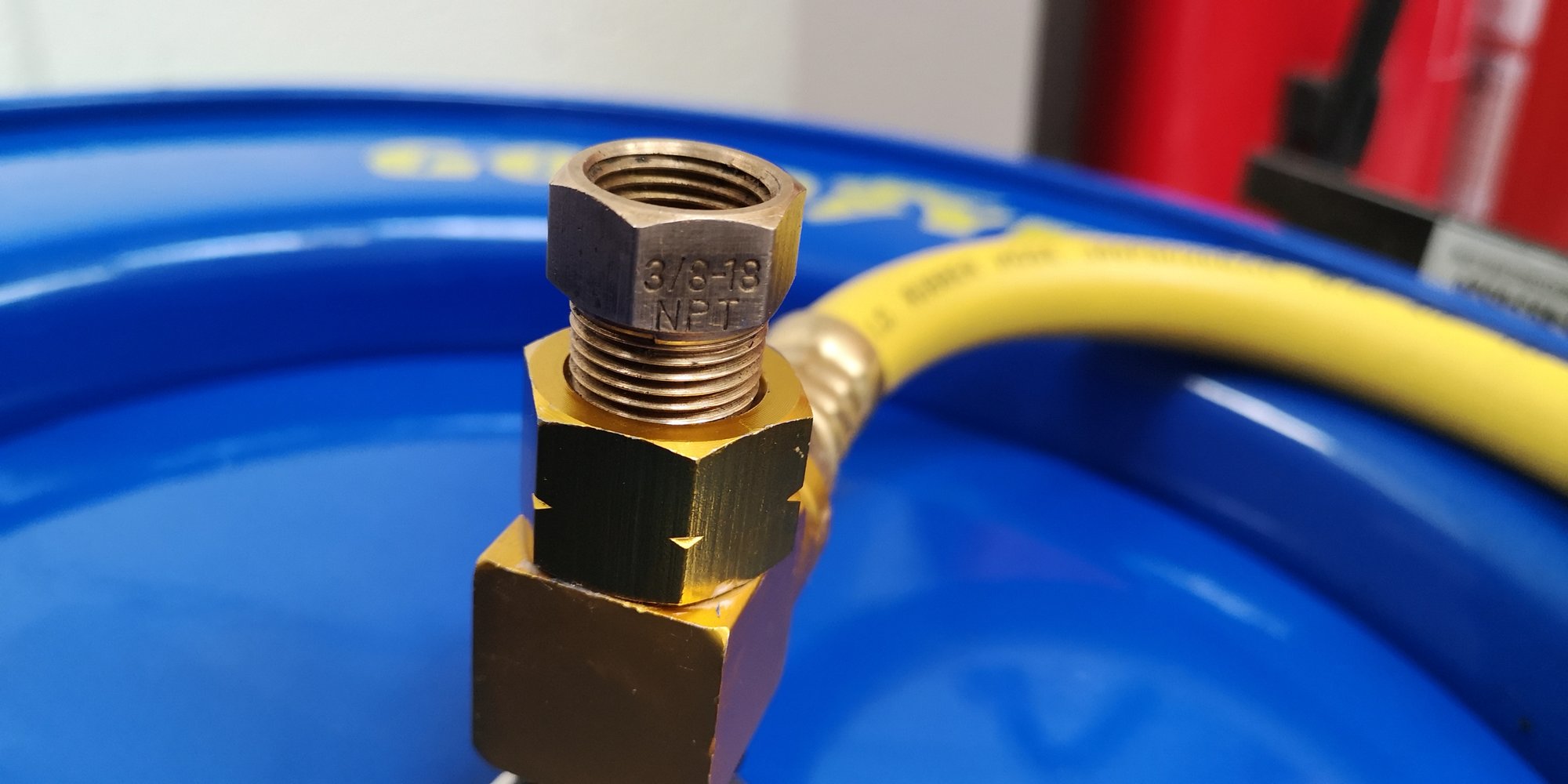

Hi guys,
I know for a fact this is the best place for me to get an answer to this question I've got this cool Goodyear compressed air hose reel that I think originated in the U.S. I can't quite identify the thread in it though. An M16 goes in, but is too loose, and 3/8 NPT starts in it, but get right really quick. And it's definitely tapered. Any ideas? I'm sure this is a silly question but I'm not overly knowledgeable with pipe threads. See photos attached
Thanks !
