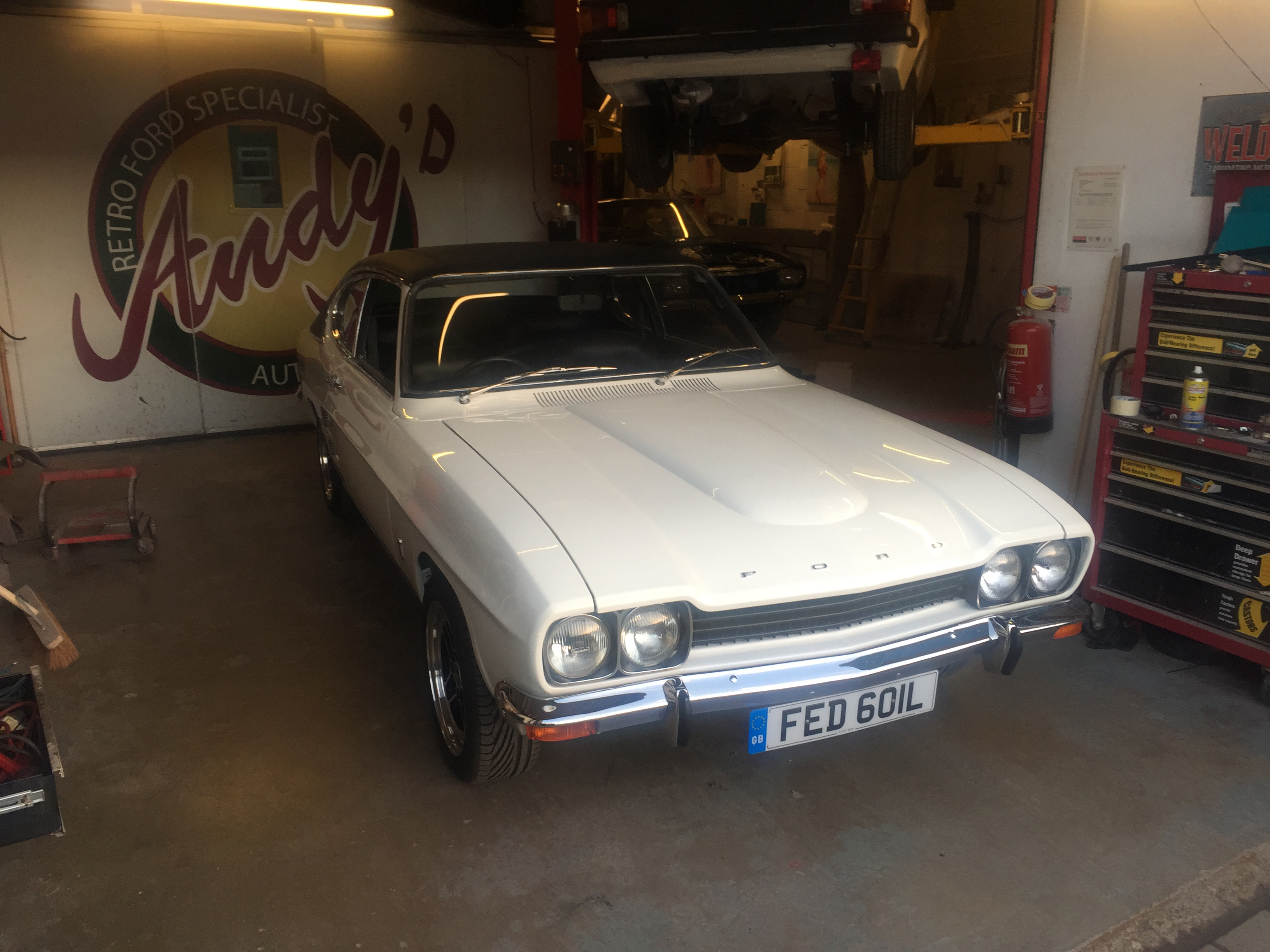

Welding a flat plate on a compound curved roof doesn't help. Just using a grit blaster will mess up a roof.Oh dear.... I don't understand what I've done wrong? I didn't get it hot or weld for too long or put pressure on anywhere, the patch is the same thickness as the roof, I'm confused
Battling tops....Welding a flat plate on a compound curved roof doesn't help. Just using a grit blaster will mess up a roof.
I tack without moving the torch and bob about, one each on the sides so it takes forever to do a patch but it stays very cool.
Grind both sides flat, keep the heat out of it with a water spray (Detox sprayers are good)
Use a light hammer and tap lightly and often (steel is slow to move and it's all in the wrist action )
It will be if he cuts the patch out every time the weld shrinks.Sunroof?
