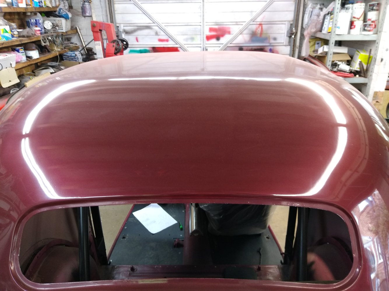

He has, and it did.For now, i would cut just around the outside of your current weld, and that will almost certainly pop back into position.
I'd scuff the underside up a bit and put a 'glass patch under it myself.
Dont knock PU glue, a lot of panelwork is stuck on cars nowadays.
