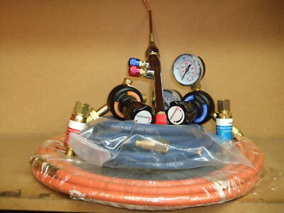

Already offere a hobbyweld bottle - what more can I do ?The deposit on the oxy bottle was the one that made me wince the most.
I know conflicting advice is a pain in the **** but you could heat with that. It is a cutting set but it will heat well until you pull the oxy lever to cut.So is this the kind of kit I need for just heating things up using oxy propane?
Oxy/Propane 18/90 Cutting Set
Contents 2 x Regulators (Oxygen & propane) NM 18/90 cutting torch 2 x Flashback arrestors (oxygen & fuel) 2 x Hoses Nozzle cleaner 2 x Cutting nozzles Combination spanner Single flint lighter Tool casewww.weldingsuppliesdirect.co.uk
Depends how good / confident you are with a torch. If you are doing 20mm bar that will get it hot in a good time in a localised area.
There is the option of a welding torch or a rosebud but for heating big stuff I just use the cutting one as above.
Depends on your budget. If I was in your shoes and was going to buy one thing for heating 20mm bar I would use that. The bottles etc are the pricey bit. You can always add another welding torch if you want to heat small stuff or braze / solder things.

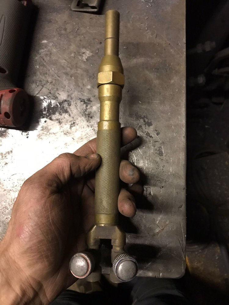

Not being rude but I hate them!!!My torch has interchangeable ends beyond the valves, so I can have a cutting torch, a heating torch or a soldering torch with just a few seconds of changing the end.
I thought they were all like that.![]()
Yep - my first one, a cheaper one, let all the magic smoke out one evening . . .Same as cheap welders, you get what you pay for. Send the right money on the right tool and it will run all day.
I can see how that might be the case, I basically only use mine for heating but it's nice to be able to cut if necessary.Not being rude but I hate them!!!
I’ve got different torches. Easy to swap the hoses. Just personal preference but if you’re burning a lot then I find there’s too much to get caught
OP - if you want this it’s yours for the postage. You’ll need nozzles. It’s butbro so not ****, just unused.
