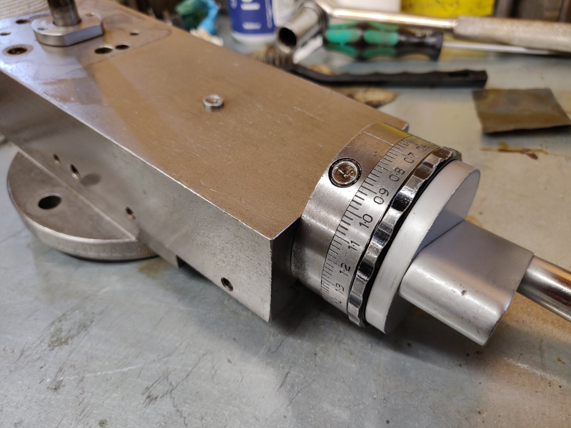

    Tailstock and compound slide stripped and rebuilt, both were in very good condition...

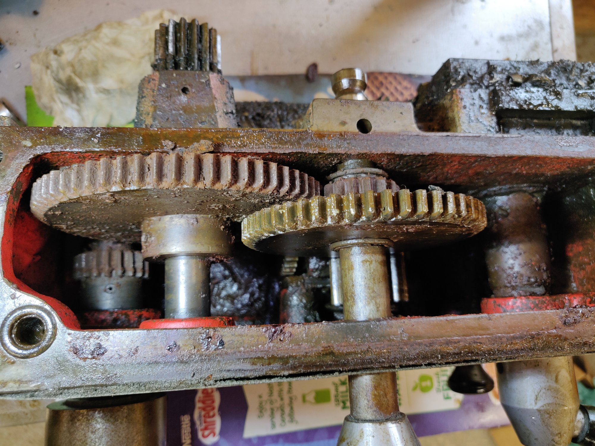

    Next was the apron....
    Looks parched.... don't think it's seen any oil for some time - fingers crossed not too much damage has been done, time to strip and find out.

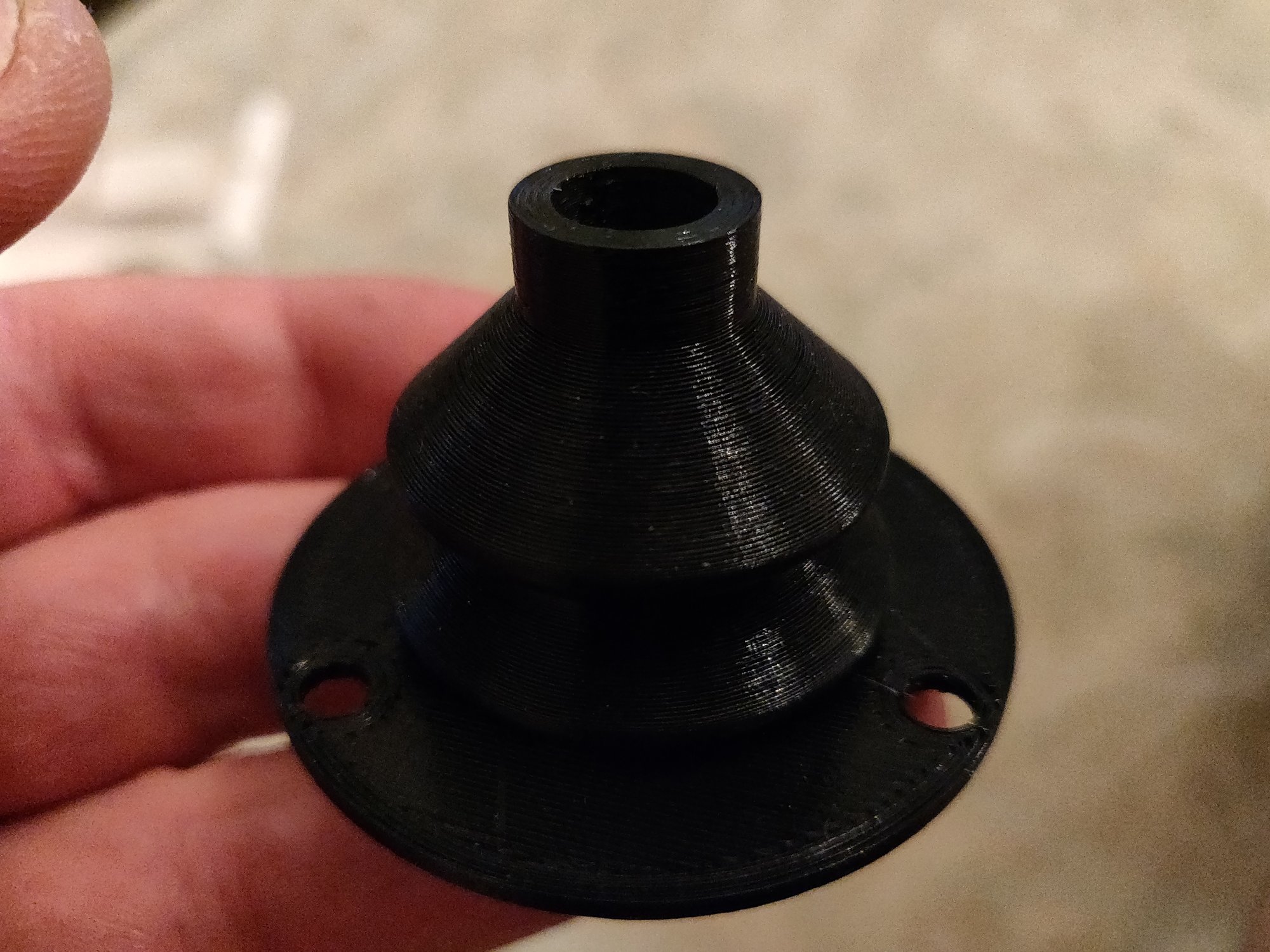

    Whilst I'm waiting for the citric acid to do its stuff on the gears of the apron I thought I'd have a go at 3D printing the apron bellows. This is the first attempt, will need some tweaking but might just work. IMG_20200319_203943.jpg

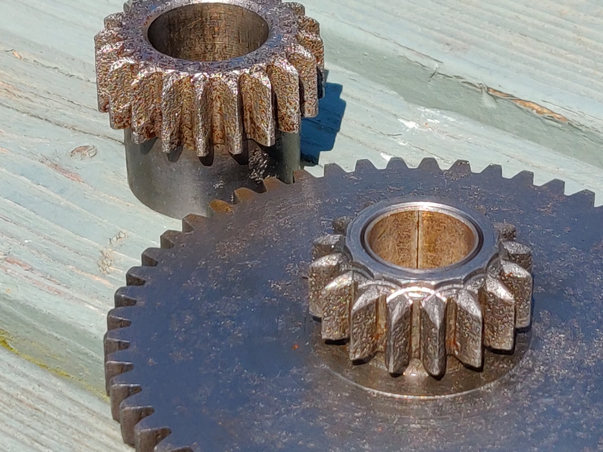

    The M300 has been keeping me busy. I stripped the apron and assessed wear - mostly moderate and confined to the saddle handwheel gear train. I investigated buying off the shelf gears and machining down since most of these are just pinned to shafts. Strangely the gears seem to be MOD 1.75 (not exactly common!) and then change to something neither imperial nor metric. The handwheel shaft is slightly worn where it passes through the apron - I'll take measurements since that should be relatively straightforward to remanufacture.

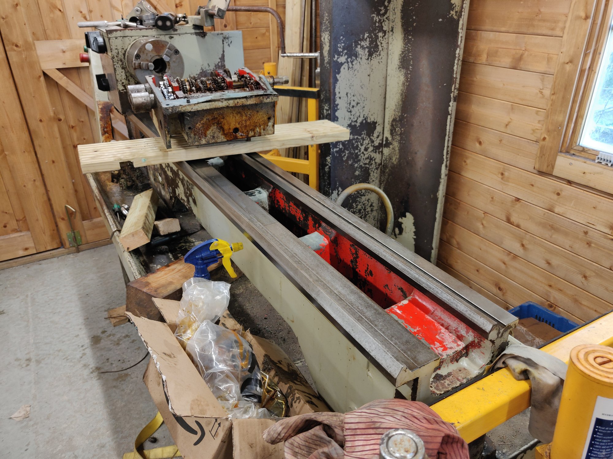

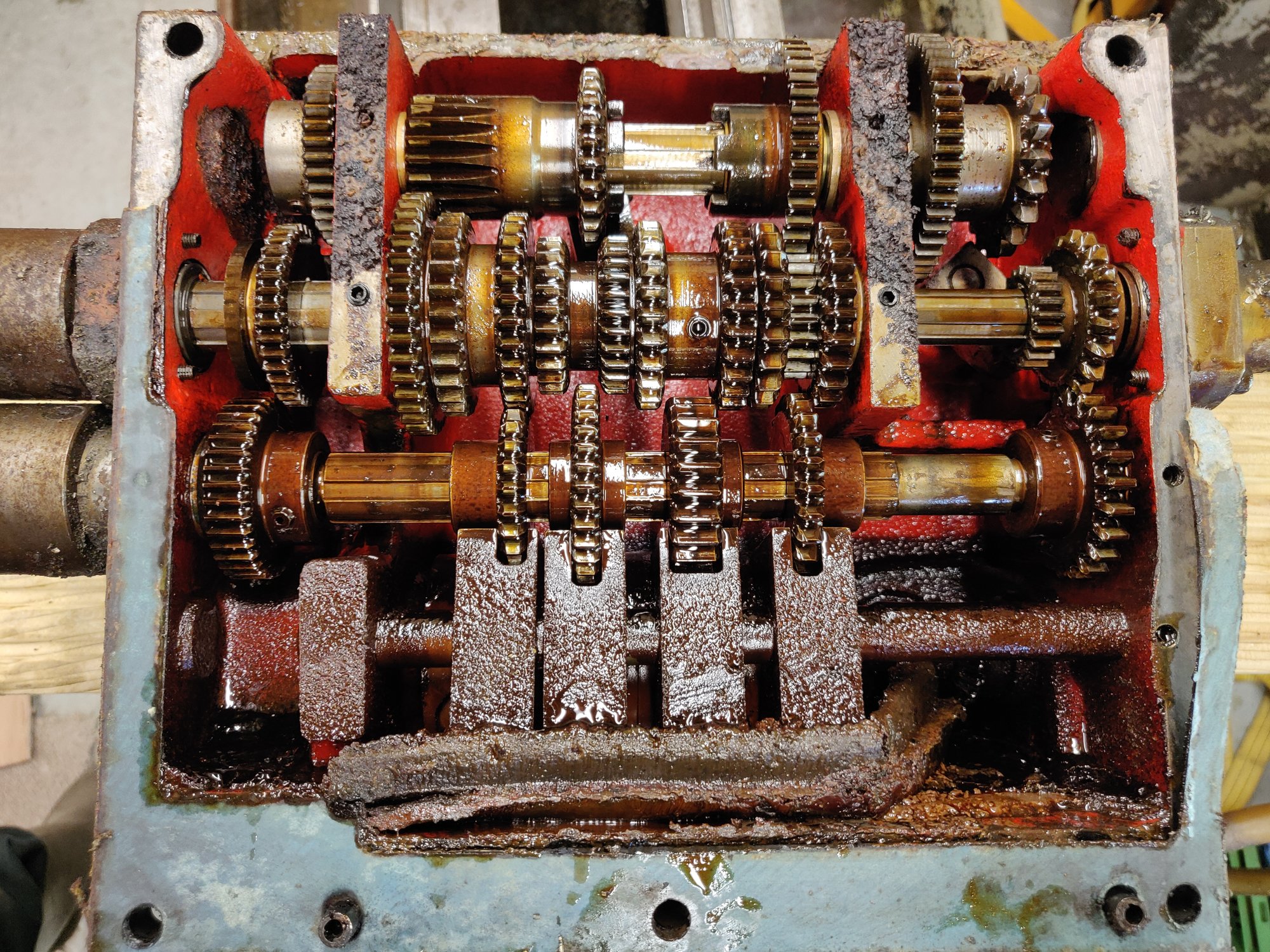

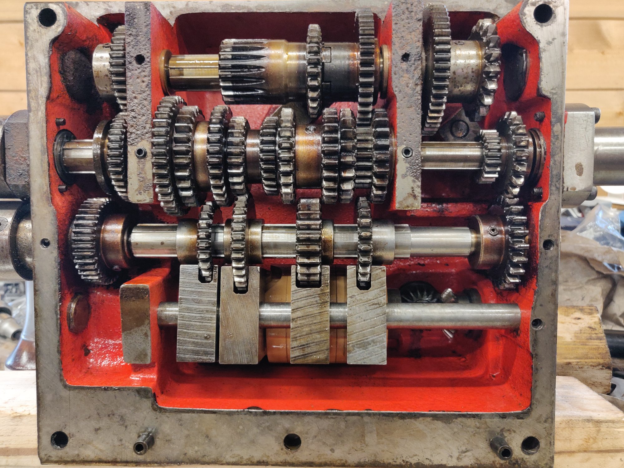

    Whilst I wait for a replacement thrust bearing (the original was rusted solid) I decided to remove and clean the saddle, clean up the ways, chip tray and investigate the feed/threading gearbox.
    I'd noticed the 8 position selector knob at the bottom of the gearbox was jammed, so drained the 'oil' - more a mixture of water which came out first and runny grease.
    On removing and inspection, plenty of rust, crap and sediment around the lower selector rods and drum but other than that doesn't look too bad.
    Now contemplating whether this needs a total strip down or whether I can get away with just the lower selector shaft/drum.

    My gearbox looked like that. A good soak in diesel for a few days, and you would have never of known

    Wot @Shox Dr said, mine was gummed up and stuck solid, few days soaking sorted it out

    As already mentioned a very good soak and I bought new Oil Windows from Stephens lubrication (cat no DW4064A) its the same size for all three.
    Just be sure that the numbered 1-8 is put on correctly (it easy to get it wrong)

    What gear are you measuring? If it's less than 20 teeth it's likely to be modified addendum so won't 'work out' by dividing teeth+2 by diameter.

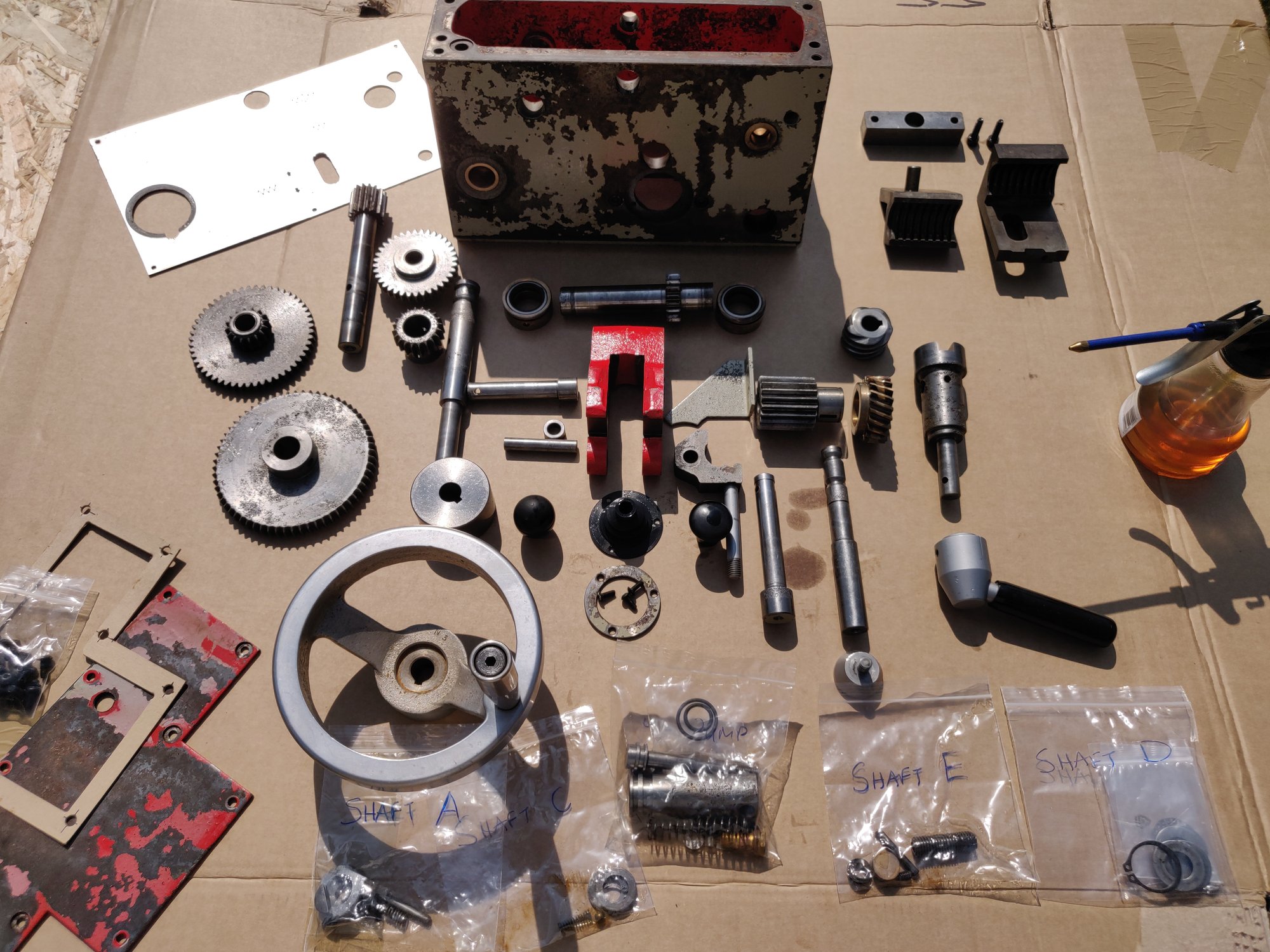

    I've got pretty much all the replacement parts for the apron so I'll start reassembling that.
    Some of the gears had wear compounded by excessive rust which after a dip in citric acid has left them looking pretty fragile...
    The one in the background calculates give or take to 1.75mod, the small spur in the foreground is more like 1.86mod.

    They'll still work. If you do get them re-made be sure to have them knife-edged to allow for easy engagement.

    Apron reassembled and installed with no problems nor leaks.
    After soaking the screw cutting gearbox in kerosene for several days it emerged in pretty much same state so stripped the selector fork, drum and 8 position indexed knob, thoroughly cleaned and reassembled with new o rings. After spending a good hour tweaking the change is very smooth...

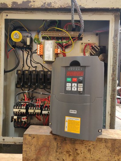

    With the screw cutting gearbox reinstalled it was time to wire up the VFD. It's now I'm wishing I hadn't upgraded to a 4kW model - it's massive.
    I don't want to mount it external to the lathe so I'm going to have to cut a hole in the pedestal wall inside the electrical compartment....a job for tomorrow.
