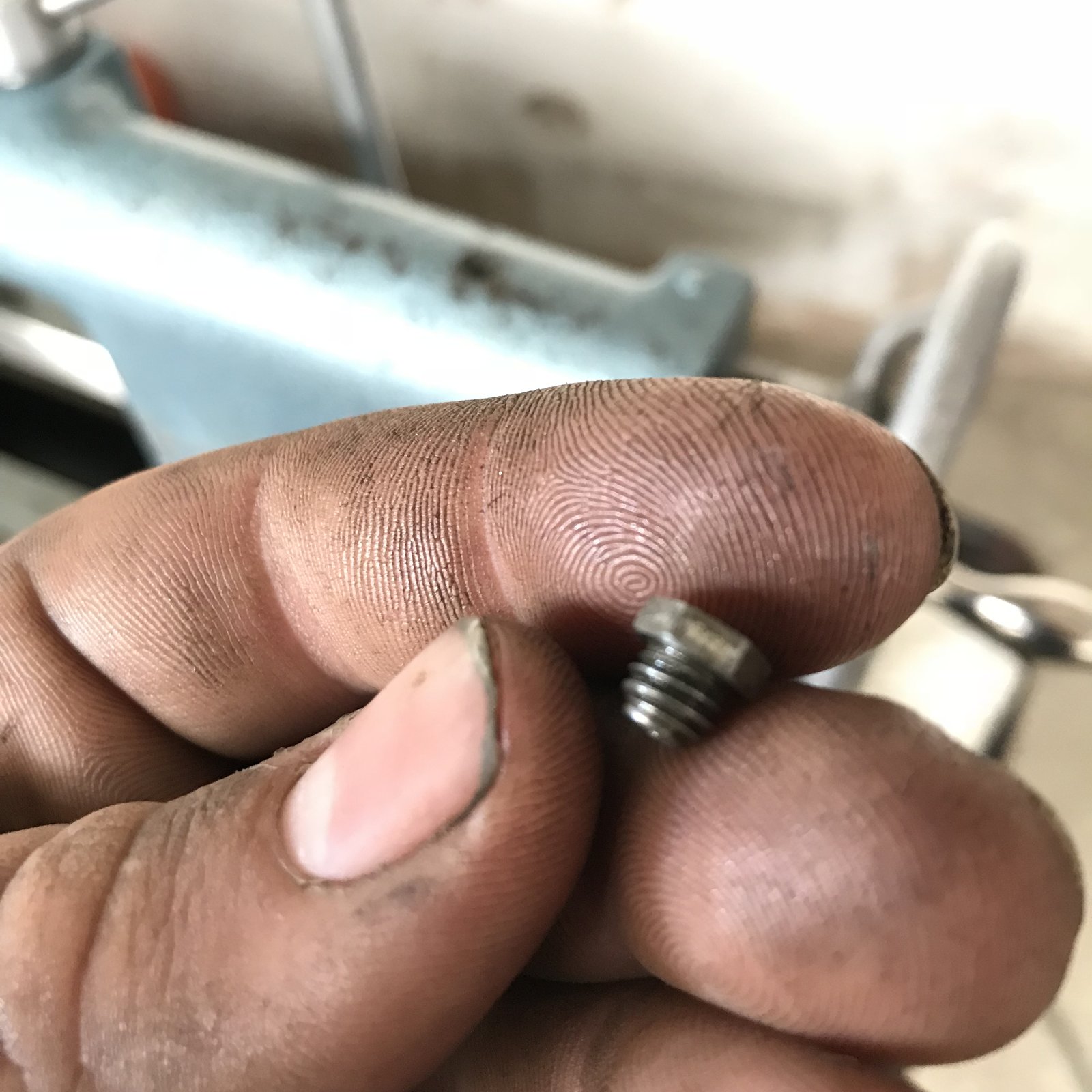

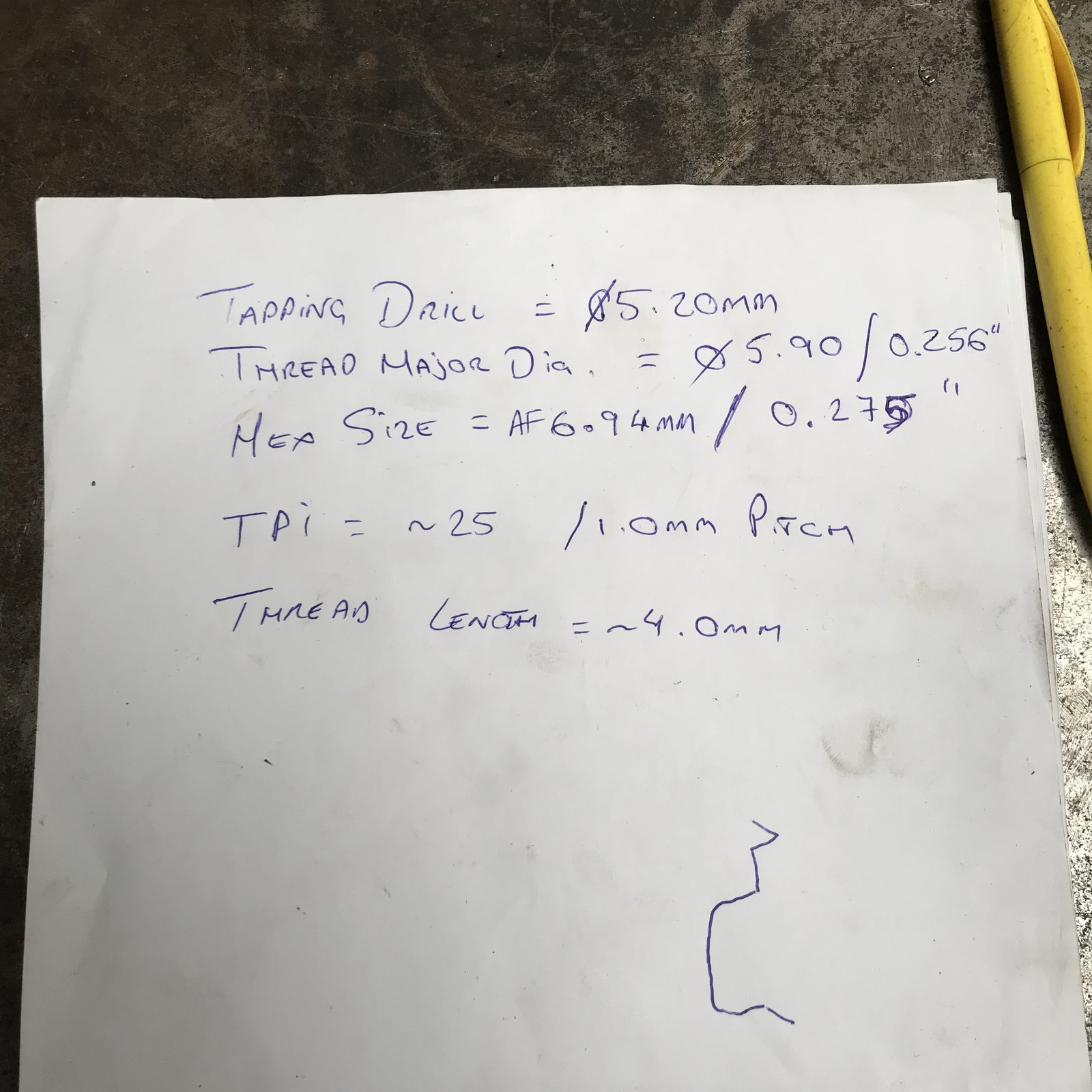

Anyone know what thread form these oil nipples are?
A 5.20mm drill fits perfectly in the hole, nearest tapping drill imperial size would be 13/64”. They’re not a particularly fine thread.
I’m siding with 1/4” Whitworth.
But could be 0BA?
