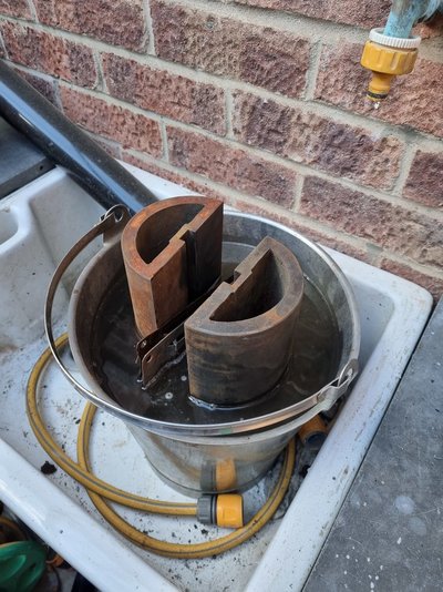

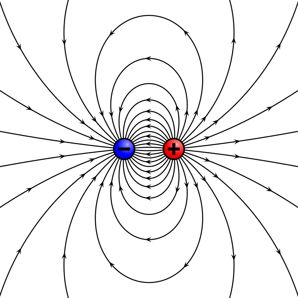

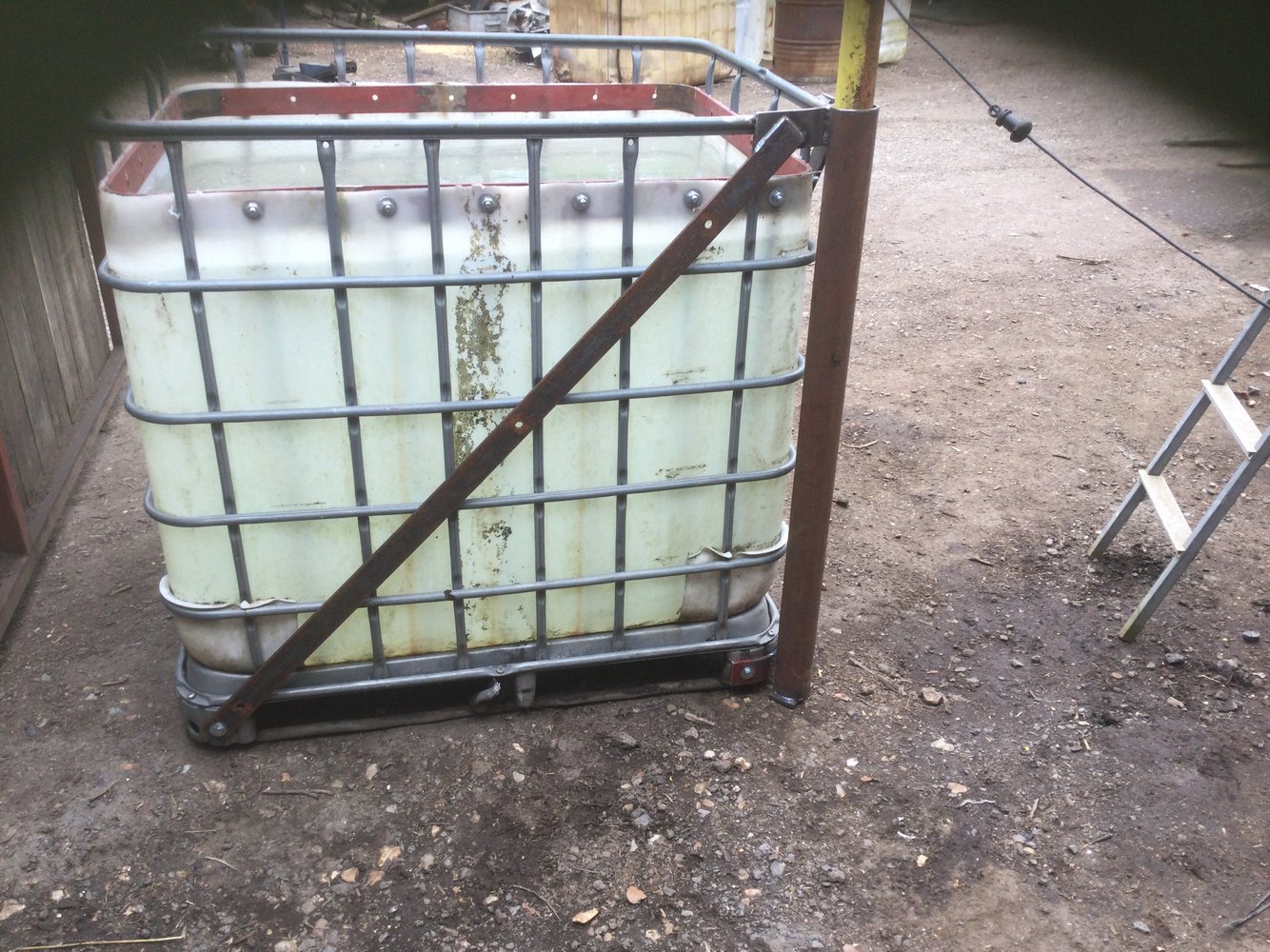

It's line of sight-ish: The electrons (And therefore the de-rusting action) follow electrical field lines, something like this:
It's faster where there's line of sight, but the back-side of the part will get cleaned just fine, if a little more slowly. The problems come when you have deep holes or tubular/hollow parts. Electrolysis didn't touch the inside of these grinder tables until I stuck an extra anode down the middle.

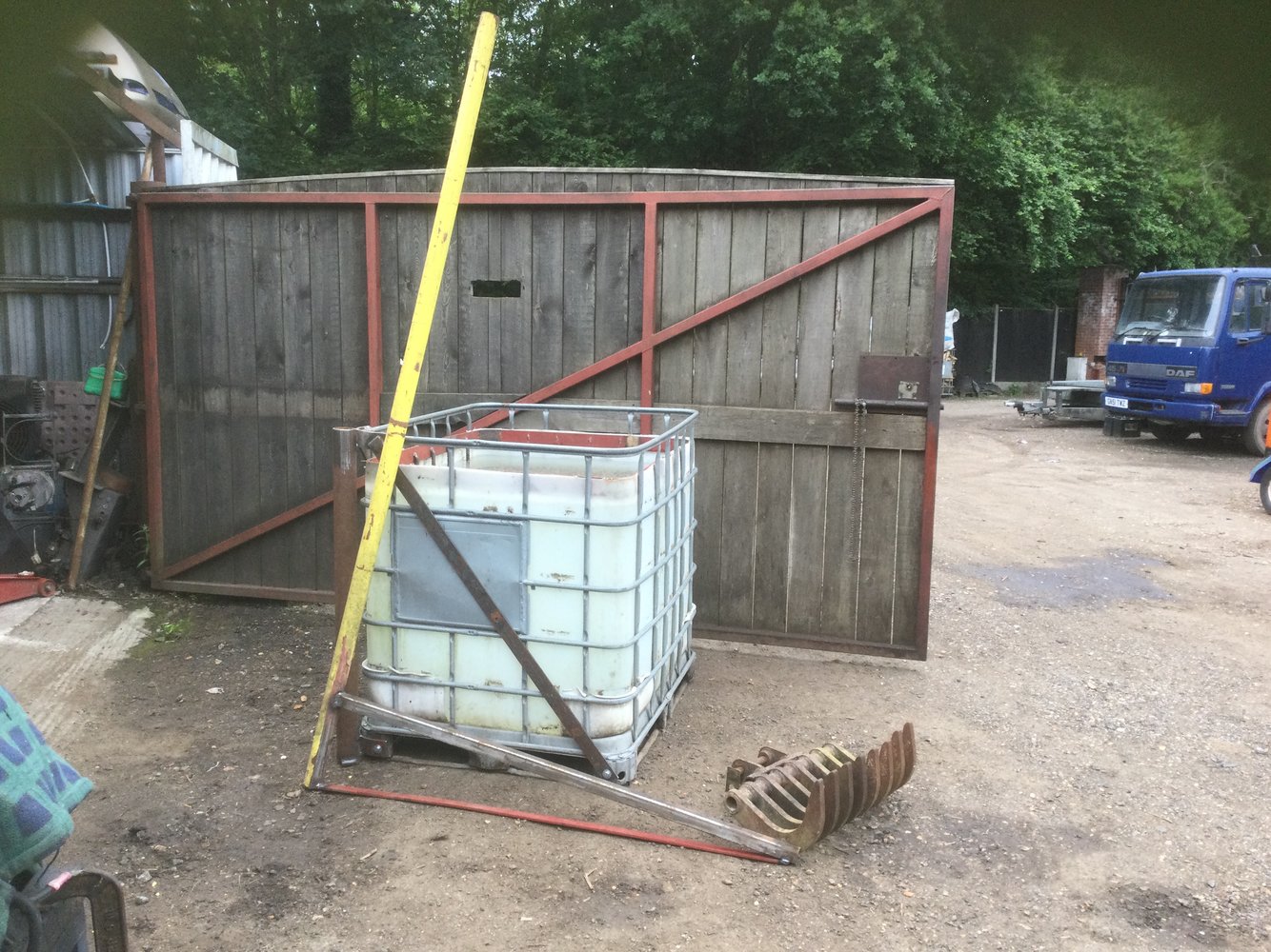

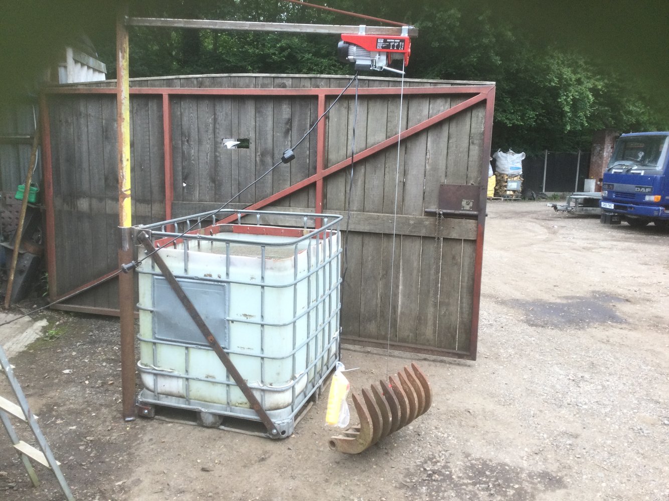

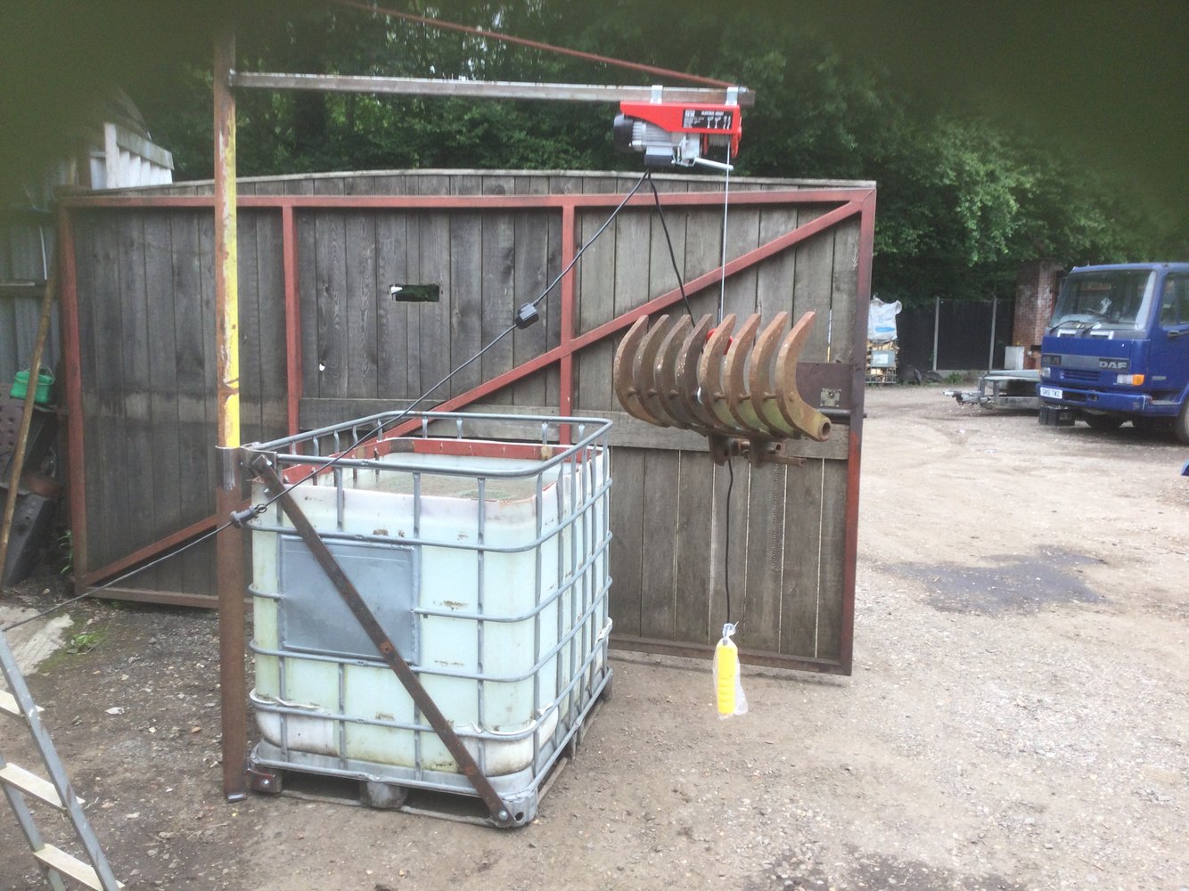

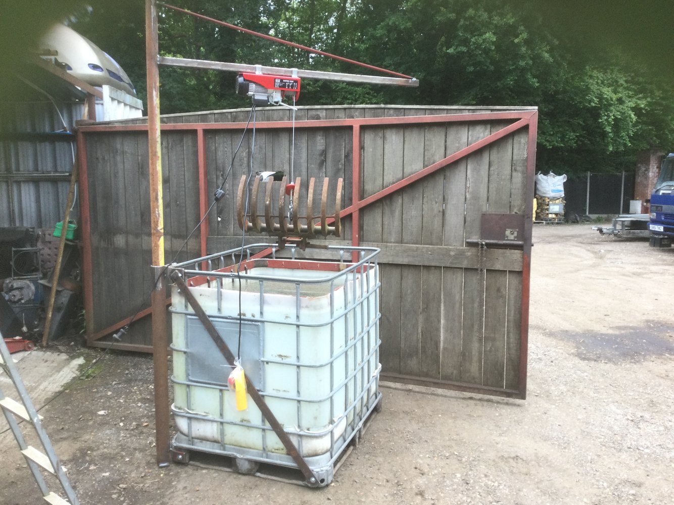

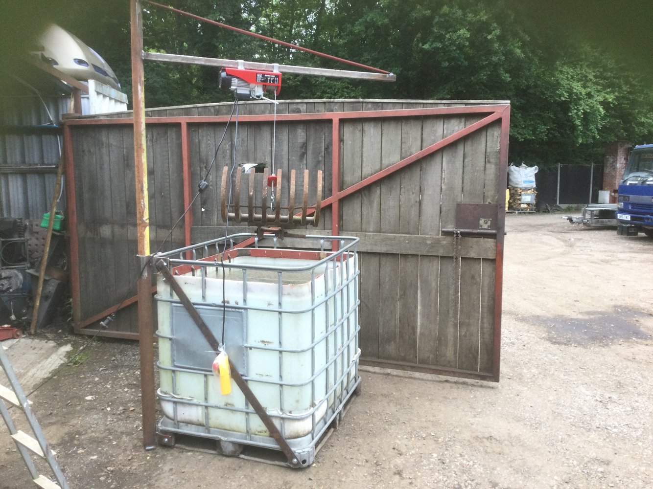

the idea is to dump that tank in the corner of the yard and have a pallet of gear next to it that needs cleaning, far easier that it self loads.
