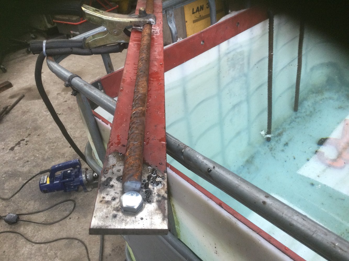

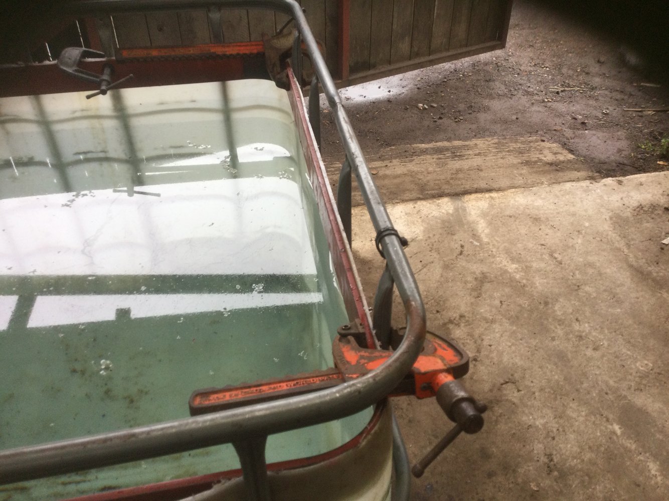

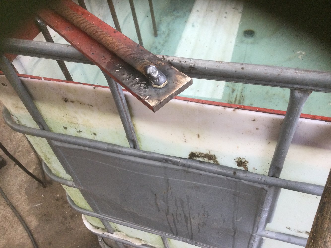

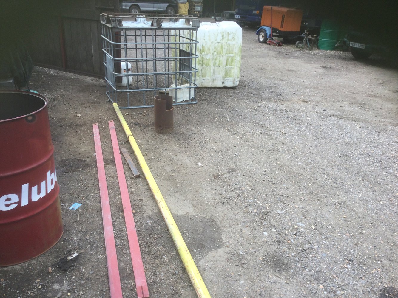

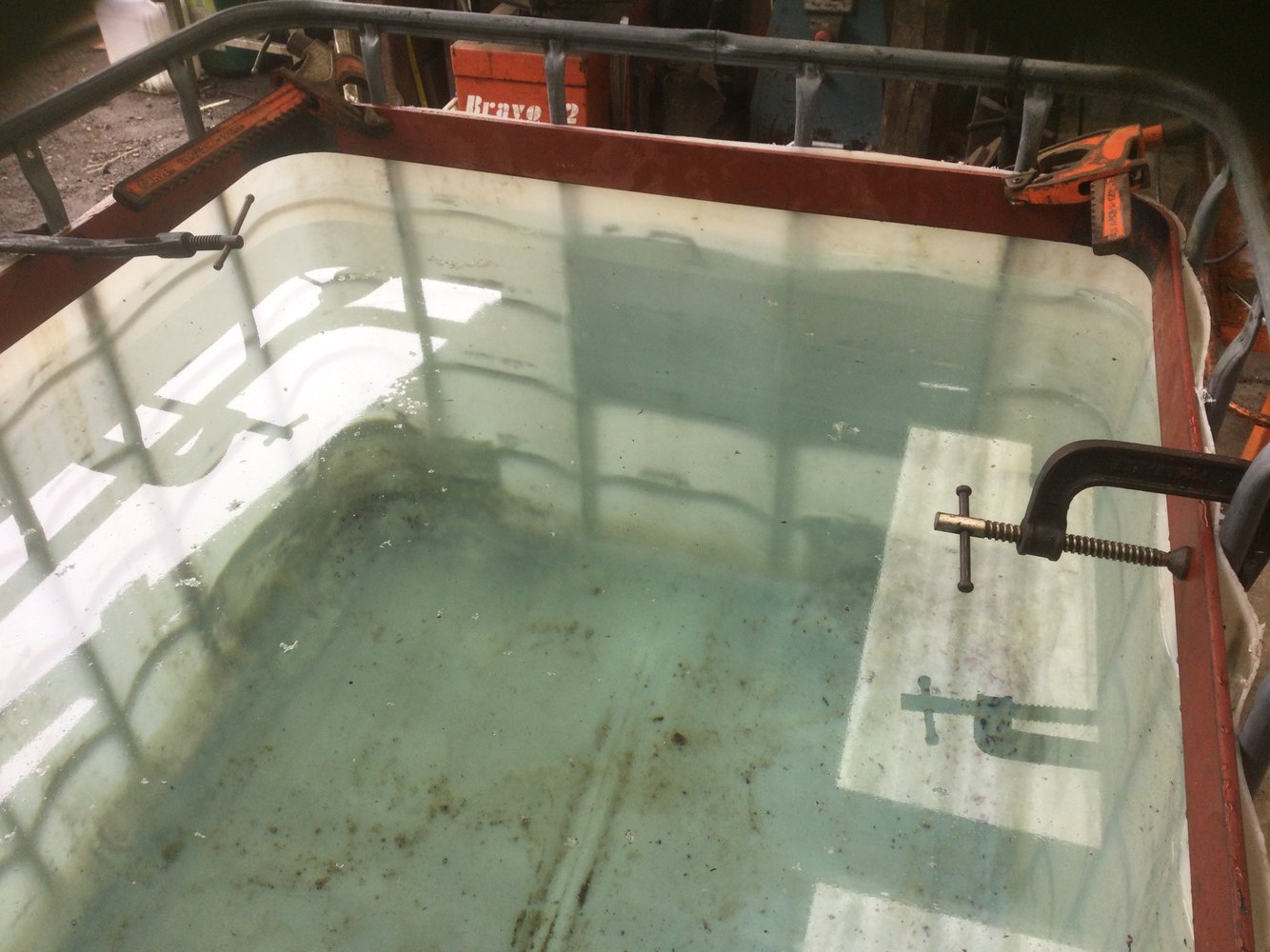

Inspired by the Queens jubilee and my desire to derust rather a lot of toolsntoys I am knocking up a gurt electrolysis tank using an IBC. One corner will have a swing lift attached.

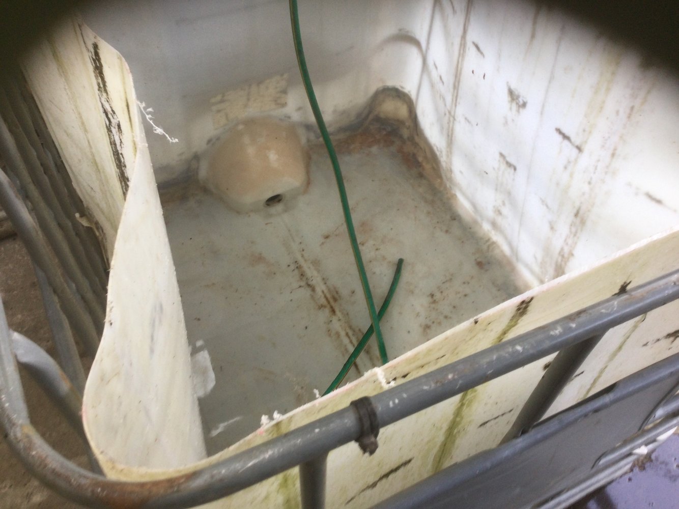

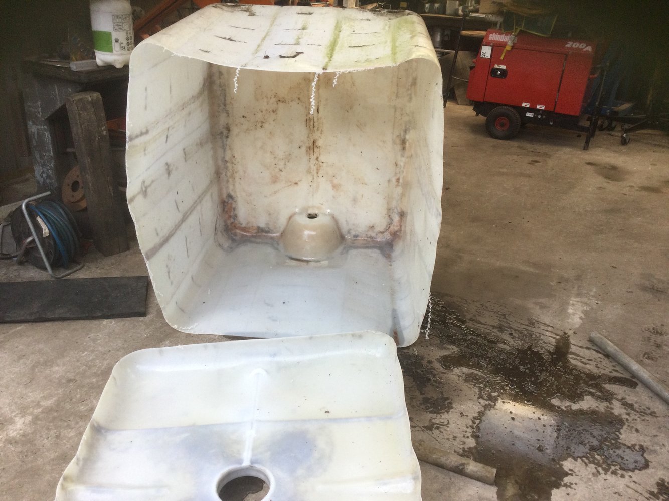

Found a half sensible IBC in the IBCery and pulled a few bits of steel out of the seasoning rack.
Trimmed off the top with a woodsaw.

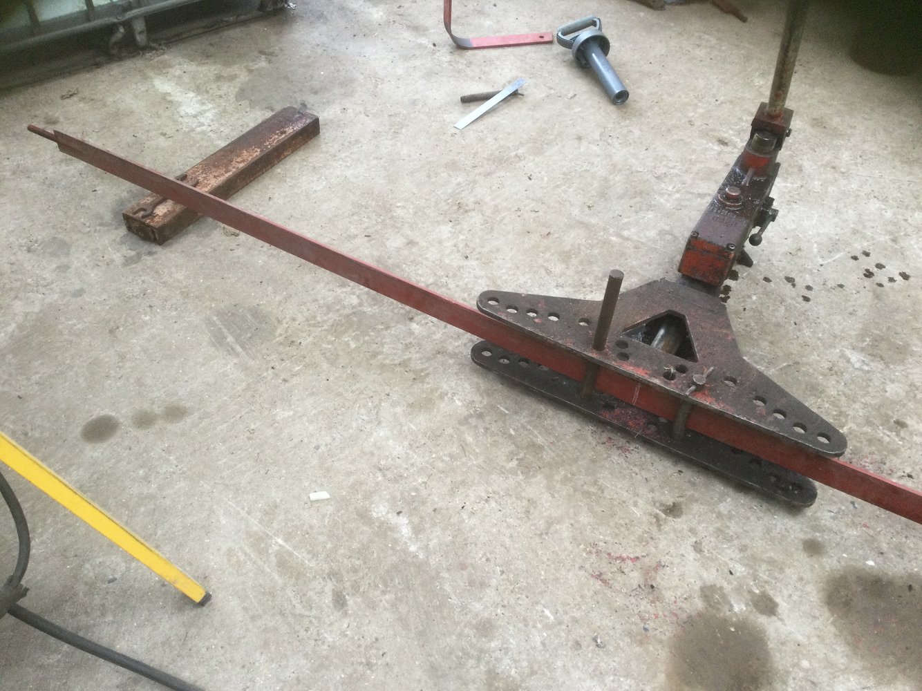

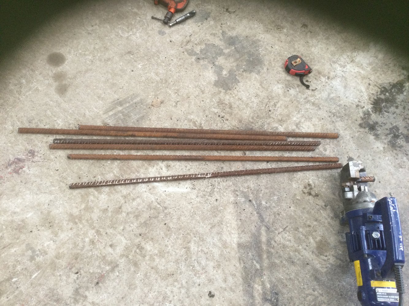

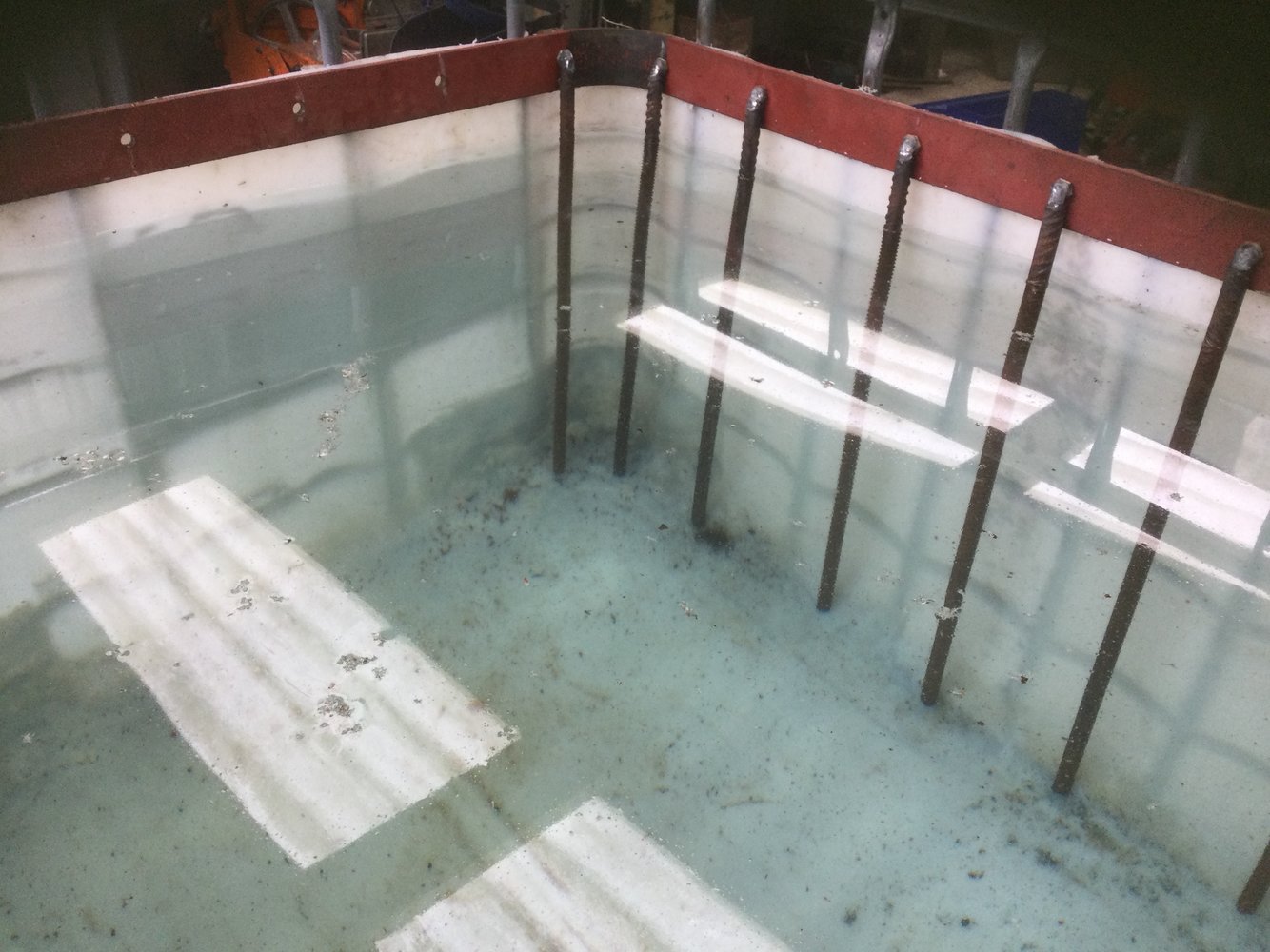

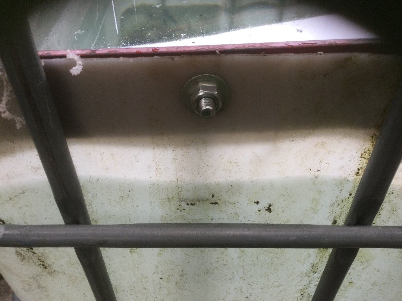

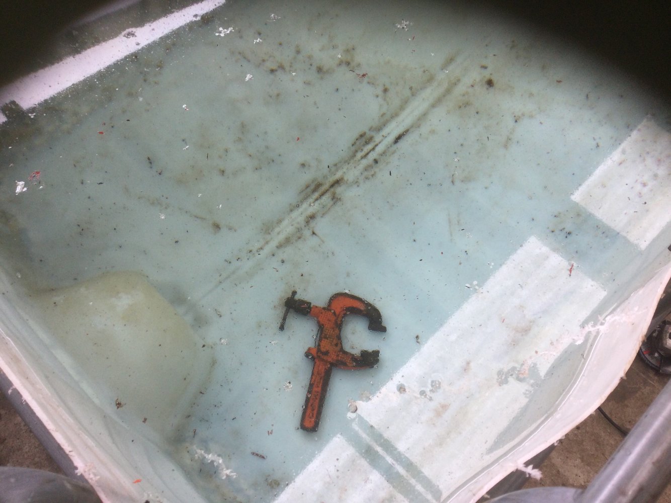

Baggy old things around the top with the lid off but I will edge it with that 50x6mm flat and that will also be used to attach the rebar annodes, filling it with water first so its all settled.

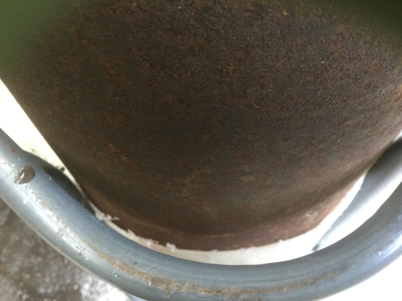

That lump of 9" tube is the correct radius for the inside so I will segment that to join to the flat.
