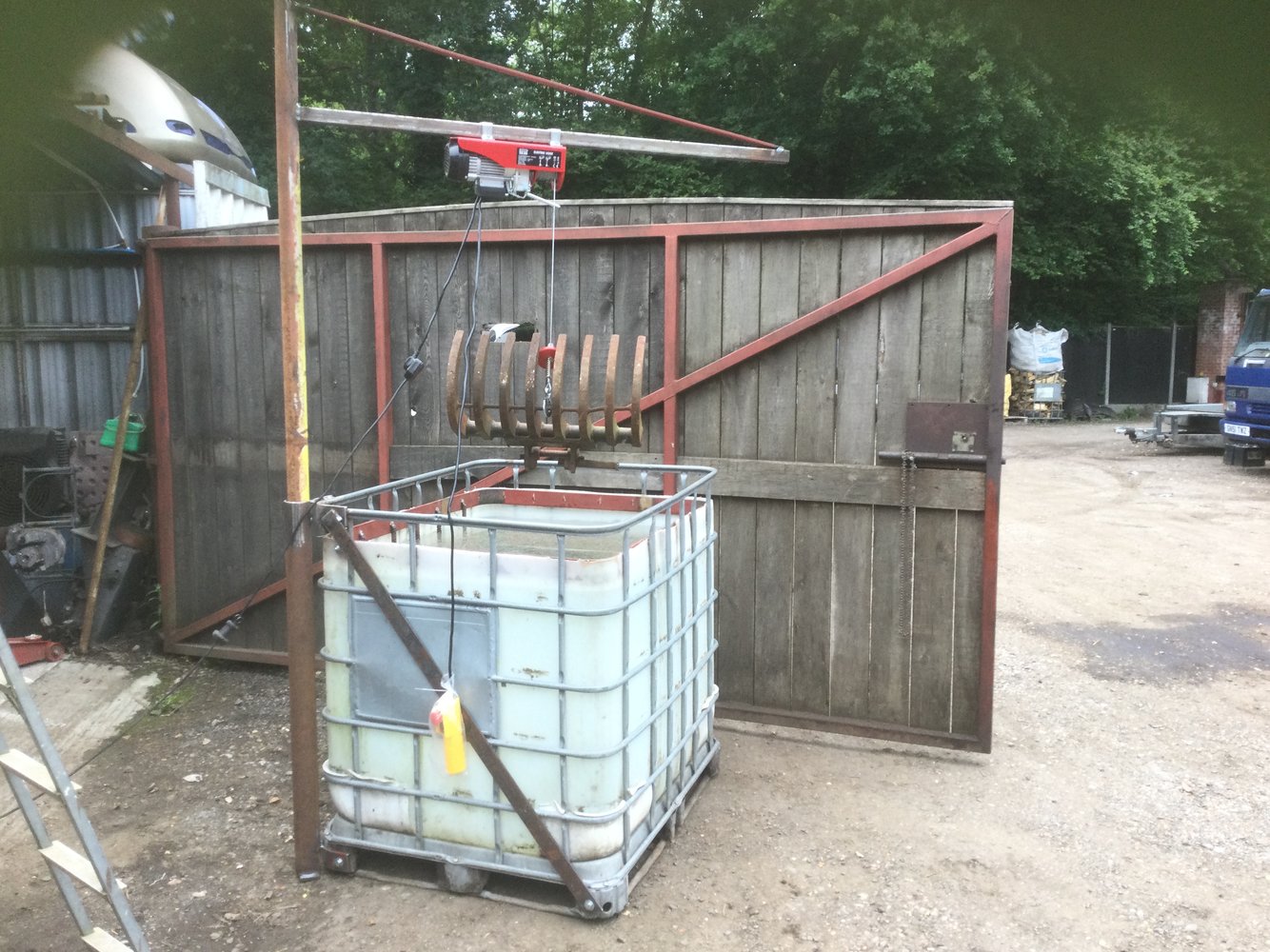

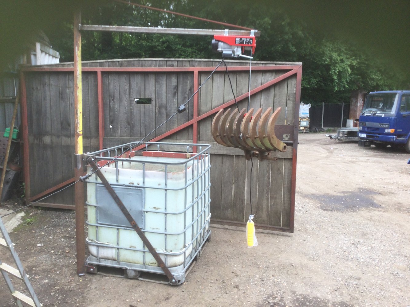

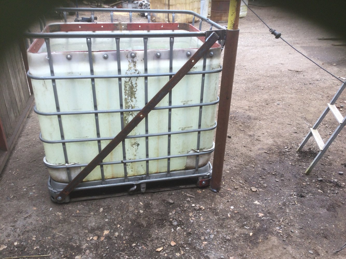

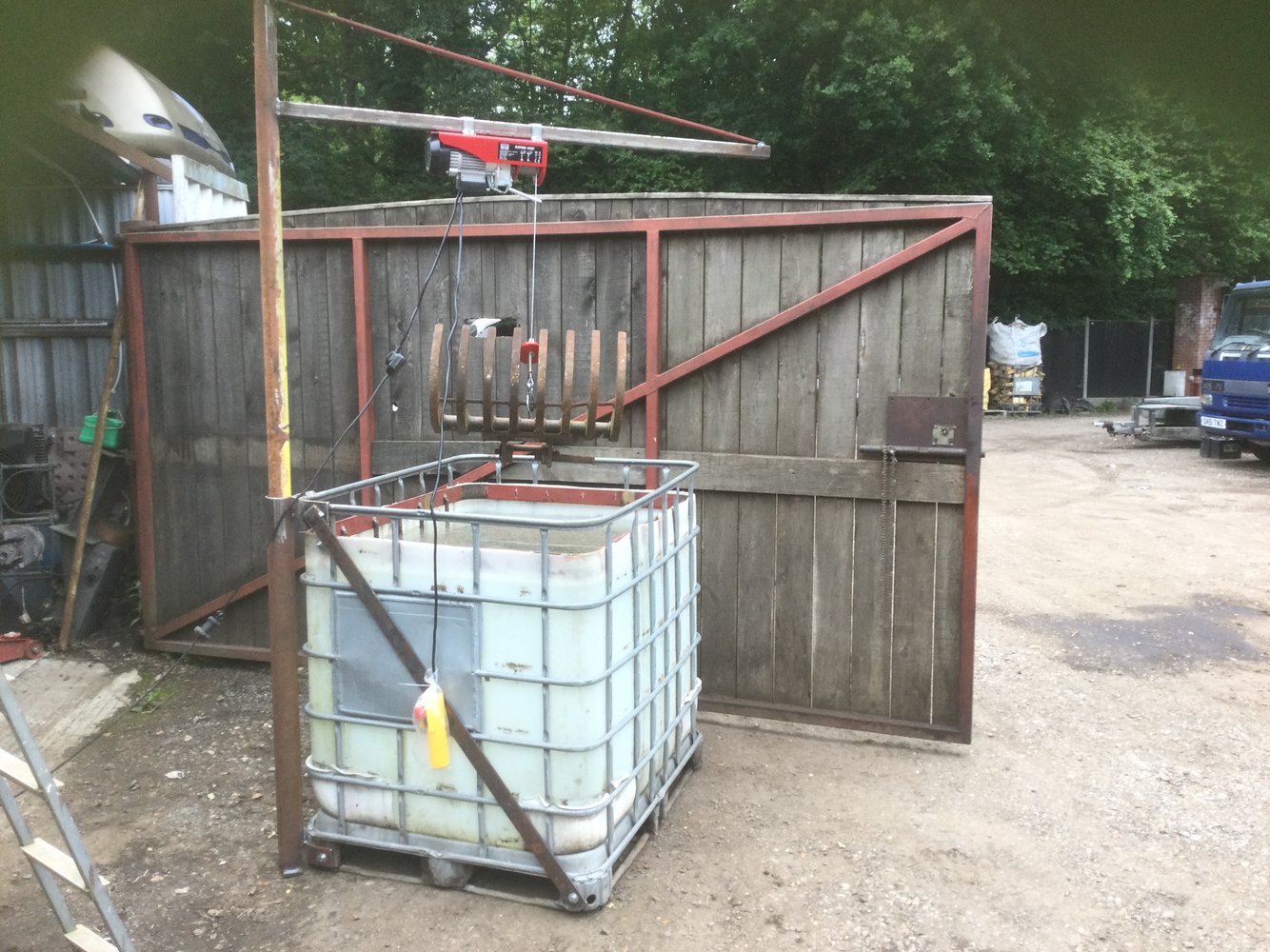

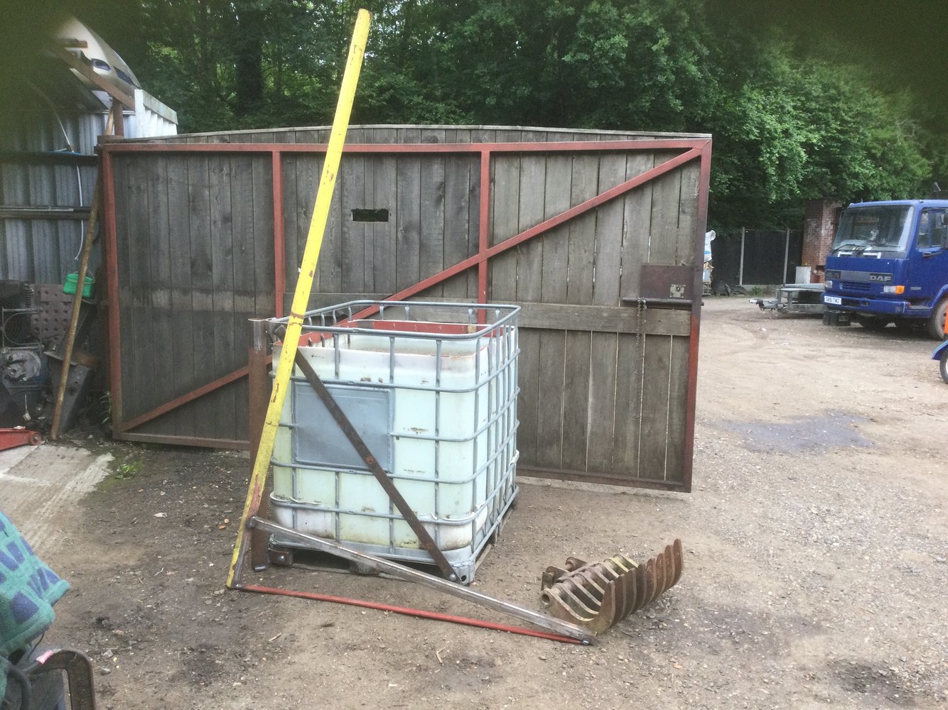

I can understand making the existing cage 'live' and using busbars sitting on it for the workpieces.
Given the steel strip edging to the container I assumed you would make that oppositely 'live' busbar and simply bend the end of the rebar and hook it over it.
They can then be increased/decreased in number to match power availability, or removed individually for jetwashing without interrupting the process.
Why the need to bolt them to the steel strip? I understand bolting the strip to the IBC.
Then we can discuss adding air sparge and/or circulating pump with or without settling or filtration.
Now, how much more complicated can we make this?
I dont know what I am doing so I am making it up as I go along

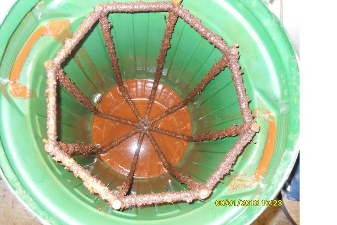

I bolted the rebar in place for two reasons, one being if they get knocked or move on the busbar they could short out on the frame/chassis and knock out/fuse the psu, this unit will be moved/be brought out with a forklift when needed so dangling reo would move. The other reason is I dont have a clue as to how many bits of reo a tank like this needs or whether or not I will have to weld flat plate to the ones I have to increase surface area. Cant find any info about the merits of bending the bottom of the reo at 90 degrees and having the anodes run along the bottom of the tank.
Never thought about pumps and filters, there is a 2" drain tap which could be used as a pick up.
