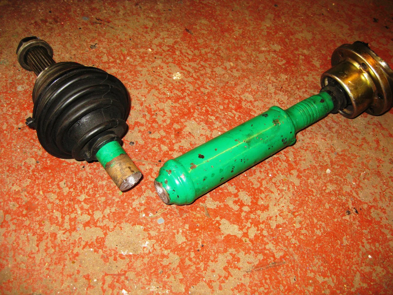

Audi/Skoda (Getrag) 6 speed 01E transaxle/gearbox.
Fitted in lots of things they shouldn't be in. They are great on smaller engines that rev but worse than useless on a V8 torque monsters, I have driven a few where you pull away in second gear because first is way too short, miss third, into forth for a very short period and straight into fifth.Even Lotus had to downrate that V8 rover engine they shoved heads on because that gearbox couldn't cope. Good gearbox but not for everything.Those bloody Renault boxes get everywhere...

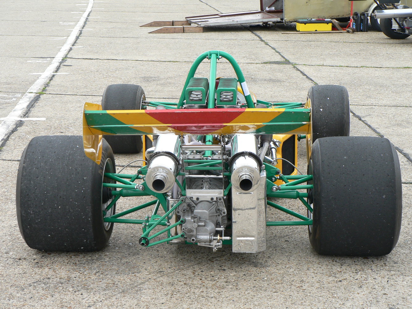

Excellent. Presumably massively cheaper than a Porsche G50. Or probably cheaper than a Decent Renault UN1, which would probably be marginal in a car of the GT40's weight with the torque from a Lexus V8. I'll keep an eye out for one of the Getrag transaxles. I have a Renault UN1 'box in my home built single seater at present. It's now installed upside down in order to get a decent driveshaft angle. This requires the position of the crownwheel to be reversed in order not to have 5 reverse gears and 1 forward. Also I had to arrange for some lubrication to reach the now 'up in the air' gears. BTW, for any Renault anoraks, it does look like one of earlier 369 transmissions in the photo but has a Renault 369 selector housing on a UN1 'box.

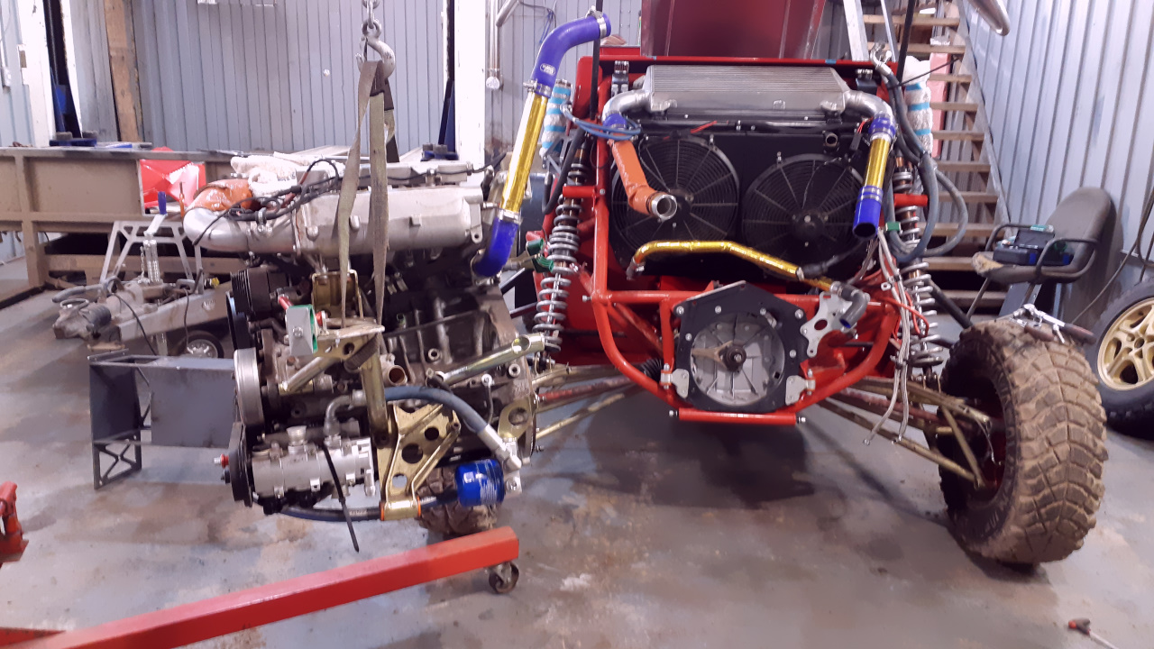

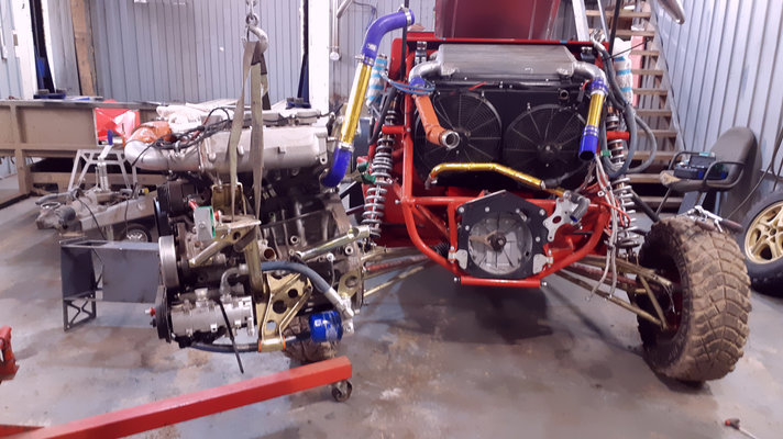

1st gear was useless on the buggy even with 250bhp and 9krpm to go at.
's gonna struggle now with 400![]()
