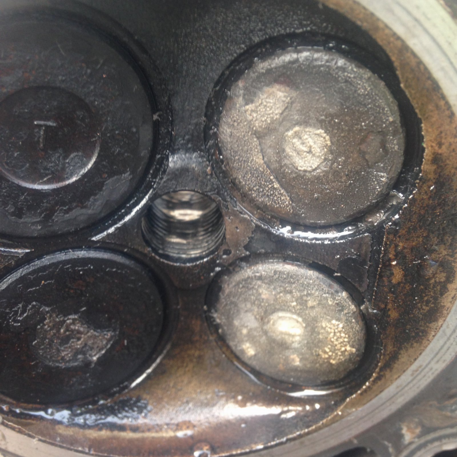

I agree with 8ob my money is on a piston/head gasket not valves
Most people have a spare wheel....Broken biker has a spare car.Well I haven't had a great deal of time to work on the car today but I did manage an hour or so...
I may have found part of the problem, and I have definitely found where the oil was coming from...there Is a crack In the valve cover that the oil has been leaking through slowly...

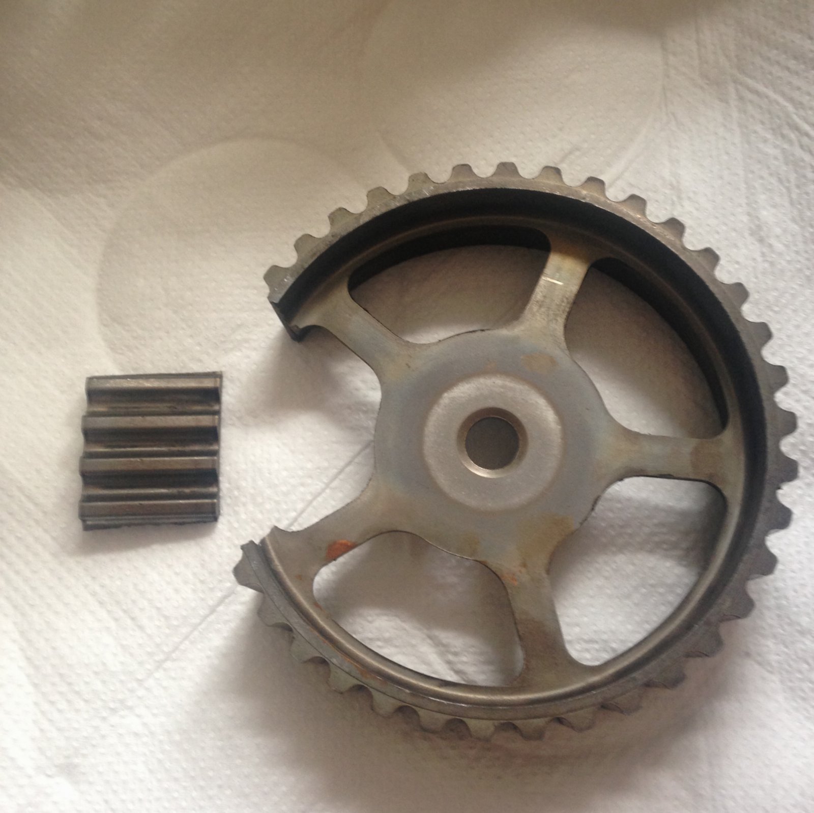

As I started to tear into getting the head off I removed the cam belt cover and found a piece of the inlet side cam wheel as it fell out when the cover was pulled away...4 teeth have broken away from the cam wheel in a chunk...
I think the low compression may be because of a bent inlet valve if the cam belt skipped when the wheel broke...belt is still intact with no signs of damage but think I will take this opportunity to replace it and the water pump...
