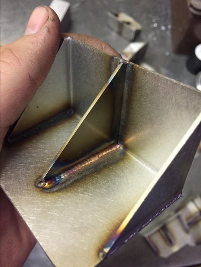

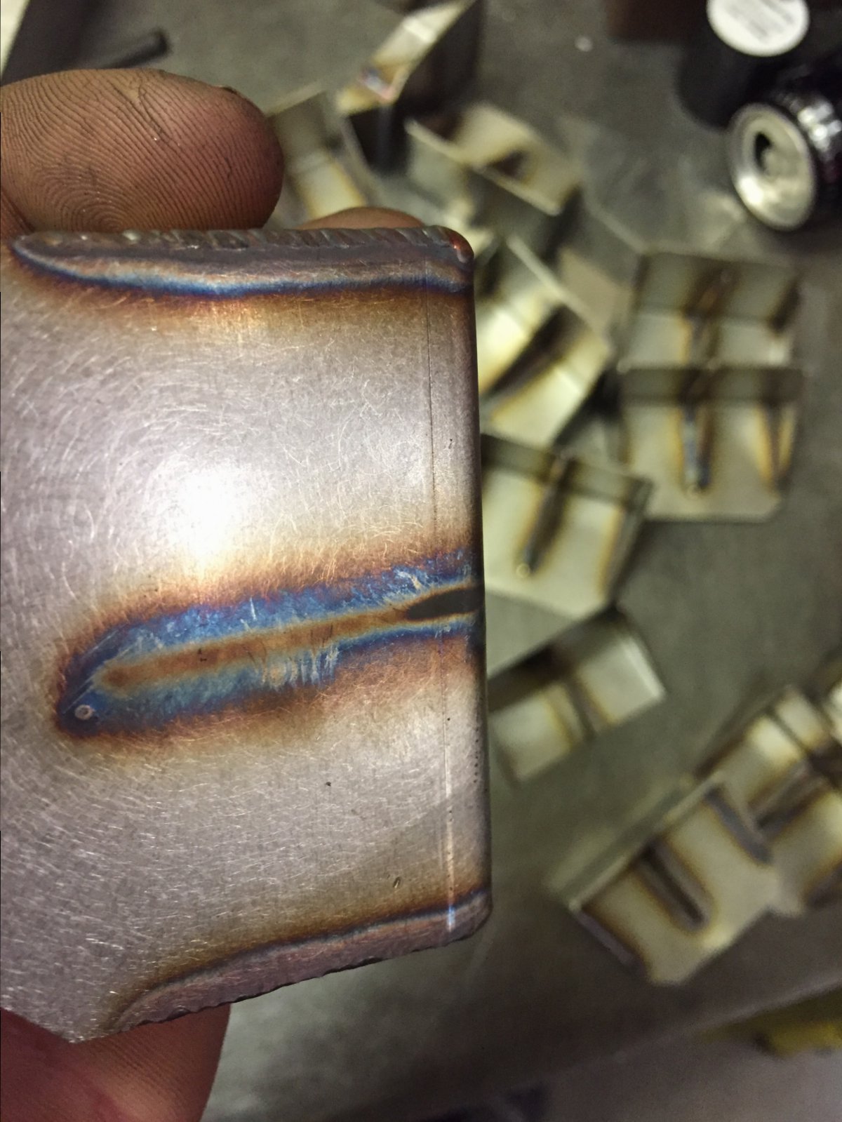

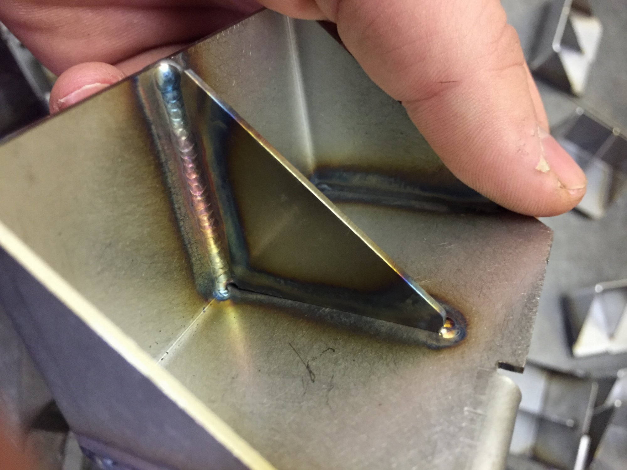

If that's what your looking for you'll get that through a no7 giz. Heat input (or lack of it) plays a bigger part in getting a weld to look colourful in heat tint. Take a ganders at some of @Paul. s stuff before he cleans it up. Different industry mind so he won't be leaving them like that but the point is you don't need spendy cups and big gas volumes to get it you just need to know how to weld stainless. Keep your big cup for Ti jobs. Do afew of those and it will soon pay for itself.
