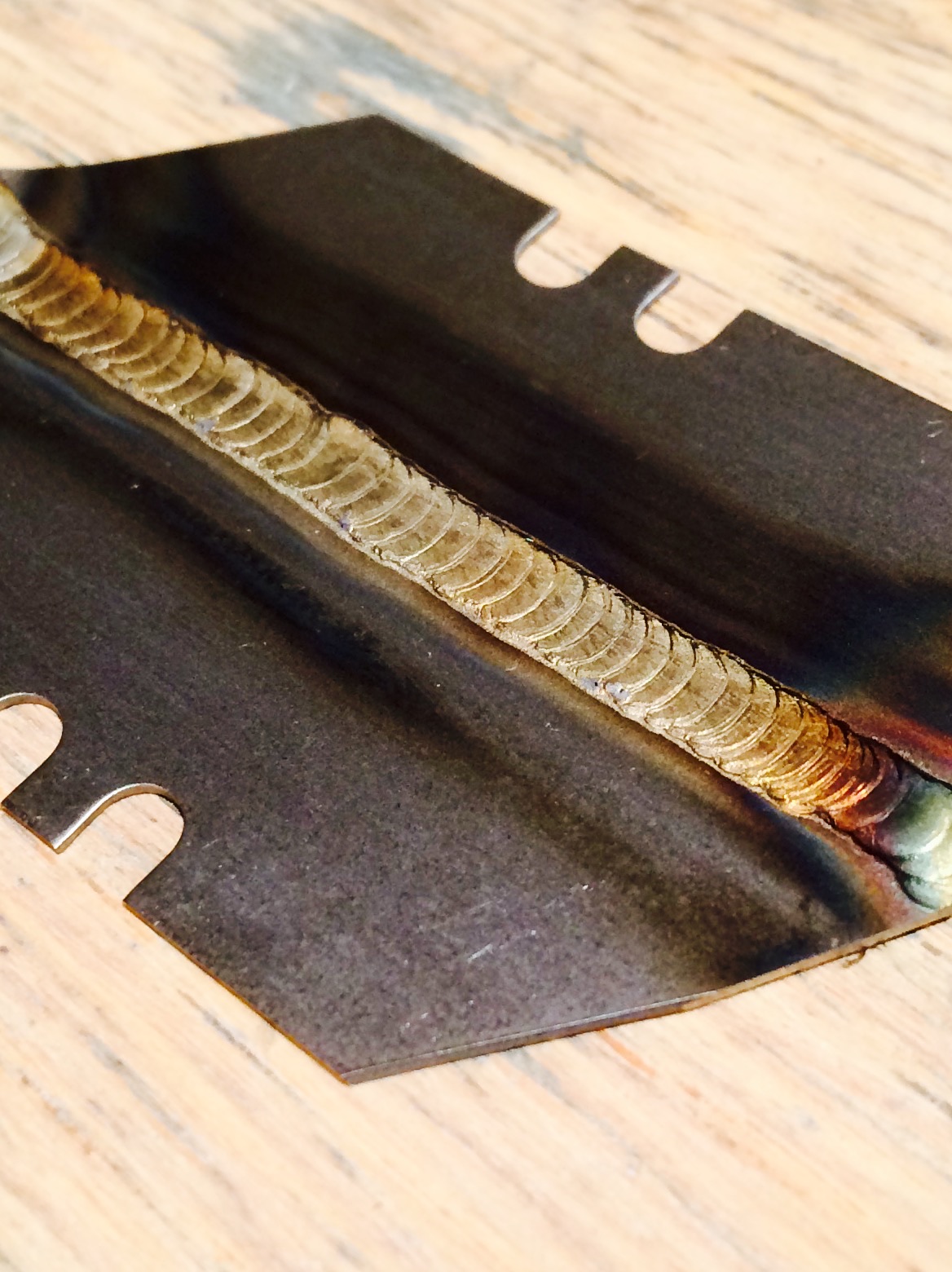

the welding particularly on the lower middle pic looks more like a series of tacks rather than a continuous joint. You need to get your filling intervals much closer together. A joint like that wouldn't be very strong but more importantly on that it could slightly blow.
