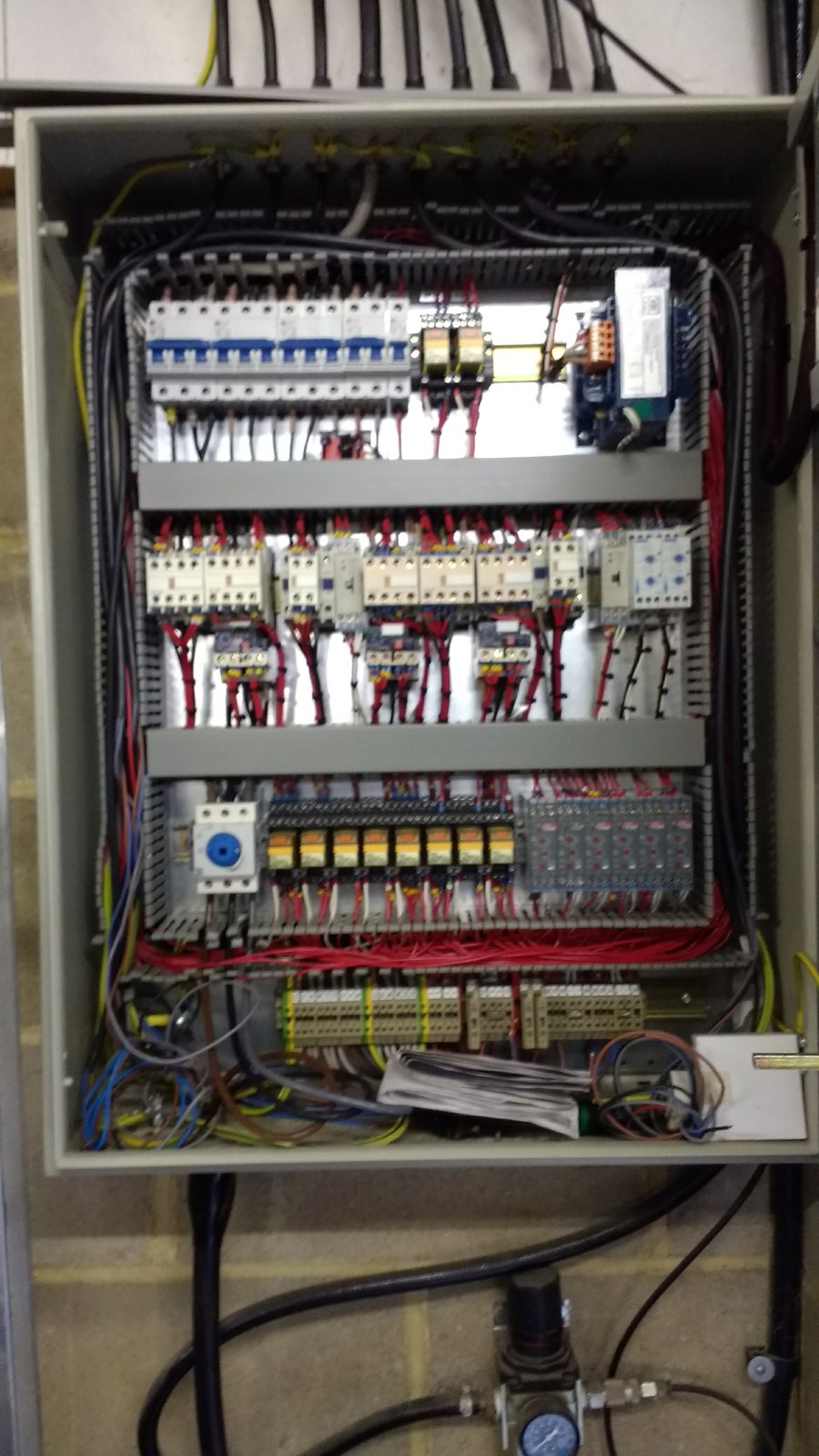

Ok the plastic flexible conduit terminated at the top of the start delta, that open fitting will allow the box to get filled with dust unless opened regularly to clear. Even with the correct glands in this type of environment its a constant maintenance battel to regularly keep switchgear boxes clear. I have opened boxes like that in the past to find them half full of dust and contactors failing to close when energised.

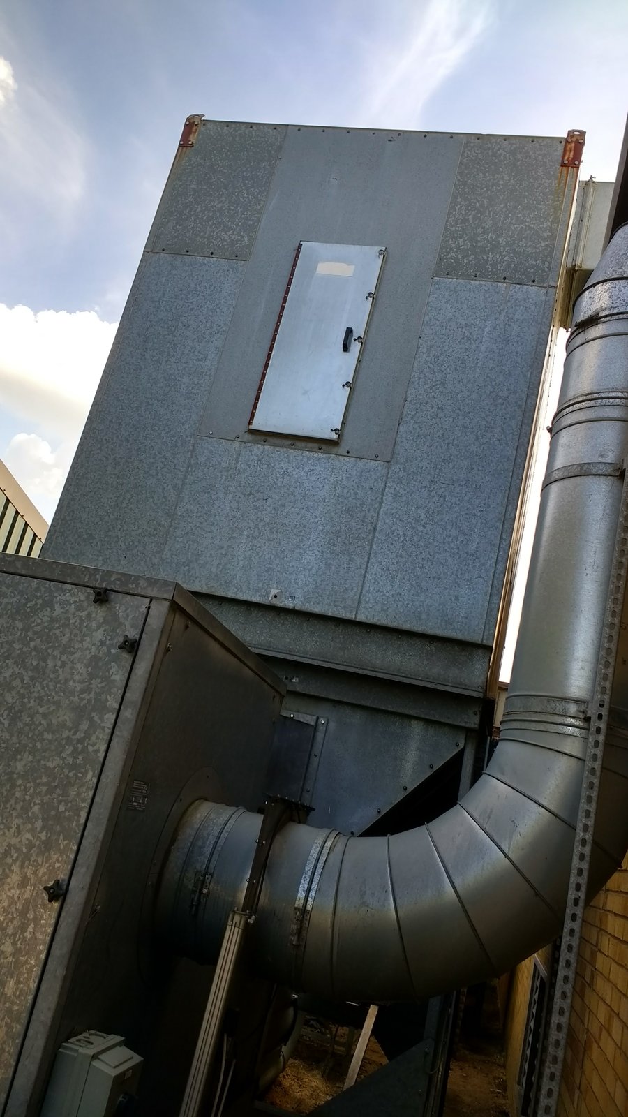

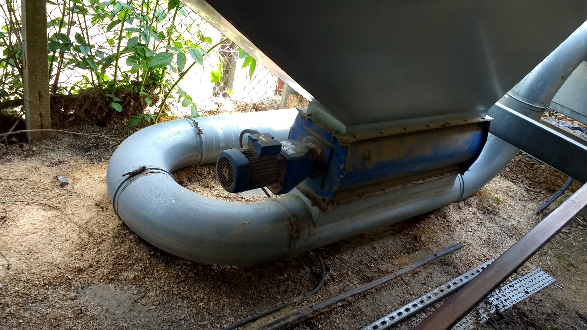

View attachment 225281 View attachment 225282 View attachment 225284
Extraction at a customers site I supported until I dismantled and packaged for export.
No wase bags straight into a 40foot trailer via transfer fan.
Now over 20 years in wood-related production manufacturing and 40 years in UK manufacturing I don't play at this for fun.
That feature has already been discussed, I flagged it with the owner. I haven’t opened the control box up yet to see what that flying lead is. Clearly someone has modified this item from the original configuration. I am already in discussion with the manufacturer to address that specific issue. Thanks for pointing it out and I will make sure it is properly addressed.

I don’t doubt you have experience or even expertise in the subject. I take people at face value but I don’t see how those pictures help me in this circumstance or how that constitutes “a long and helpful technical post”.
