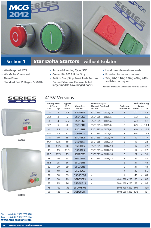

Not sure what this is bolted to it. Some sort of star-delta starter but with a built in timer (??).
I may try and track it down with the original company based on their sales record. Meanwhile does anyone know what it is?
